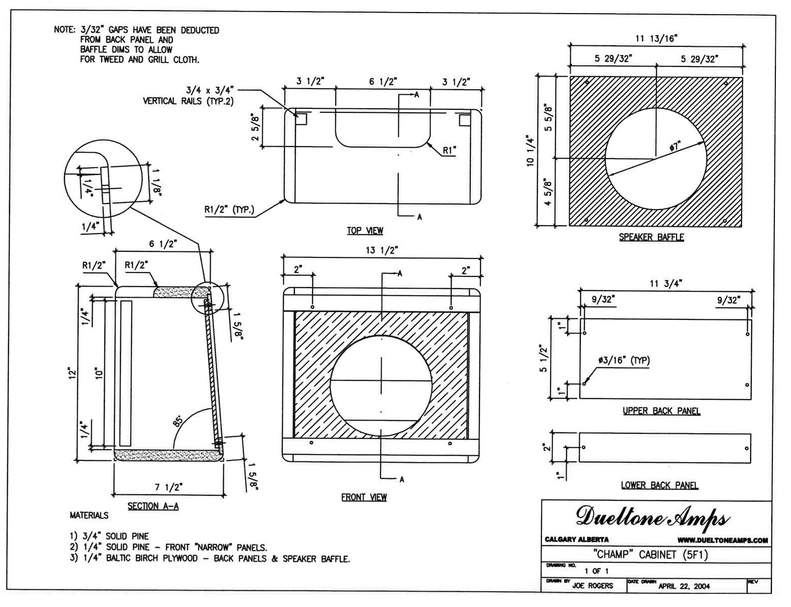

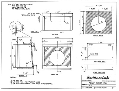

Re: How to build a Fender Champ 5F1 style CABINET
Mojojtm wrote: Tue Dec 21, 2021 8:52 pmI asked how to build a Fender Champ guitar cabinet
Fender Champ cabinet plans from the web:
Champ cab (5F1) DuelTone.pdf
(137.01 KiB) Downloaded 1313 times
Mojojtm
Posts: 73
Joined: Wed Dec 15, 2021 6:09 pm
Location: Hoofddorp, Netherlands
Post by Mojojtm »
Thanks a lot that helps

Mikante
Posts: 214
Joined: Fri Oct 29, 2021 7:07 pm
Location: Italy
Post by Mikante »

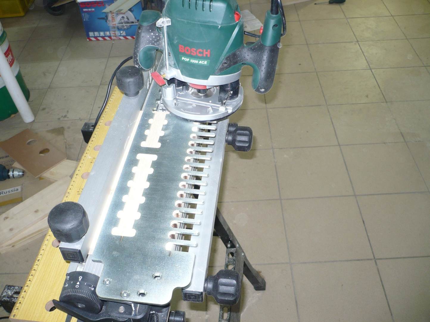

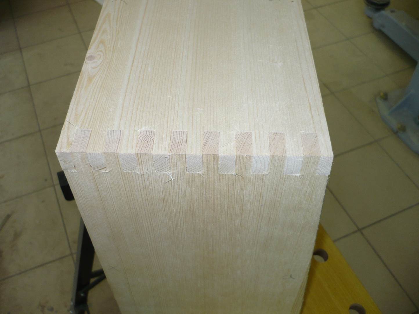

Hello, i m building the same cabinet, just larger enough to host a 10 inch speaker.
I wouldn’t care about the finger joint, a simple dado/rebate on each side, some vinylic glue and clamps.
You ll get the same result and there is no benefit in terms of vibration going for the finger joint which is in my opinion purely aesthetic and probably a better choice only if you decide not to use the classic tweed tolex to cover the cabinet.
But this is just my advice on the construction method that you might want to take into account.
The plans that Martin provided you are what you were looking for.
I would add a couple of screews in the middle to have a better connection between the cabinet and the baffle.
I d like to see your work in the process of making it.

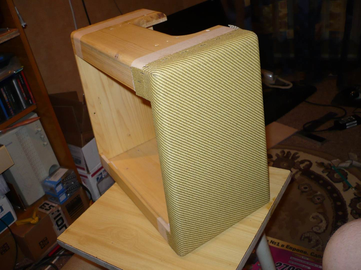

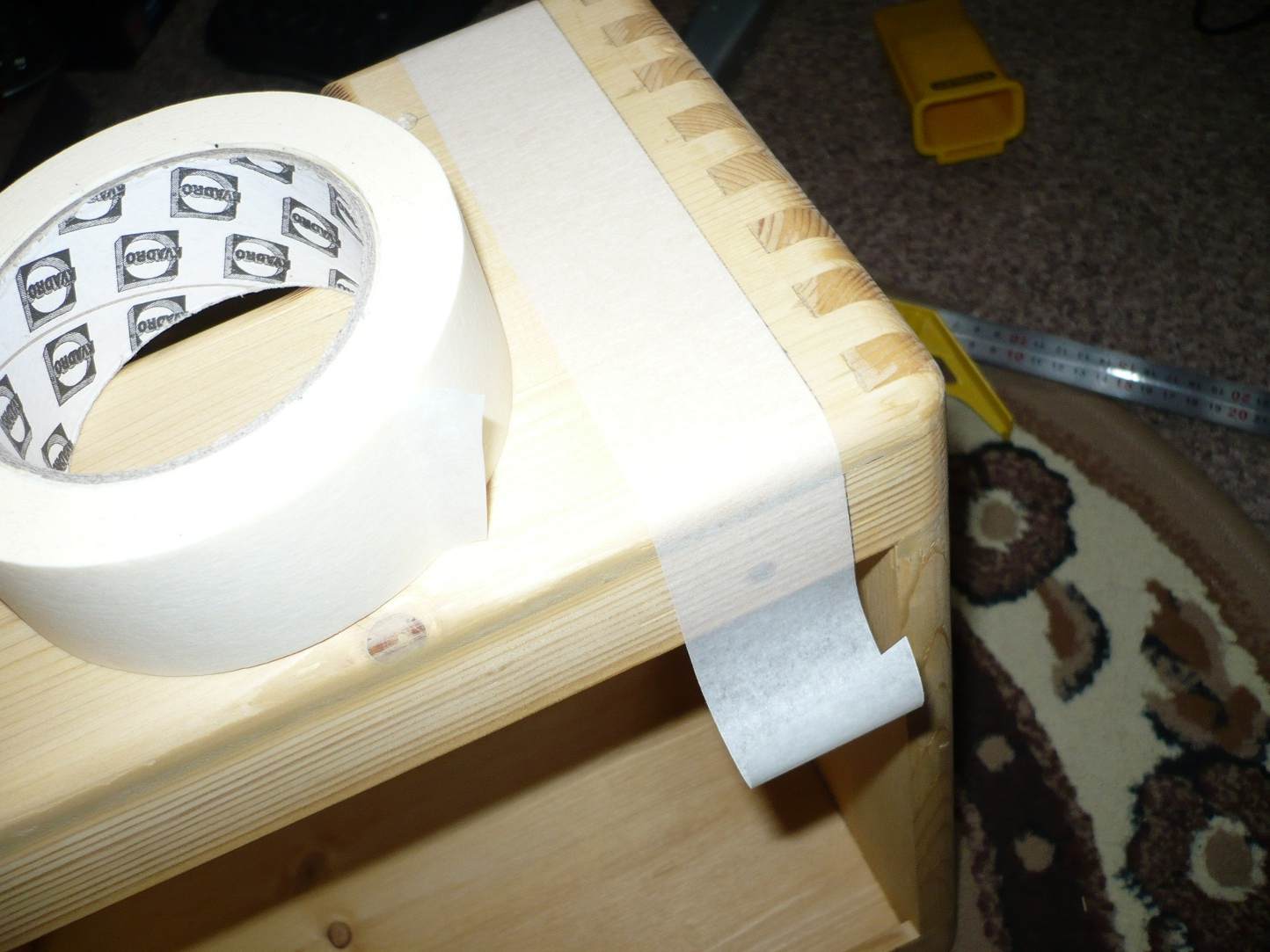

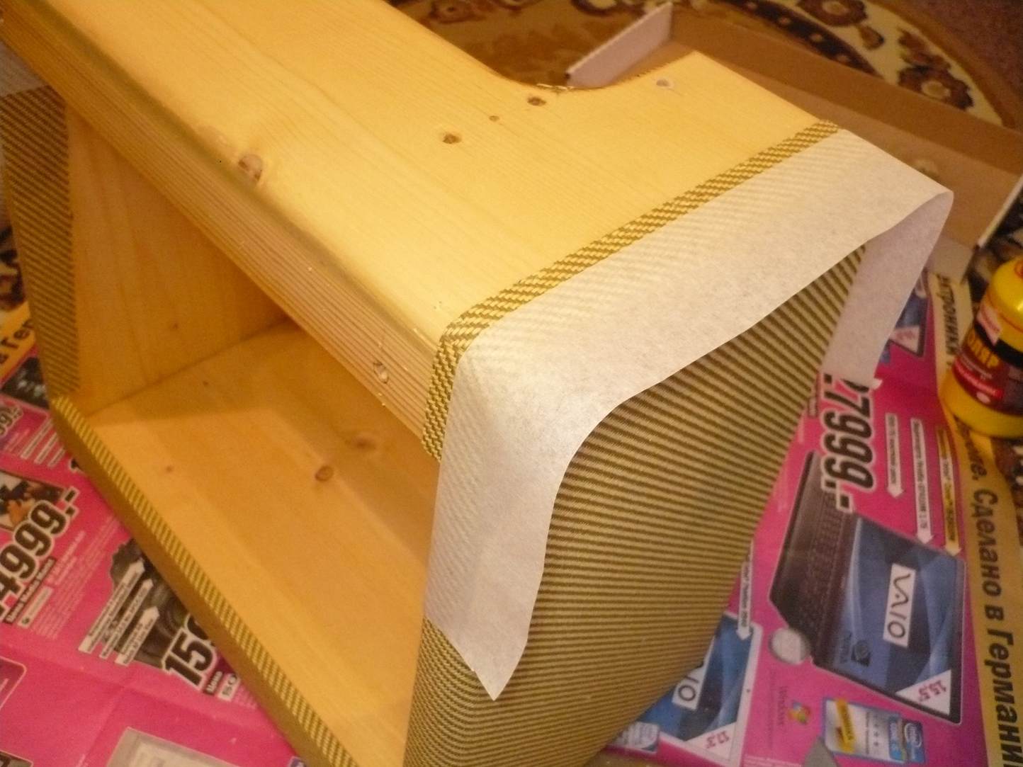

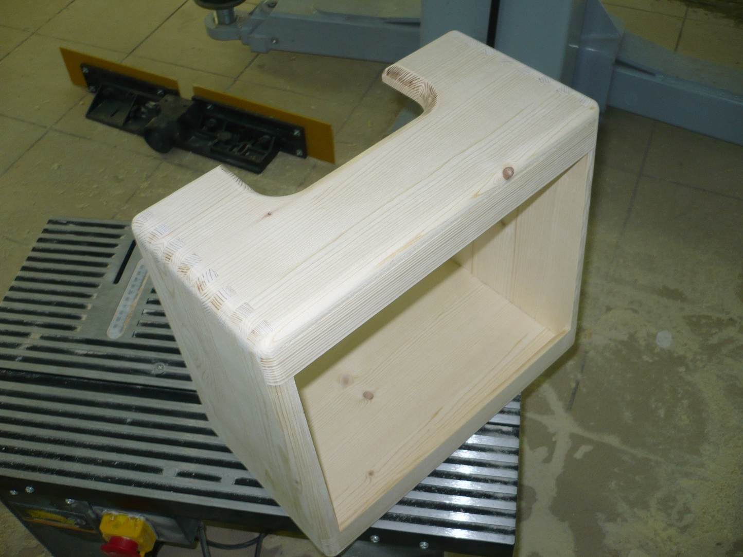

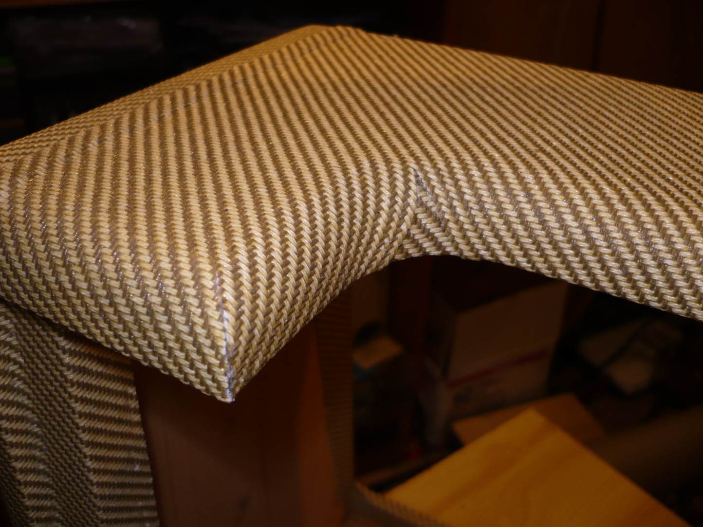

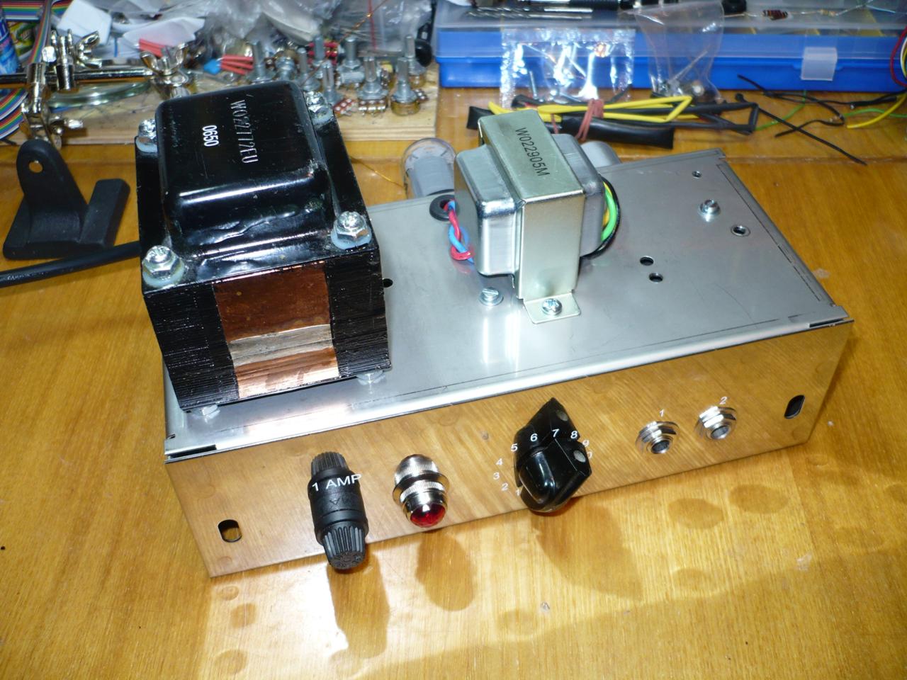

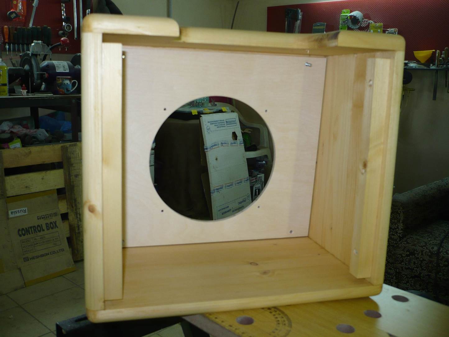

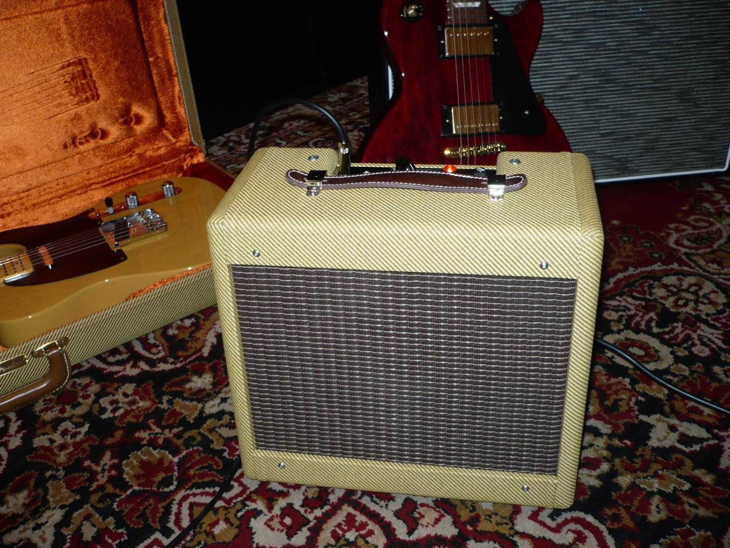

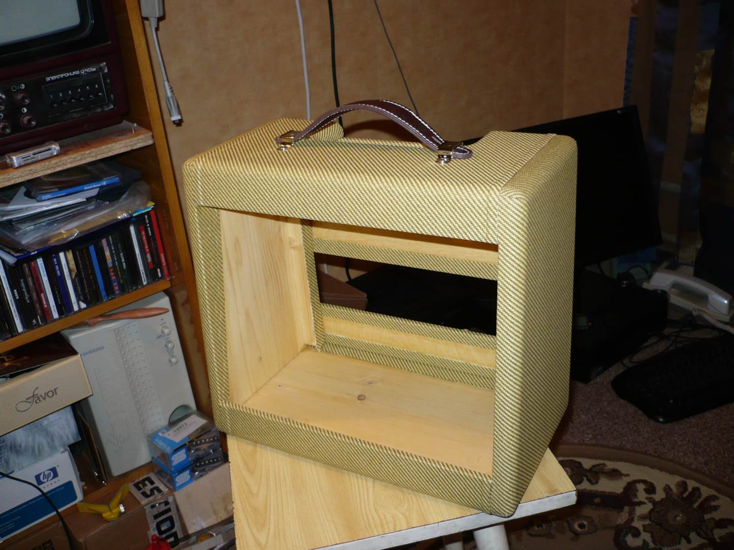

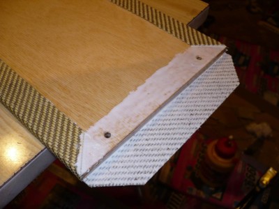

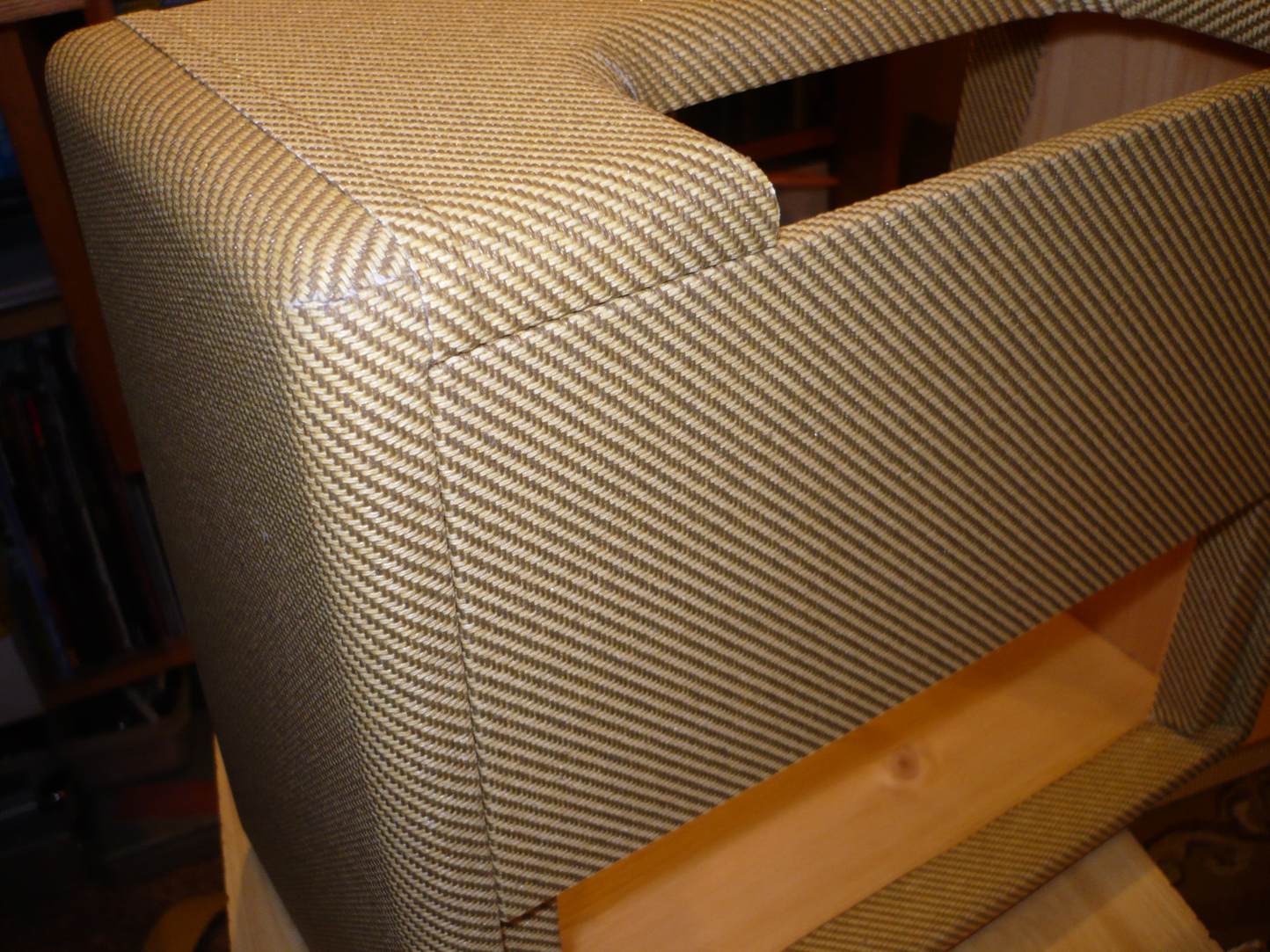

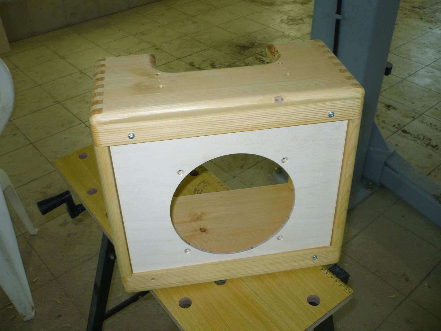

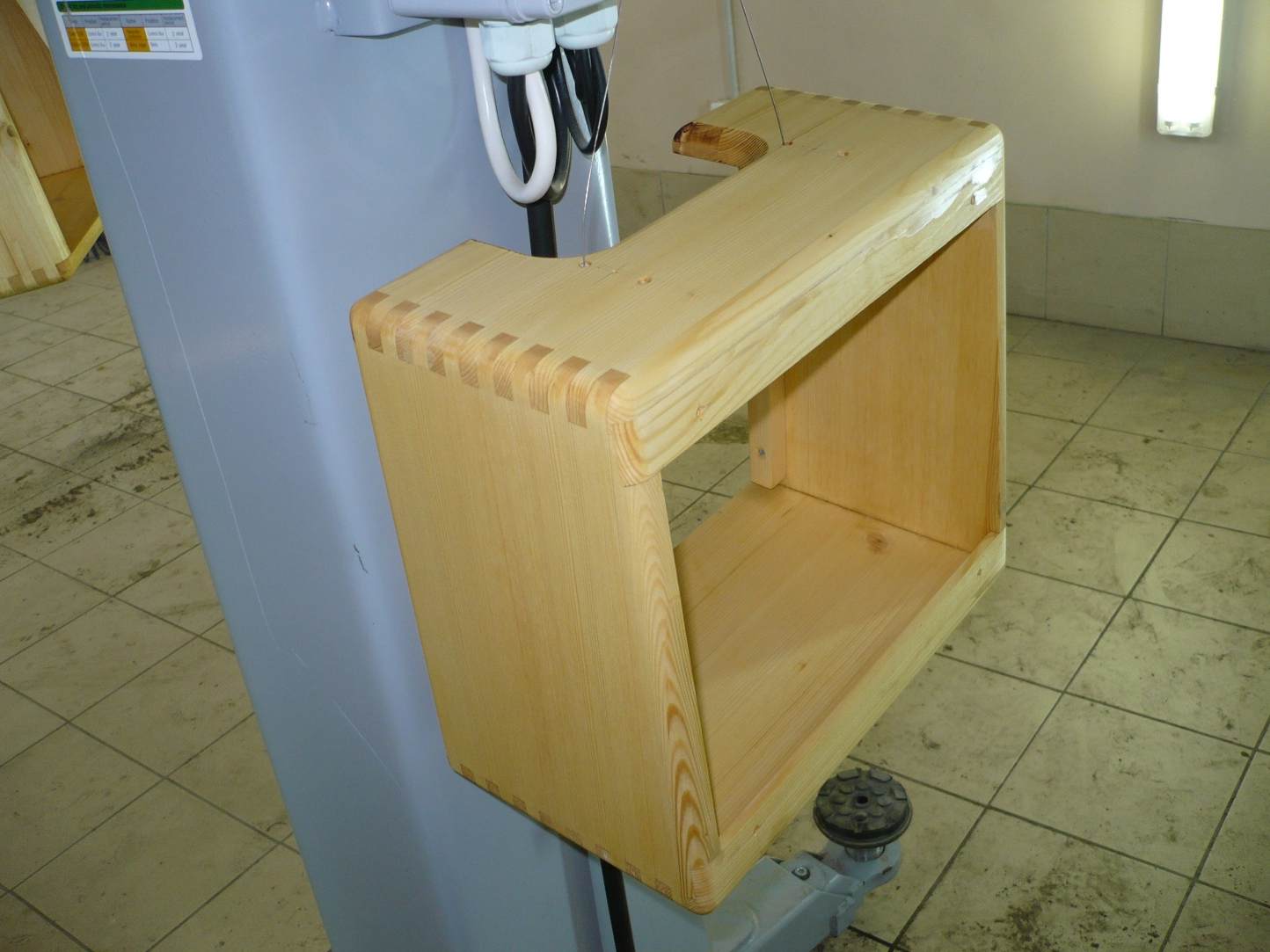

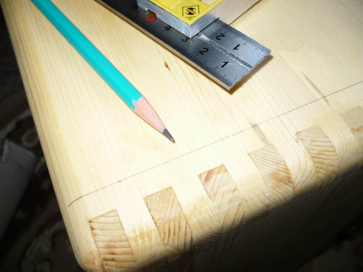

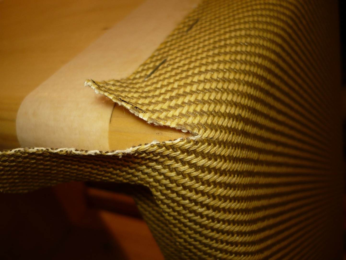

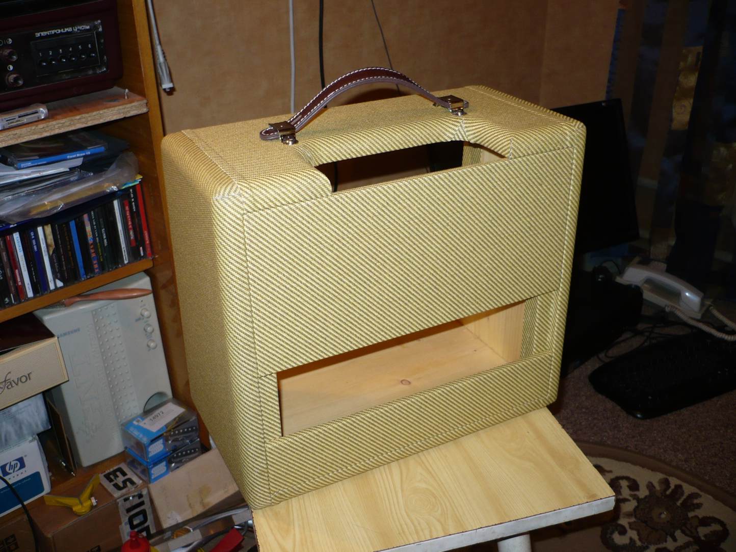

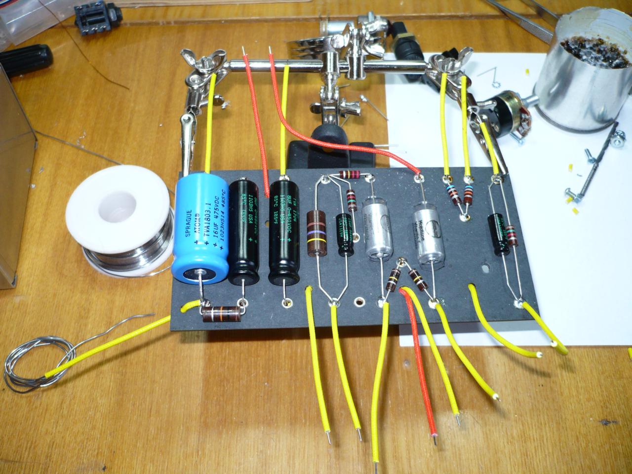

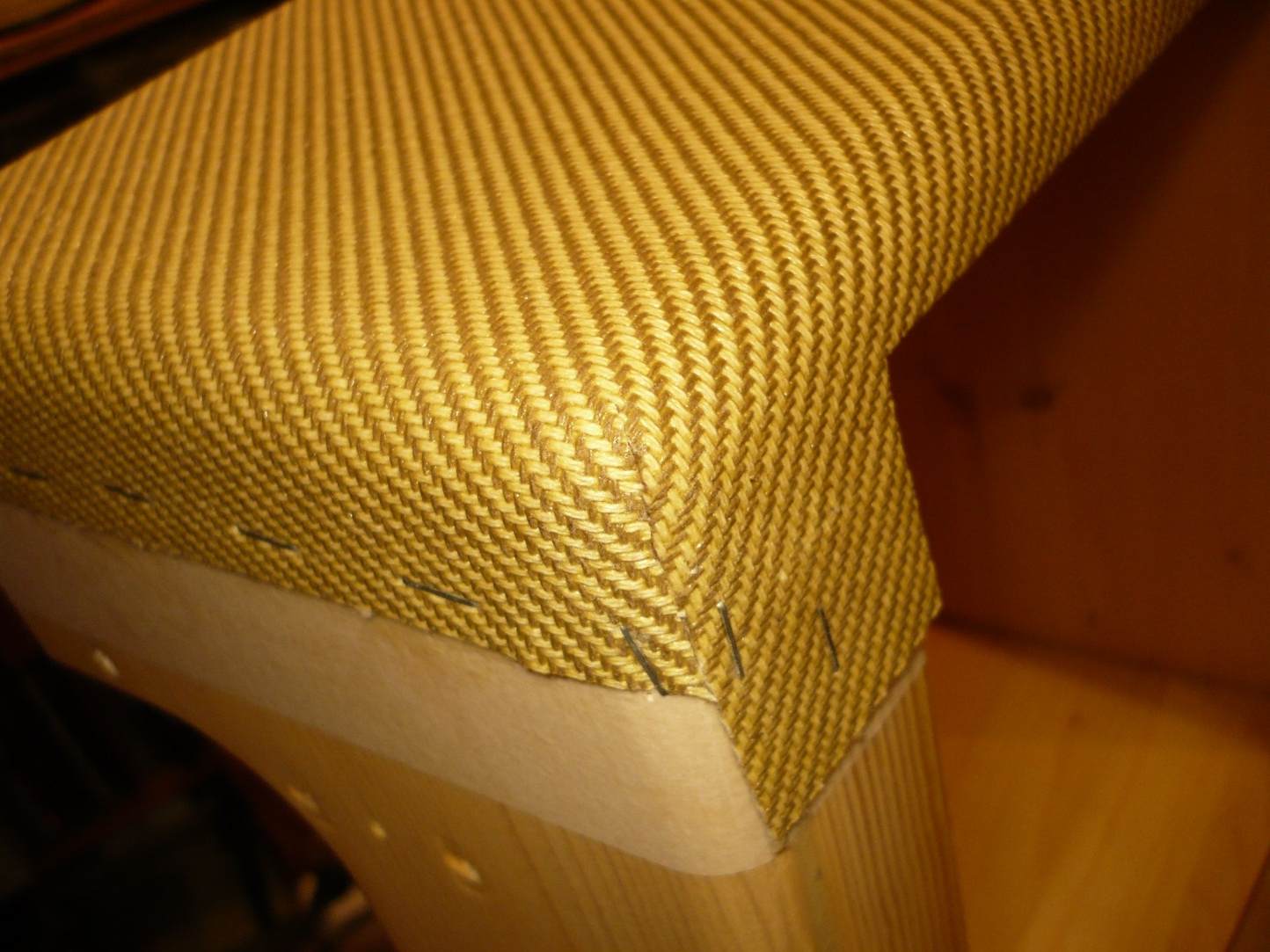

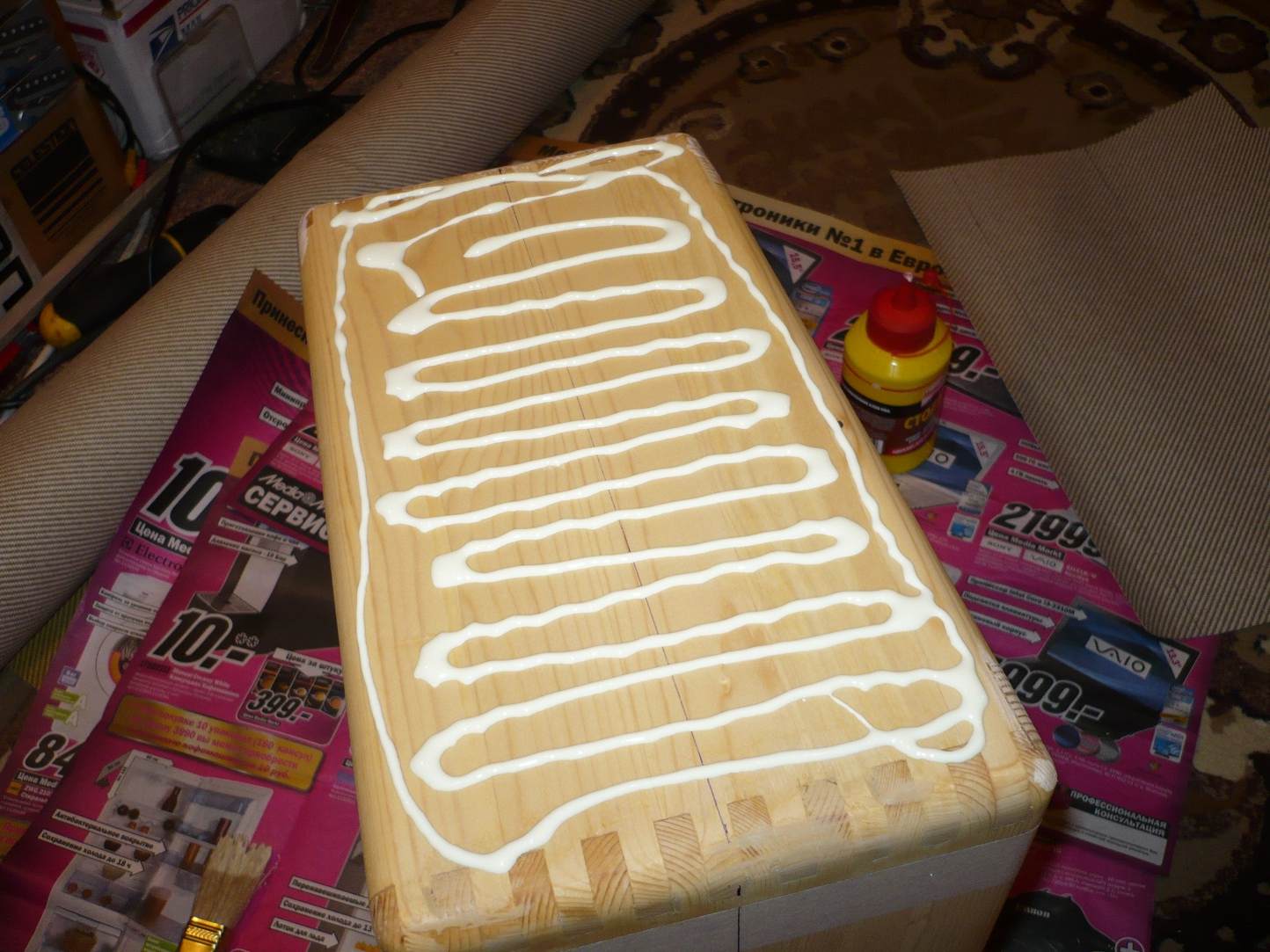

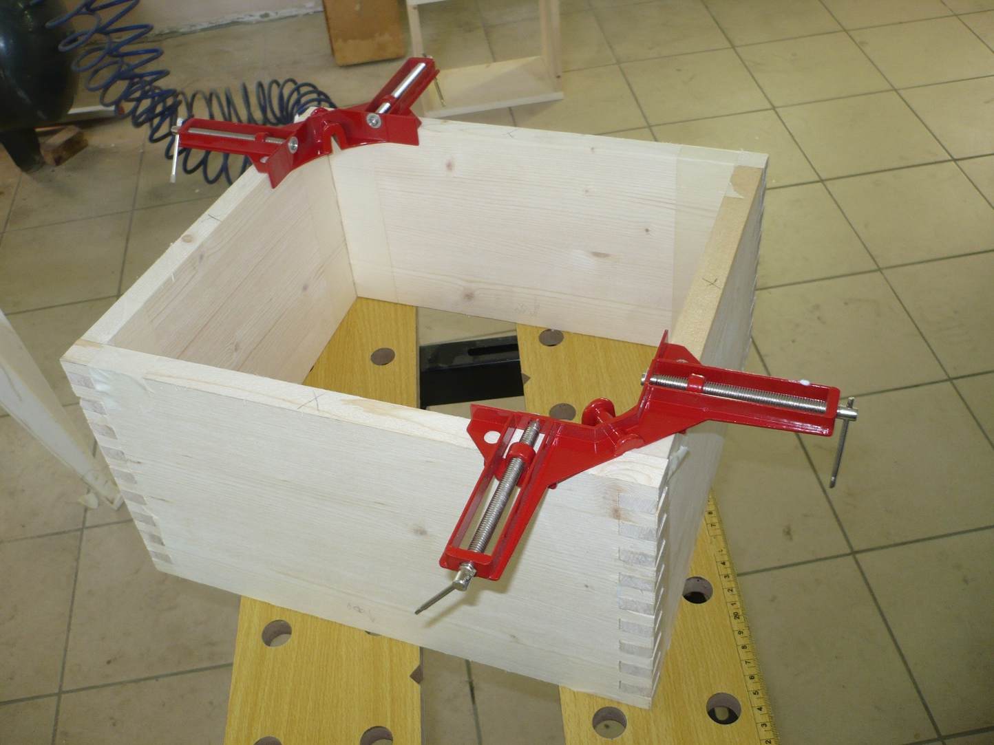

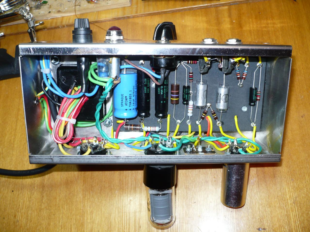

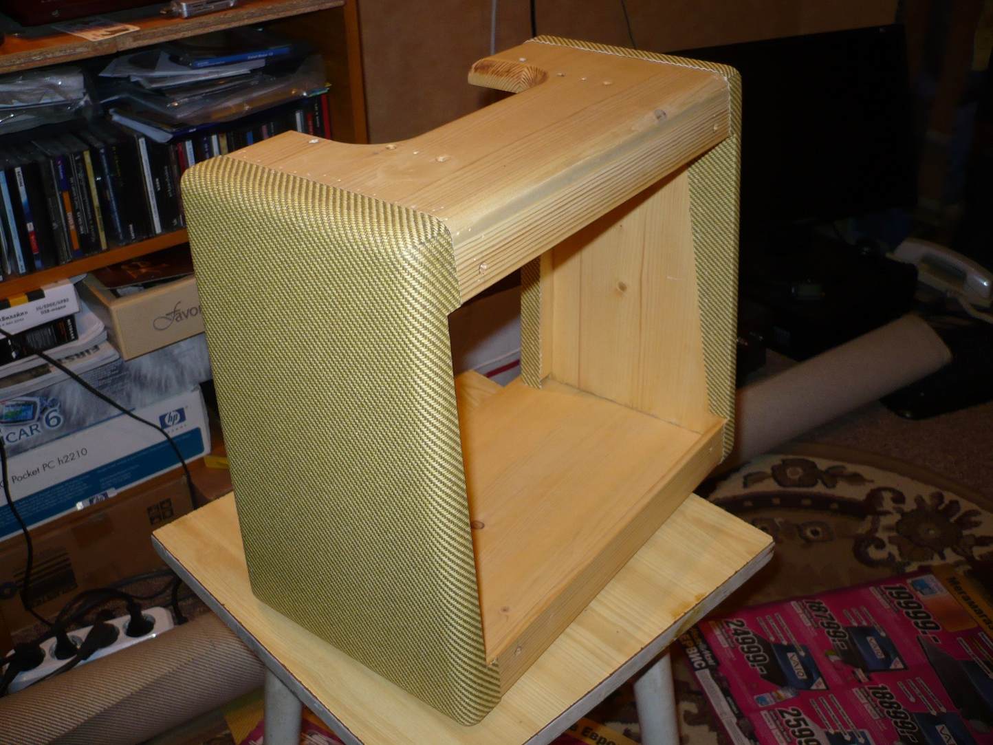

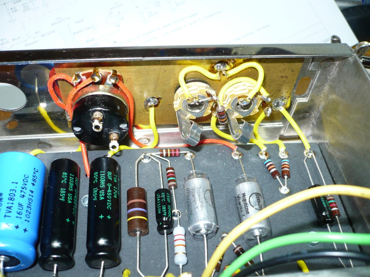

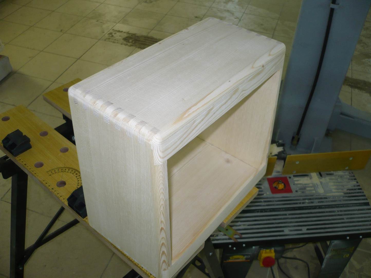

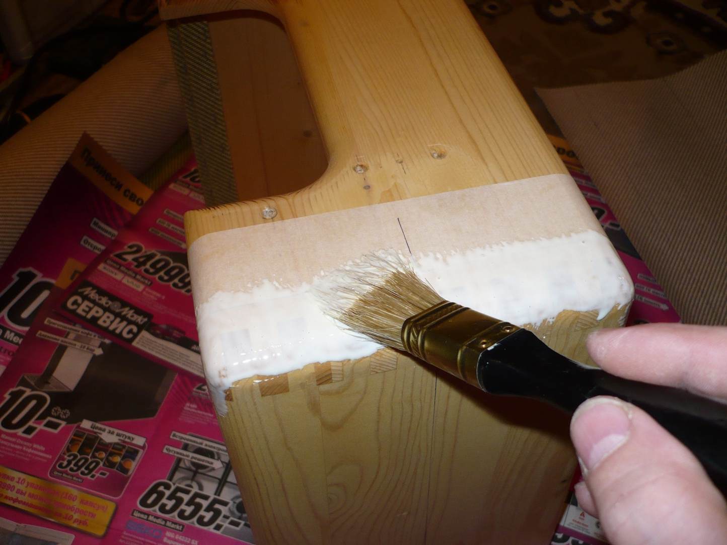

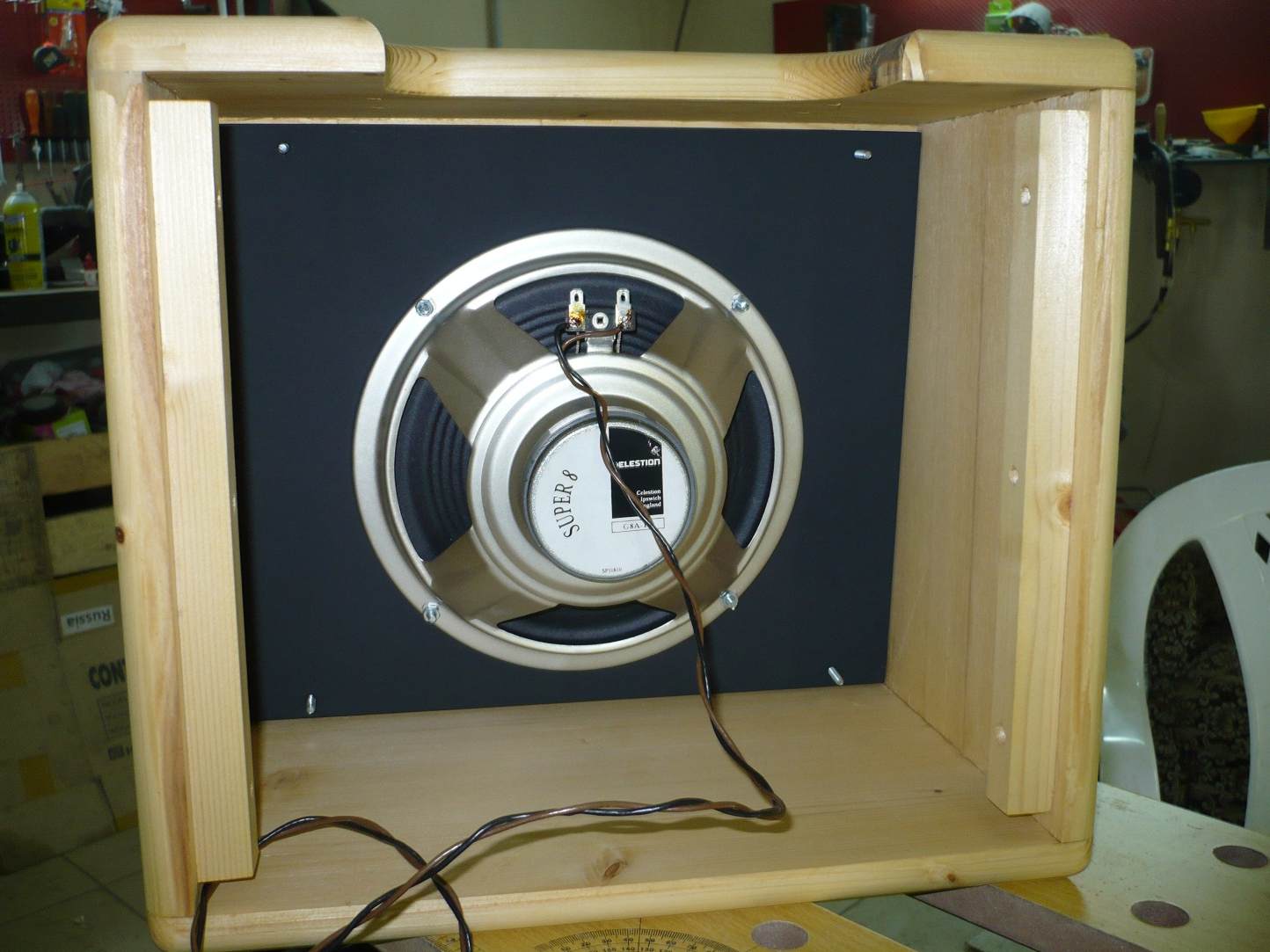

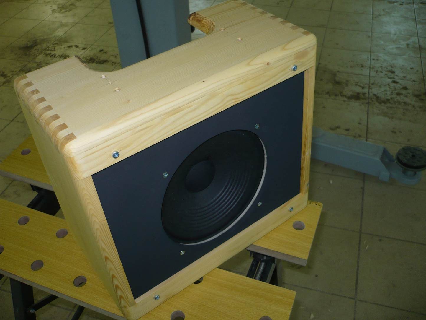

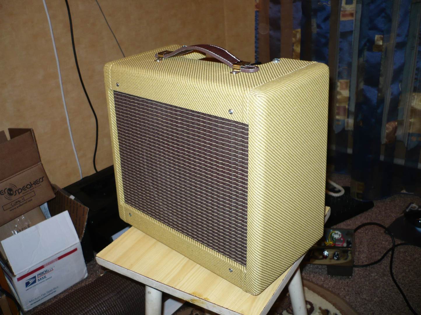

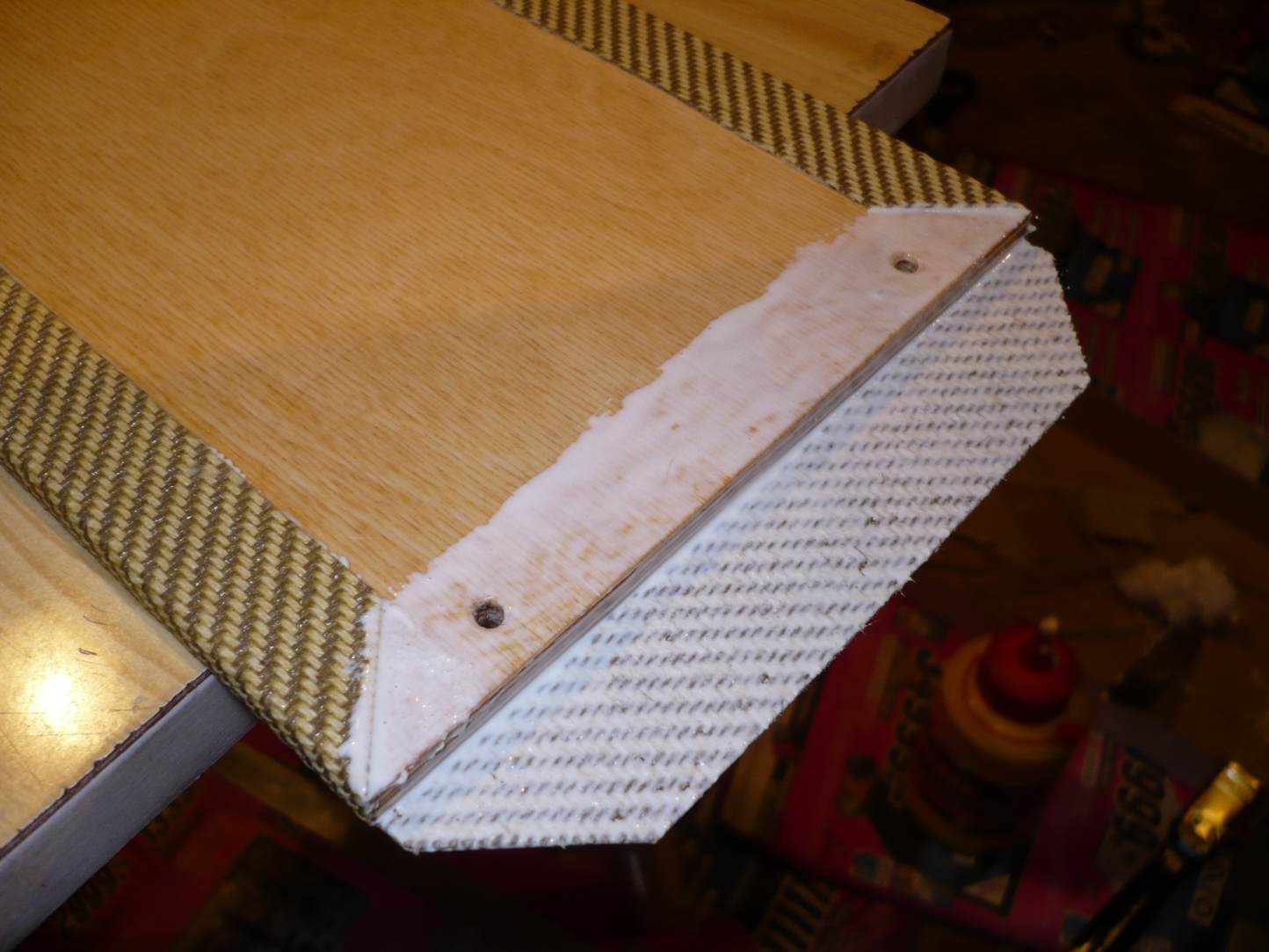

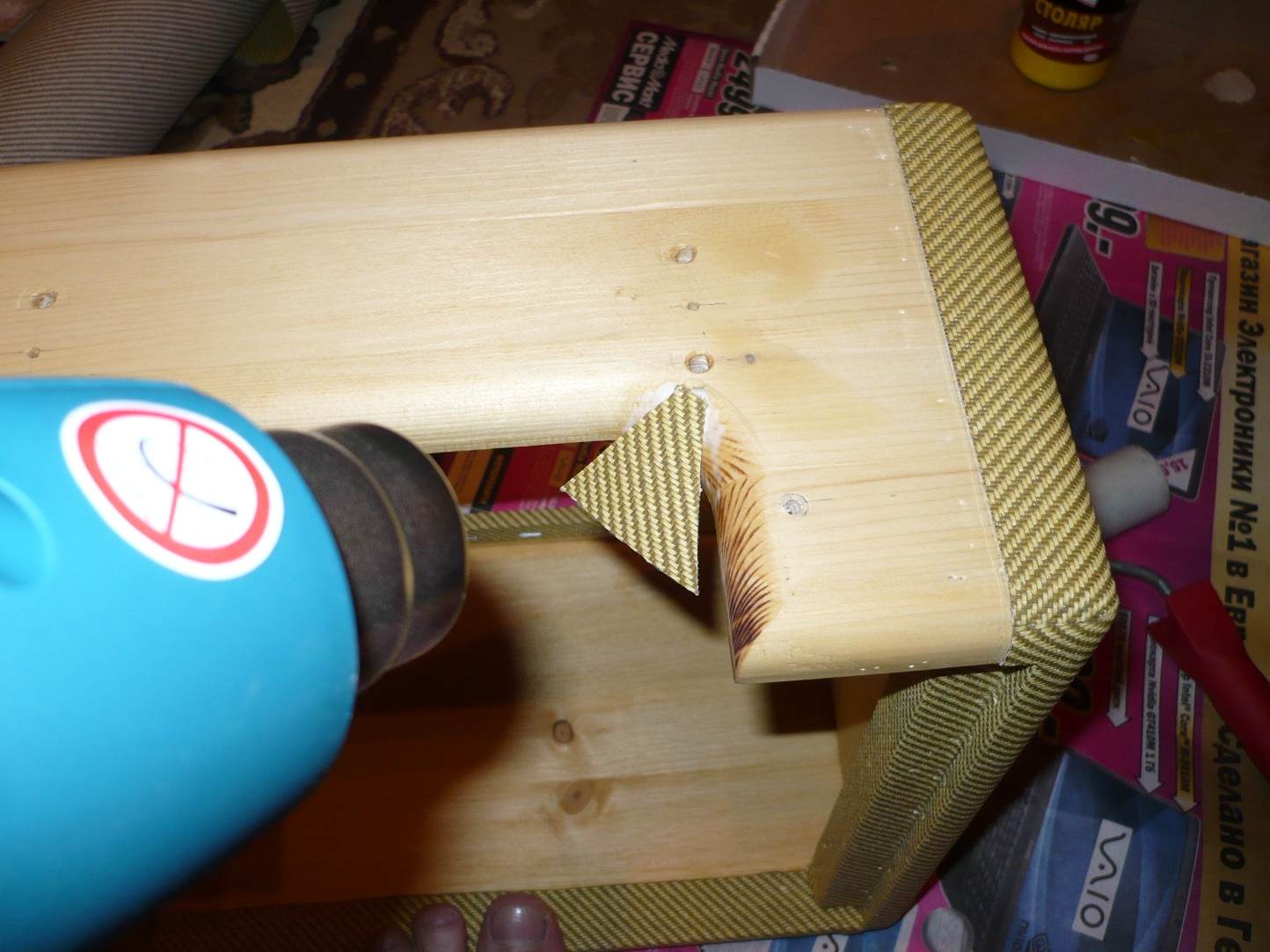

I remembered that a long time ago I also collected Champ, and I still have photos of the build, step by step. I think it might be useful to someone...
alkuz1961
Posts: 179
Joined: Sat Mar 03, 2012 3:32 am

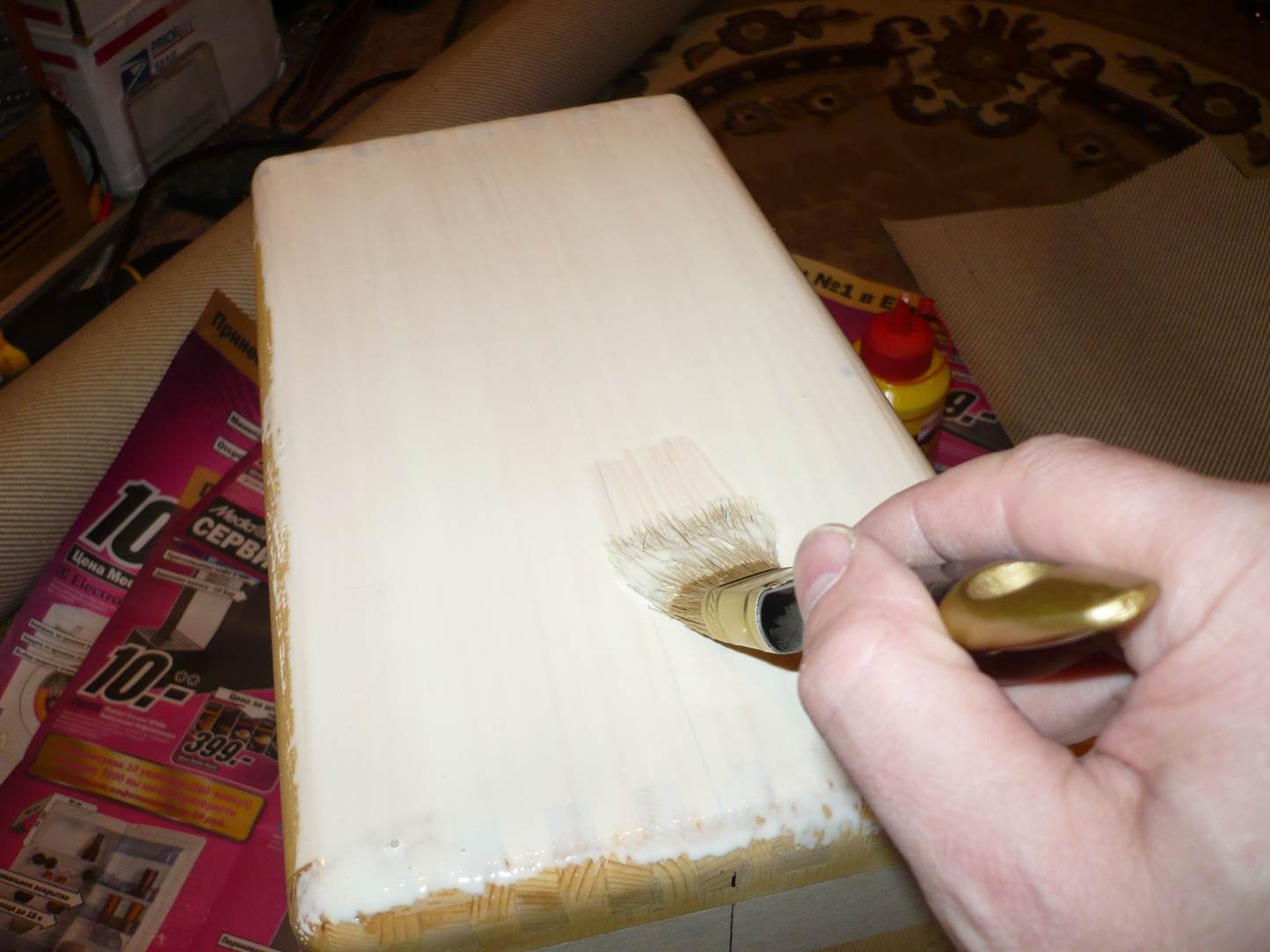

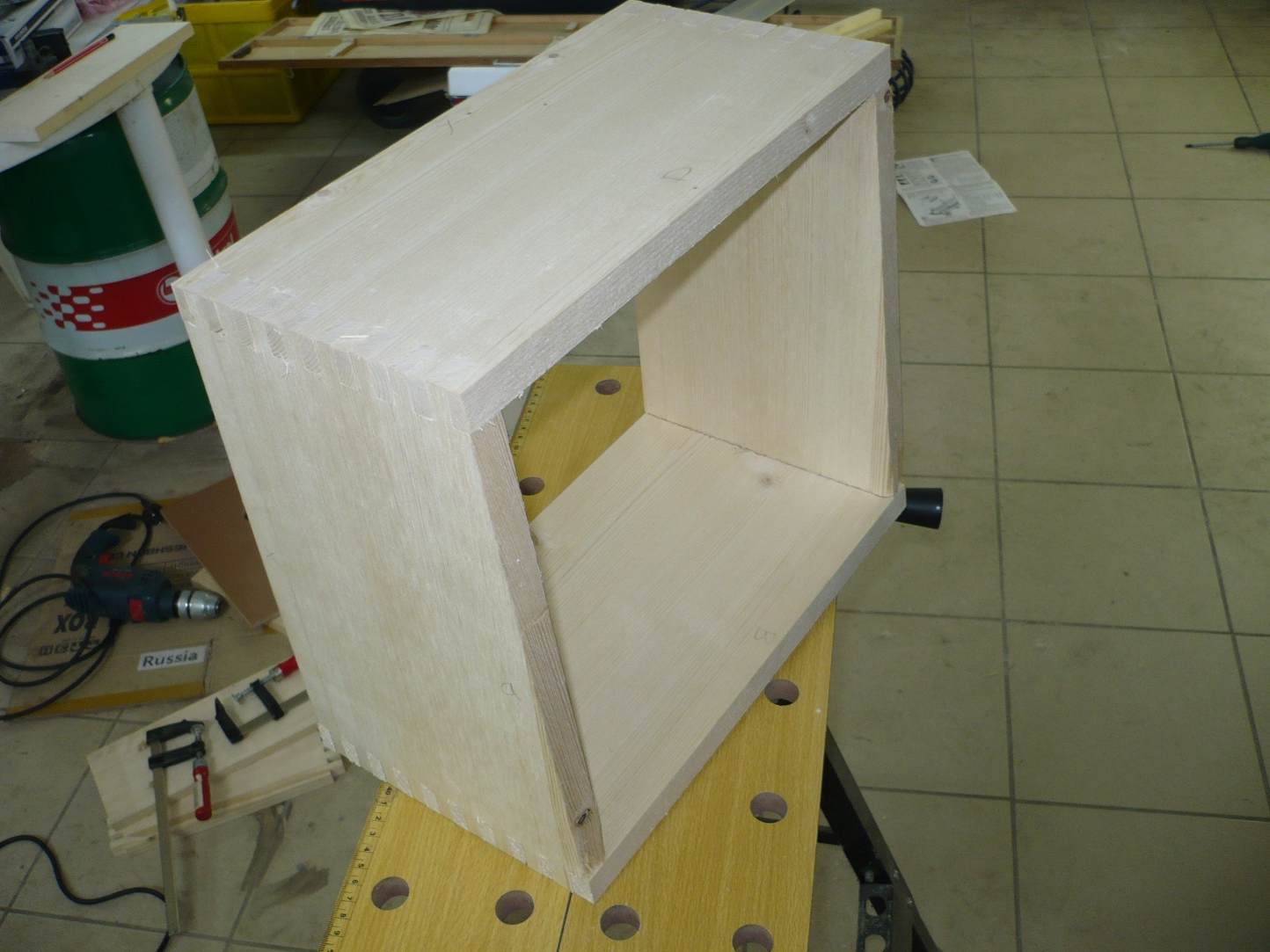

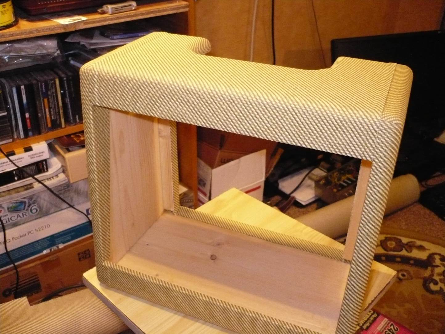

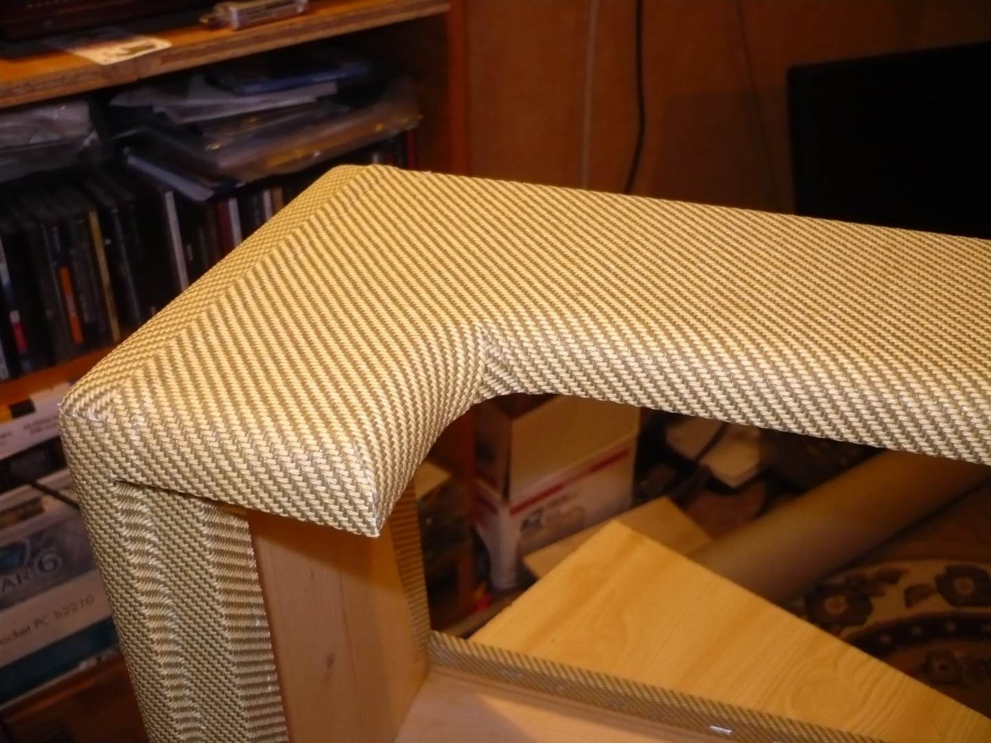

Post by alkuz1961 »
continuation

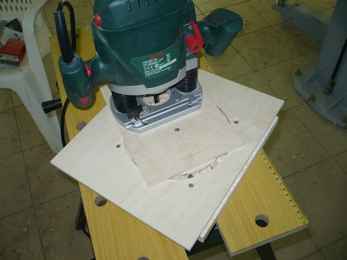

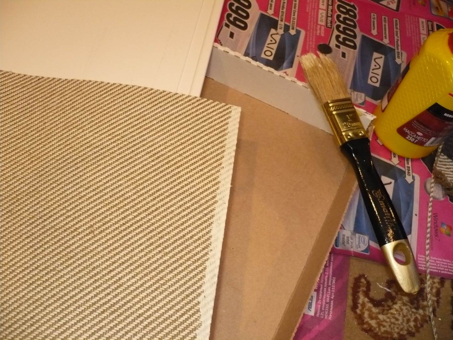

alkuz1961
Posts: 179
Post by alkuz1961 »
and a little more

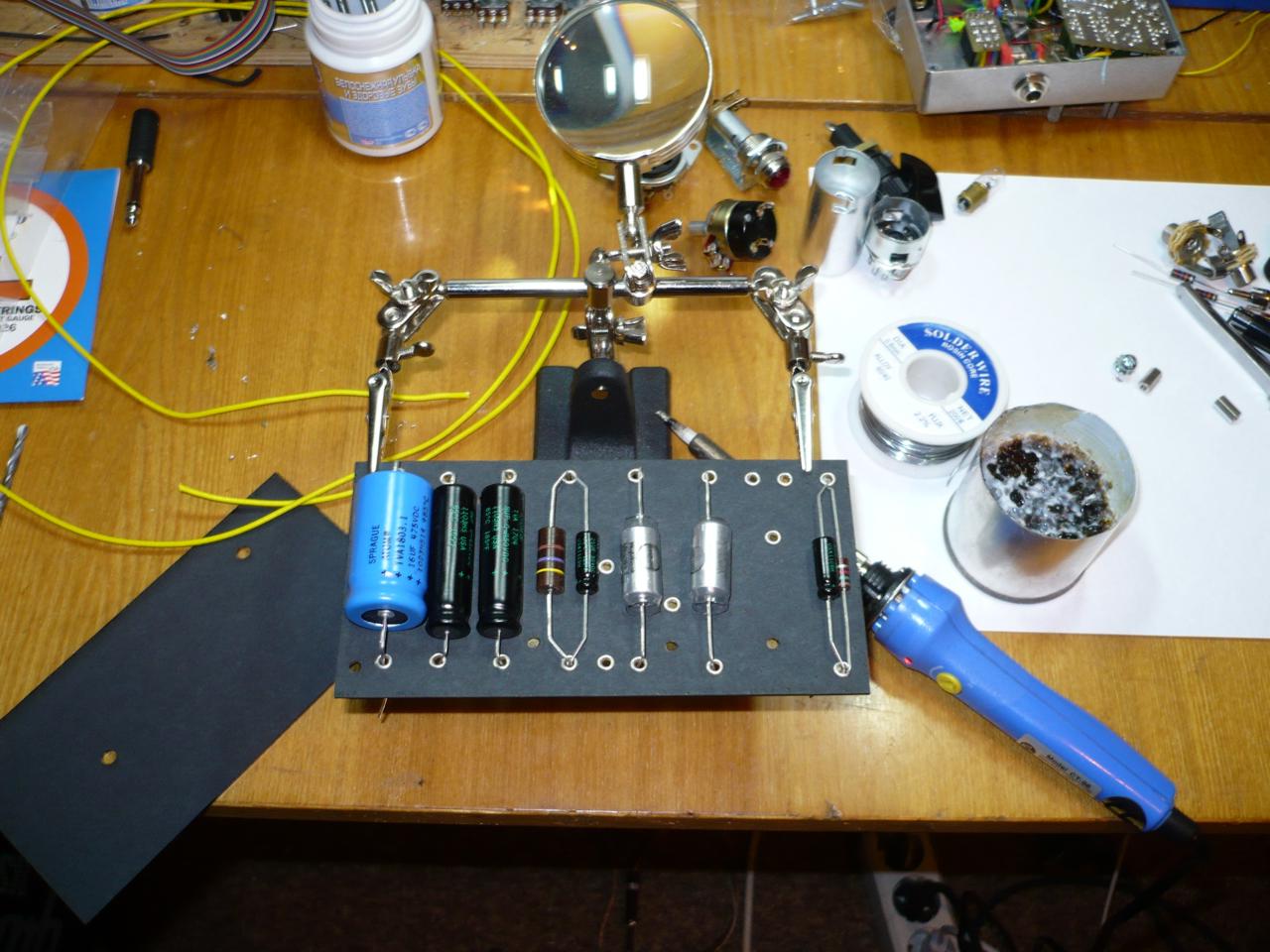

alkuz1961
Posts: 179
Post by alkuz1961 »
It's almost over )))

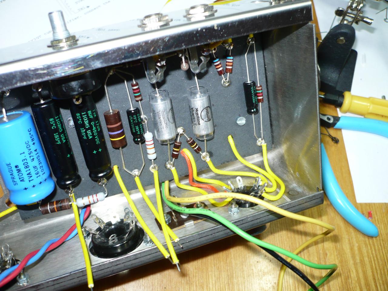

sluckey
Posts: 3528
Joined: Sun Jul 22, 2007 7:48 pm
Location: Mobile, AL
Post by sluckey »
I'm surprised to see 27K on the input jacks. The original 5F1 uses 1M.
alkuz1961
Posts: 179
Post by alkuz1961 »
sluckey wrote: Thu Jun 16, 2022 5:12 pm I'm surprised to see 27K on the input jacks. The original 5F1 uses 1M.
Oh, I'm surprised myself! But it was a long time ago and I don't remember all the nuances of this build anymore. I think this is some kind of temporary glitch that has been fixed)))
