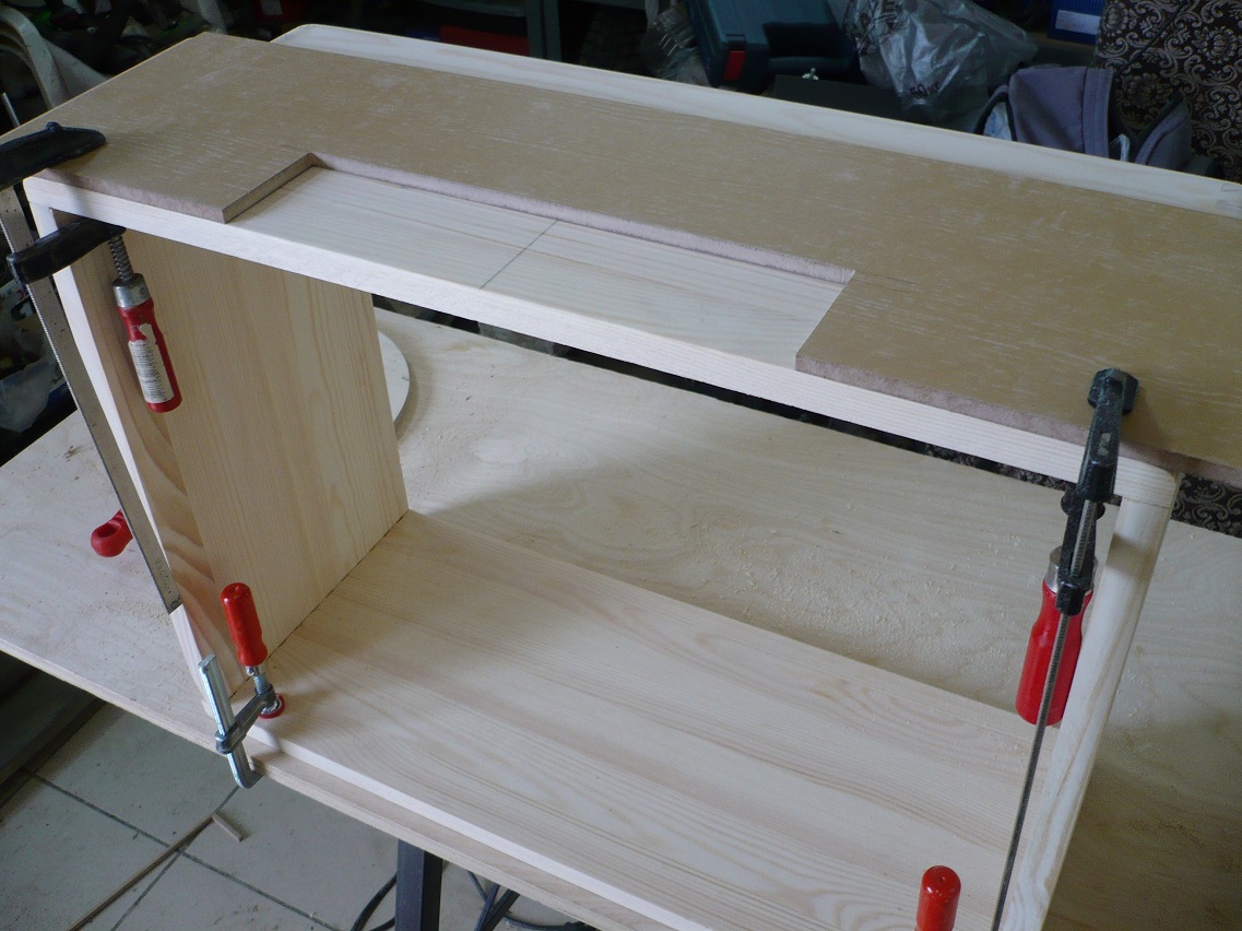

Geeze, your woodworking makes me jealous ...
I use that kind of drilling "hole saw" thing
with apologies for the Google translation ...
But of course there might be more suited tools to do that - especially for the drilling "hole saw" thing doesn't necessarily make for a sharp cut on soft wood.
At least I could do that
even though the right edge on the picture was a "oops" one that was somewhat "rectified" with the ruler and the copying bit, afterwards : if you look carefully it doesn't look that straight.
You got the idea. I manage to do the cutout prior to cutting the board for the top to the final size, so I can even bolt the (drilled) ruler on its edges.

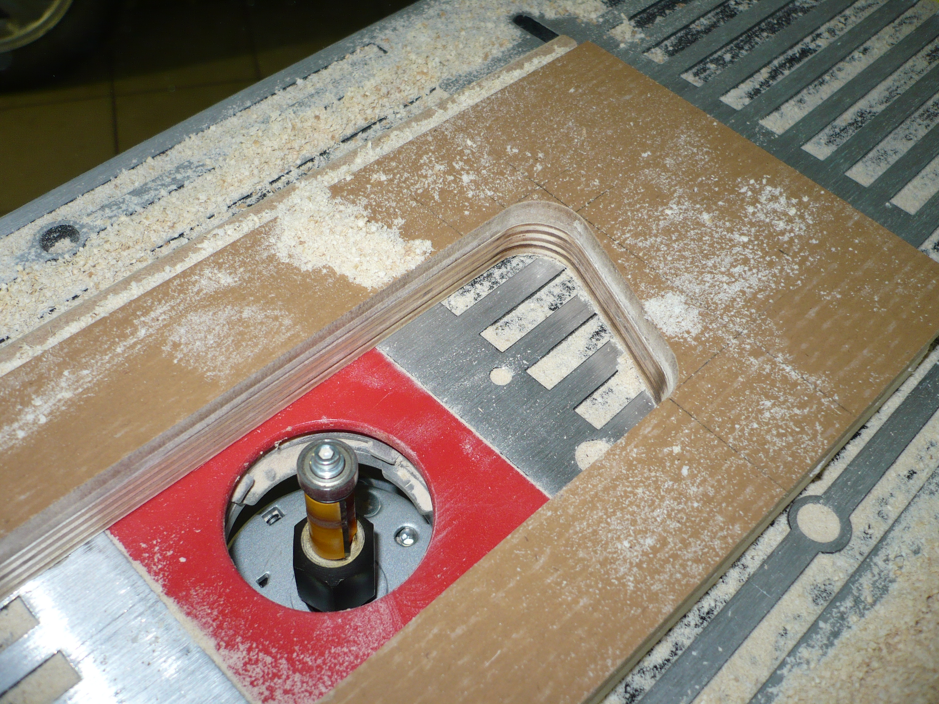

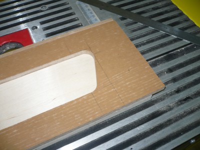

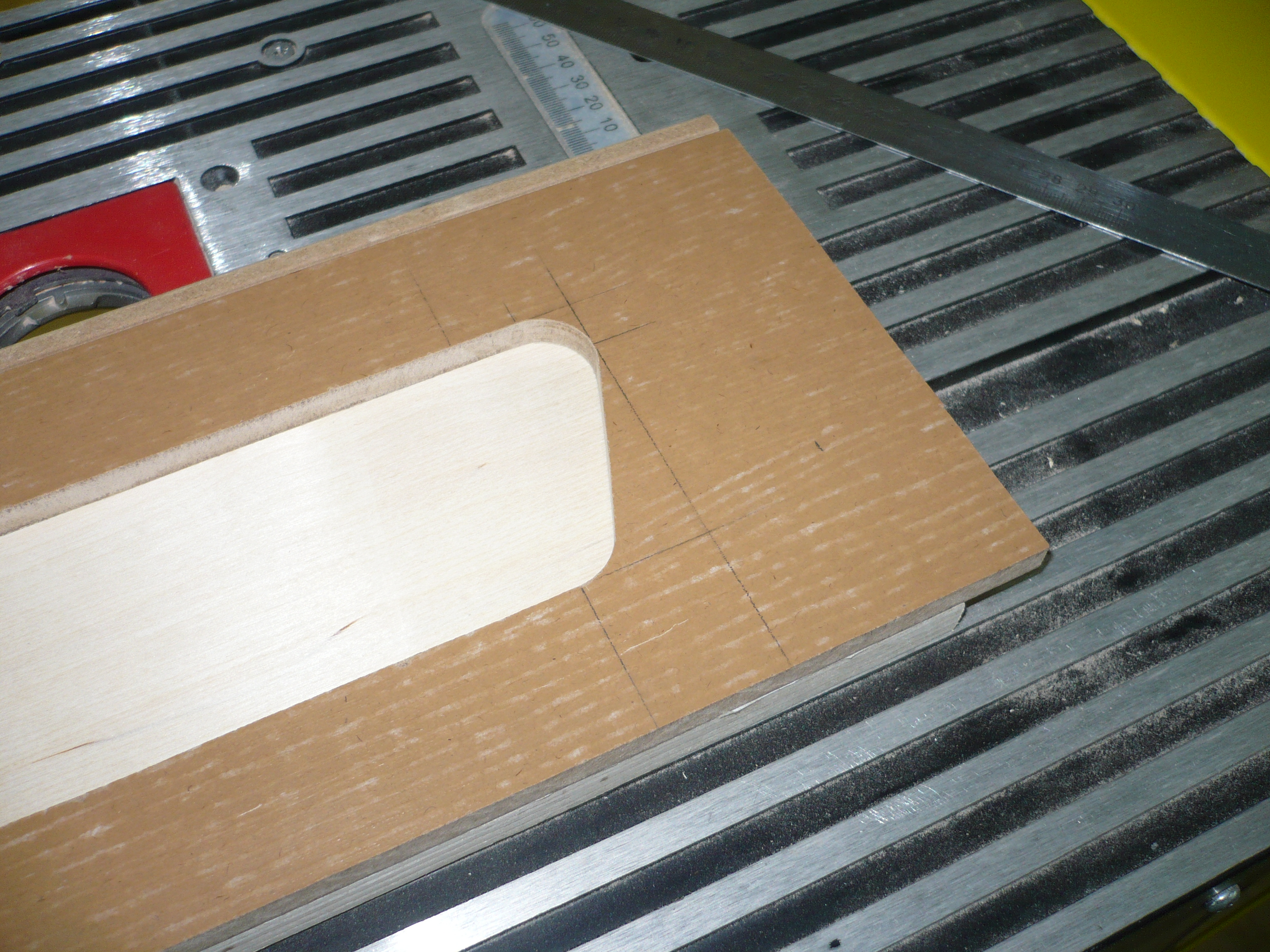

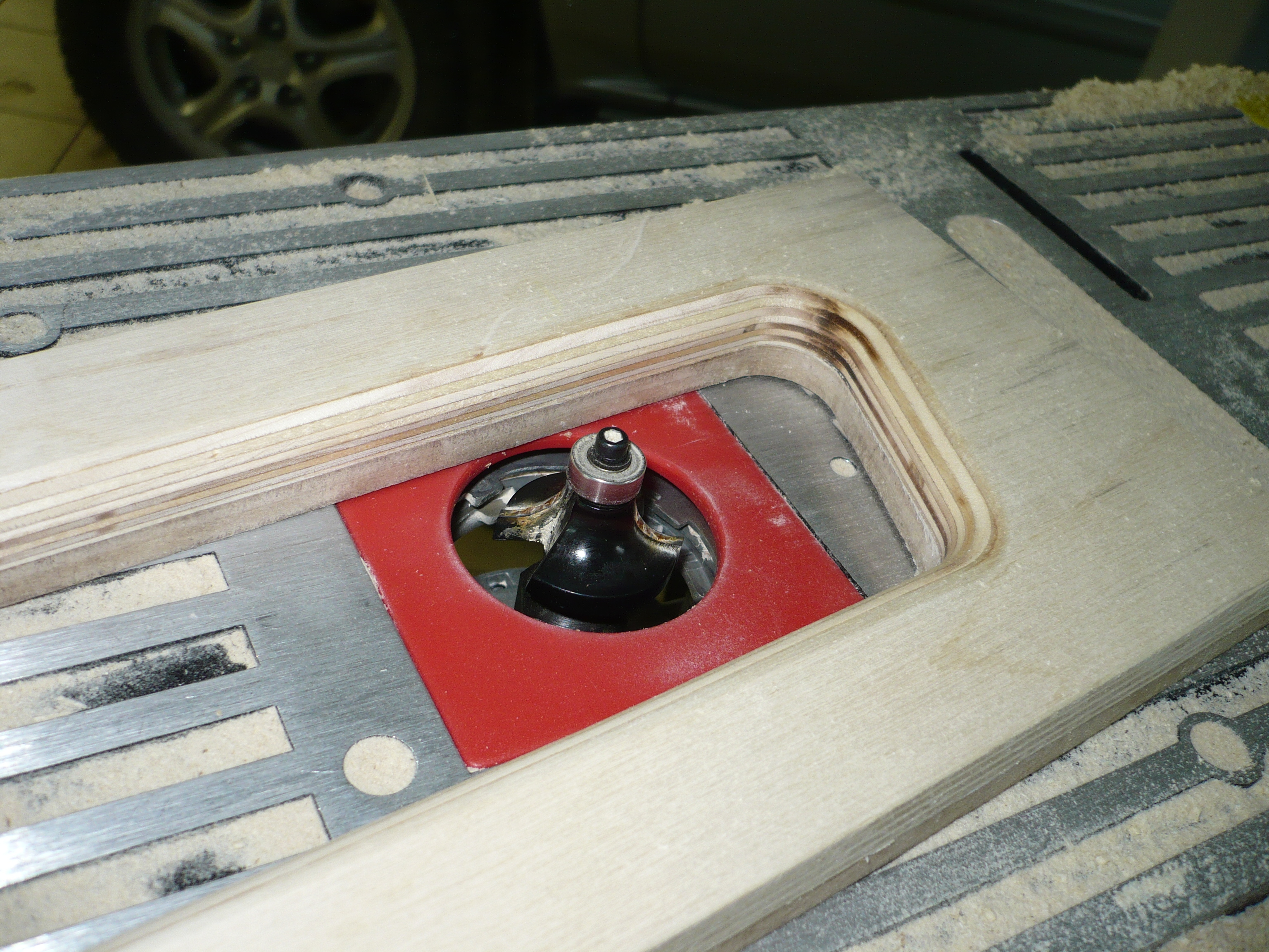

It's true, you don't need a workshop full of machine tools to do this. If you're serious about it though why not invest in a router and a straight bit and another radius bit for all your cabinet edges? All the routers I've bought came with a guide bush then all you need for a template is piece of MDF cut larger to accommodate the diameter of the guide bush. It can be a lot easier to set up than a table saw and the larger diameter blade incidentally, will shorten the cut on the blind side compared to a smaller diameter blade (think about it) but you can only lift the blade so high in the table and you will always have to account for the long (bottom) side of the cut. Table saws work well when cutting finger joints (where the edge of the cut is made by the top of the blade) when the piece is clamped to the vertical at the back of the sled like in the first photo, where the first cut is being made. We have to make our own sleds though and that's another chapter! That second cut where the board is laid flat is always going to end up unevenly cut though. If you're covering with tolex, it's no big deal because you can fill any dings with epoxy and with pine, you will probably end up needing to do that anyway. Those hole saws are not really meant for fine woodworking though, they are basically a circular saw blade and like a saw they have a kerf which can be wildly uneven from bit to bit - it might have 1" stamped on it, but you are unlikely to get a 1" diameter hole using one. They are ok for getting a hole started, but for more precise diameter holes you need the forstner bits which are more like circular chisels! Pay more for these, the cheap ones don't last five minutes.Phil_S wrote: ↑Mon May 24, 2021 1:09 pm ChopSauce: hole saw is the correct name of that thing in English!

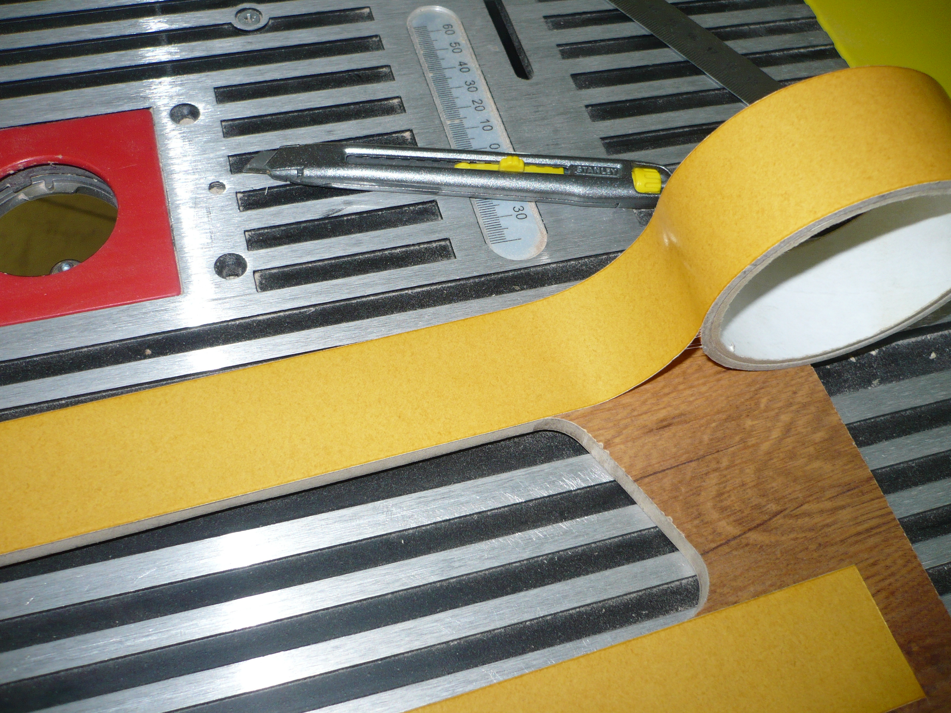

Thanks for the details. The copying bit should make for a cleaner round than the hole saw, for sure, but I wanted to do a larger diameter on my tweedish cab. Possibly I've been using a Forstner bit on the shown Voxish, but I don't remember for sure.
So, double sided tape is strong enough to maintain the template... I wouldn't have trusted it...

Yup, this is how I do it. I've done it with a router table before but lately i've been doing it with a Bosch Palm Router....easy peasy.

Re: Proper way to do chassis cutout?
In some cases, too strong - it can pull out the grain of softer woods; and or leave a glue residue on the wood which is harder to remove. You might also try masking tape and superglue. Masking tape on one piece, masking tape on the other, superglue between. A low tack tape over a larger area is perfectly adequate for running a router around.ChopSauce wrote: ↑Thu May 27, 2021 7:22 am Thanks for the details. The copying bit should make for a cleaner round than the hole saw, for sure, but I wanted to do a larger diameter on my tweedish cab. Possibly I've been using a Forstner bit on the shown Voxish, but I don't remember for sure.
So, double sided tape is strong enough to maintain the template... I wouldn't have trusted it...![]()
