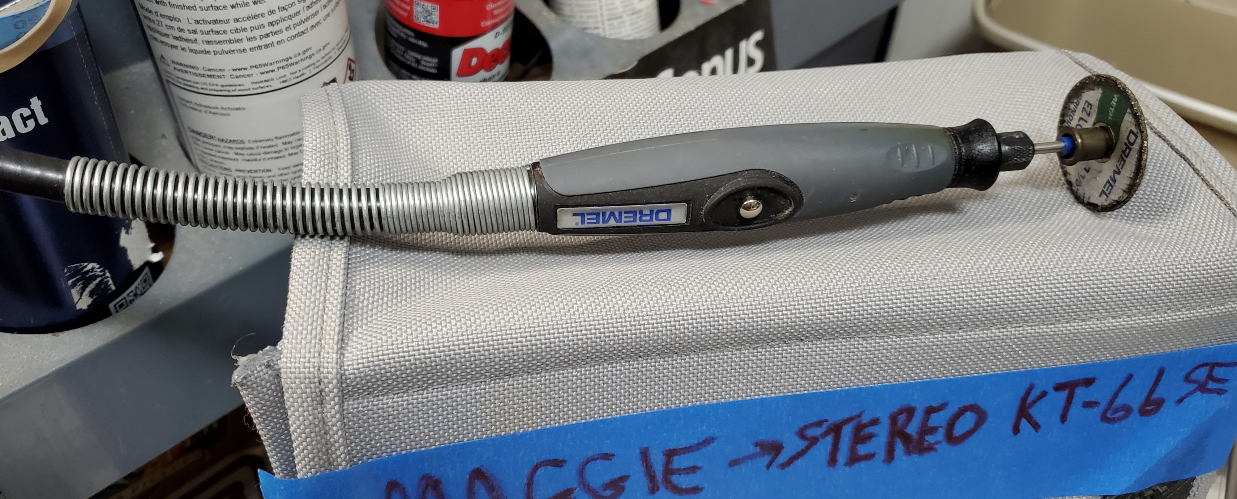

I either drill the corners and insert a coping saw with a meal blade, or Dremel with a cutoff wheel. But I use aluminum chassis. With thick steel, I'd find a water jet or laser service. Short of that, your biggest chassis punch, then file work till your hands cramp and bleed.

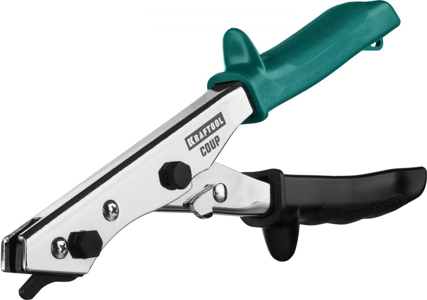

alkuz1961
Posts: 179
Re: Make large rectangle holes in 1.6mm steel chassis?
Post by alkuz1961 »
Of course, metal with a thickness of 1.6 mm is quite difficult to process, but for a slightly thinner metal, such a tool is very convenient
this cuts very smoothly, without deforming the edges and allows you to make a curly line

alkuz1961
Posts: 179
Post by alkuz1961 »
ChopSauce wrote: Sat Mar 27, 2021 8:05 pm How thick a sheet of mild steel / aluminum can you cut with it?
ChopSauce
Posts: 1045
Location: So Paris, France
Post by ChopSauce »
alkuz1961 wrote: Sun Mar 28, 2021 11:43 am
Oh yes, thanks. I own one of these. The tool posted by thetragichero, however, seems more capable, but how much?
Short of a proper punch or laser cutting, none of these methods will be 100% perfect. You don't need perfect, but you should temper your expectations. For 1.6mm steel, I think I'd go for Dremel with a cut off wheel, and cut just shy of the cut line. Then finish with a file. Drilling the corners is a good idea. I think I'd allow 30-60 minutes so to do this. It's best not to hurry.
