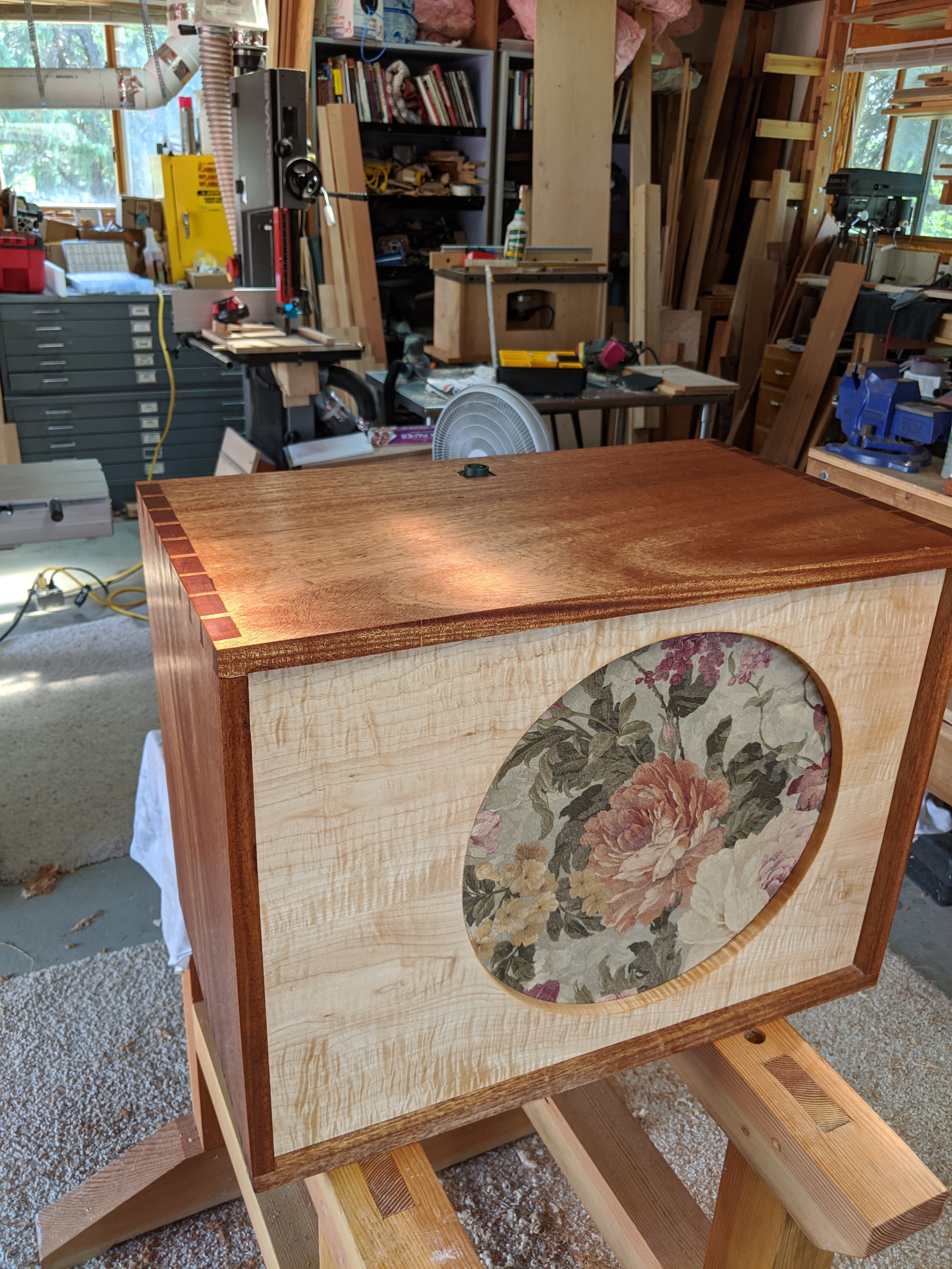

There's nothing particularly magical about grill cloth for guitar cabs. Since it's a woofer output, you don't need anything "audio transparent" ie: expensive or exotic, just pretty and durable. I've built two speaker cab baffles out of JoAnn fabrics "brocade" material. You want the upholstery fabric section.
I really like the look of "This fabric crawled off my couch" look, especially with enough flamed maple and sapele to make it stand out. I actually bought a bunch of that material like 20 years ago, couldn't find enough to do another cabinet after my main stash went to recover my dining room chairs and then went on a long quest to find a fabric remnant after they stopped making it. I bought this bunch off Etsy. Since you don't need much, etsy is a really good source for fabric remnants. They have more than you can possibly sort through. You only need a couple "yards" to last you a lifetime of DIY speaker building and you have the upside that all your cabs will kind of match.
Fun note: I get really funny looks wandering around a fabric store by myself unaccompanied, but then I'm secure enough in my manliness street cred that I also play a shell pink strat, so /shruggie.

Nice workshop... 8)

>Nice workshop... 8)
Thanks. I do a combo of handtools and power machinery, although my original background is in EE. It's an ever ever-evolving mess. I originally got into woodworking trying to build cabinets for my original twin/plexi mashup. Funnily I have two daughters and I really really want to make sure they feel welcome and valued in the guitar and maker spaces.
