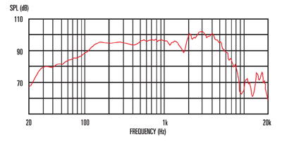

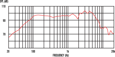

The response curve of the G10N-40 shows a knee at around 30Hz
by comparison with the response of the G10 Creamback
G10 Creamback.gif (13.23 KiB) Viewed 5209 times
which - I guess :?: - is unlikely to produce the "chime" I'm after.

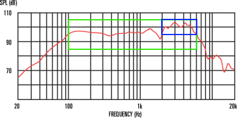

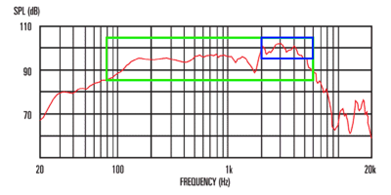

Typical frequency curves are meant for Hi Fi speakers (we are a TINY market by comparison) so show full Hi Fi range: 20Hz to20kHz, which might be confusing.
Guitar range is WAY narrower, from 80Hz to, say, 5 kHz, 6kHz tops, solet´s focus on that.
I edited your graphs to show so.
1) area within Green rectangle shows relevant frequencies and also relevant SPL,anything below 90 dB (I show down to 85 just for completeness) will not be heard under stage or even garage rehearsal conditions, it will be *masked* by ambient noise (cough cough "drummer" cough cough ;) )
2) chime area is roughly within the blue rectangle, so compare same areas in both curves.
3) Creamback (which itself is a variation of Greenback) consistently outperforms Silver at most any frequency, even in the Chime area.
Which is not surprising, and it´s a more expensive speaker too.
Being more efficient all over the range also means it´s better suited for a low power amp such as AC4 in most situations
First Creamback, then Silver:

Thank you very much for these insights. I must have been confusing the lack of response close to 100Hz and the chime, does it seem.
It's really difficult to learn sound related terms through the computer, but the point is I haven't been disapointed by the silver. It is just how I expected.
However, I feel it already is too powerfull for the small AC4 and its fragile EF86.
