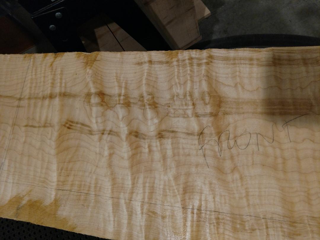

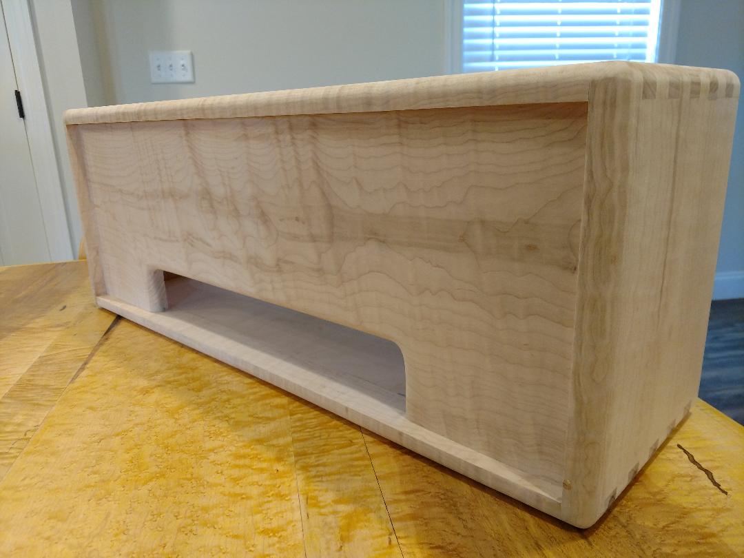

I've played with this idea for over a year wanting to wrap / morph / stylize a dragon on a cab for a 1959. The last insanity was having a dragon claw bursting from the curly maple top and possessively scratching the face plate. I've done some pretty wild things with wood but that's a bridge too far. So scaling back to curly maple case, walnut piping a carved Marshall logo - I'm thinking black - with a two tone dye job. Scarlet sanded back topped with orange and a spray sealer. The scratched face plate is still a go as I plan to build a dragon claw with curly maple and ebony talons to sit on top. This way the thing - minus the claw - will fit in a flight case for shows.

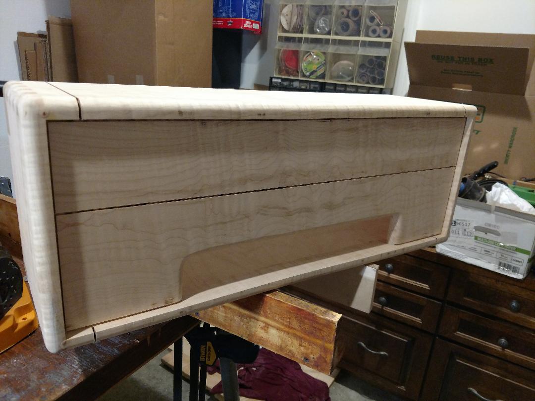

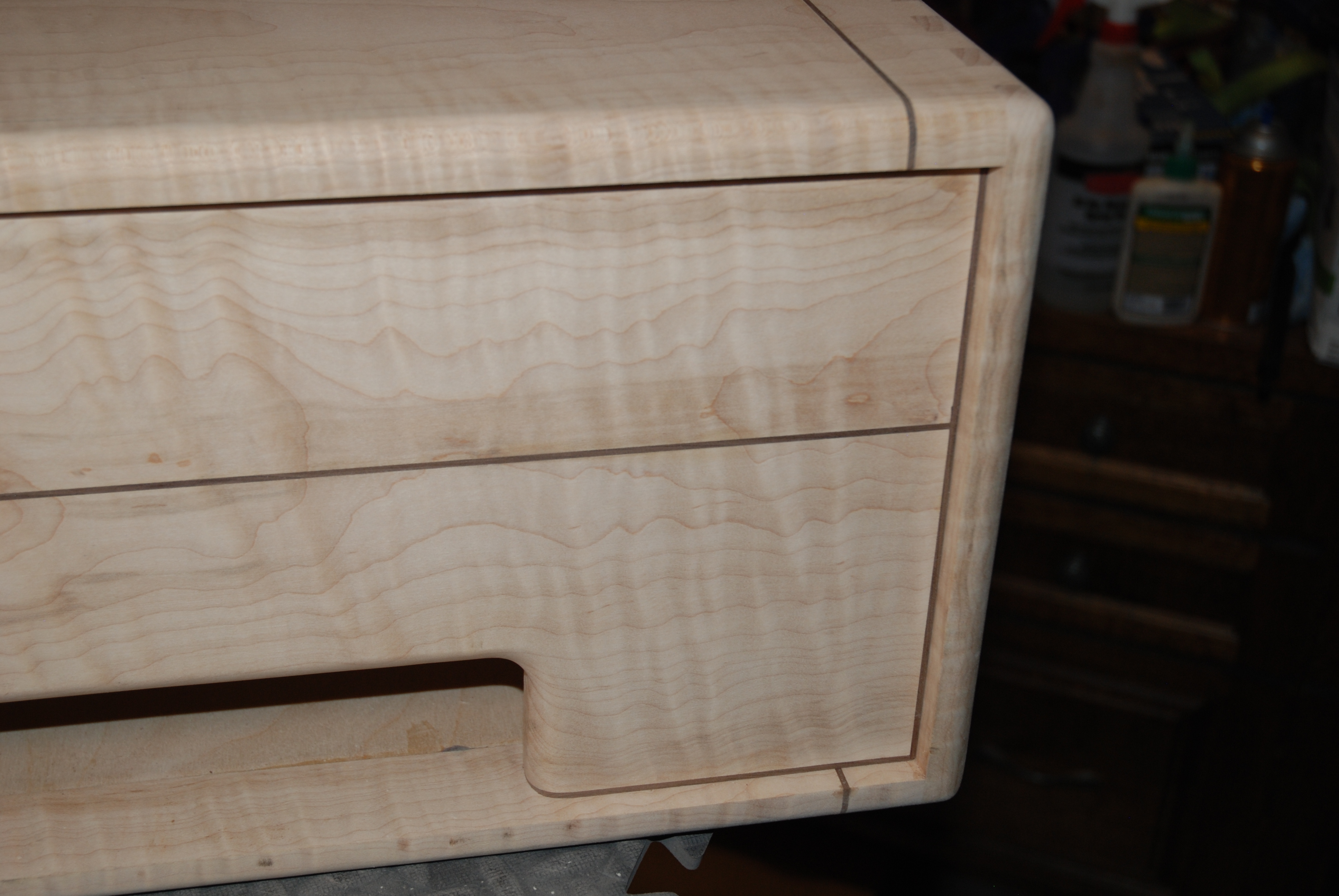

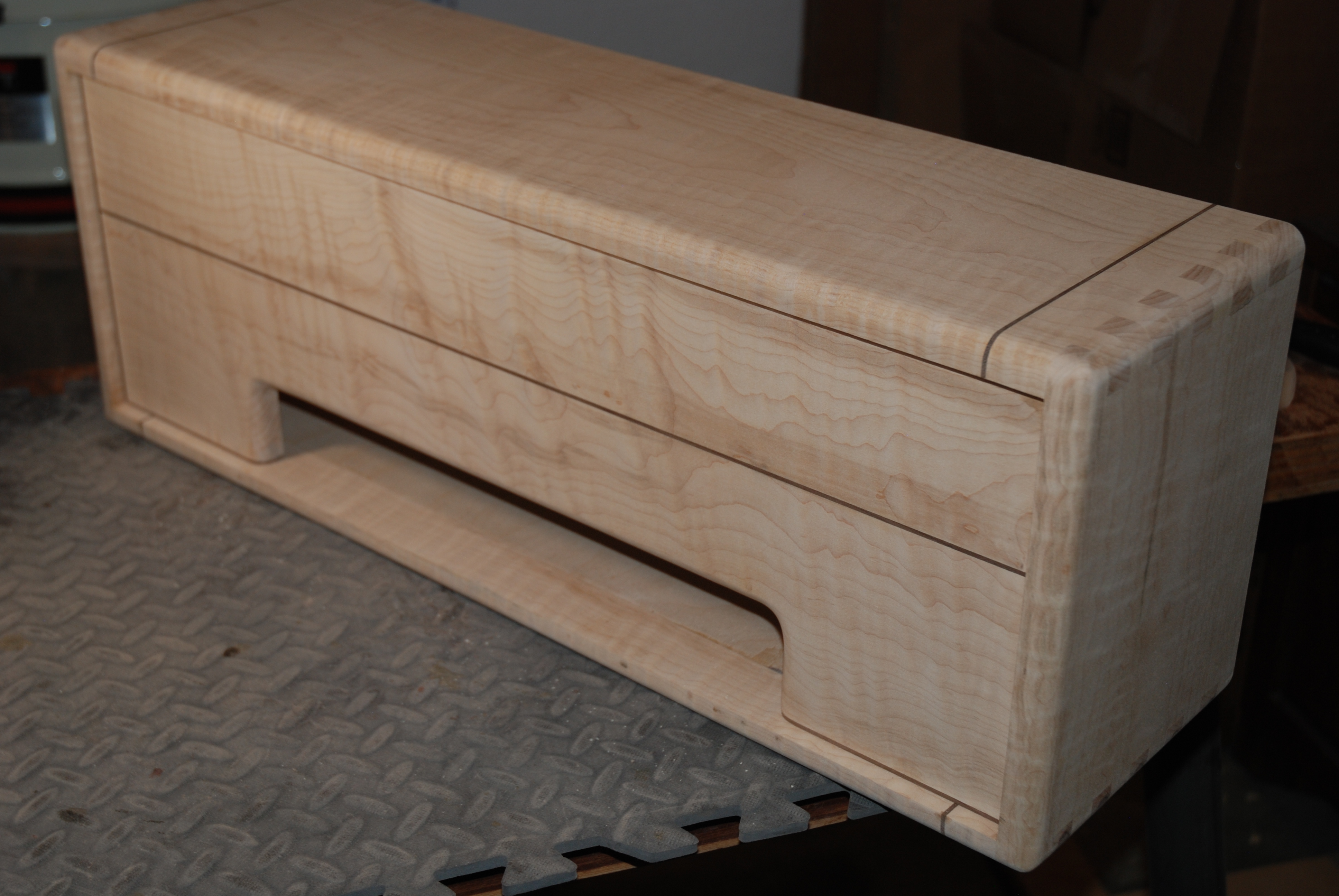

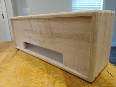

I've got it put together

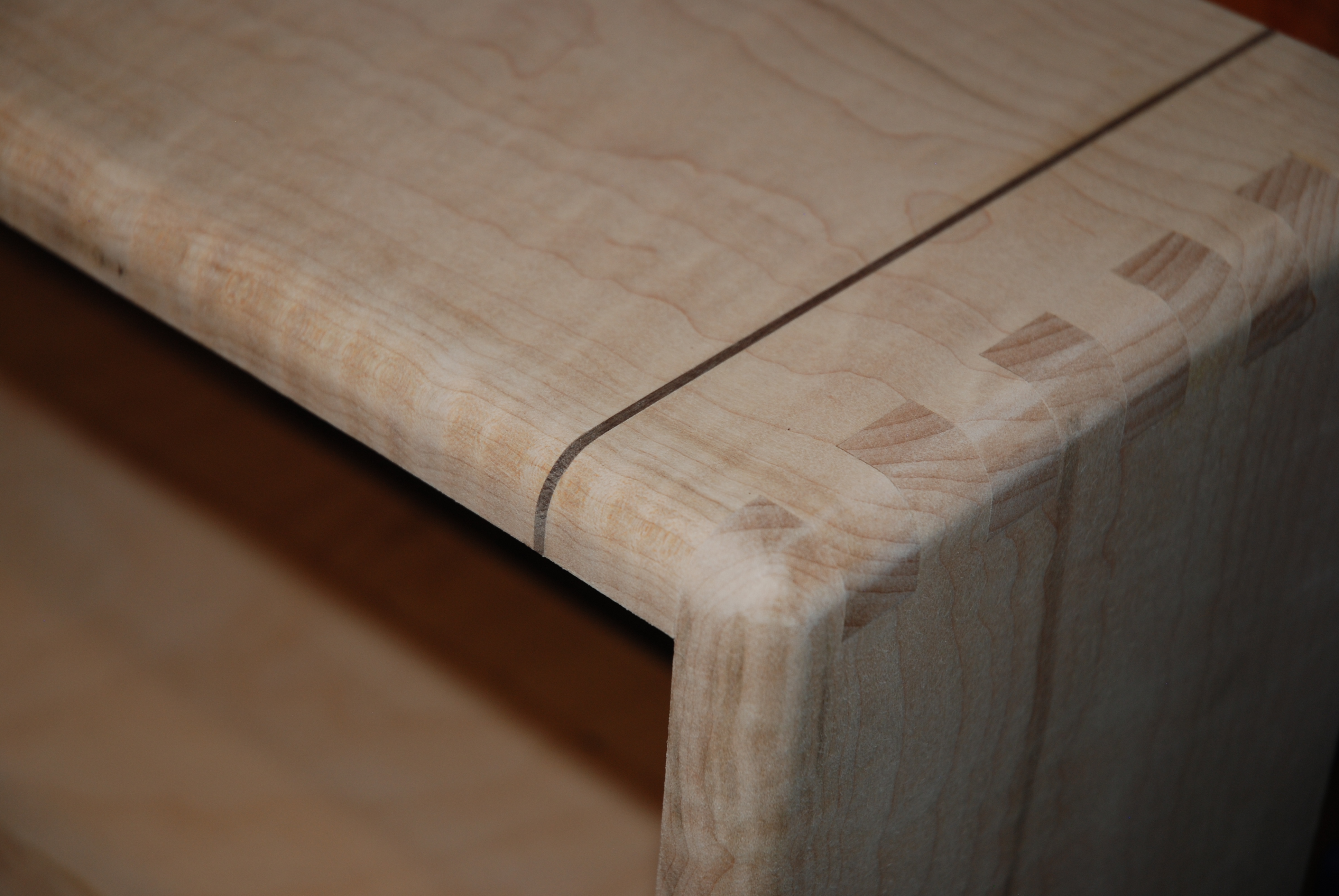

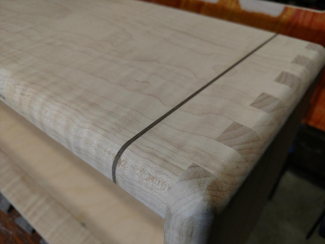

Am working on the piping cuts all done with my trusty table saw

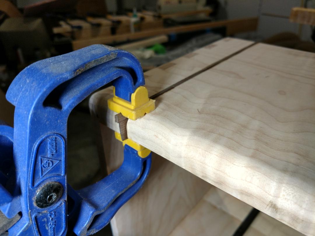

Gluing in the walnut piping

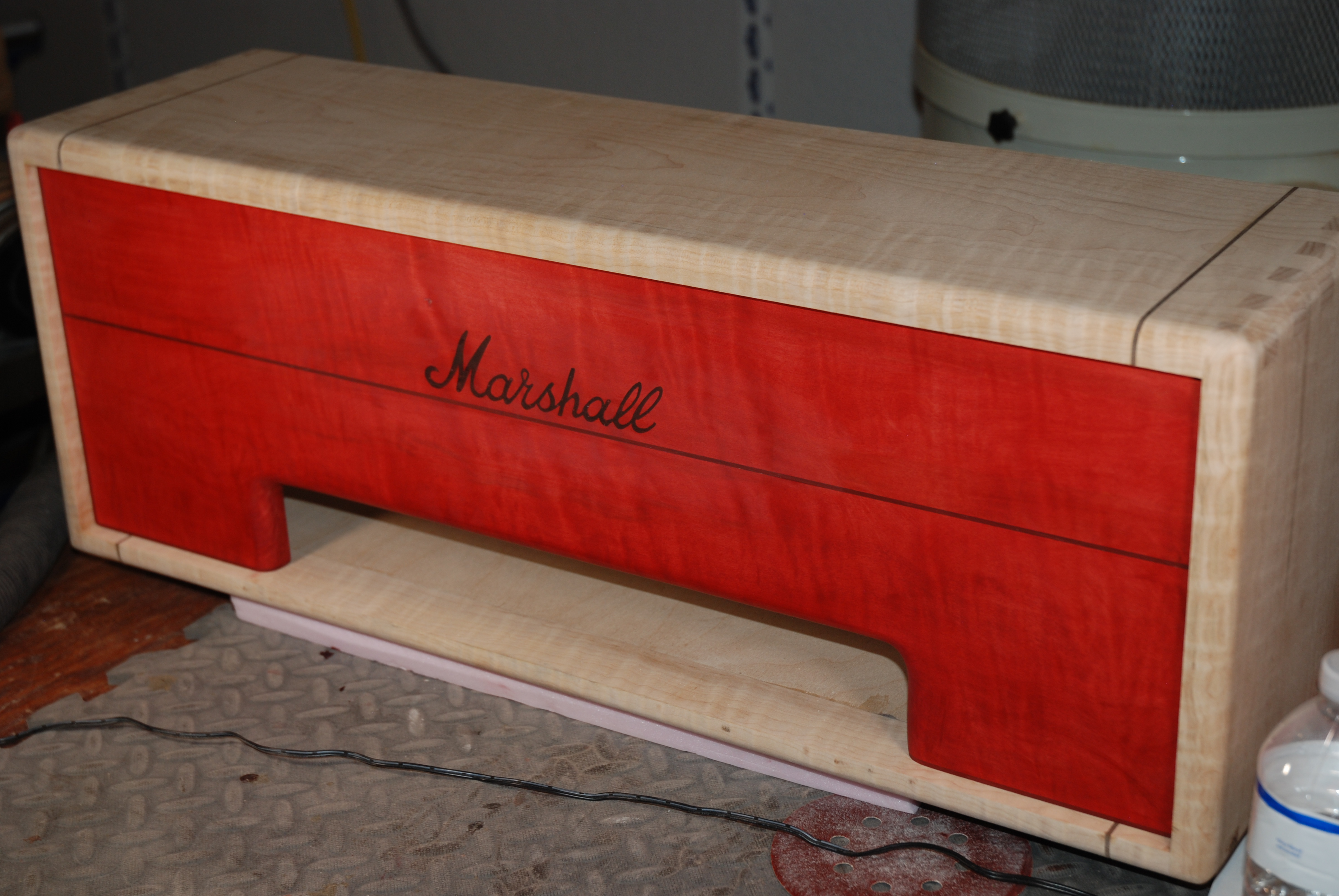

I'm off to finish adding the piping to the face plate.
Re: Head shell for 1959

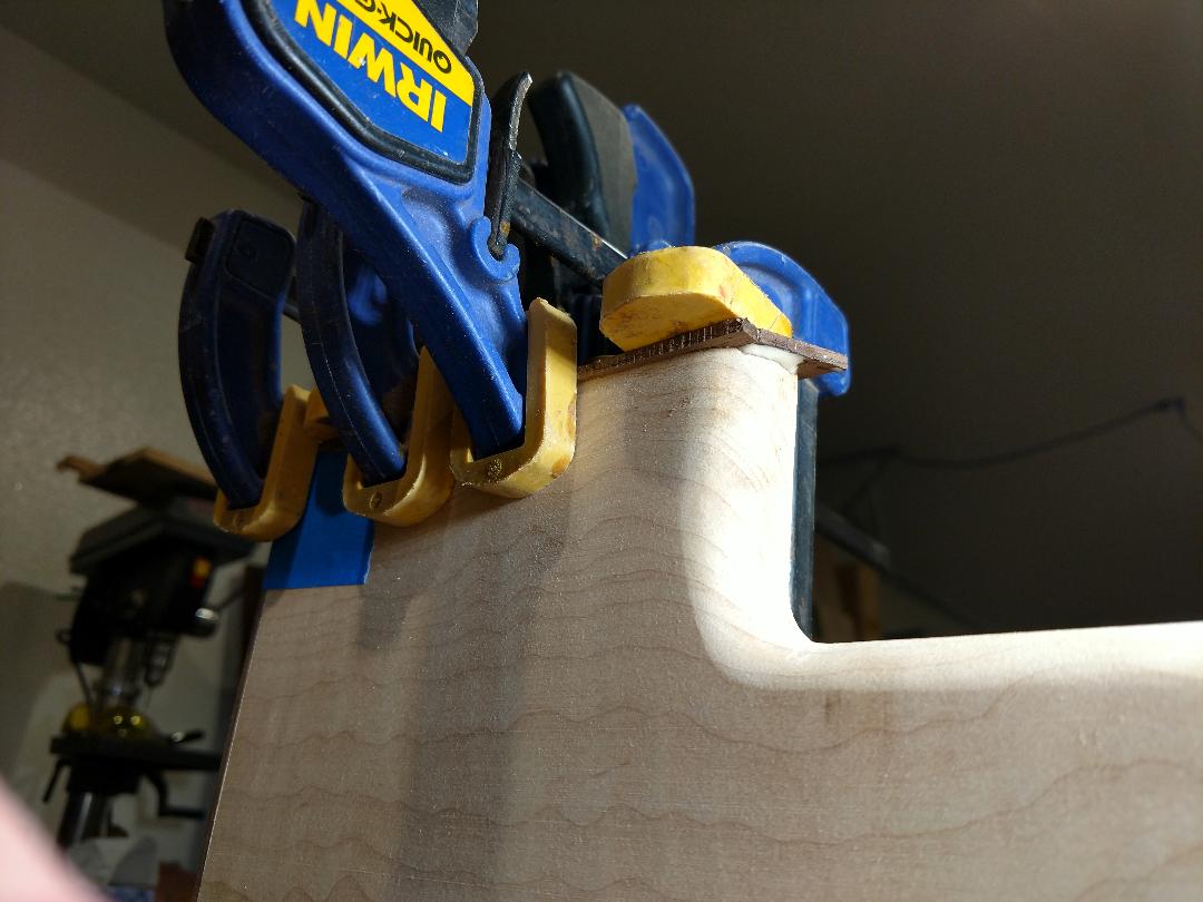

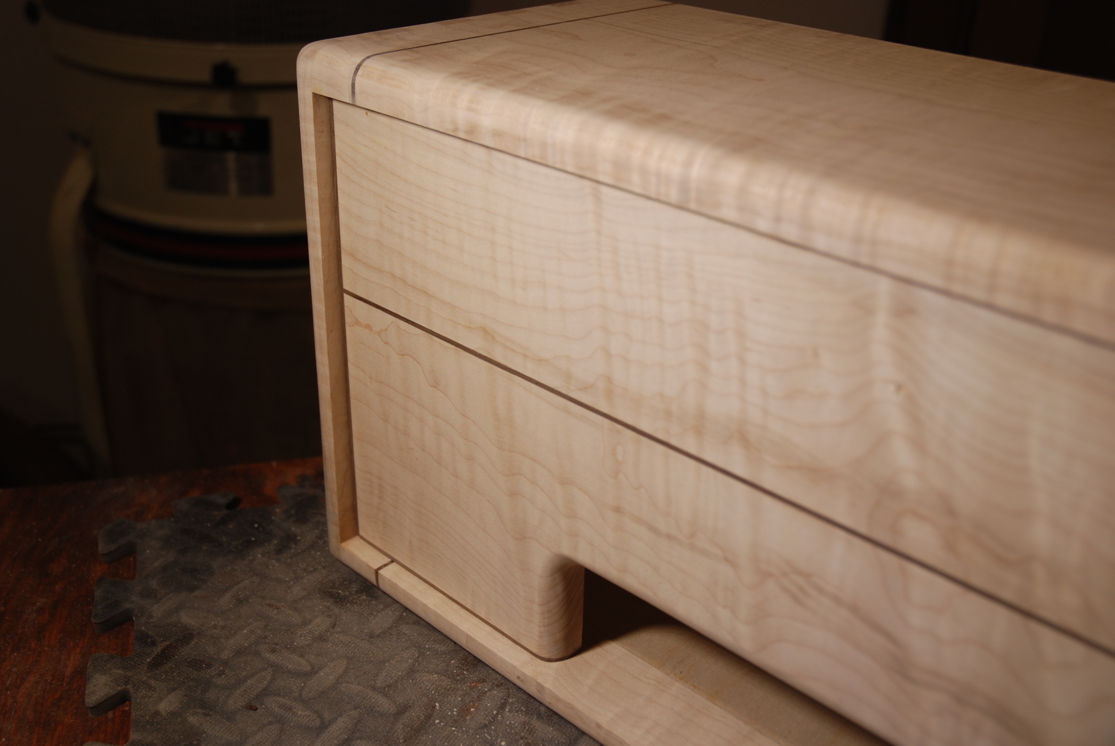

Bottom piping bits are glued in - had to do a big relief cut to make the 'wrap around' work.
Rough sanding to shape on the top piping.
Logo carving starts tomorrow.

Piping dry and gaps filled with CA and an accelerant.

Fantastic work! Nice piece of wood and the walnut "piping" really sets it off. 8) Flawless box joints! Did you use a stacked dado blade to make those?
statorvane wrote: Sun Jul 14, 2019 1:57 am Fantastic work! Nice piece of wood and the walnut "piping" really sets it off. 8) Flawless box joints! Did you use a stacked dado blade to make those?
Yes I used a Freud carbide set - even better than the Forrest I used for years. I can hold to .002" going across the plank.

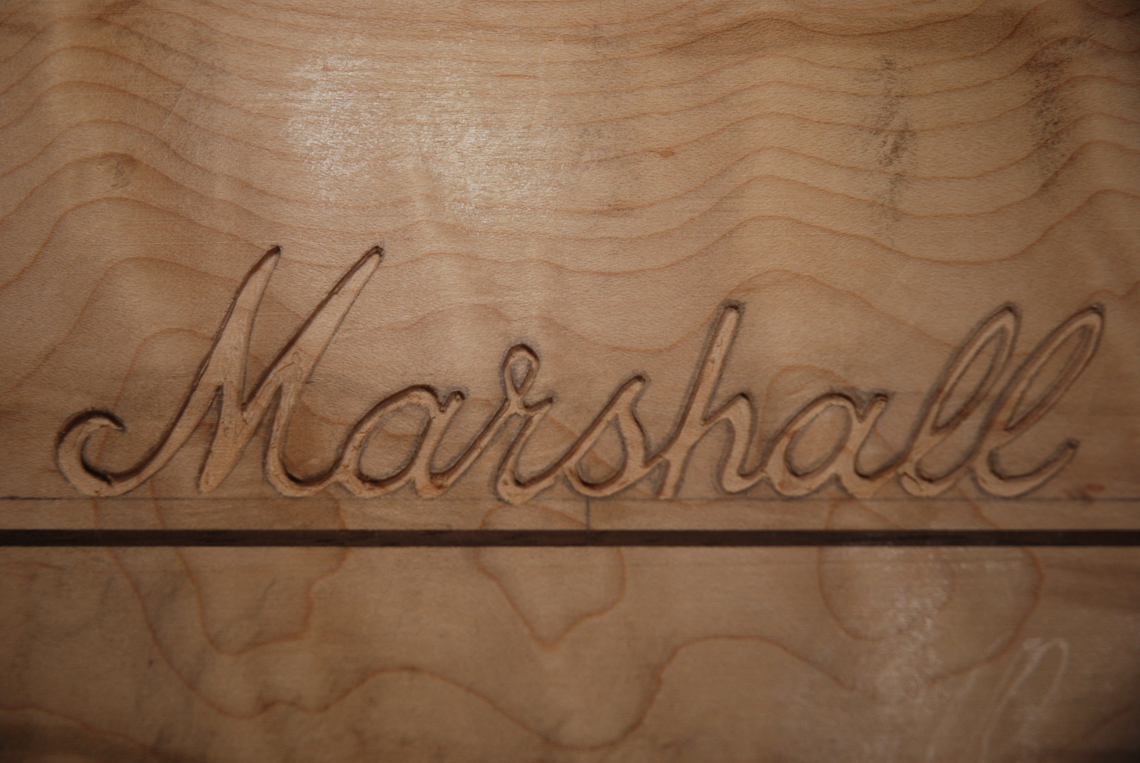

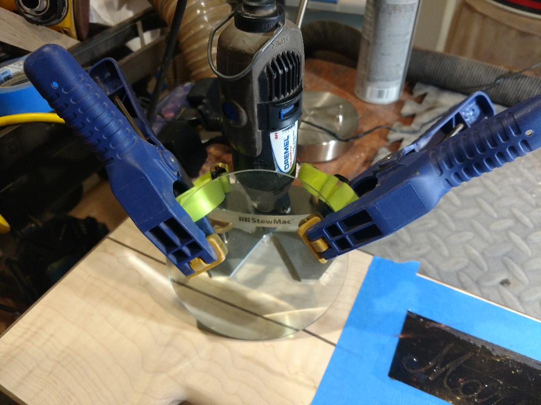

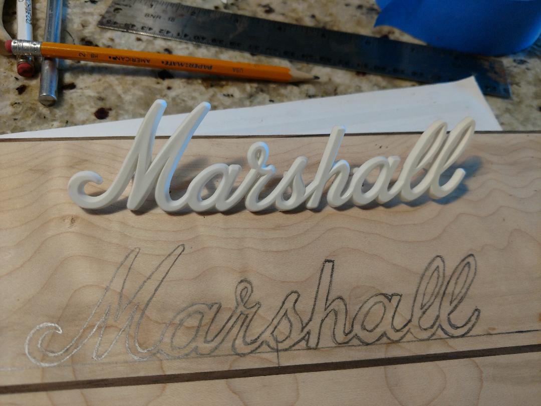

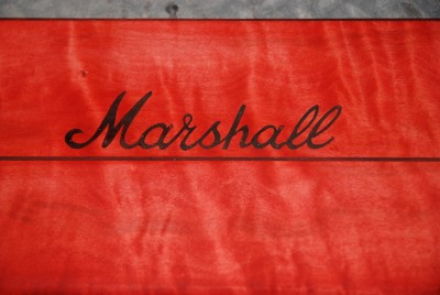

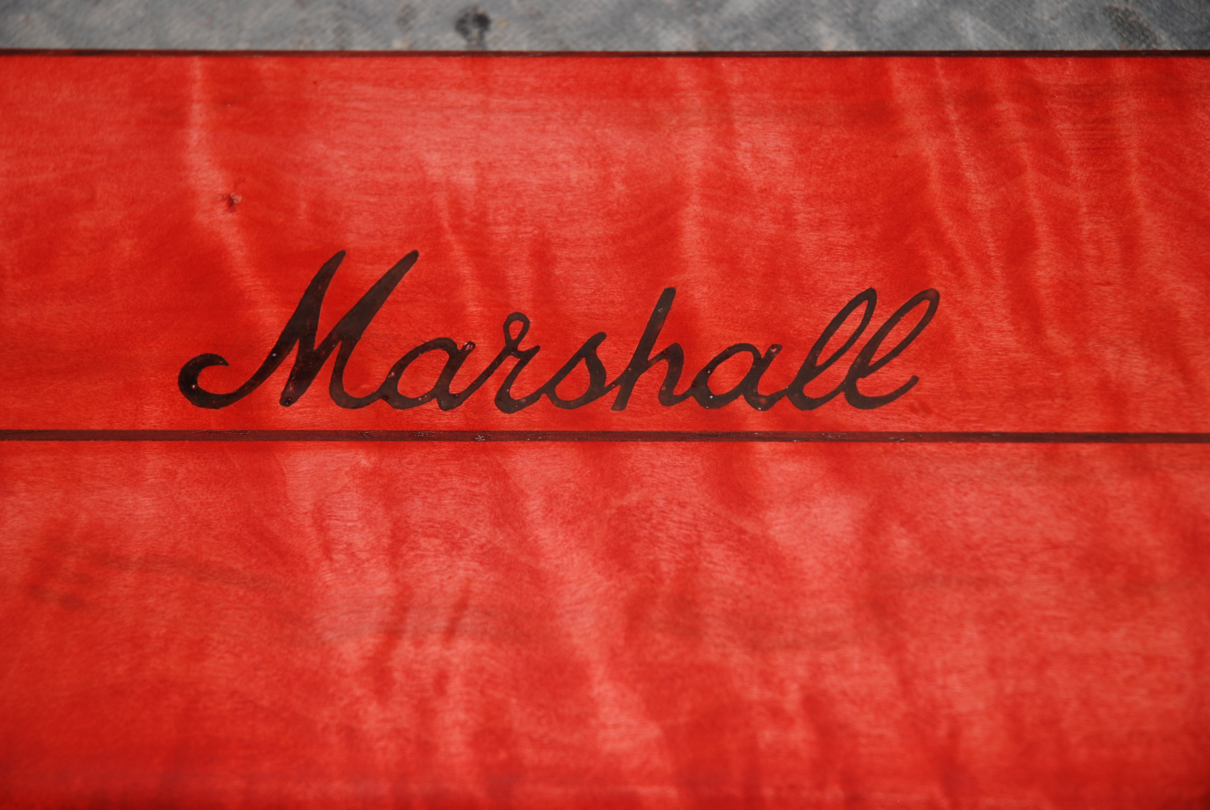

Working on the logo today.

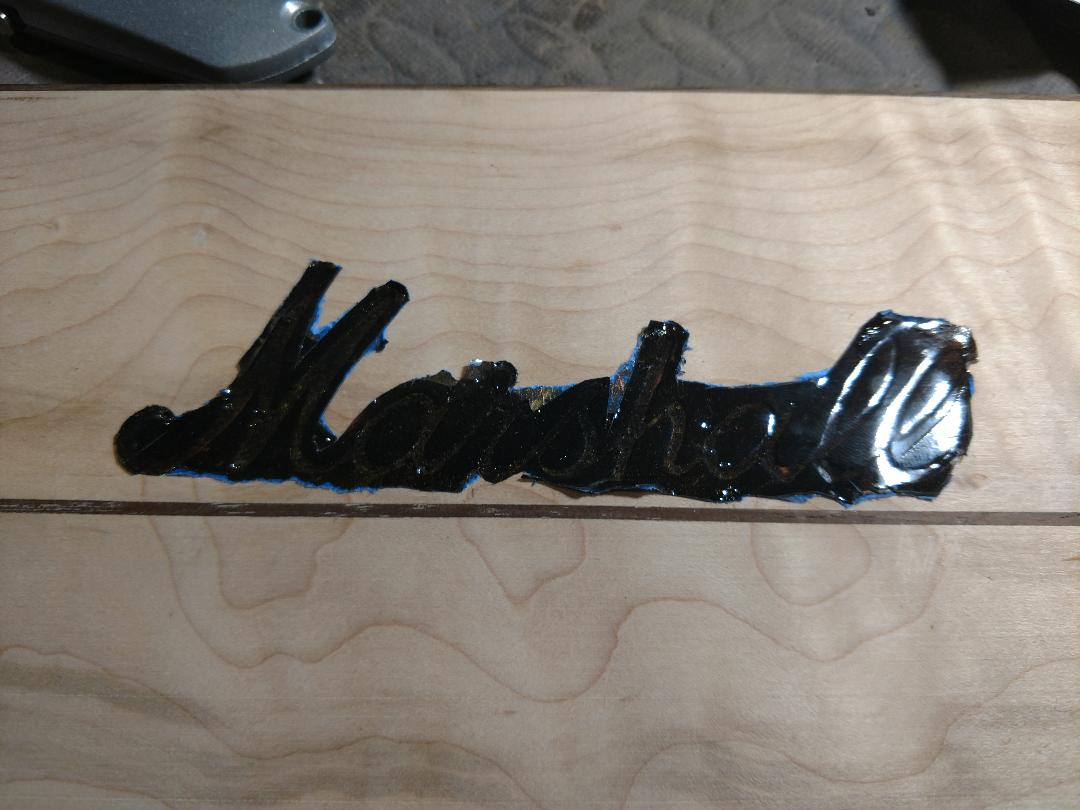

Cut with a dremel in a Stewmac router rig.
It is currently painted black and filled with epoxy.
My beloved 6" magnifying light decided to bite the big one and I needed a bit of eyeball assistance. After flailing about plotting to a fix the 5" lens to my head, clamps and guitar cable ties to the rescue. It's ugly but it saved me from dashing through the monsoon to a store to get another one.

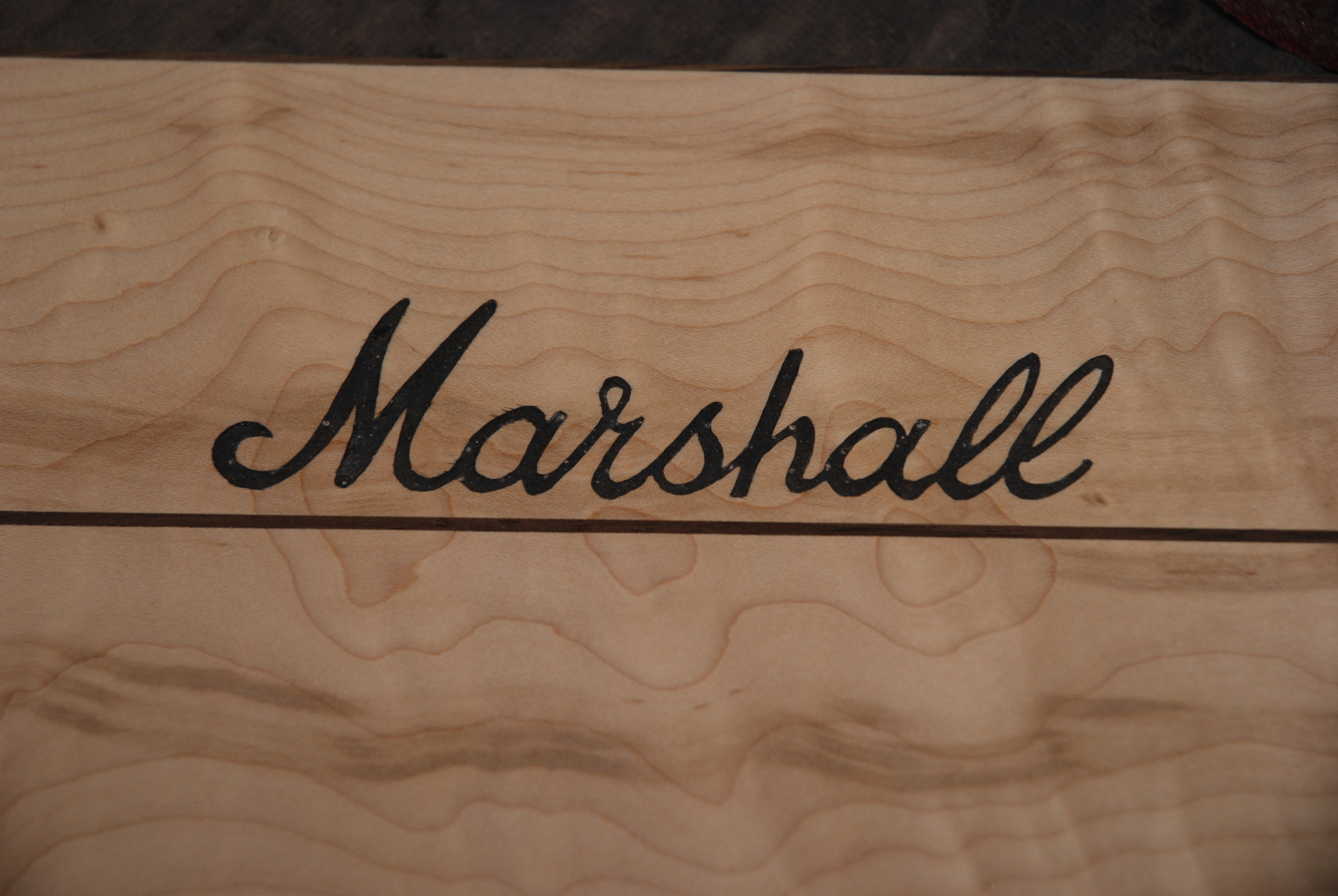

Here is the logo after tape off [to keep the black spray paint in the correct place], epoxy applied and while semi cured I pulled off most of the blue tape.
And sanded.
I filled most of the pin holes but I messed with the epoxy too much as I attempted to level it and created a pant load of bubbles.

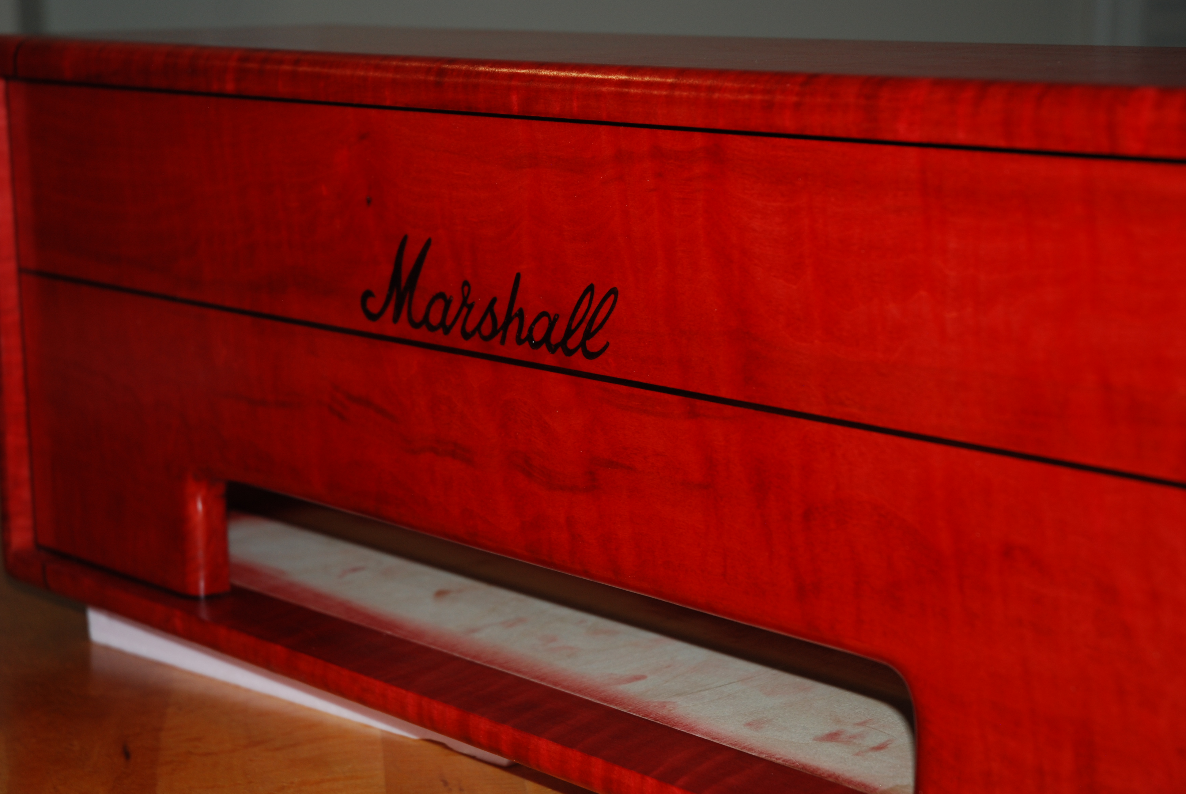

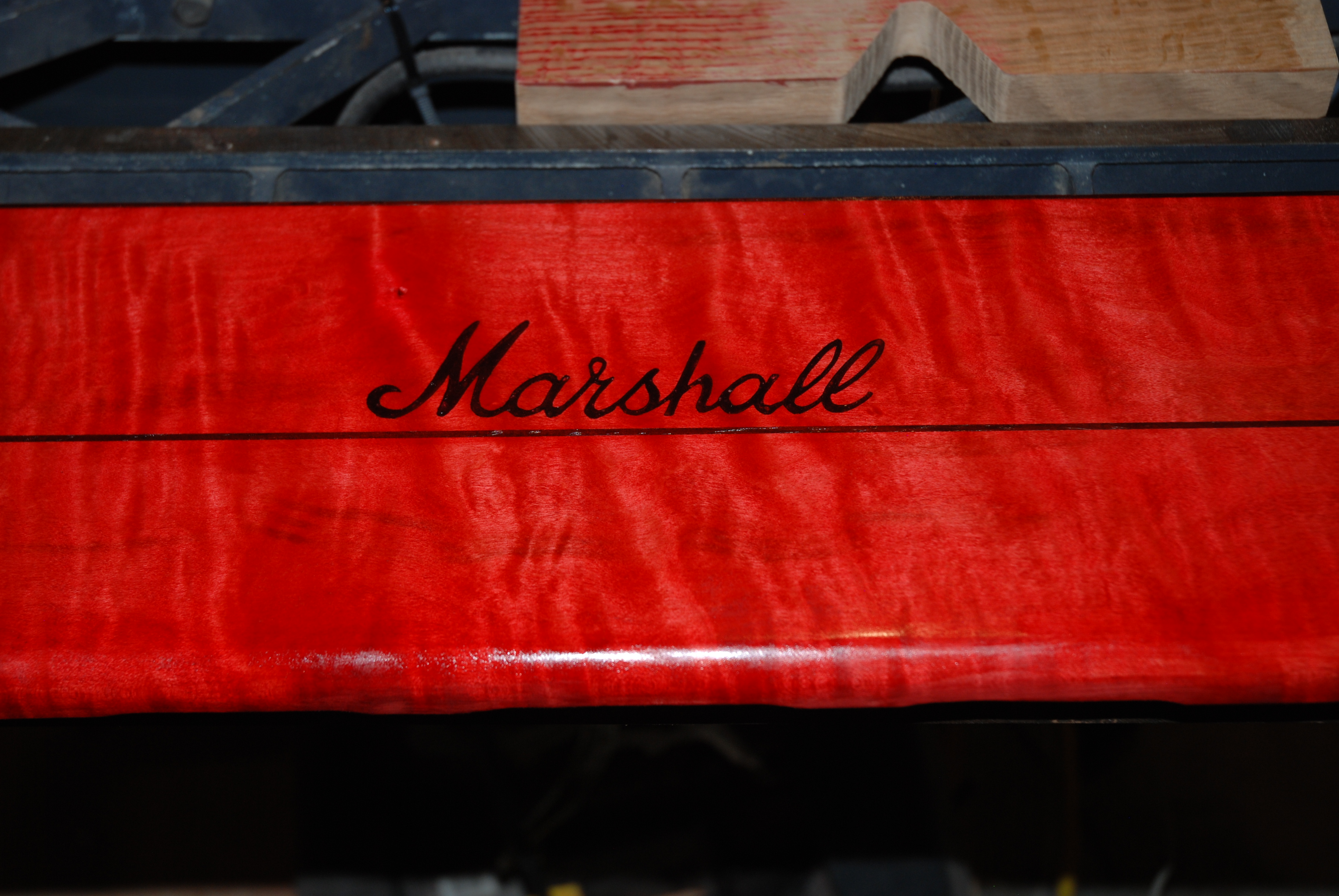

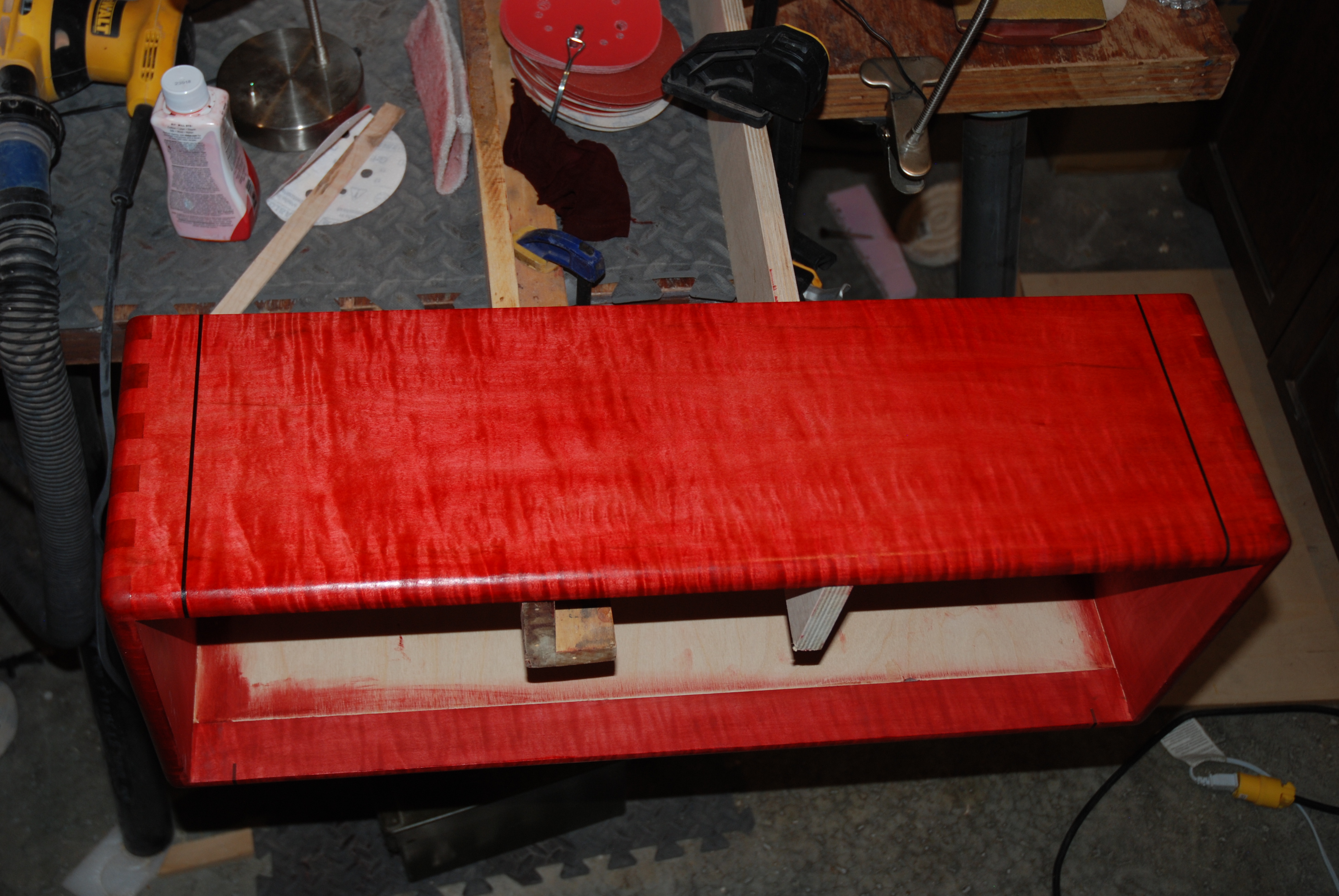

I sanded to 220 and applied the RIT scarlet dye. The original plan was a two tone with the scarlet sanded back and orange applied then sealed. It always struck me as over the top gaudy. Since I strive for subtle, understated and easily overlooked designs [who am I kidding?!?] I may just use the scarlet and then seal. A red head appeals to me.

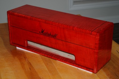

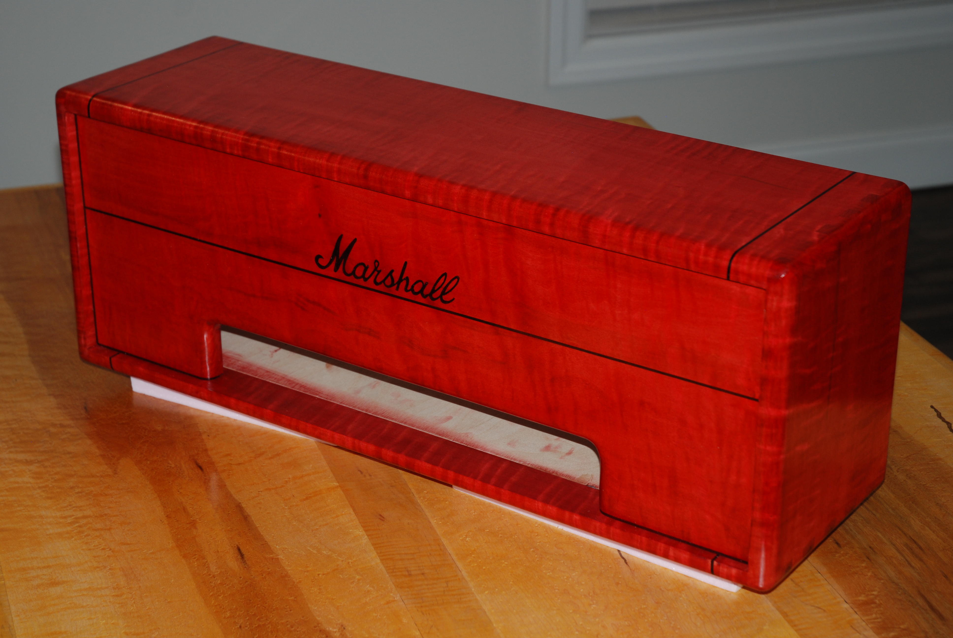

Assembled.

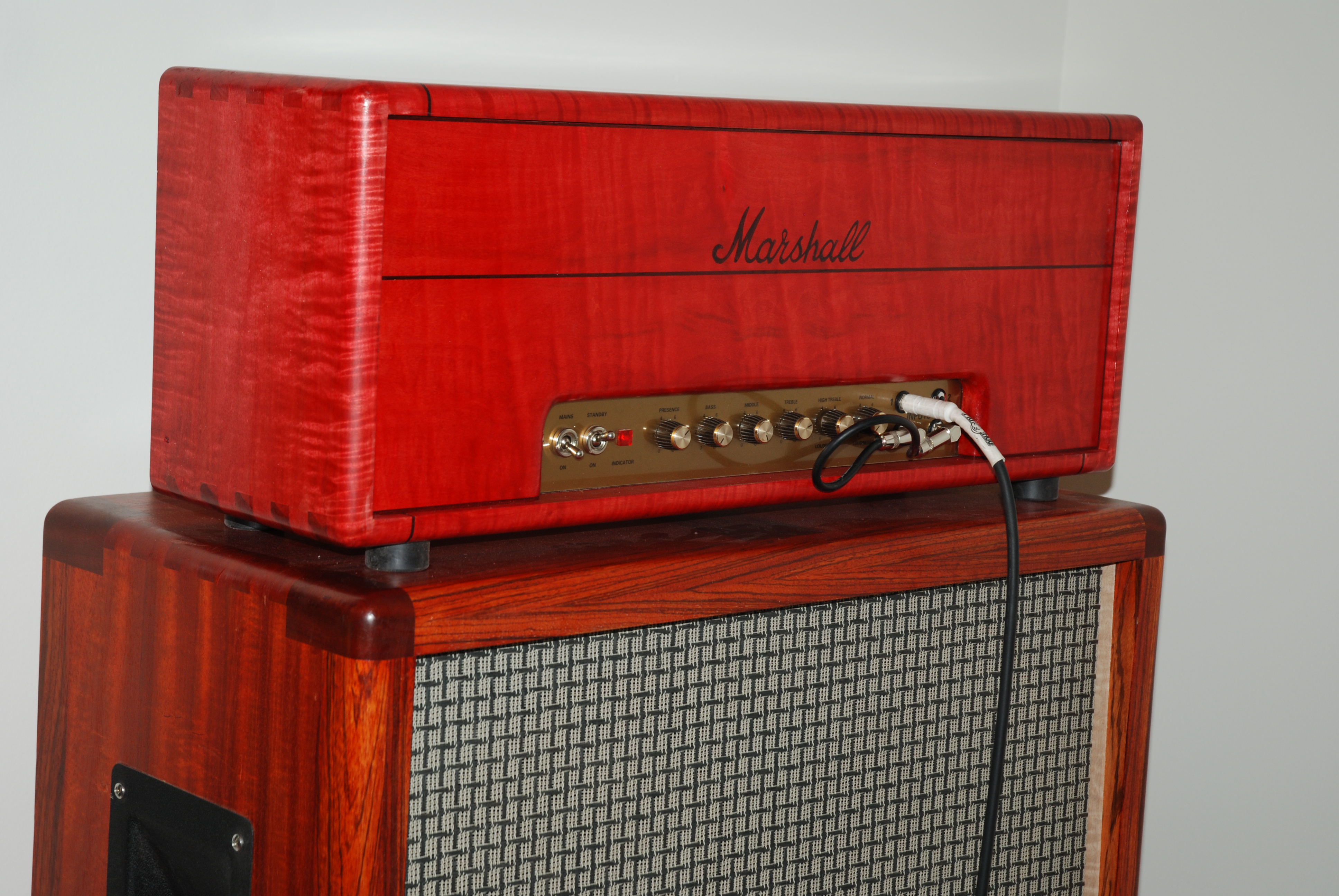

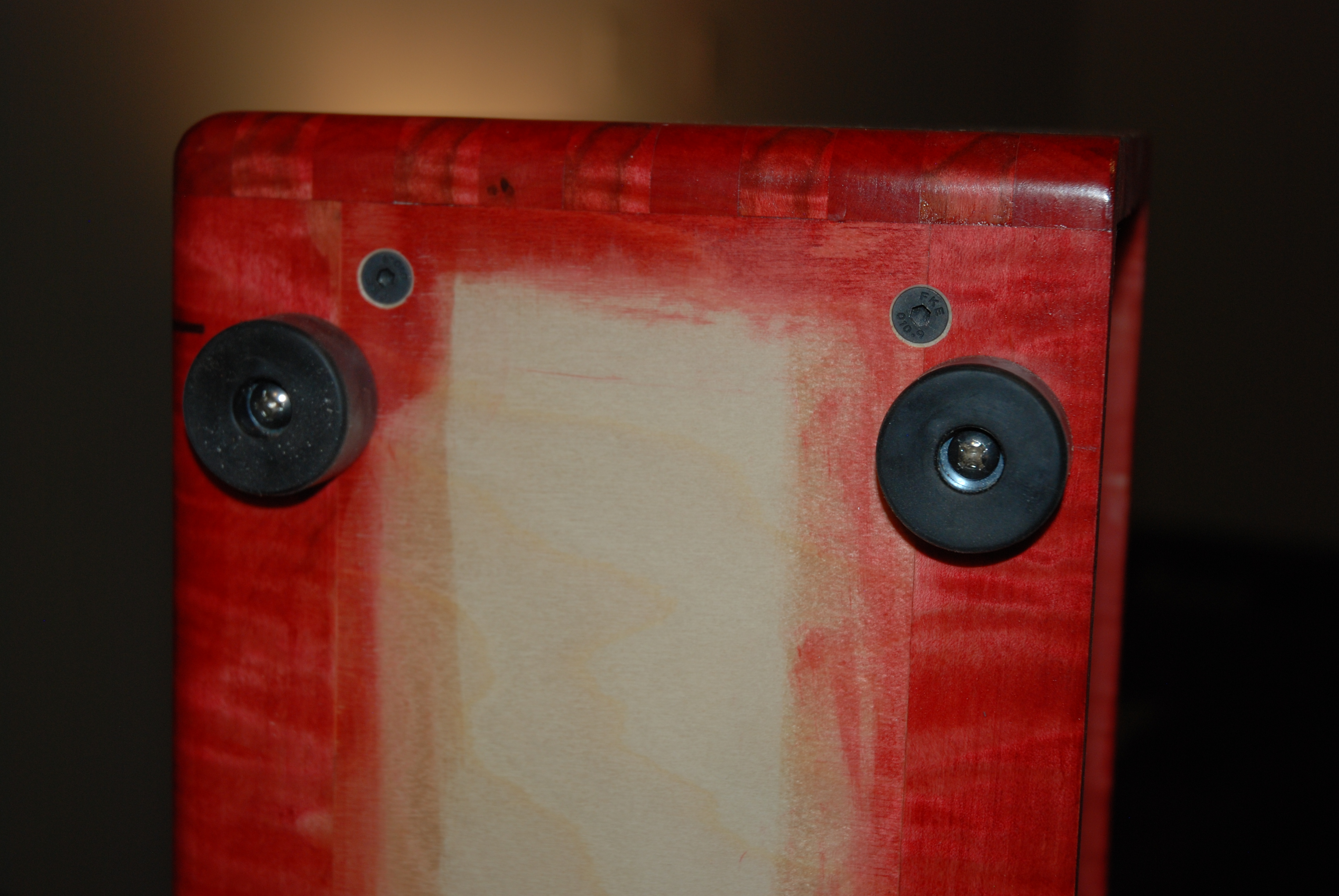

Under bits.
Superlead installed.
