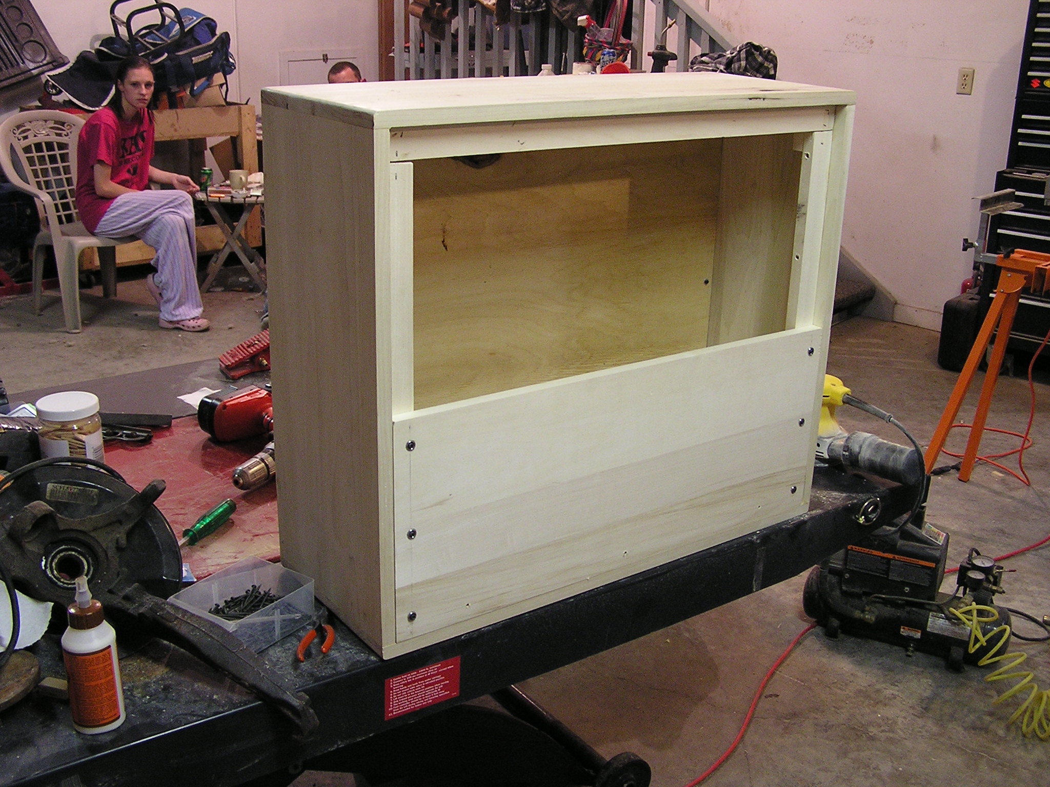

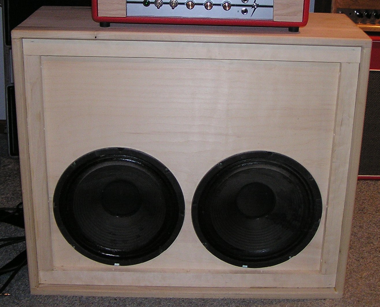

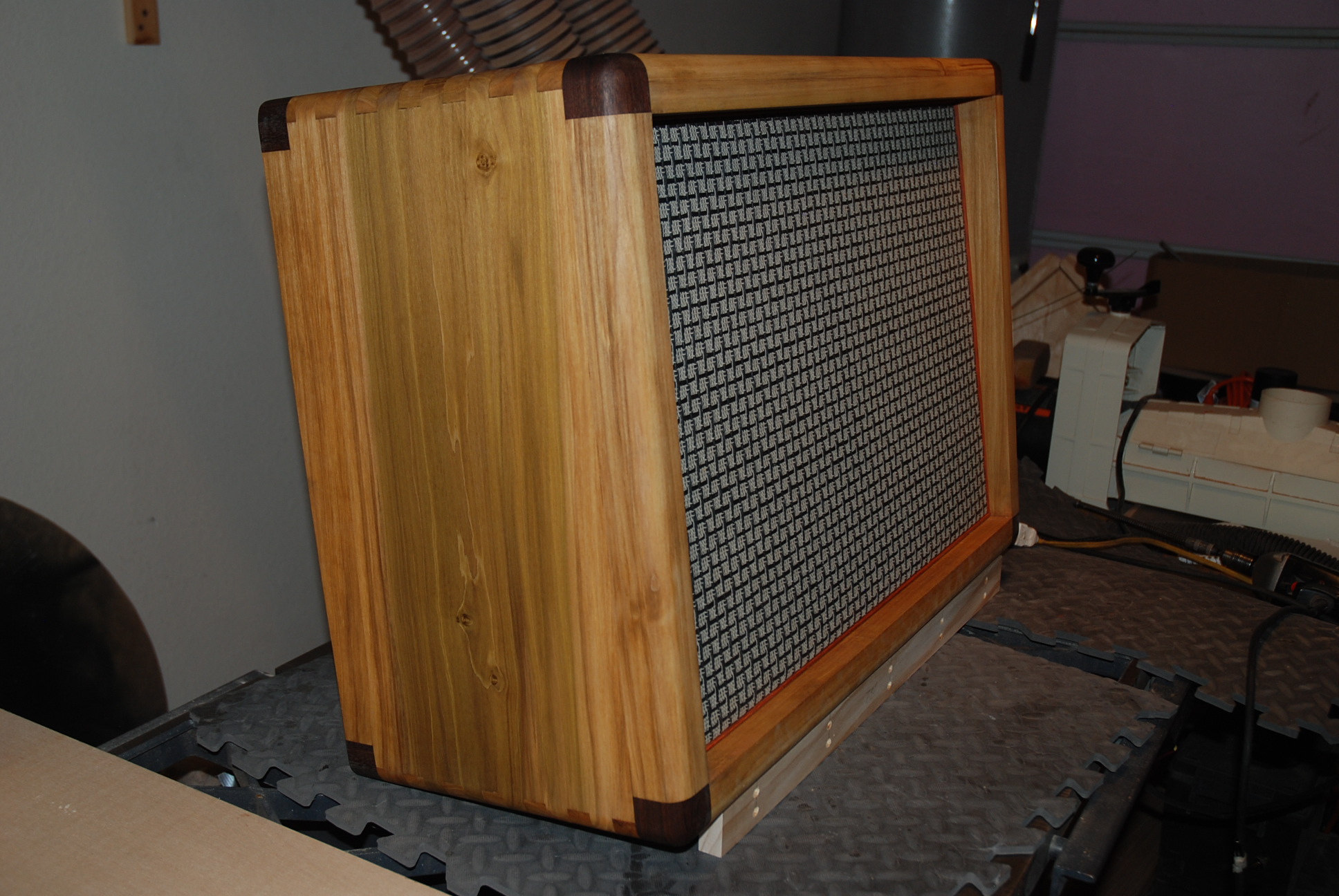

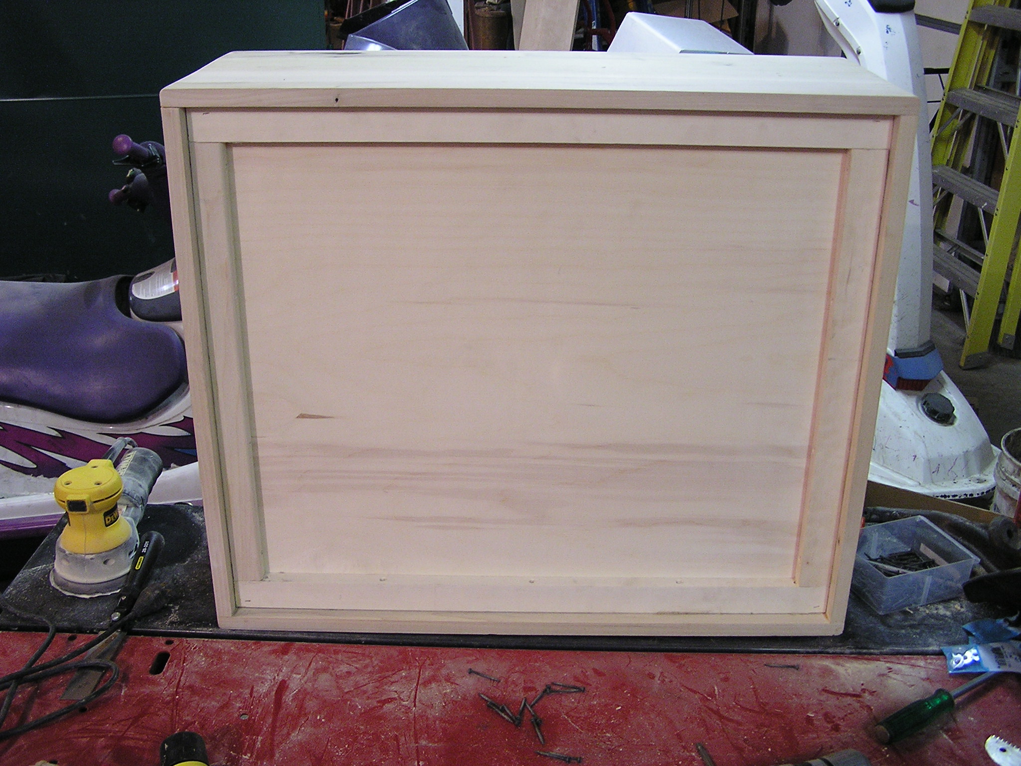

I'd use solid poplar - I've built several speaker cabs with it. If you use modern glues like Titebond II or III the joint will be stronger than the wood. If you plan to cover it use screws.

Hi Russ, you Cabinet looks stunning. Bear in mind this project will be for a head cabinet and hence no tonal effect.
