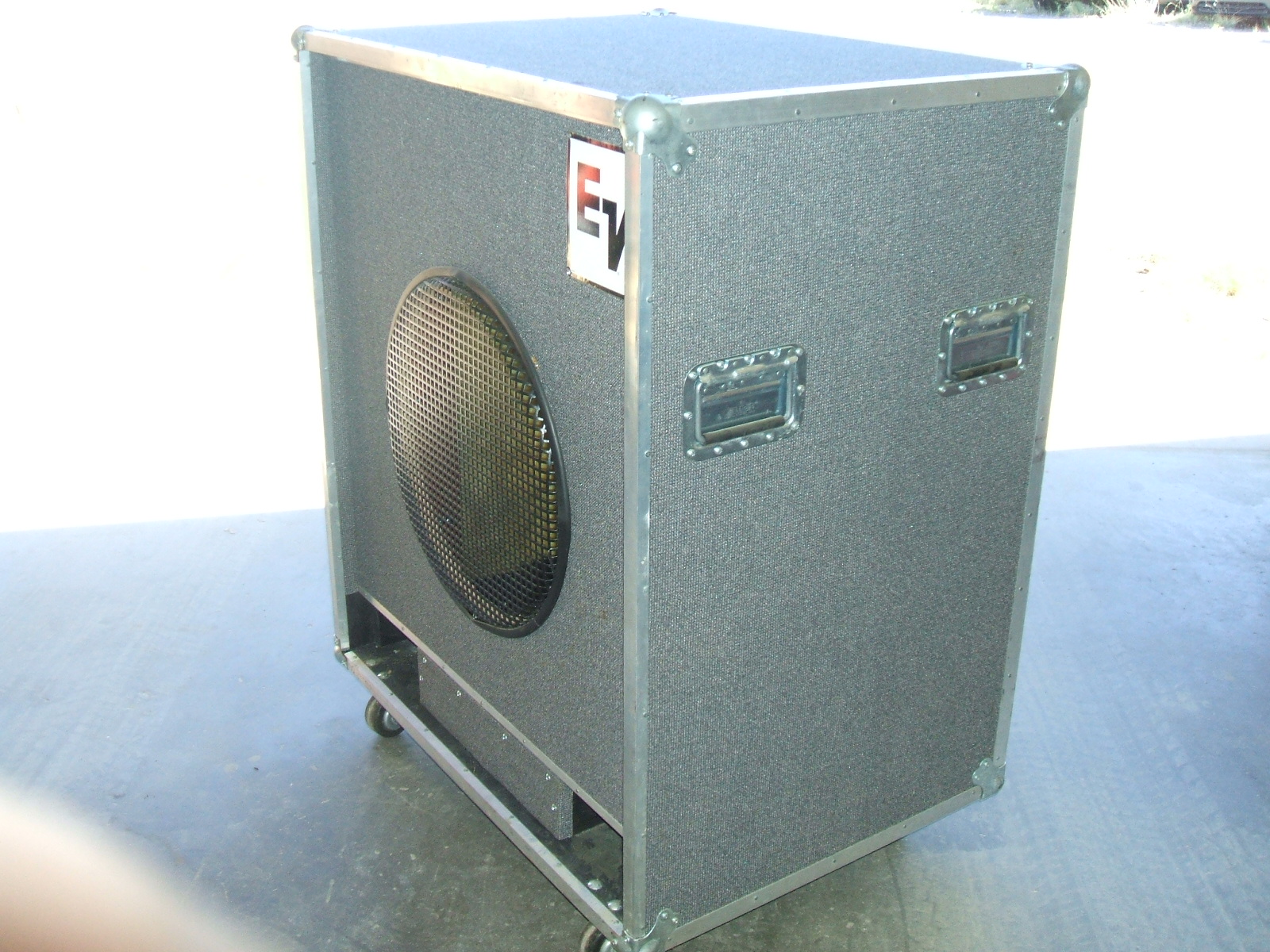

I used to use "carpet screw" nails when trimming my PA cabs (they look like a rack case.) (Most are 1 1/4", but easy enough to cut to length). I bet they would work fine for the corners as well!

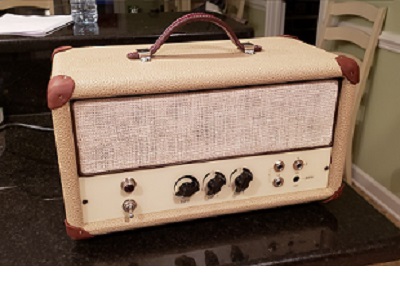

I loved the look of the leather corners so I put them on the Tweedle-Dee head I built. I wished I had seen that before I did mine. They weren't very hard, but reading that could have saved me some time experimenting. Next time I'll make sure to clean up the unfinished back side of the leather to make the cut edges look a little cleaner. Overall I'm very happy with how they turned out.

Well, soon I'm about to see if the "screw nails" will come out easily! I decided to turn the enclosure shown above into an EV 3-way enclosure, (18", 10", and horn). Someone used an old Ampeg 412 cab to house them in, and it sure is awkward to move. The old bass bin has casters, and plenty of handles!
