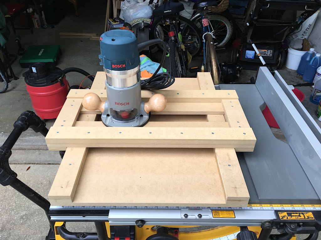

Here's the jig to use a router as a planer. There are obvious size limitations, but this was built to accommodate the material sized specific to the cab. Double sided tape is your friend, but if the board is two cupped/bowed to begin with, this jig might be a challenge to use.

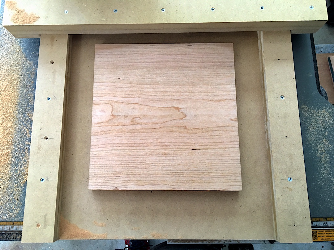

One of the sides for the cab, now flat, and prior to "jointing" on the table saw.
Final results, no jointer or planer used (I think the hardest part is understanding how to finish the wood; I might approach it differently next time):

I built the router sled several times -- different sizes. One sagged in the middle under the weight of the router and I didn't notice until all the boards were thinner in the middle.
but I was working with scrap pine. I was still sorry because they were wide boards. The thing I found was that I needed a relatively thin bottom board to rest the router on or I couldn't set the bit for enough depth to reach the board. So, I built one on 1/4" fiberboard. I finally reinforced the fiberboard one that sags with L shaped aluminum. I haven't tried it yet, but I am hopeful it will work as it should.

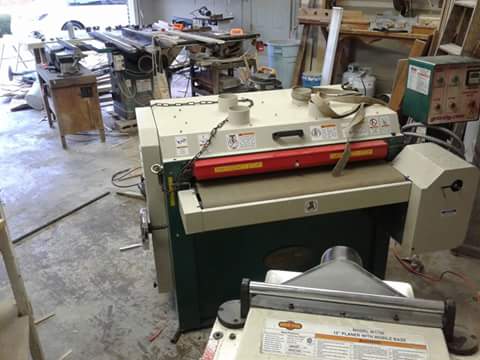

Another option to the 'Making those unhappy planks behave' is a drum sander. A good dust collection system is a must with these. I have a 16" Jet that has milled miles of wood so far. I use 80 gr paper on the drum which leaves a decent surface to finish sand from. Not as fast as a planer but much much quieter and capable of milling to 1/16" stock.
