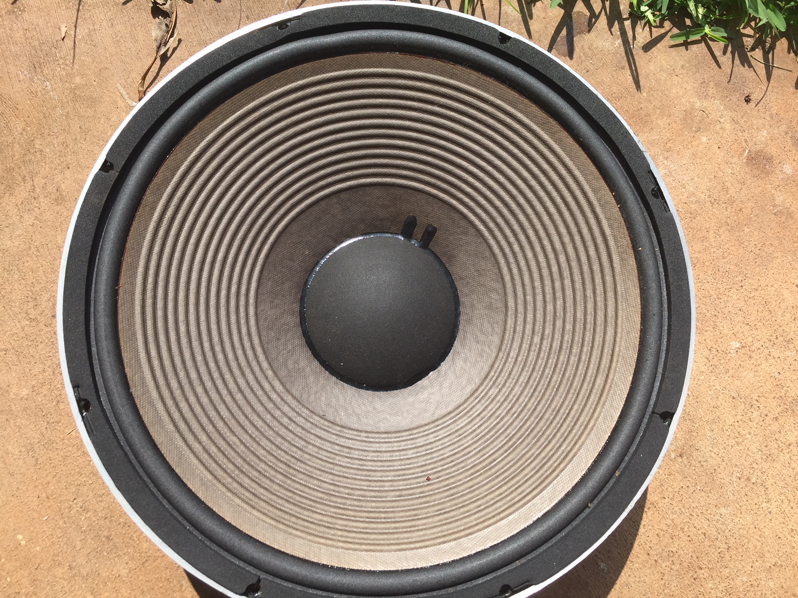

Here is a picture. The more I look at it, the more I think this is not a standard paper cone. Is this a hemp cone perhaps?

Re: Color of JBL recone kit looks darker
The more I think about, and I might be mixing up model numbers in my aging mind, but I think the original woofers may have had white cones. I know the L100's were white, and if I'm not mistaken, the L100's were the consumer version of the 4430's
I see healthy looking foam edges which means they can´t be more than 10 years old, maybe 20 years tops if they were unused inside the original cardboard box , obviously away from the sun and in a mild temperature and humidity place.
Foam rots and in general is way more damaged by sunlight/UV than cone pigments.
My point is that if those cones are not deep black but somewhat brownish or greyish, they were so from the beginning.
Which does not mean anything is wrong with them, "natural" paper colour is light brown as in untreated Kraft paper, for the very good reason that it´s basically the same; black colour is popular because black pigments (think of carbon black/chimney soot) are both light and intense (like anybody who touches carbon black or even Laser toner quickly realizes) so very little is used so it affects sound properties the least.
While say, white pigment, is basically some ground mineral, and it adds weight; you´ll see some white woofers, not quite recommended anywhere else.
