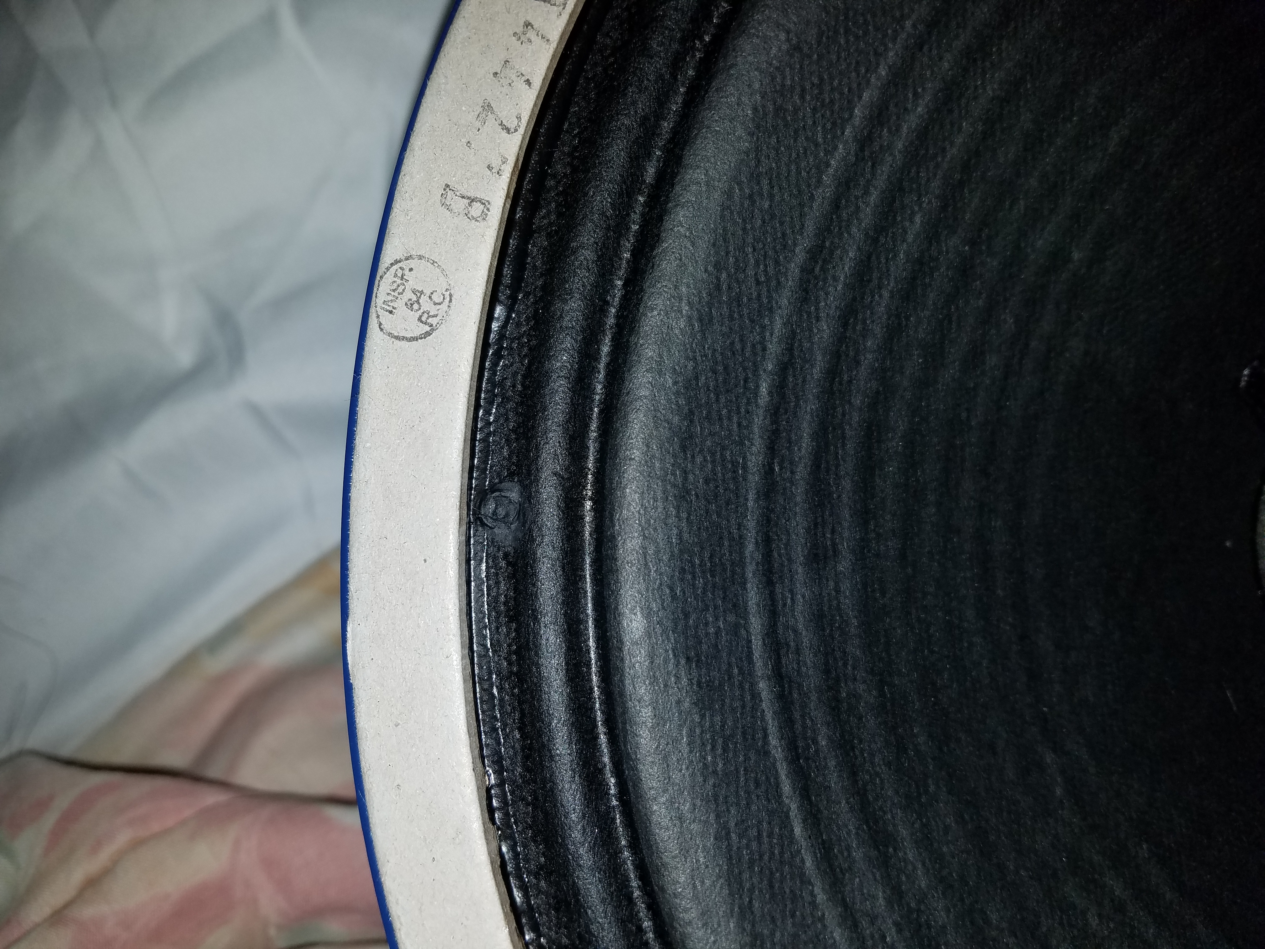

Hi all, i just purchased a used celestion blue on reverb.com and it came today. It was advertised as mint. I took it out of the box today and there was this small hole near the edge of the cone. I paid $200 for the speaker plus shipping. What should i do about this? Should i return it?

Hole isn't big enough to fuss about. Press it closed and superglue it.
But make sure you plug it in and play it before you give the OK.

Puncture wound from a screwdriver or mounting stud bolt (Fender, etc). I'd try it first after
contacting the seller. If it makes any noises (doubtful), negotiate or return it. While that hole
isn't that big, it is on the edge of the frame underneath. It will flex a little, and over time
will grow from use. Either patch it with glue/paper towel/toilet paper/etc or send it back.

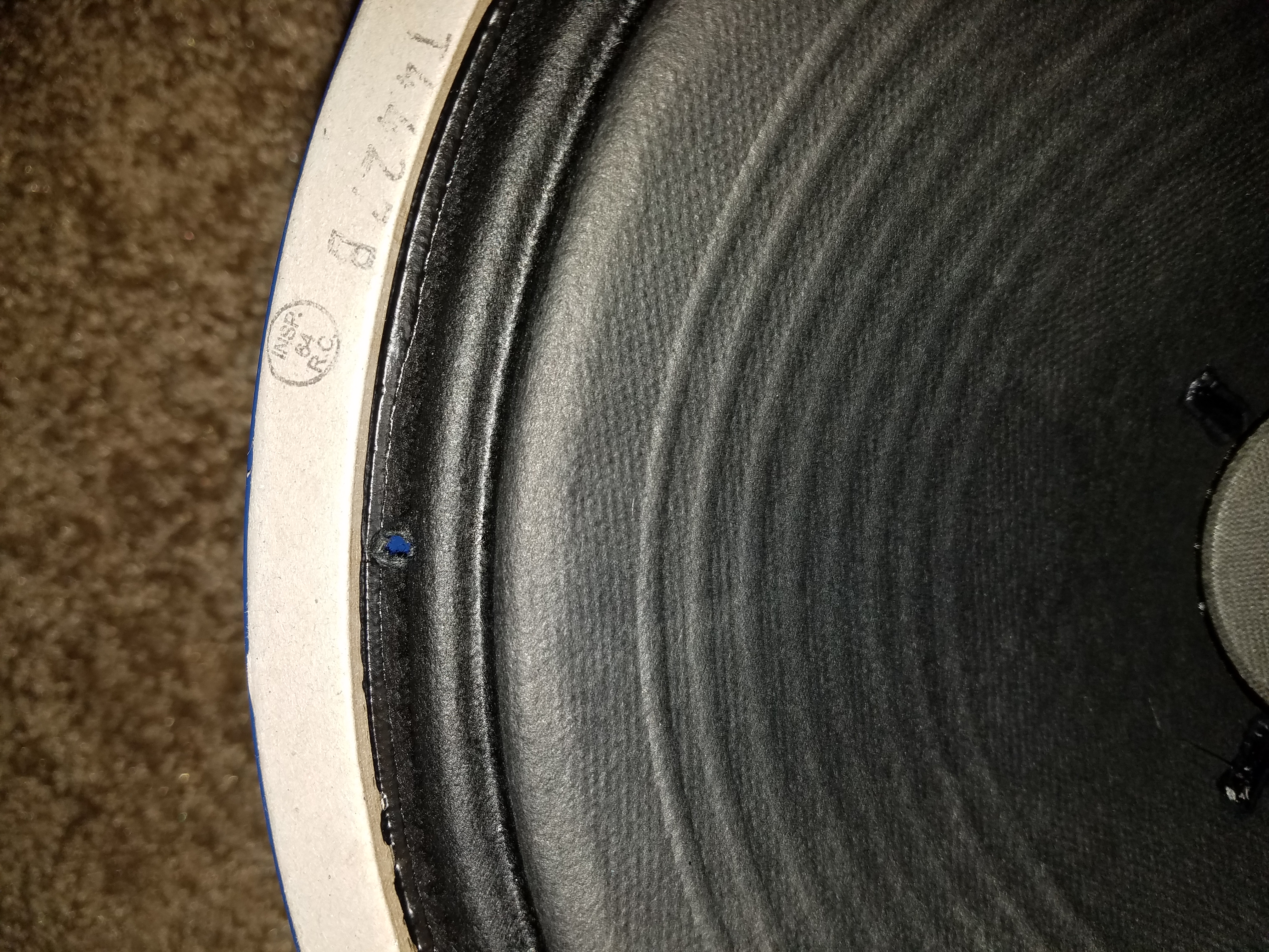

Well, i ended up getting 65 dollars back, bringing the whole purchase cost to $150. I pushed the paper bak through and used some watered down elmers glue. I think it should be okay, ill take a quick pic to see if anyone thinks i should do anything else.

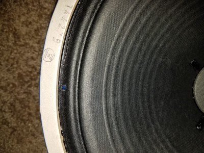

Here it is with 2 light coats of elmers glue, does it look like i need to do anything else to it?
Thank you all for your help!

Well enough alone .. Ian

Doesn't look bad, play it like you stole it.
