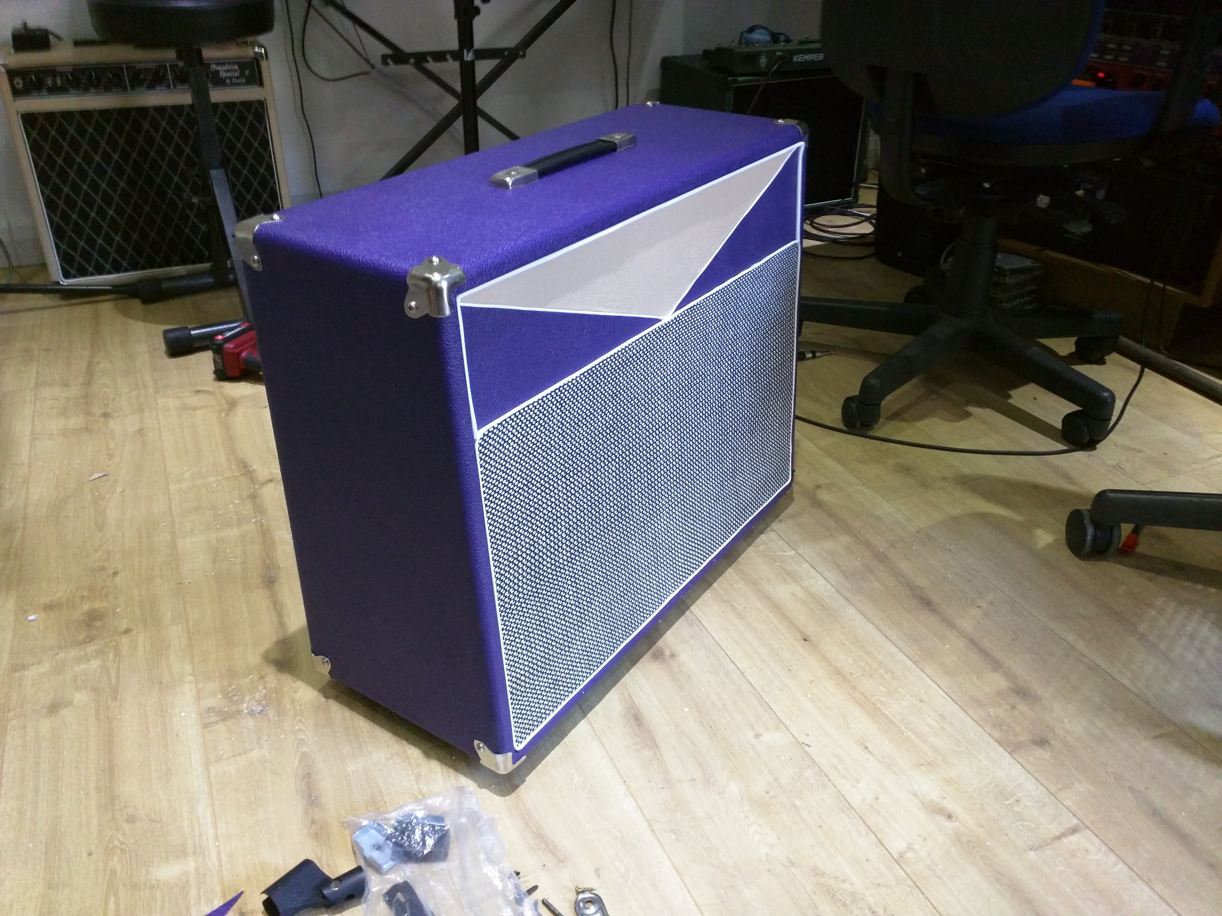

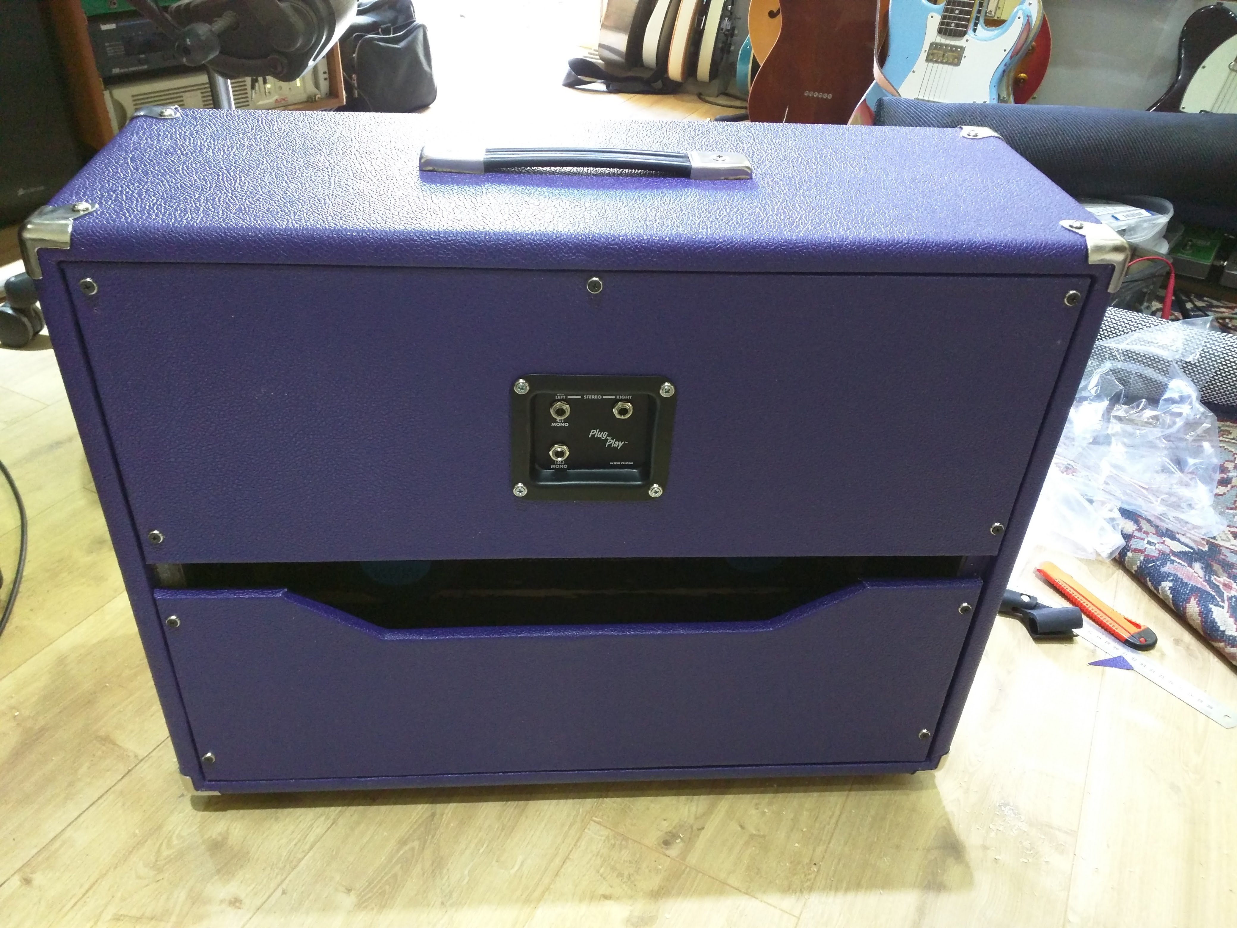

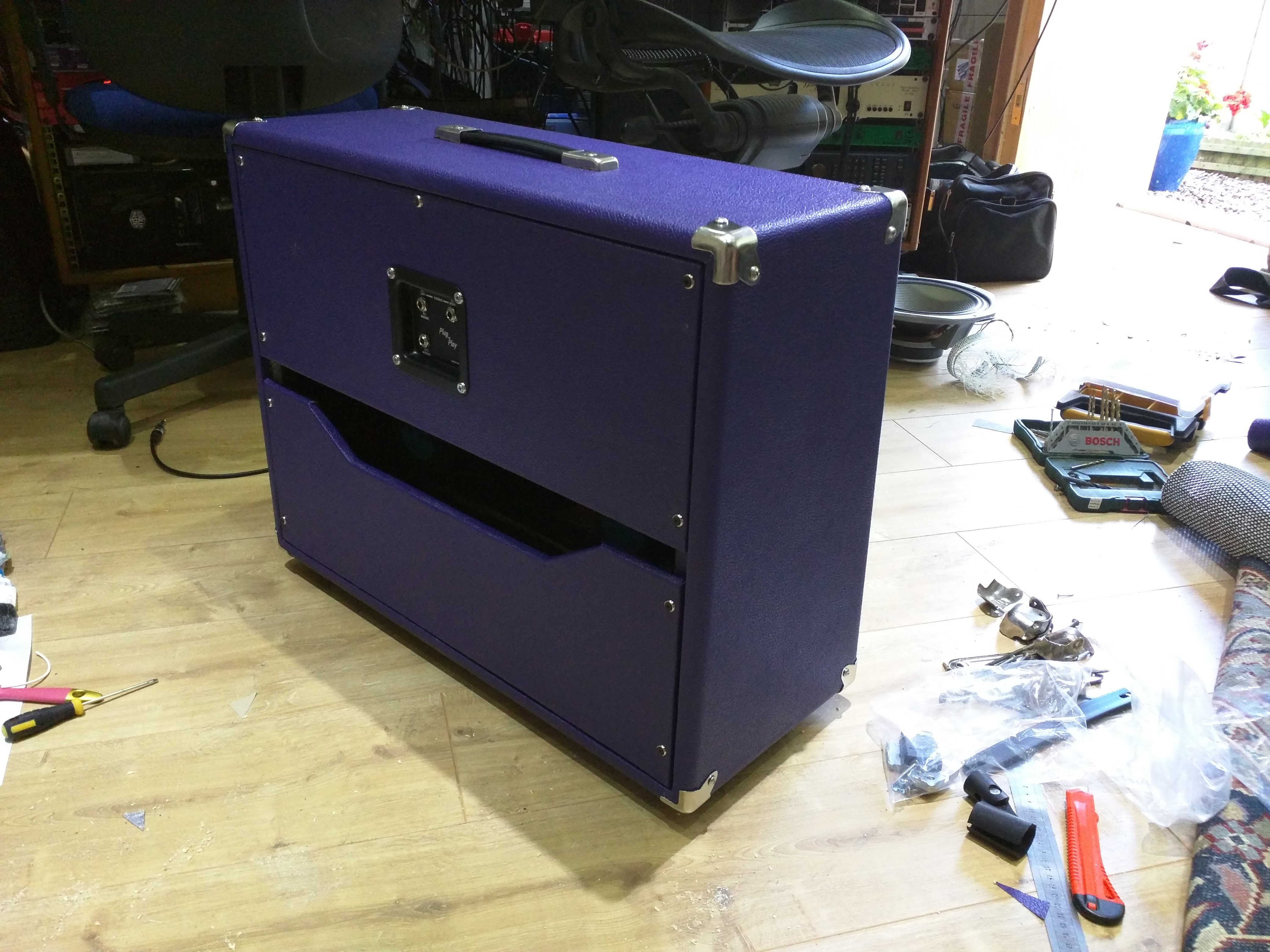

So I had the cab left from the peavey deuce after I'd removed it's transformers etc
It was made from very light solid pine.
So I made a new baffle and rear panels and here we are :D
My first time at piping , not to bad.
It's got a pair of Jensen 40w Alnicos that can be run in stereo or mono. I sort of modelled it on an AC30.
going to build a matching head cab for my rocket to with this now.

thanks, my first time doing piping, used a straight 1/8 router bit and clamped a straight edge on the wood and routed a channel. seemed to work OK for a first go.
Cab sounds really good. I've heard some bad reports about these new Jensen alnico's but they sound great to me, they break up nicely and they've got a sweet top end, not harsh at all.
