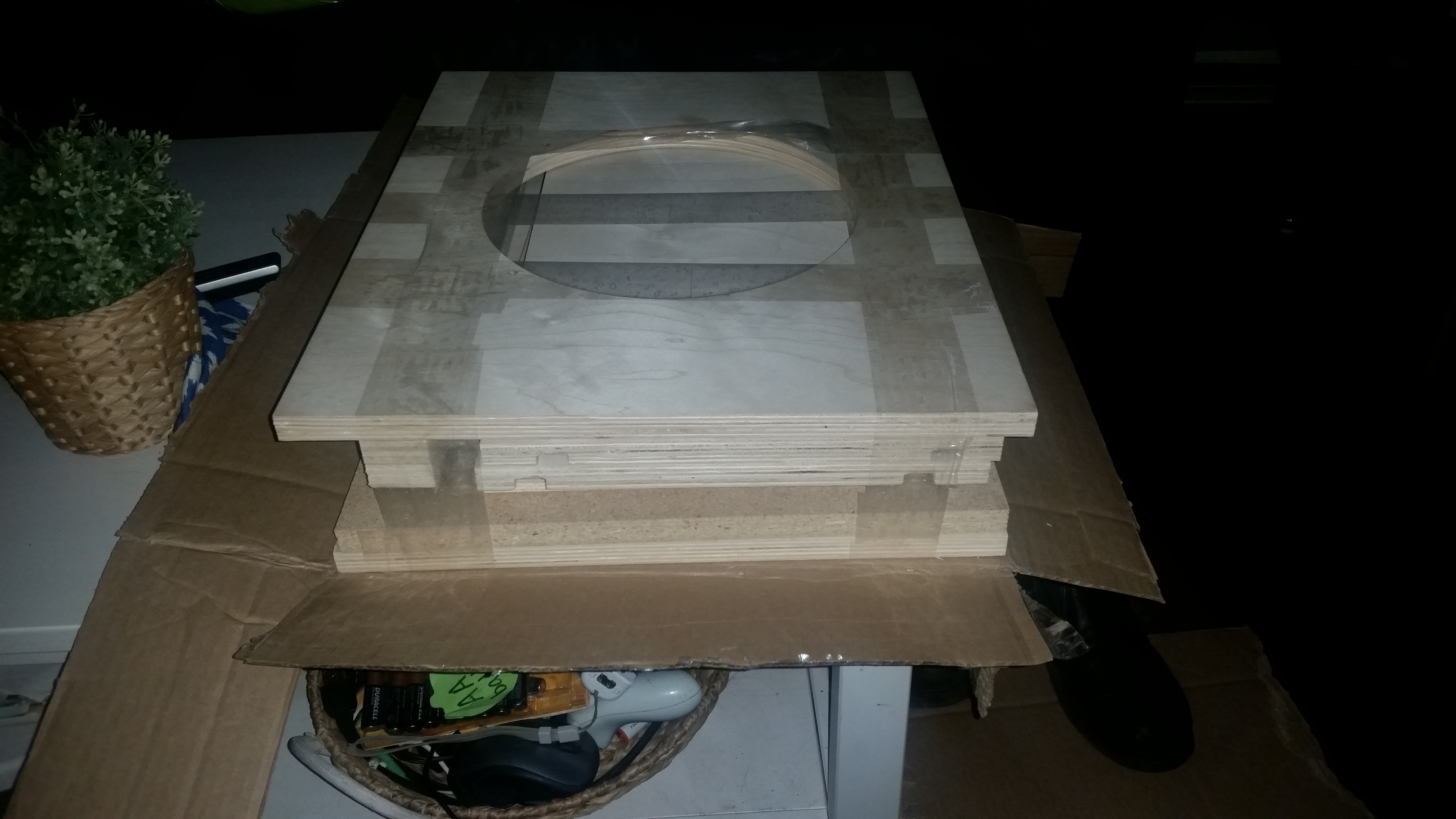

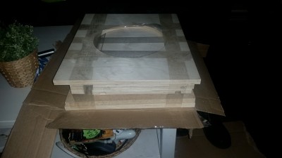

Test fitted...
You will definitely need to do something with the edges using a router but this thing will be a snap to assemble and is VERY sturdy even without any glue. Everything fits perfectly.
If turned into a combo It would be cool to fit a piece of plexiglass in place of the jack plate so you can peer into the guts of the amp.
