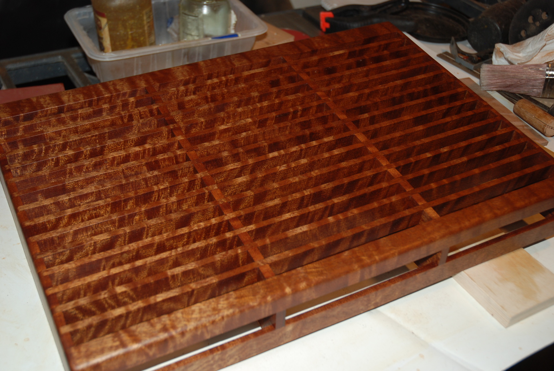

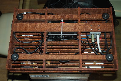

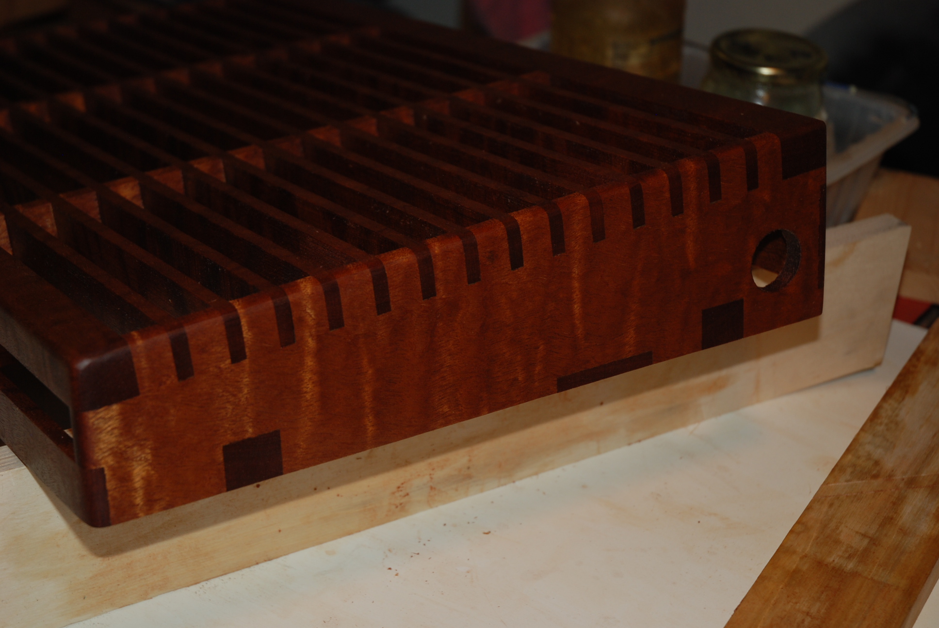

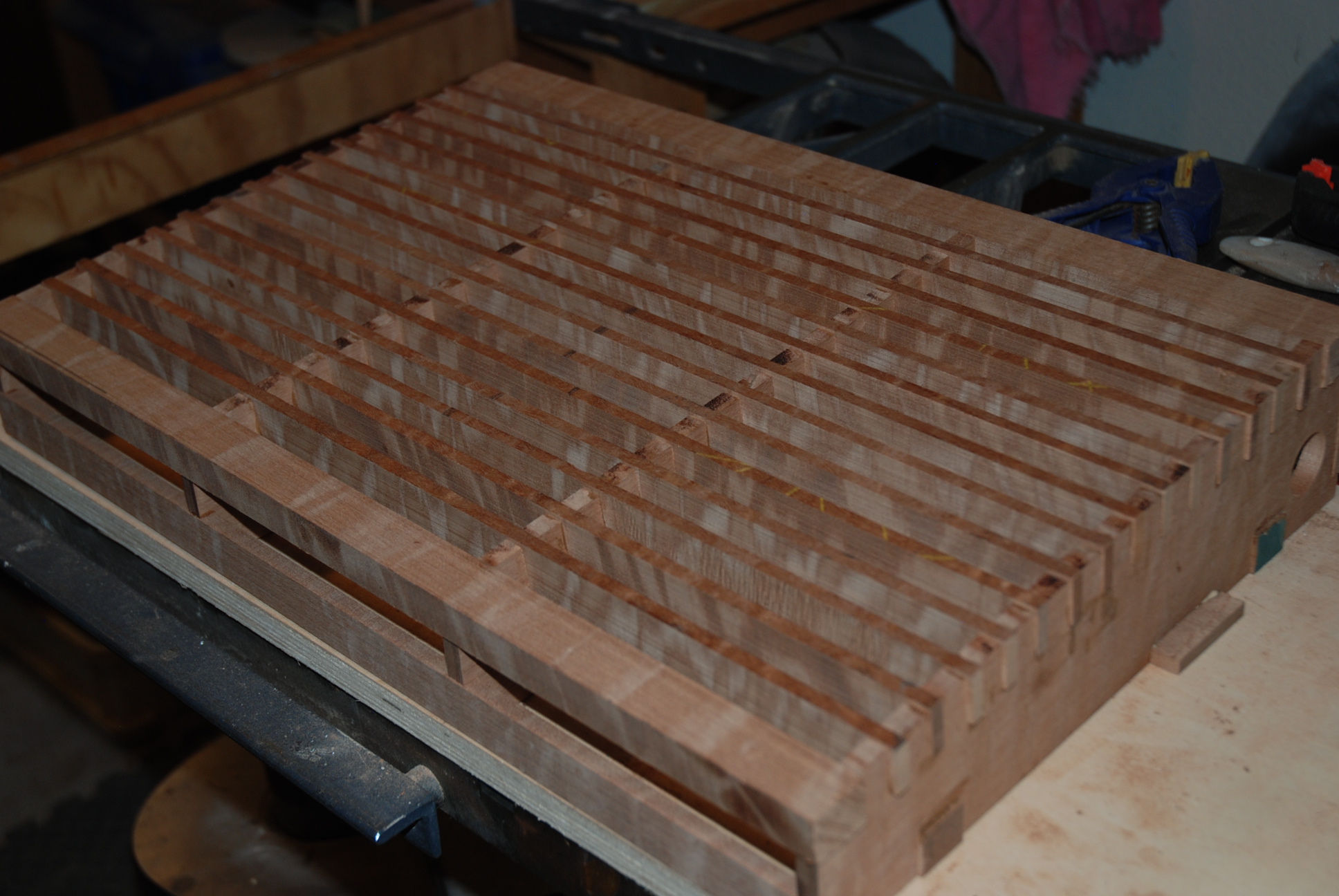

A friend talked me out of my lattice style oak board and I needed another. I had some sapele [sorta mahogany with some figure] laying around and I had the 'Go build something, you fool!' urge so I obeyed.

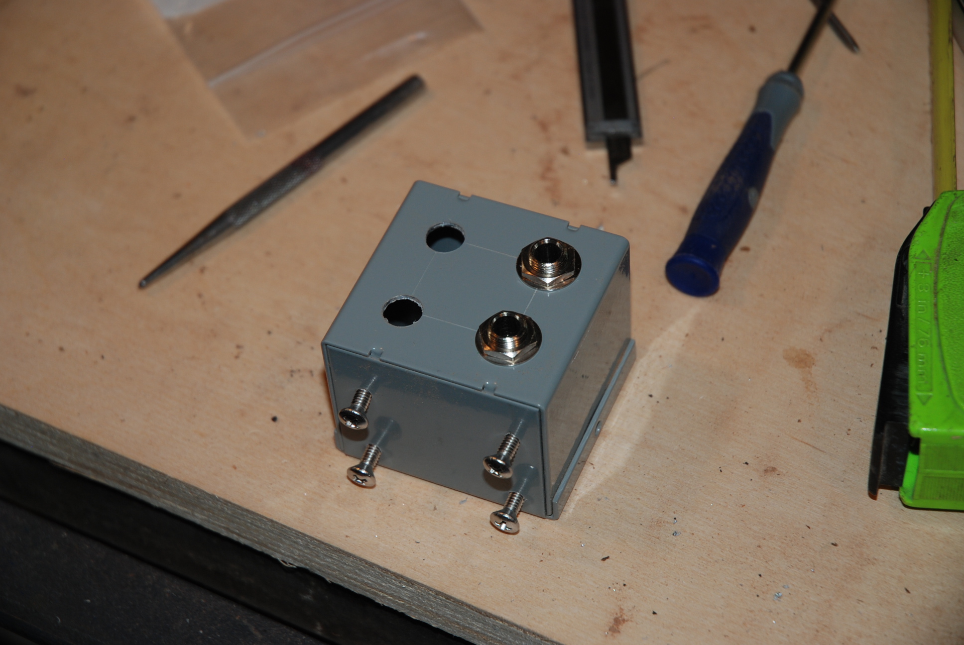

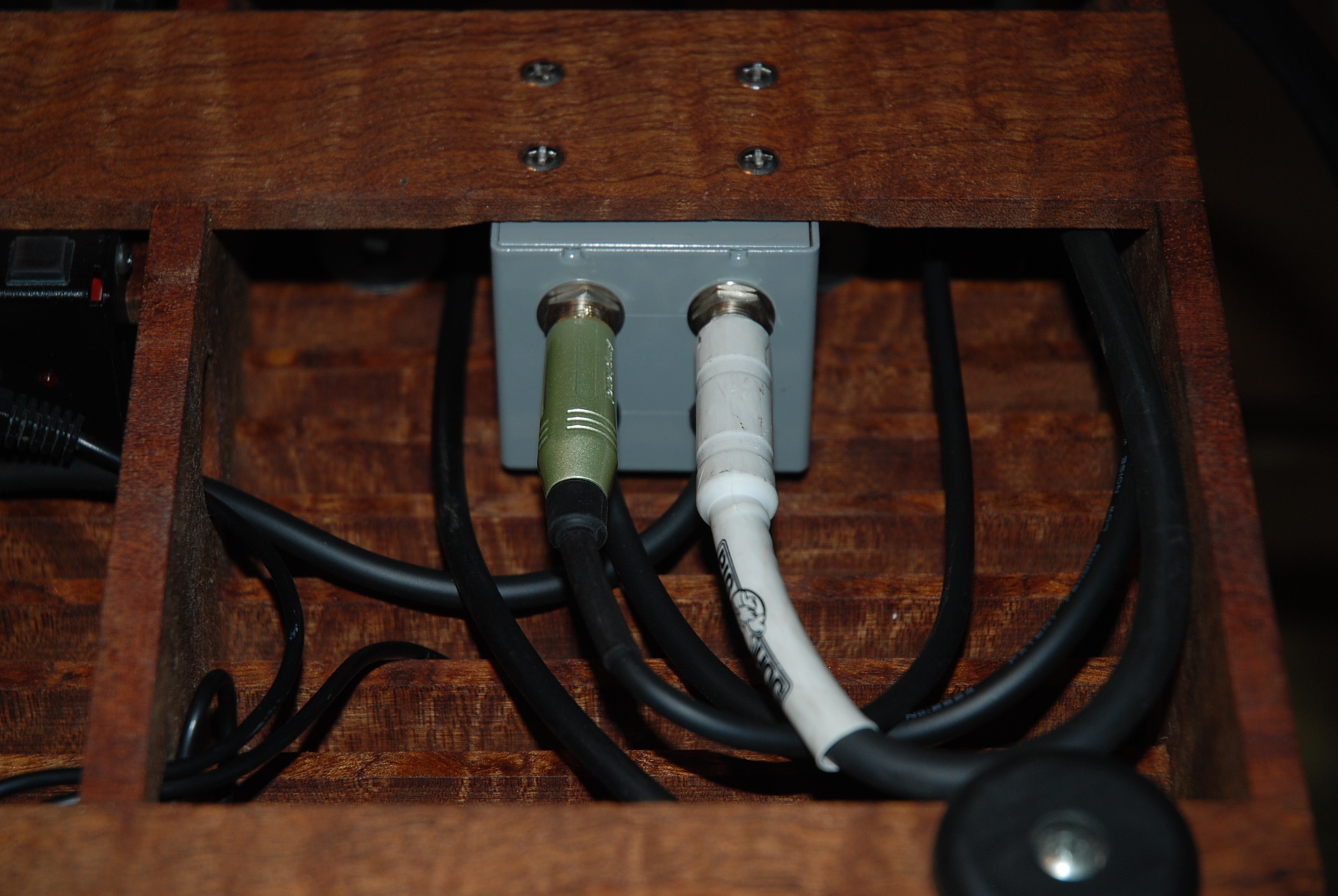

It's 21x14x3.5". I put the power supply and all guitar / amp cable connections underneath. I like the clean look and the 'I can't kick / step / break plugs and connectors' security.

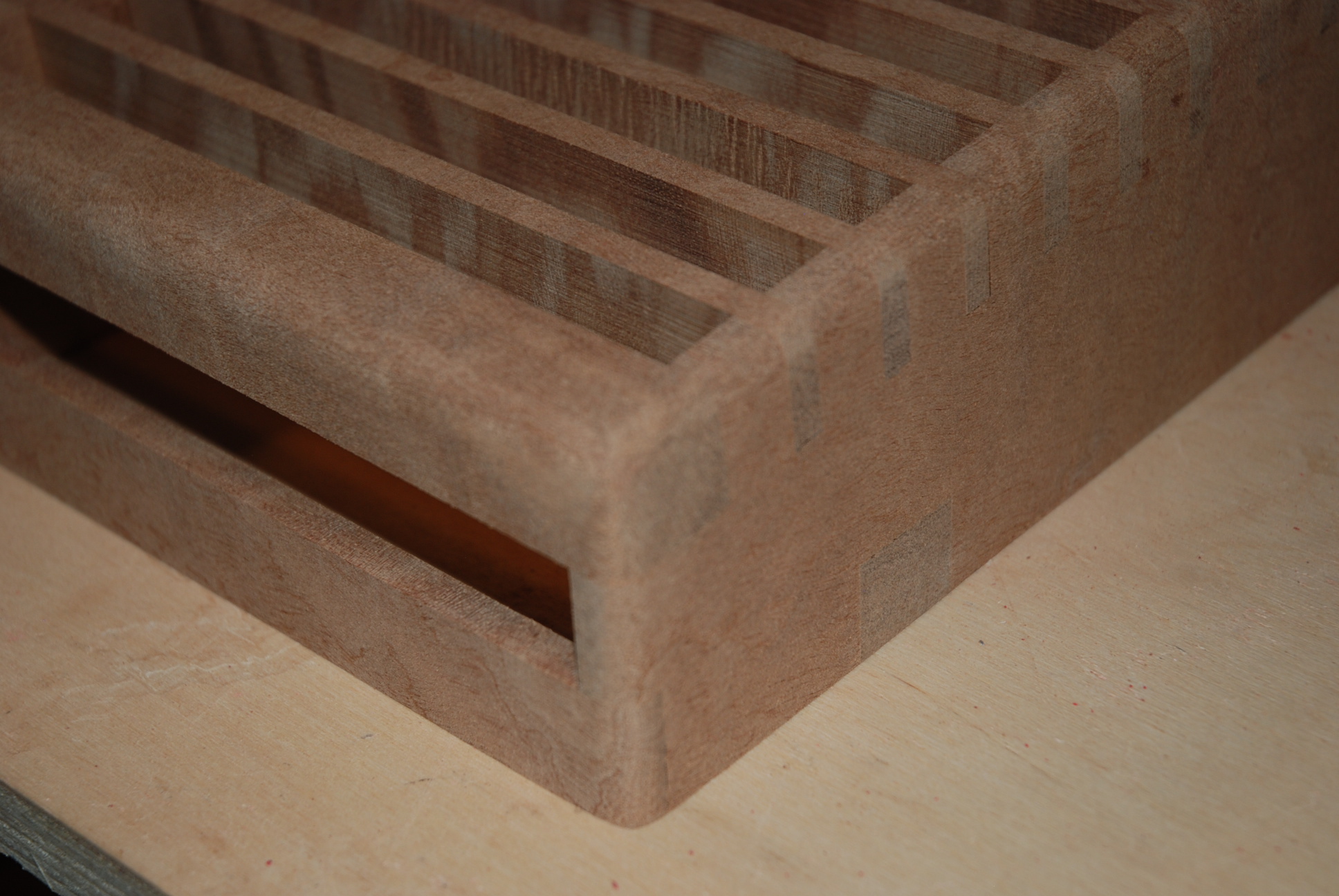

I used a tea wash and first slurry sand with 320. More sanding tonight with 400 and then oil out.

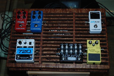

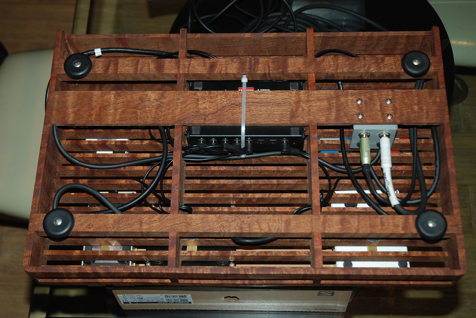

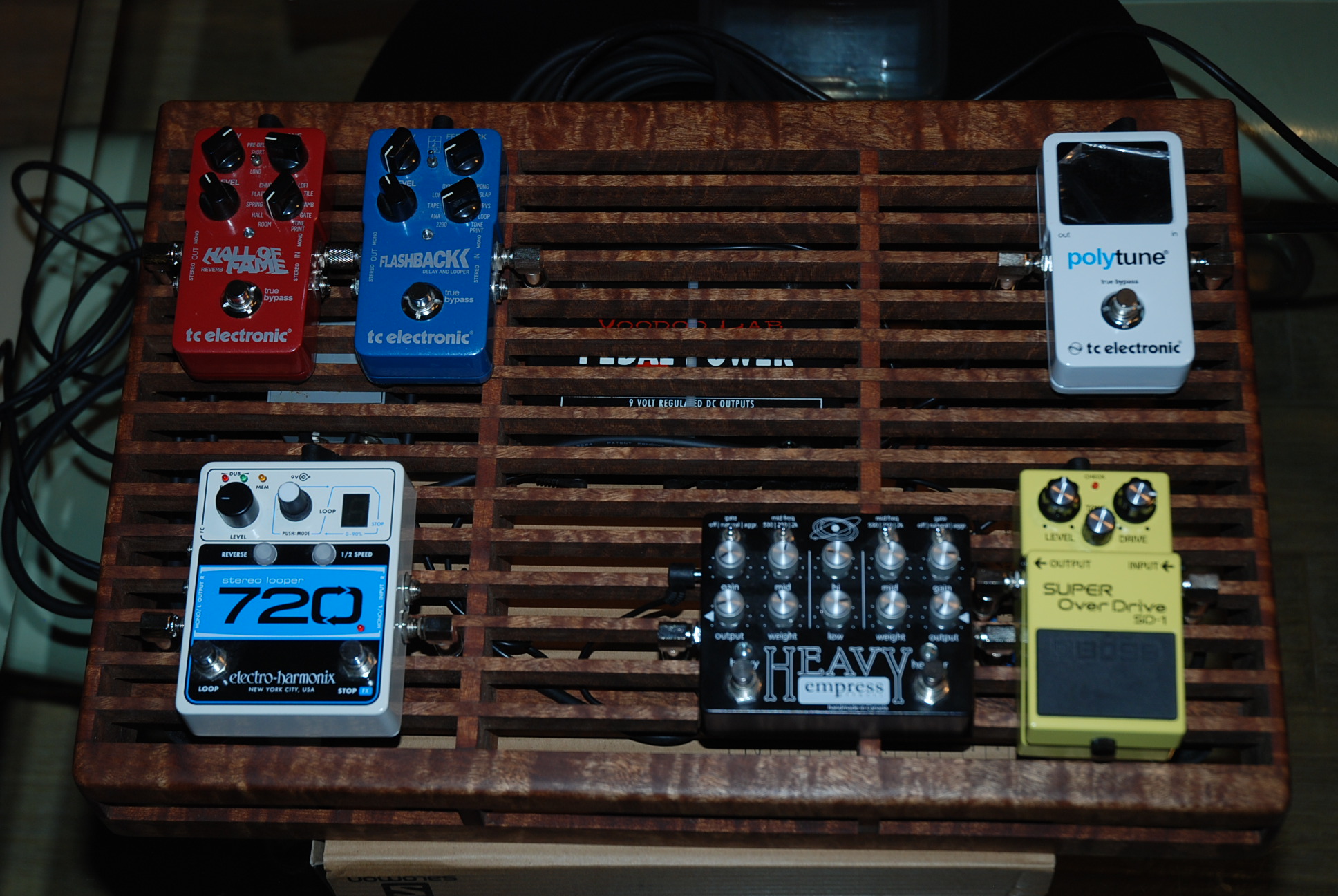

Finished - for now. Had a hiatus when I dropped the damned thing and broke the front corners off. Titebond to the rescue.
Box wired up

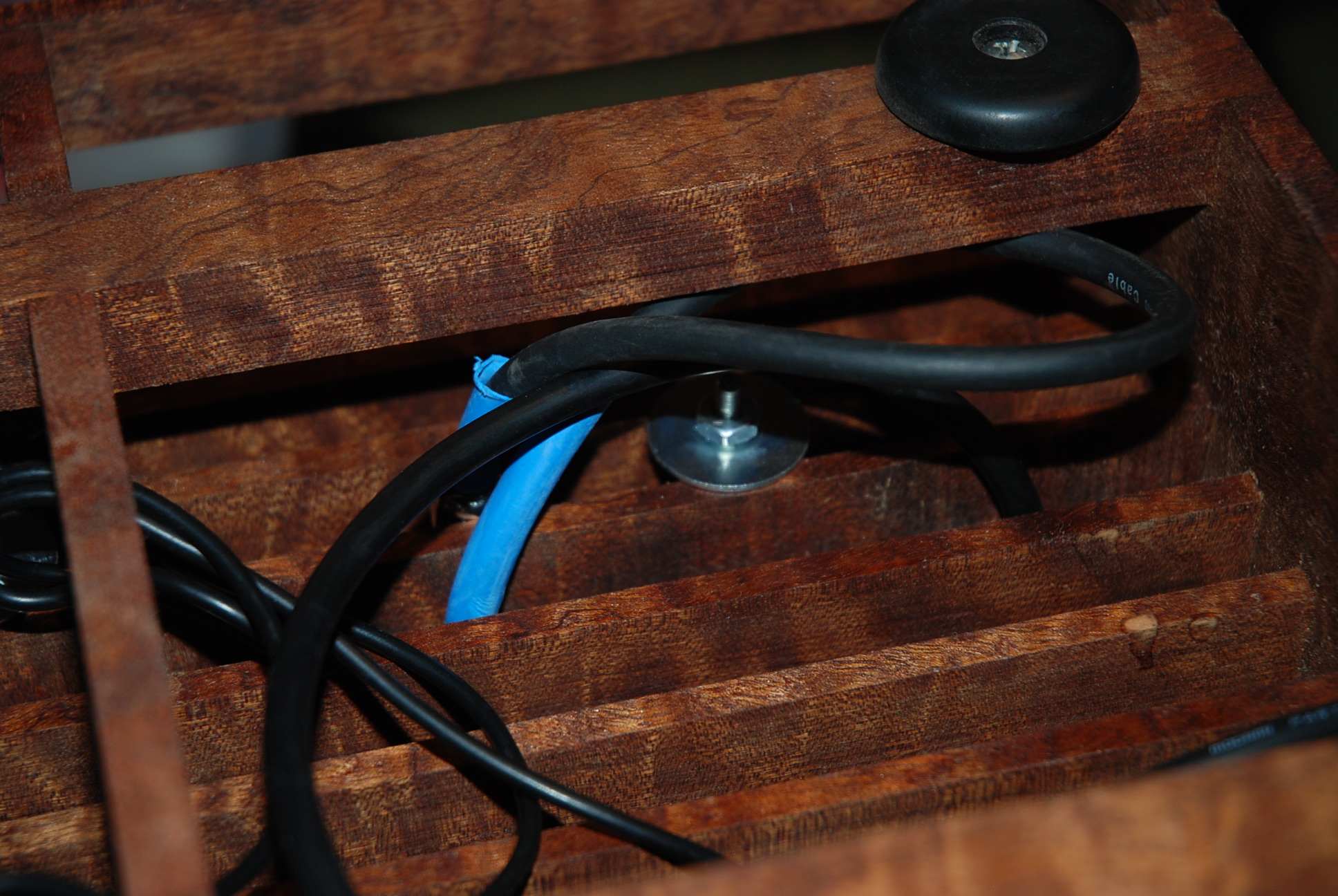

I tapped a .5" x 1.5" brass plate [8-32] attached to the bottom of the pedals with double sided tape and then a 1" washer / lock washer / nut
The power supply is zipped in for now - I used wood wedges to hold the last one in place.
Sadly I only had enough brass for 6 pedals - note to self: If you think it will work buy at least two!
Off to the hardware store for more brass.
I have a RAT 2 inbound and am trying to talk myself in to a Strymon DIG. Maybe if I'm a good boy Santa will bring me one. DISCLAIMER - I set the good boy bar very low.
