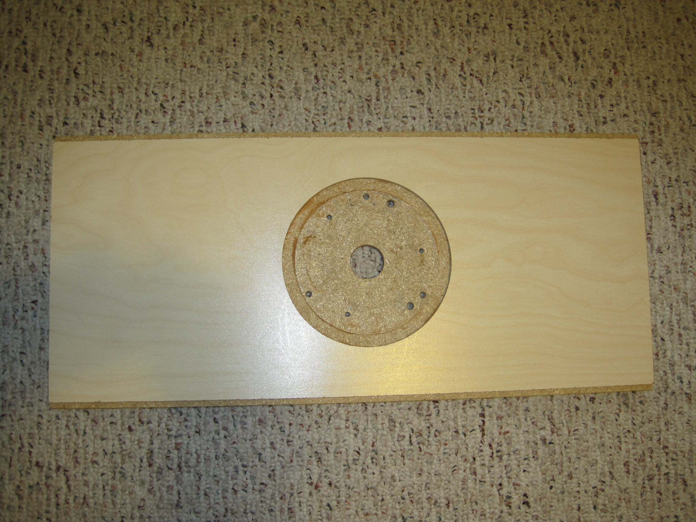

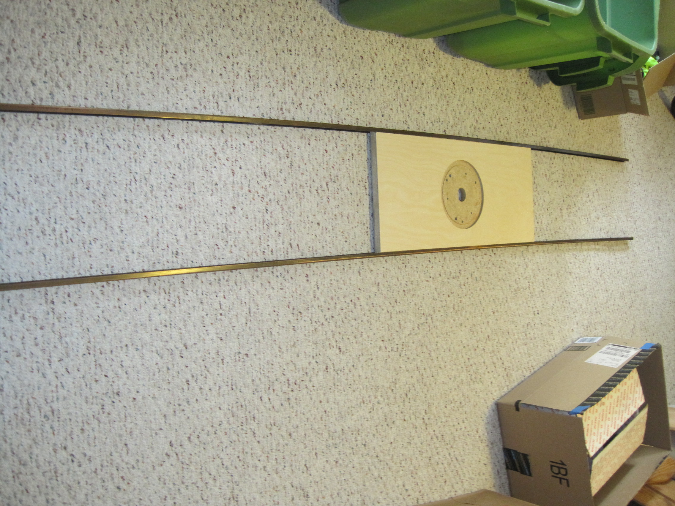

Someone asked for pictures of my router sled. This is about as primitive as it gets. The only thing I had to buy for this were the longer M4 screws to mount the router to the plate. I was mistaken in my memory of a few things. The router is not mounted, but I think you can imagine what that looks like.
I cut the router plate using the router with a homemade circle jig. The circle jig is real easy to make. Look on youtube for ideas. Mine is made from a piece of scrap Masonite and uses a couple of bolts and wing nuts.

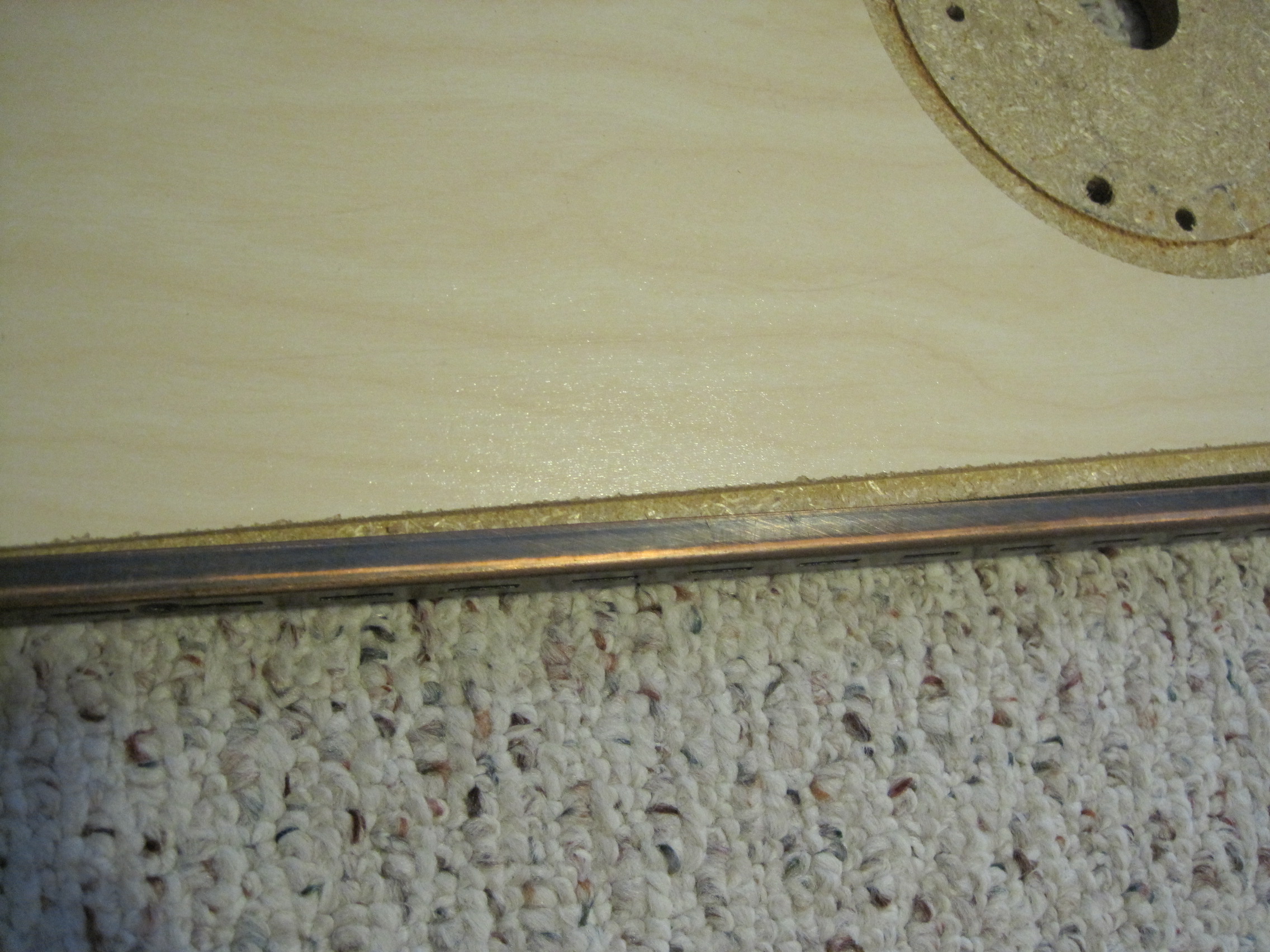

The shelf bracket holders you see were something I had laying around. They are 7' long. They don't need to be anywhere near that long, but I didn't want to cut them in case I decide to use them for their intended purpose. These are old and the metal is heavy. I'm unsure if modern ones are as good. I was really surprised that when oriented with the open side like a C how stiff they are. They don't give at all under the weight of the router and plate. The shelf brackets are only needed for wide work pieces.
I really need to install a removable stop on each edge of the plate to keep the router from sliding off the rails into the work. This can be just about anything: 4 bolts, a block of wood, a piece of L aluminum, etc. I will do that before I use it again.
The pictures show

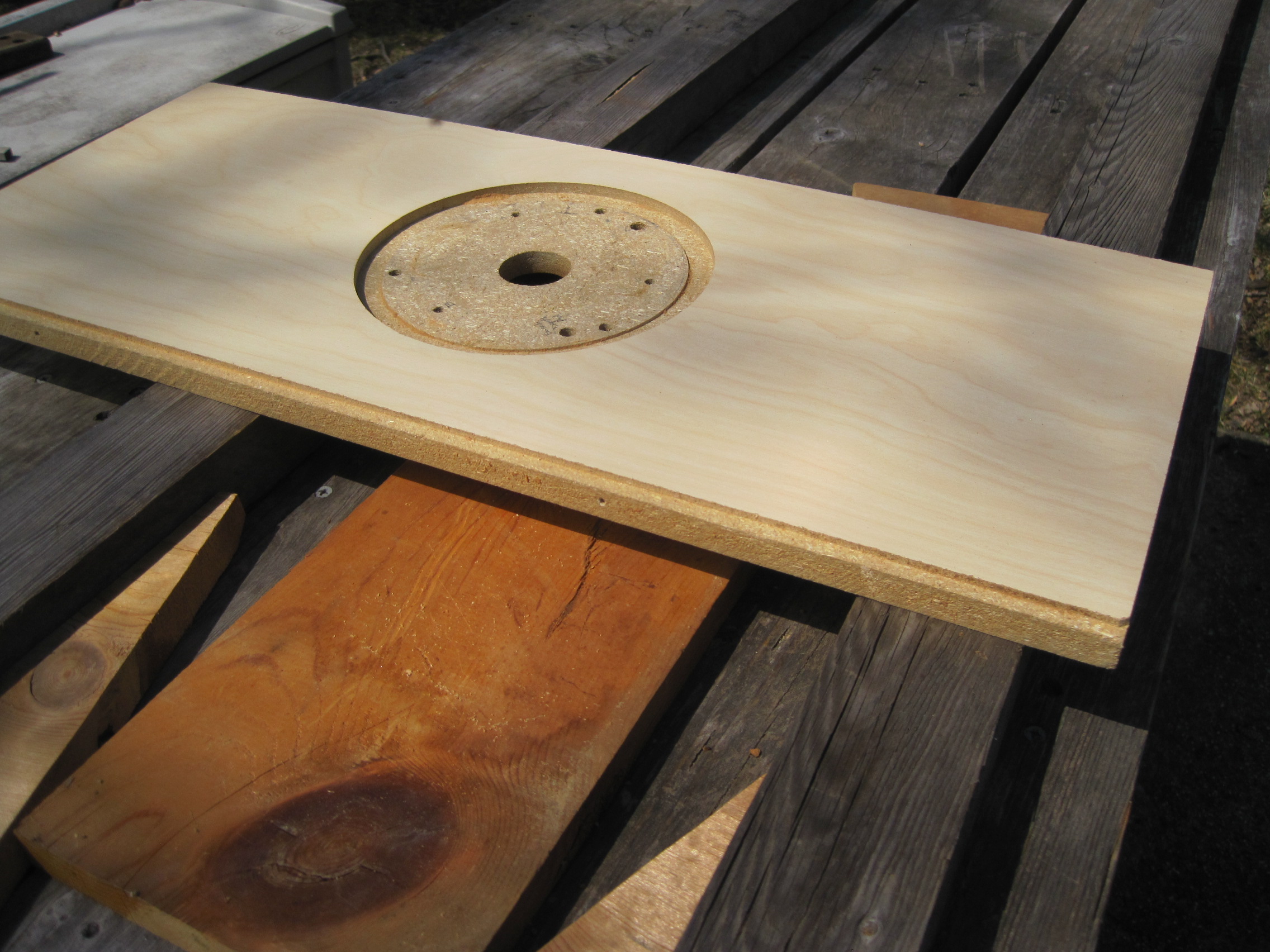

1) Plate.

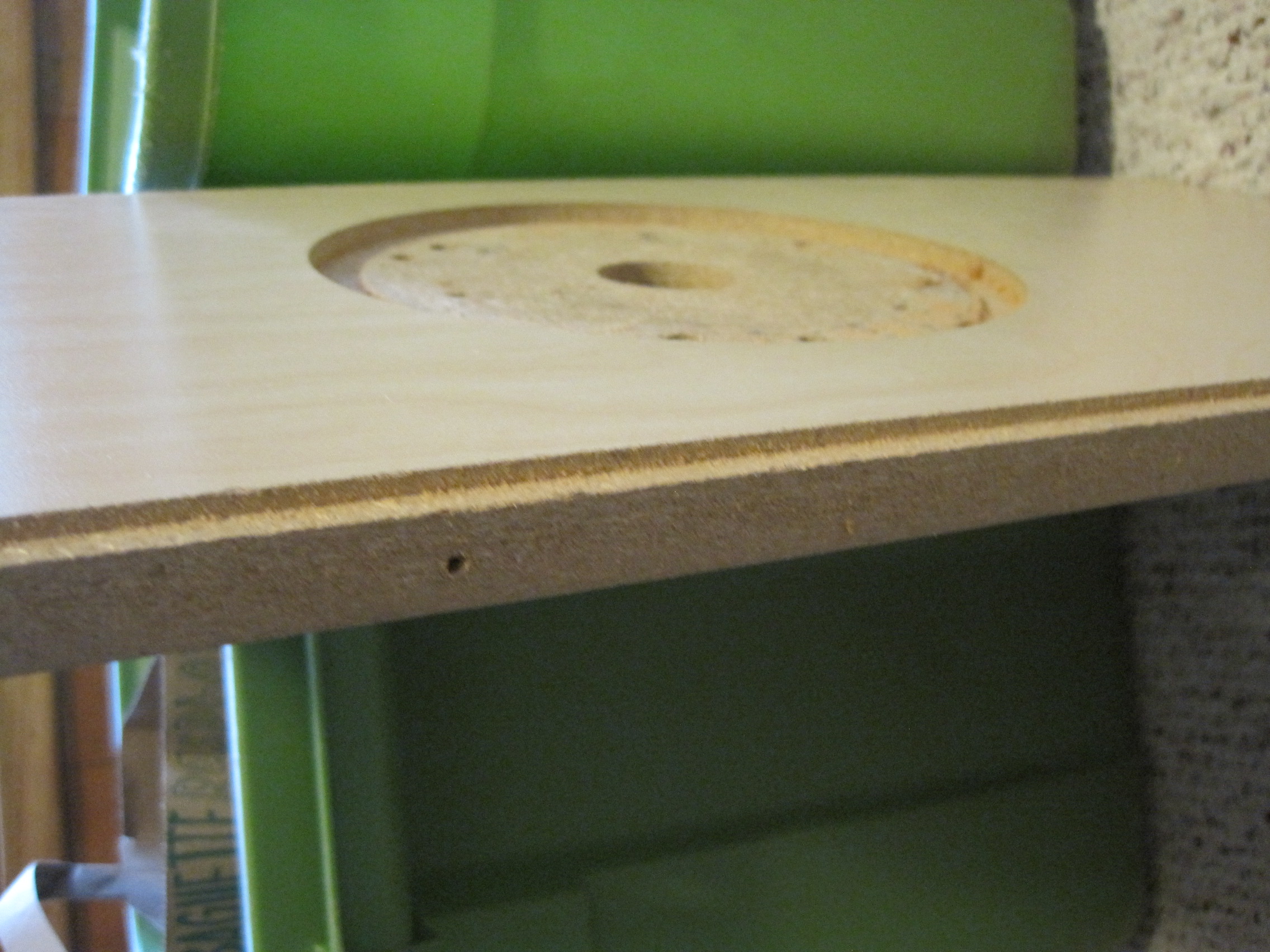

2) Rabbet on the top edge of the plate to accommodate the shelf bracket holders.
3) Plate with the bracket holders in place -- I didn't bother to screw them into the sides as this is just show and tell.

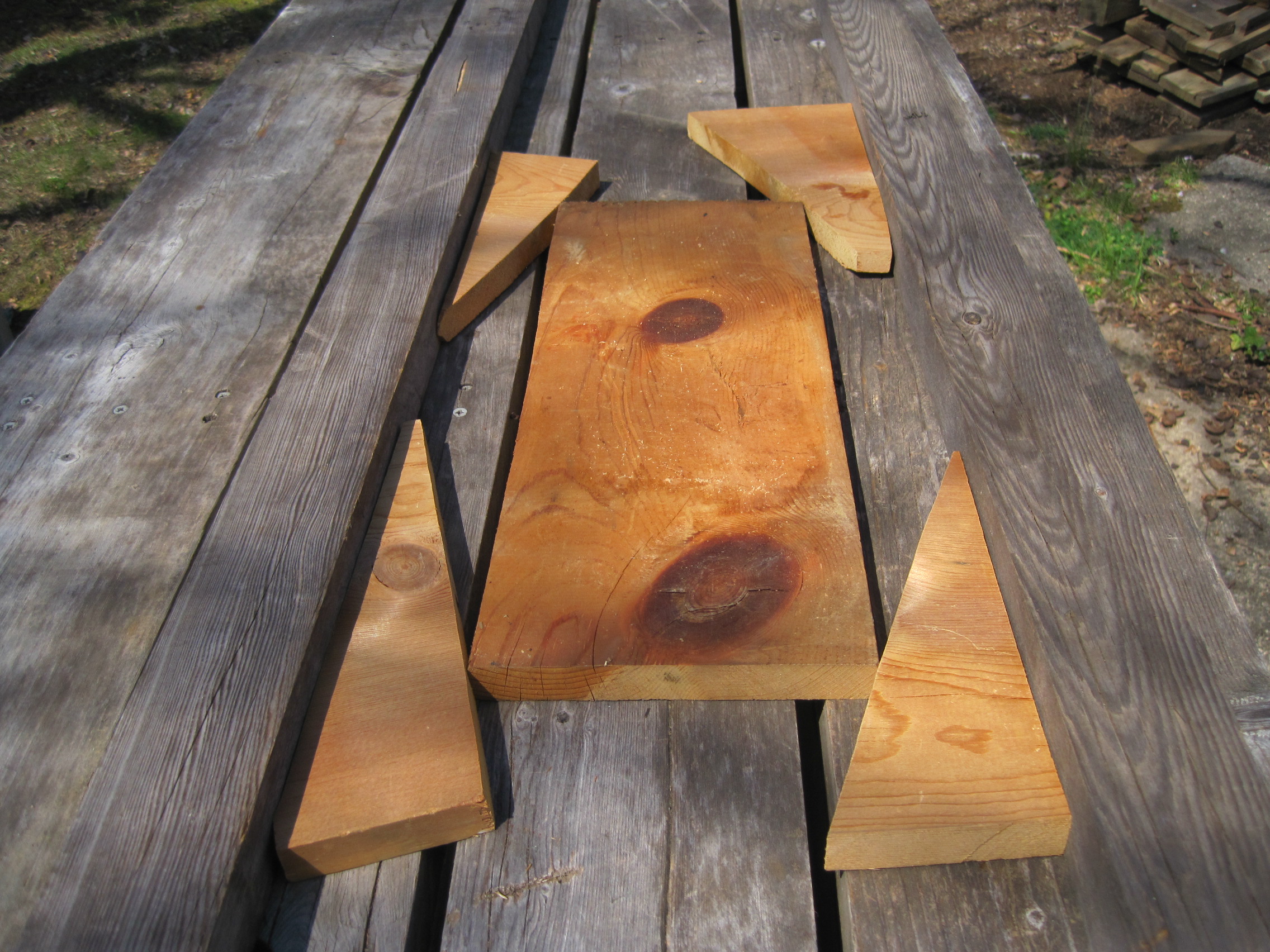

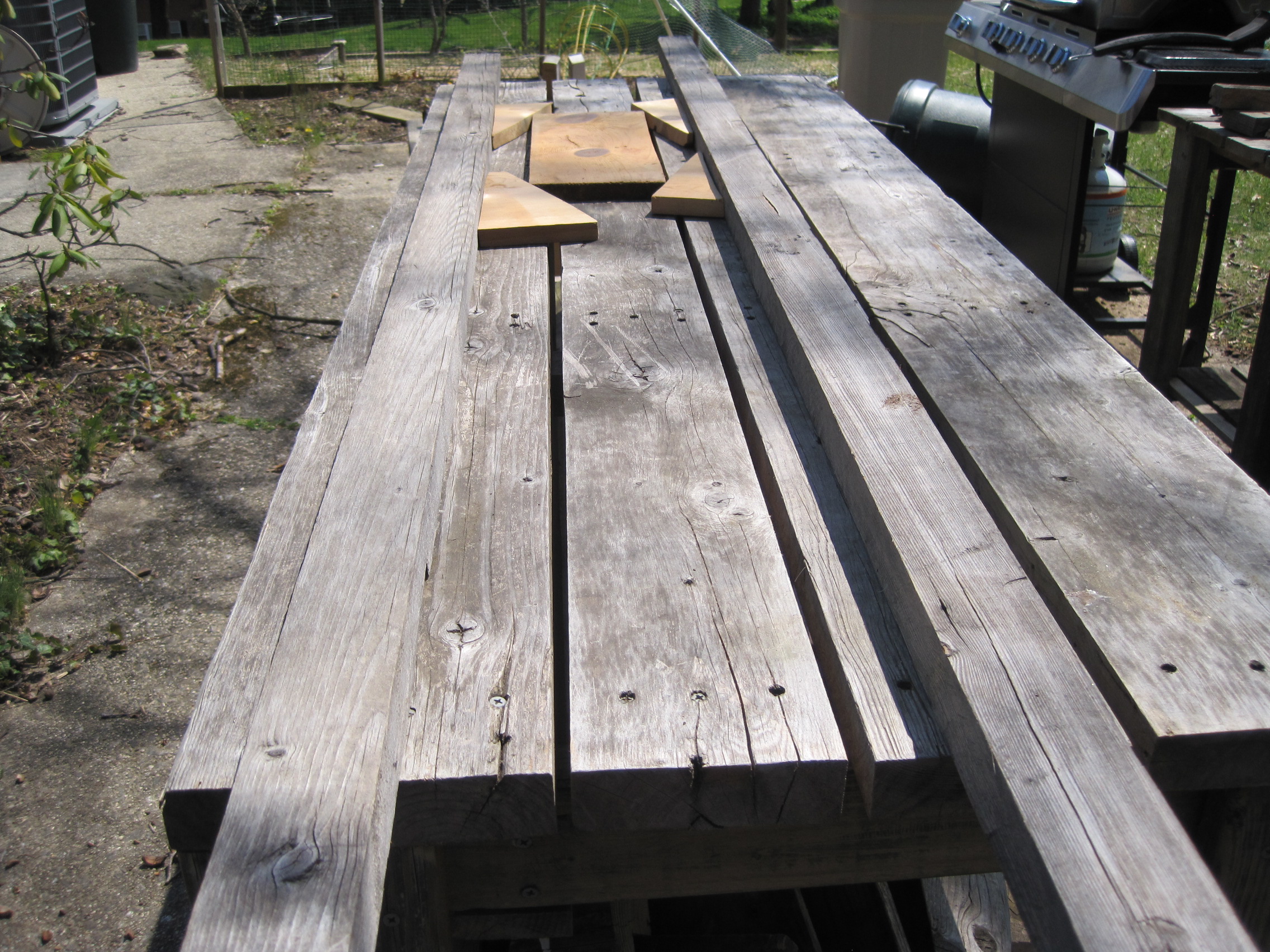

4) Rails on the work table. This are about 2" x 2". The exact dimension isn't critical. They need to be true to give you uniform height from the table. These have been outside all winter and now I'll have to figure out how to true them up again. These can be screwed into the work table or clamped, depending on the size of the work piece.

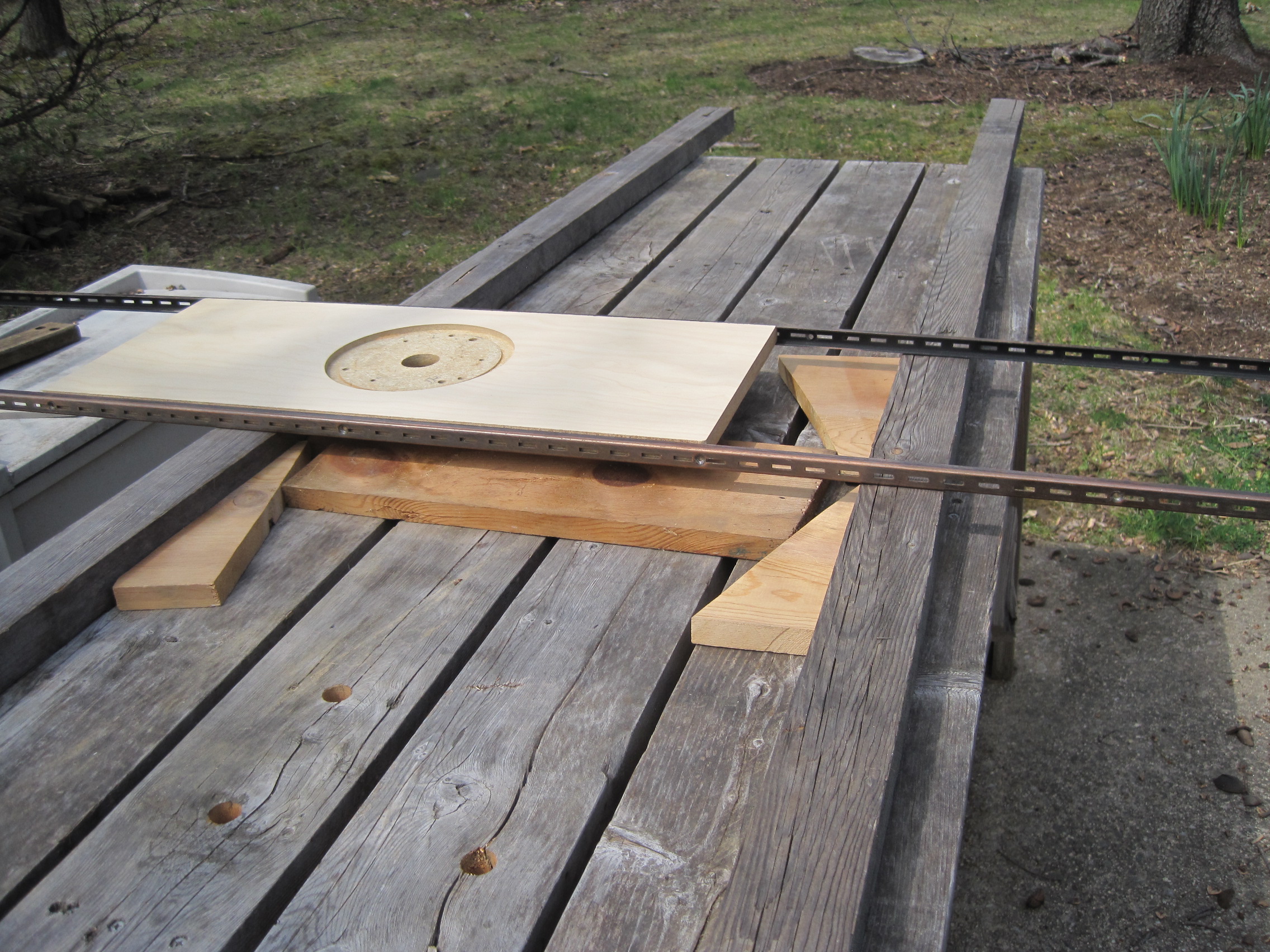

5) and 6) The work piece held by wedges. Once knocked into place, it is a solid hold.
7) The plate over the work piece. Imagine the router on top ;-}
8) If the work piece is wide, this shows the shelf bracket holders extending the width of the plate. I could just cut a longer plate instead and probably will at some point.
Plate with the bookshelf brackets in place. They look bent. They aren't.
Rabbet edge of the plate.
Plate.
Plate.

Work piece fixed with wedges #2.
Work piece fixed with wedges. The rails and table are weathered grey. One of the rails blends in, but just look, you'll see it.

I used those wood rails to flatten the table. You see they are about 7' long to carry the router to the end of the 6' table. It was a year or two ago, so I don't remember the details. I should have taken pictures.
I made some sort of jig that made sure the 2 rails were the same dimension on one side. These rails are not square, they are rectangles, so they won't work in any old rotation. I screwed them into the sides of the table and made the sled to level the table. I used a block of wood to set the height of the rail to the table, so it didn't matter about the exact dimension. What mattered was that it was uniform for all 4 corners of the rails. It did an A+ job. I did it with the crappy Craftsman router that I've since retired. I kept the rails figuring I'd need to level the table again because outside nothing is stable. Right now, I've got to find a way to re-mill those rails without a table saw.
I've been working on a solution that uses a 1/4" thick aluminum plate and a couple of short 4x4's. I am not solving that problem. The idea of a free hanging router table is looking very appealing for this job and I can use the work table for the outfeed. I am sure this can be done. I just need to think it through. I also need to back out all the screws from the top and replace them with dowels so I don't ruin whatever new milling bit I buy.

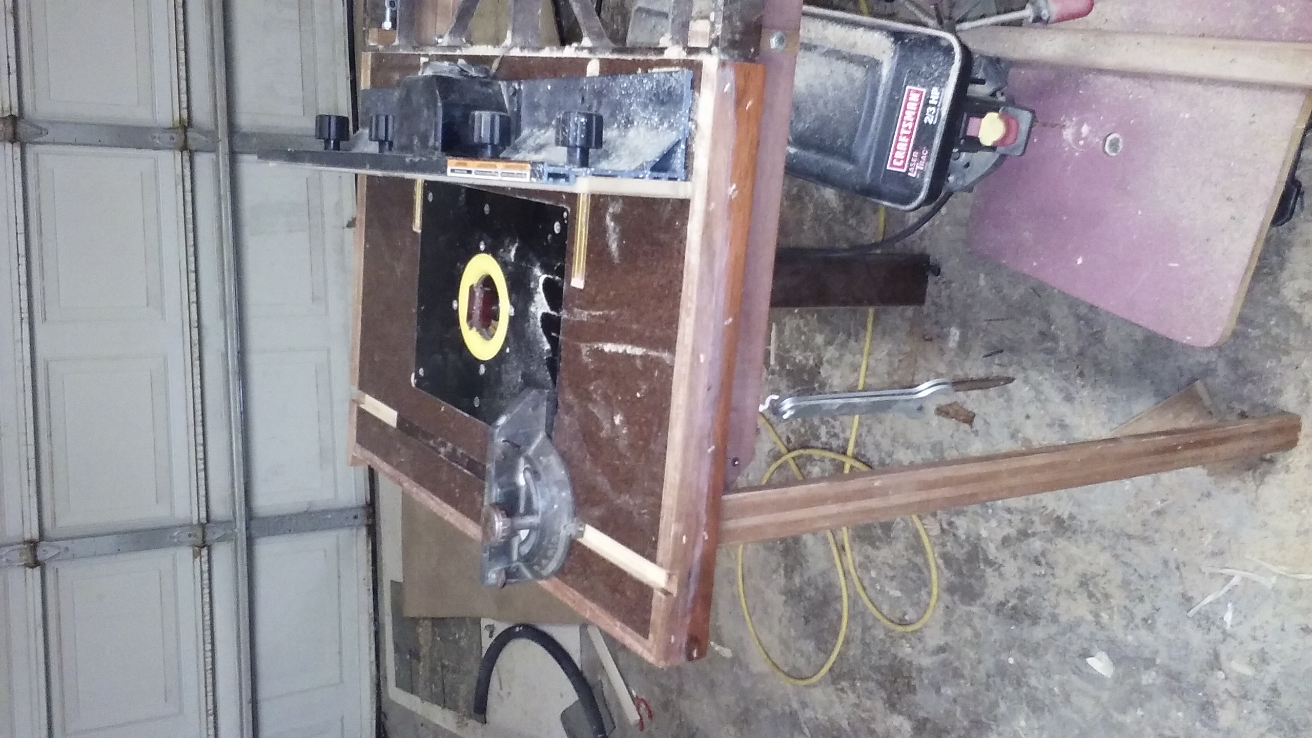

Re: Router sled
Here's axpic of my table this one isn't portable but you get the idea
