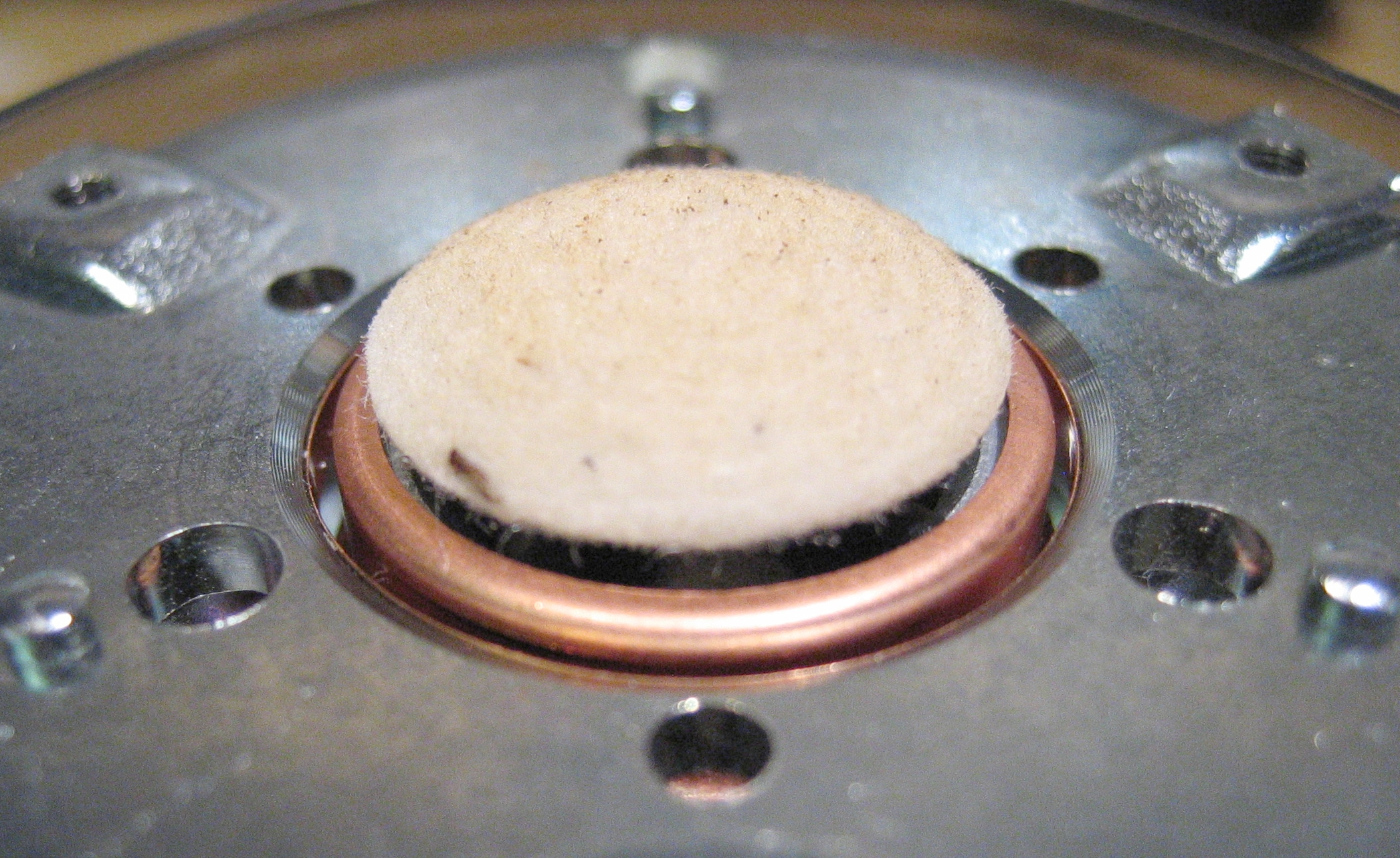

Following on from that, I'd be grateful if you could advise on this; for a given voice coil, above bass resonance, is its freq/impedance response (roughly) the same no matter what the magnet / cone / doping of the speaker it's used with?

The rise in impedance, usually starting between 400Hz and 1kHz, depends only on VC inductance, and can be killed by sheathing the polepiece with copper foil (very popular in 60's and 70's dual cone PA speakers, specially Goodmans , and RCF in the 80's), gluing a thick aluminum disk to the polepiece top (JBL) and/or gluing an aluminum or copper ring to the inside of the top plate (again JBL) .
[img:750:575]http://www.troelsgravesen.dk/9710_files ... epiece.jpg[/img]
[img:750:559]http://www.troelsgravesen.dk/9710_files ... epiece.jpg[/img]
[img]http:2093:1283]http://www.speakerdesign.net/scan_speak ... te_big.jpg[/img]
Lots of people, even speaker repairmen ignore this, because it's "invisible" and rarely mentioned in datasheets and of coyrse you have to fully disassemble the speaker to see it.
Part of the secret of some speakers being so bright and punchy.
There's some dual cone RCF speakers 12L something or 15L something which hold their own side by side with speaker + horn combinations, go figure.
