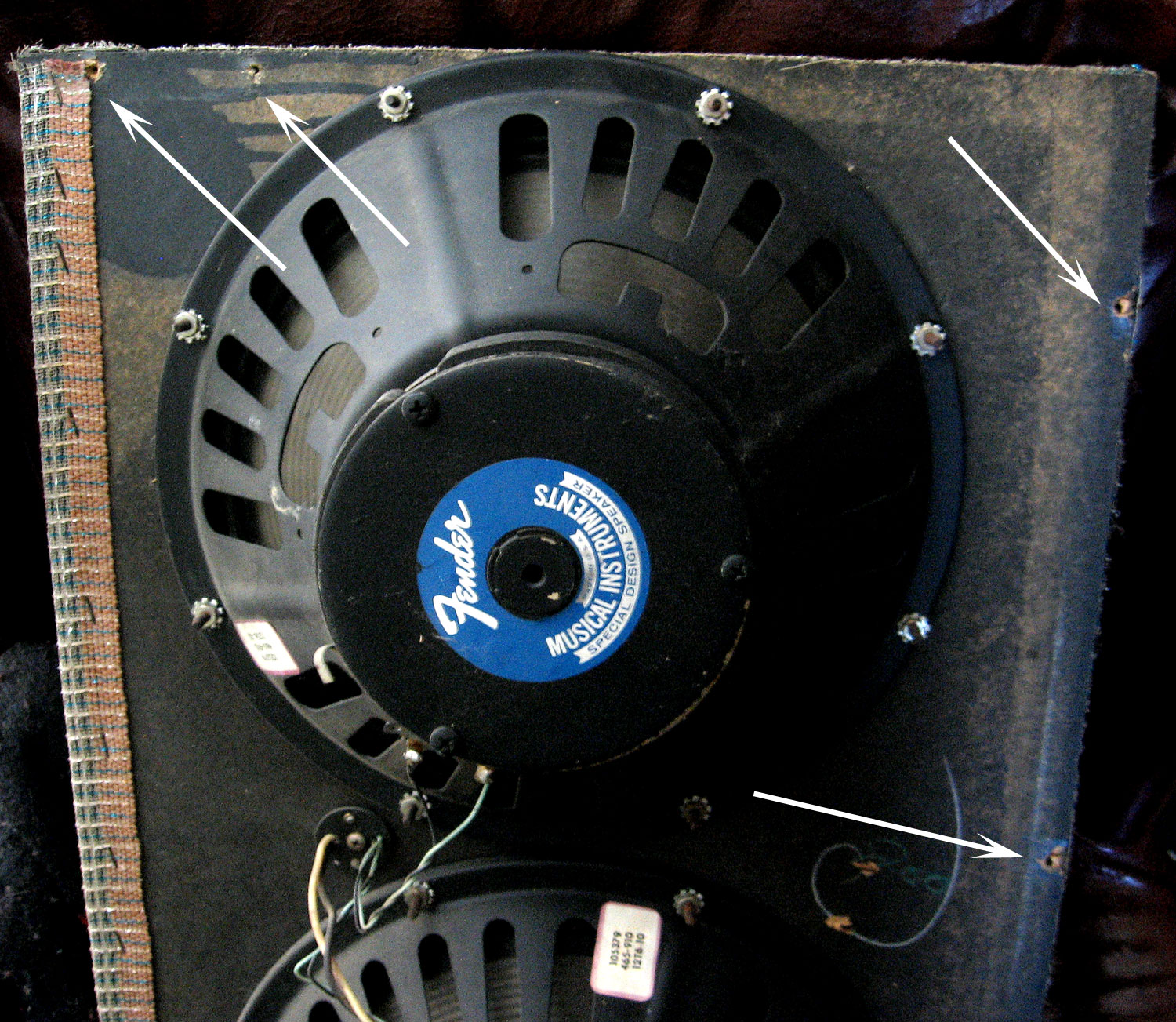

Hi everybody,
I have a 1969 Fender Twin Reverb, and the other day, it's original particle board speaker baffle decided to separate itself from the rest of the amp. It just fell out...
So, I was wondering if anyone might have some inventive ideas about the best way to repair and/or tighten up the screw holes, so the screws will again hold the baffle in place.
Thanks in advance,
LDC

Thank you all for the comments and good ideas. Leemo,I've successfully used the matchstick and glue trick on wood furniture from time to time, but this is 46 year old particle board and it's a bit too unstable and crumbly.
So far, I think I'm going to try to stabilize around the holes with "GLIT" as Geeze suggested, then fill with Bondo as Phil_S suggested. I went to the local auto parts store this afternoon and asked about binary putty: no one seemed to know what I was talking about. They did have 1 and 2 part Bondo, but the smallest size was one quart. Guess I gotta keep looking...
Aurora, I'm not sure how to go about " changing to machine screws and tagnuts or just washers and lock nuts" without disturbing the grill cloth which is quite a tight fit across the frame. Any suggestions would be appreciated.
