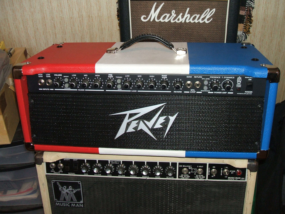

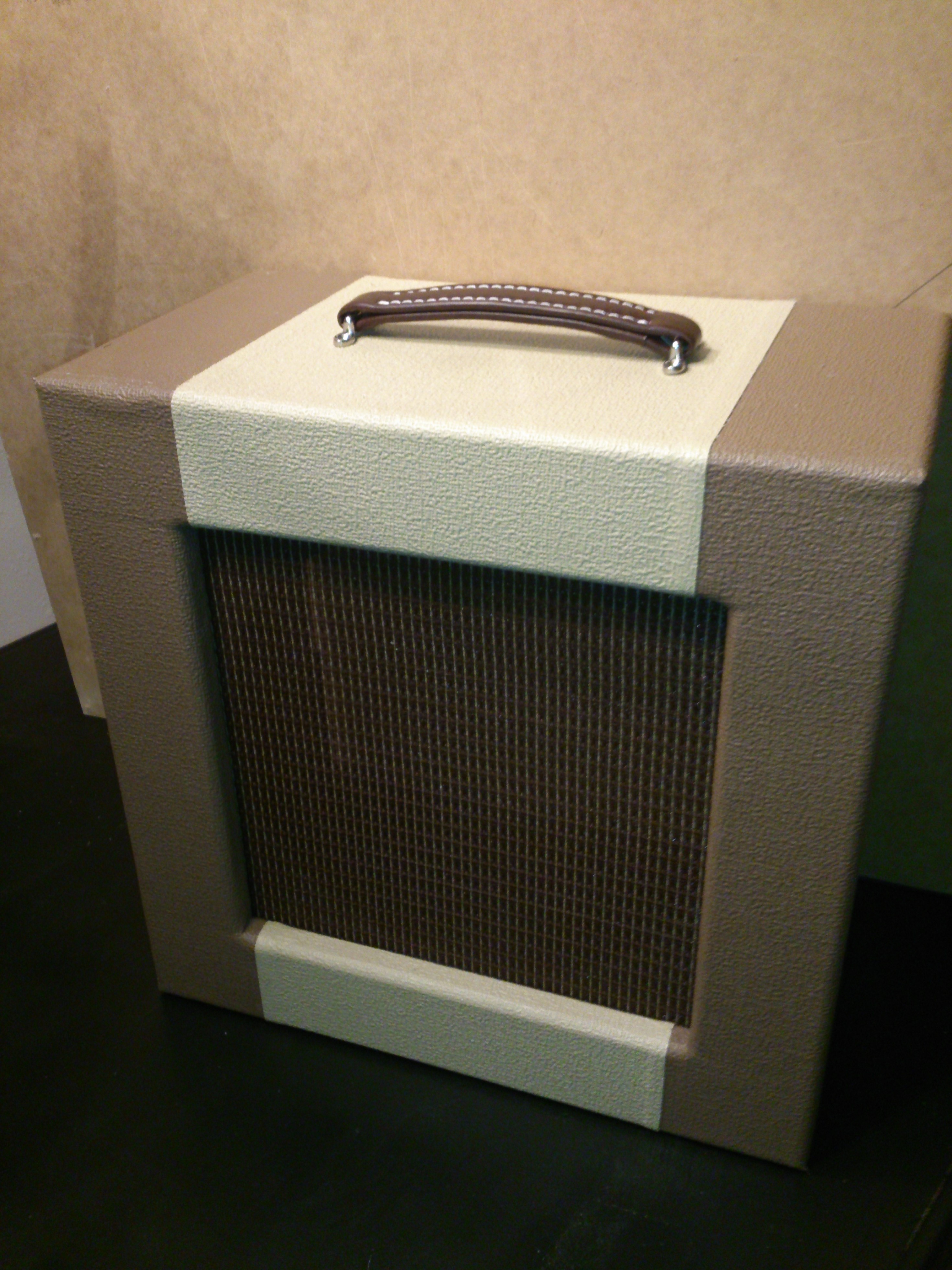

I've not been brave enough to attempt to mate 2 different colors yet, I have overlapped them with success though.

That looks good from here Bill. I'm still trying to lay this all out in my brain. My tolex and grill cloth just arrived today. I just realized that the cab I built has a face frame about 2" wide so I have some more figuring out to do.

@ billmoore: hey!!! that peavey job certainly looks good :D
Plus it must be the most patriotic head I ever saw :)

Thanks, Juan, also appreciate the tip with PVA glue!
The little Peavey belonged to my nephew, (who is no longer with us), so I wanted to do something special with it. He had tossed the amp out of his truck taking a shortcut down a mountain, so the (sawdust) cab was trashed.

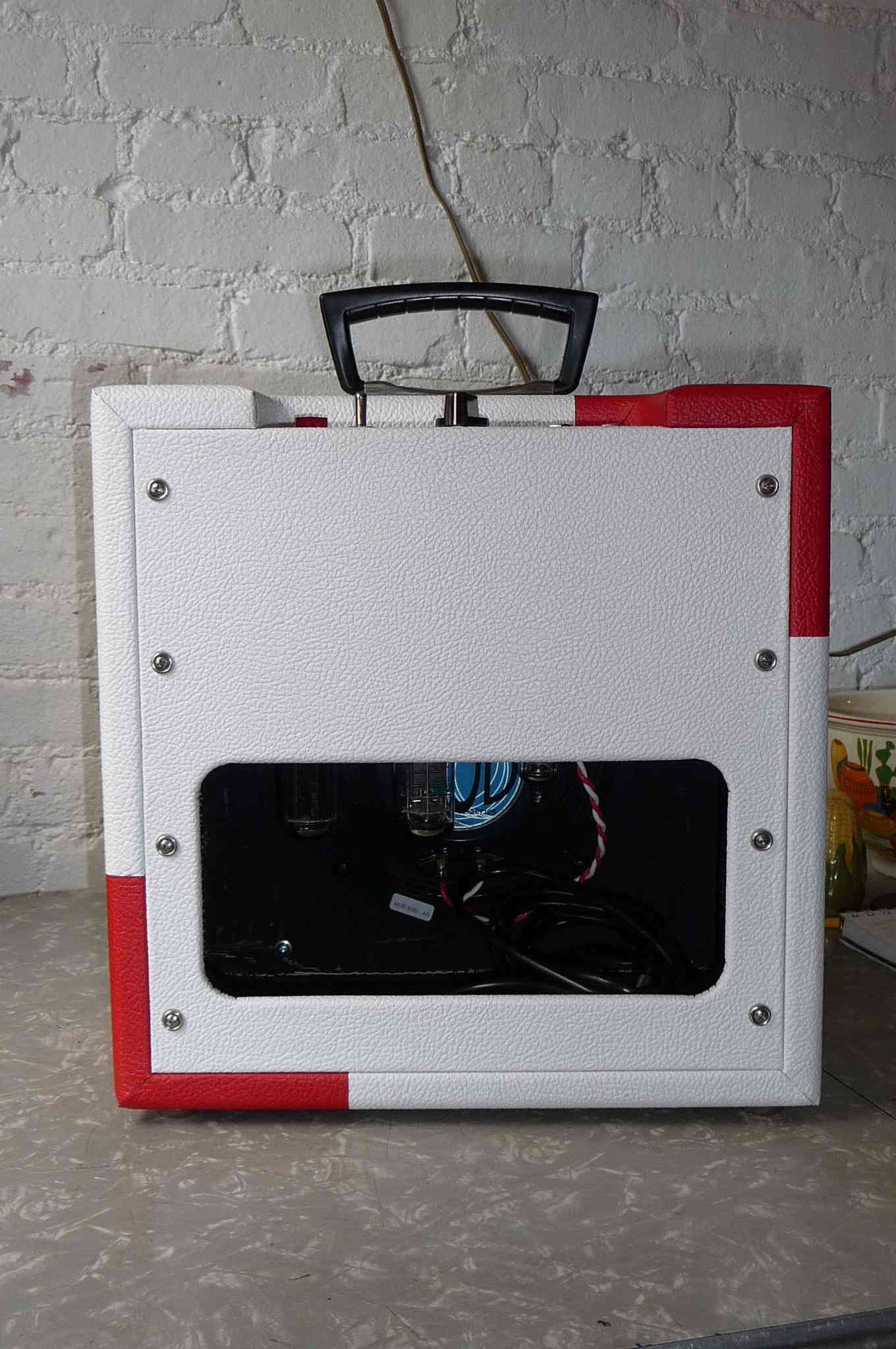

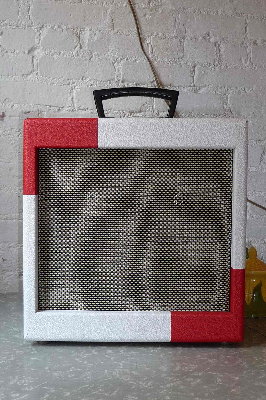

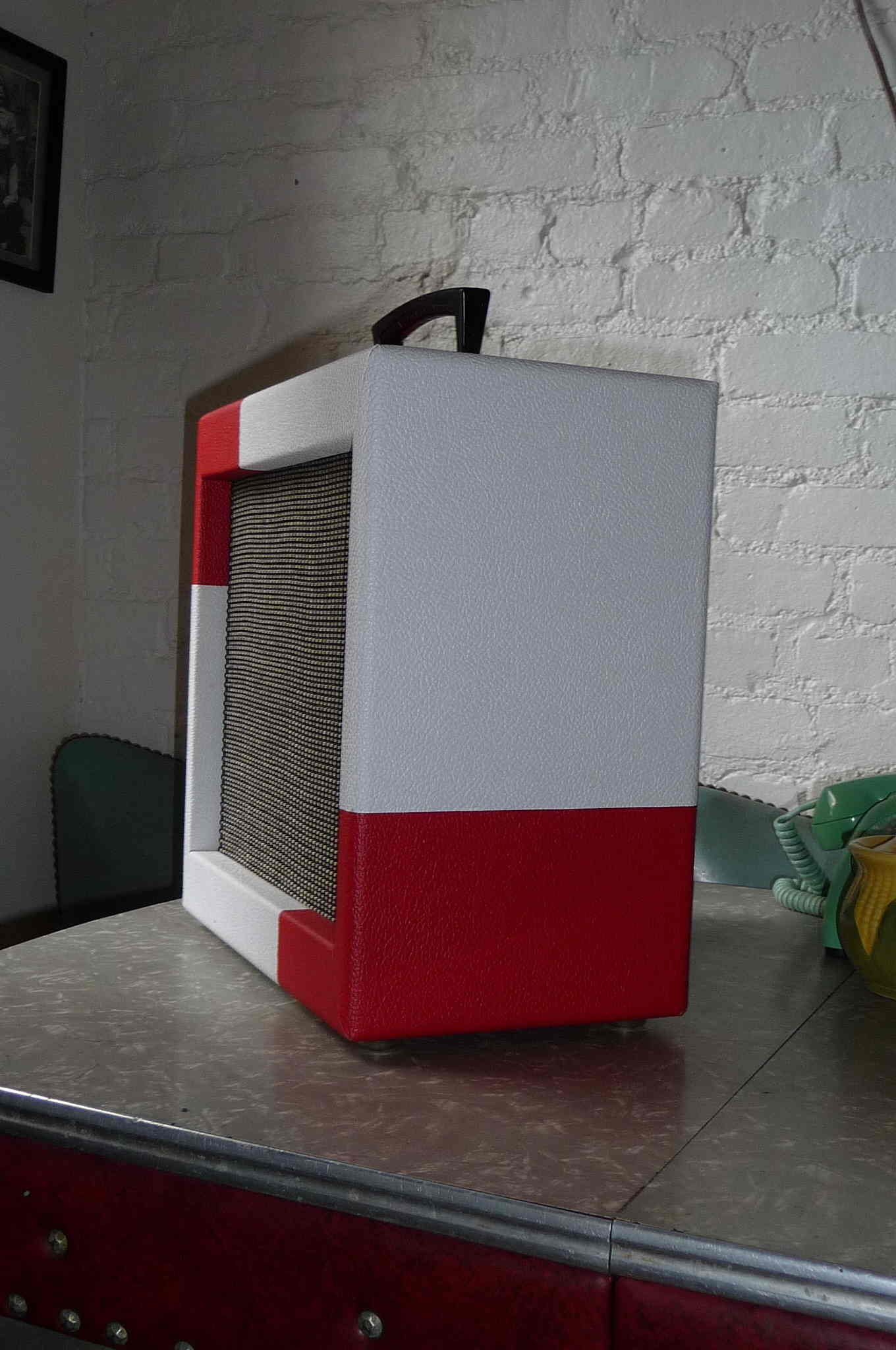

The way I did it is very easy, I overlapped first, used blue tape and made a hinge, cut through both using a square, removed the extra underneath, and glued it up. Came out seamless. I think I first glued and allowed to set up ~3/4 of the first piece, say white, then did the red with the tape hinge. Use a knife with break off blades and break them off often. Anything straight is easy, it's the f'ing corners that are hard.
Not sure I would have chosen white & red next time.

Post by Bill Moore »
That looks really nice, rp!
