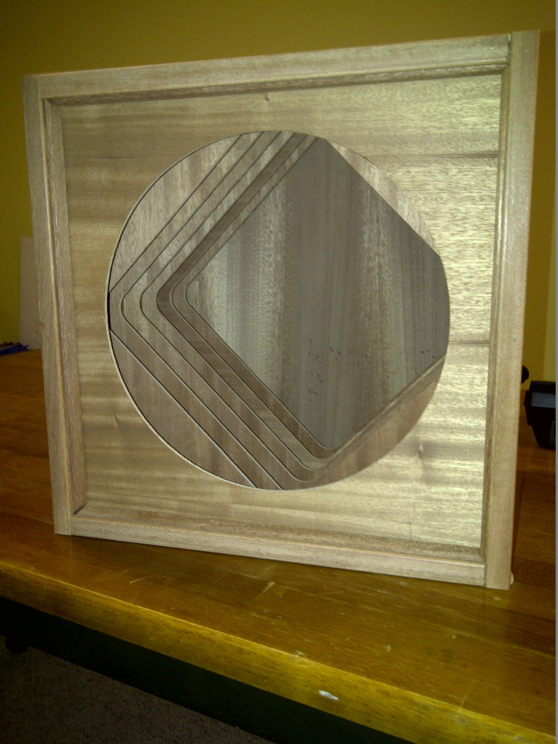

Re: Cab Resonance
Geeze:
This was my try.
Re: Cab Resonance
Come on now John, you tease. How did it sound? How much did it weigh?
That is a clever design and wood work.
Blackburn
Posts: 1765
Location: Texas
Re: Cab Resonance
Post by Blackburn »
That's a beautiful box right there. I've not yet had a chance to try any of the above methods, but plan to.

NickC
Posts: 1814
Location: Upstate New York
Re: Cab Resonance
Post by NickC »
Cantplay wrote:Geeze:
This was my try.
I've never seen anything like that. It sure looks fantastic. How does it sound? What driver works best in it?
