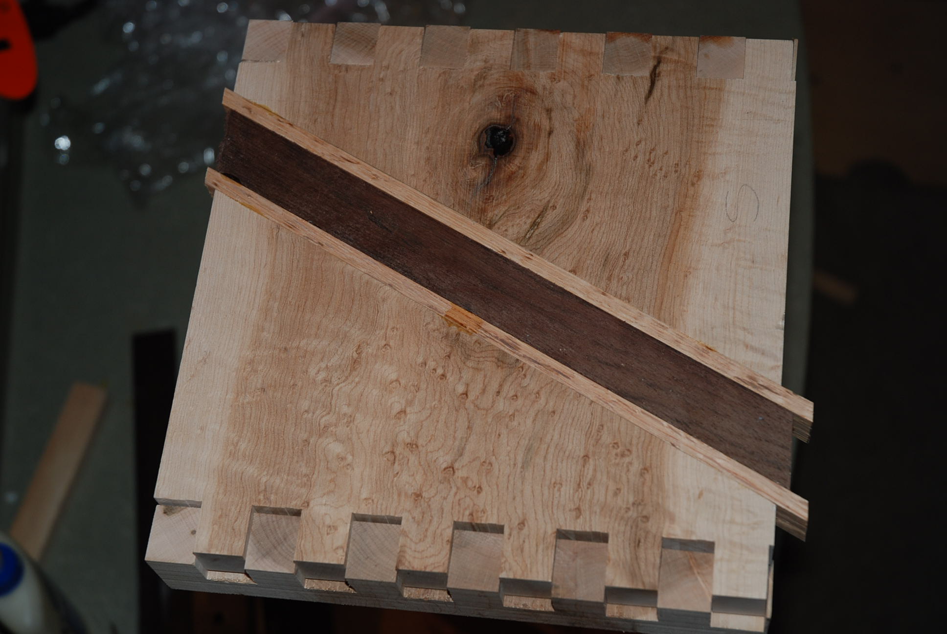

I have a new Frenzel head that needs a shell to protect it. Whilst at a guitar builders guild meeting I found this maple hiding in the wood stack [we meet at a Rockers - devious buggers!]. Cut to size and sanded I cut the finger joints today. Did a really good job on the joints - not so good on the measuring. :shock:
The sides are 1.5" shorter than they should be giving me about .125" clearance on the 6L6's. Not enough for heat dissipation even with a semi vented front panel. Luckily I have more maple.
I will edge it with walnut. and oil as usual. I thought briefly of cutting vents in the top but I can't bring myself to do it.

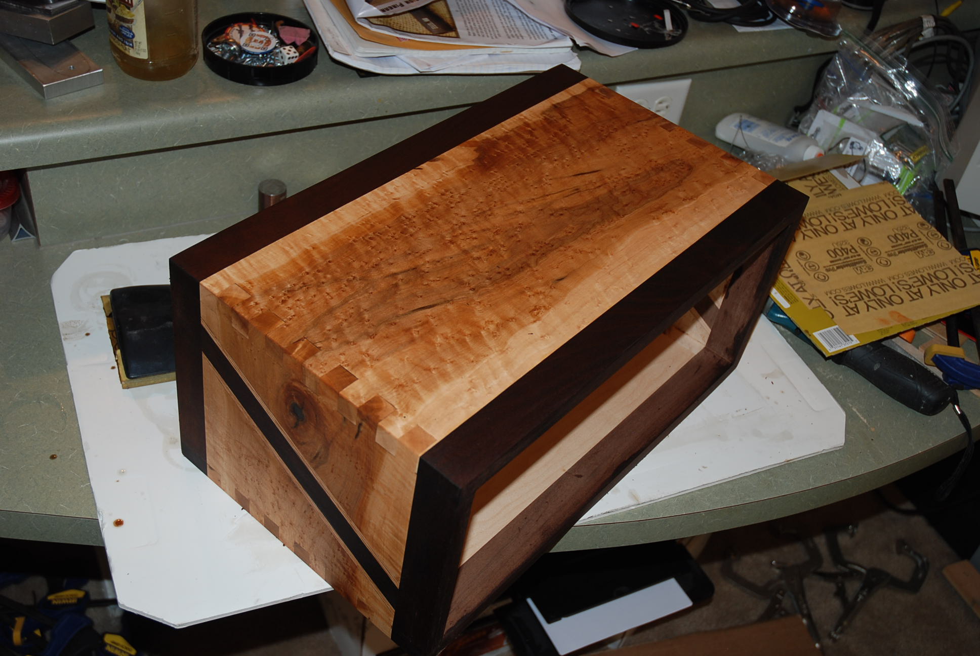

After much contemplation about the folly of tempting the finger joint gods to smite a sinner like me I decided for a decorative feature rather than cutting more maple. Being an opportunistic cockroach [some might call it lazy] I took advantage of a spare 1" wide walnut and some 1/4" red oak laying about. Sometimes those 'I might use this someday' purchases of wood I really didn't need come in handy. Back on track! On to the drum sander for more thickness reduction.

Re: Birdseye 'low rider' head shell
Good save.
If you have enough, lay up more stock the same way, oak/walnut/oak as a strip, round it and slice into knobs.

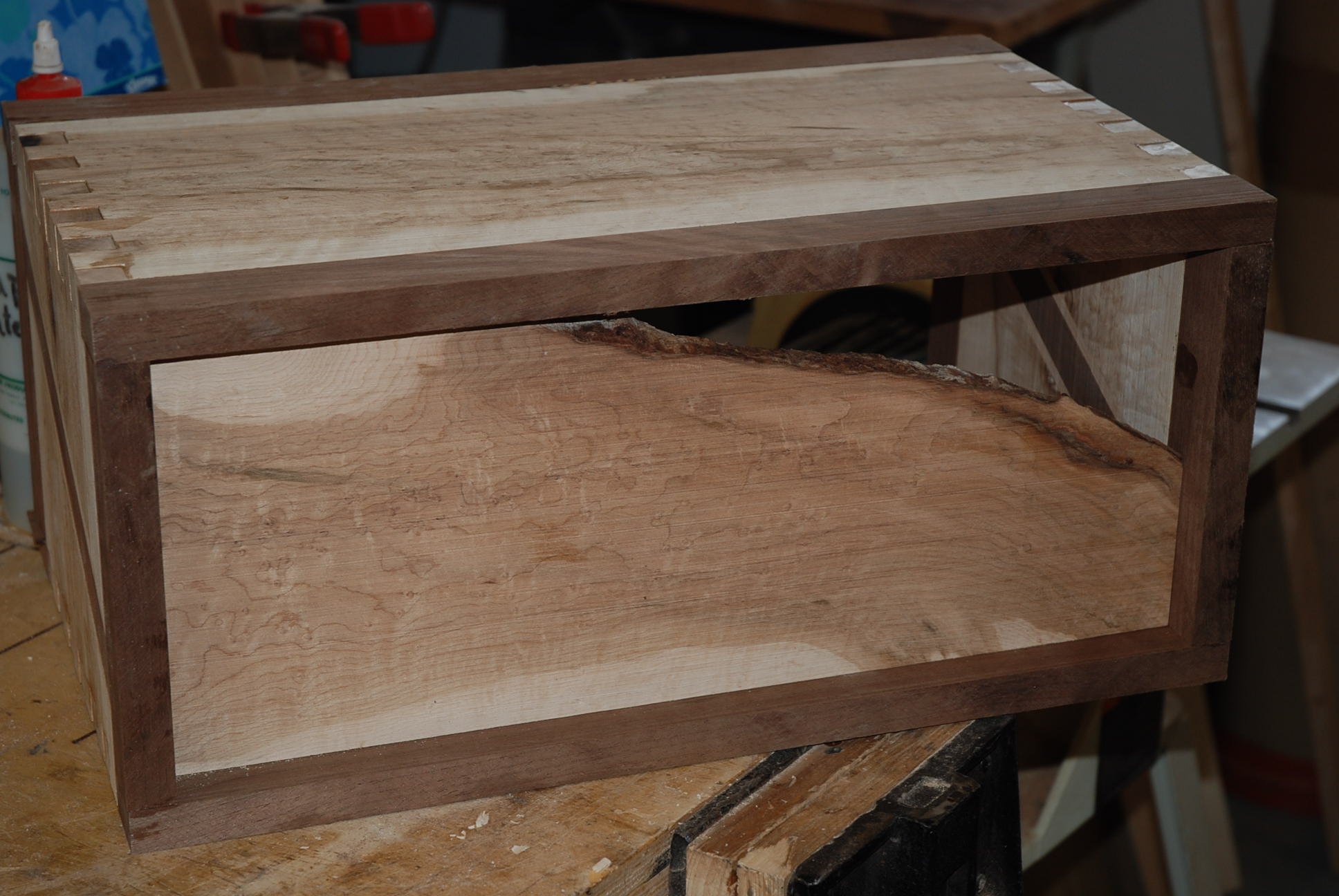

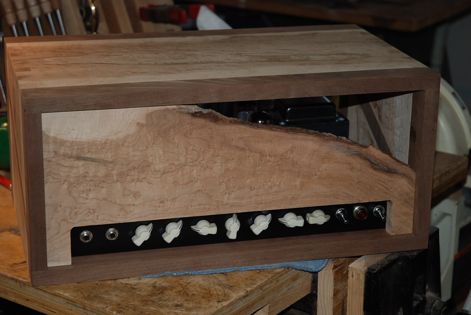

Sides assembled and trim glued on. Probably 1/2" rout the outside edges. On to epoxy gaps and cut front panel.
I've never mounted a head in a shell. Any recommendations?

Oh, I see now where you were extending things, not like my picture at all. That looks fantastic BTW. I love walnut.

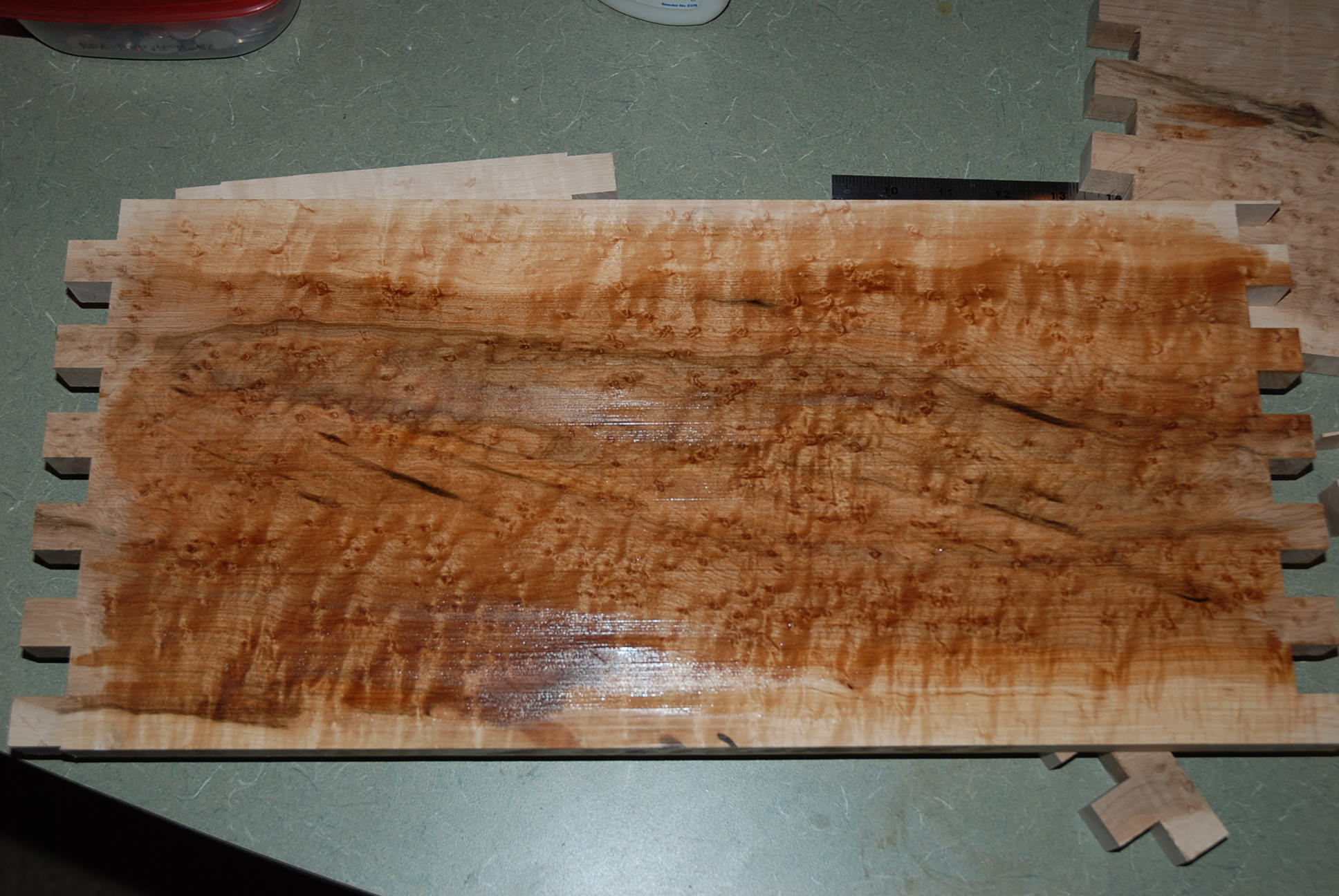

Finish sanded to 220 on to slurry sanding then oil, oil, oil.
