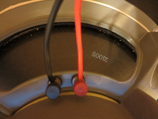

Almost forgot - check the phase is the same on both with a battery.
Push or pull on the positive half cycle is open to debate.
They are backwards to most normal speakers though.

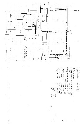

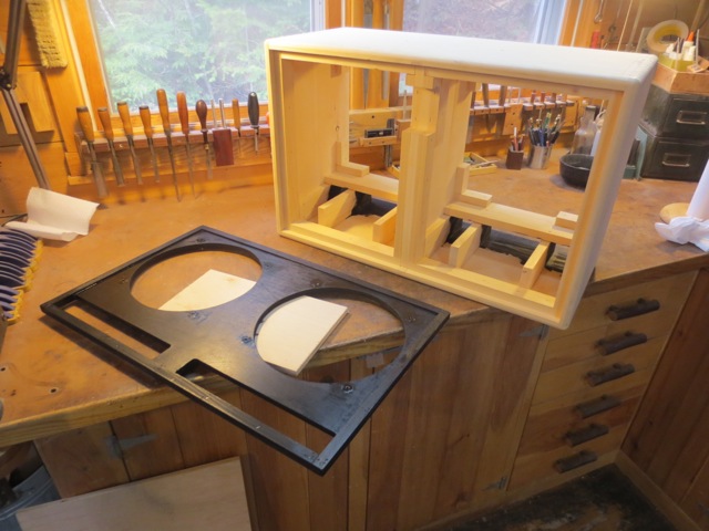

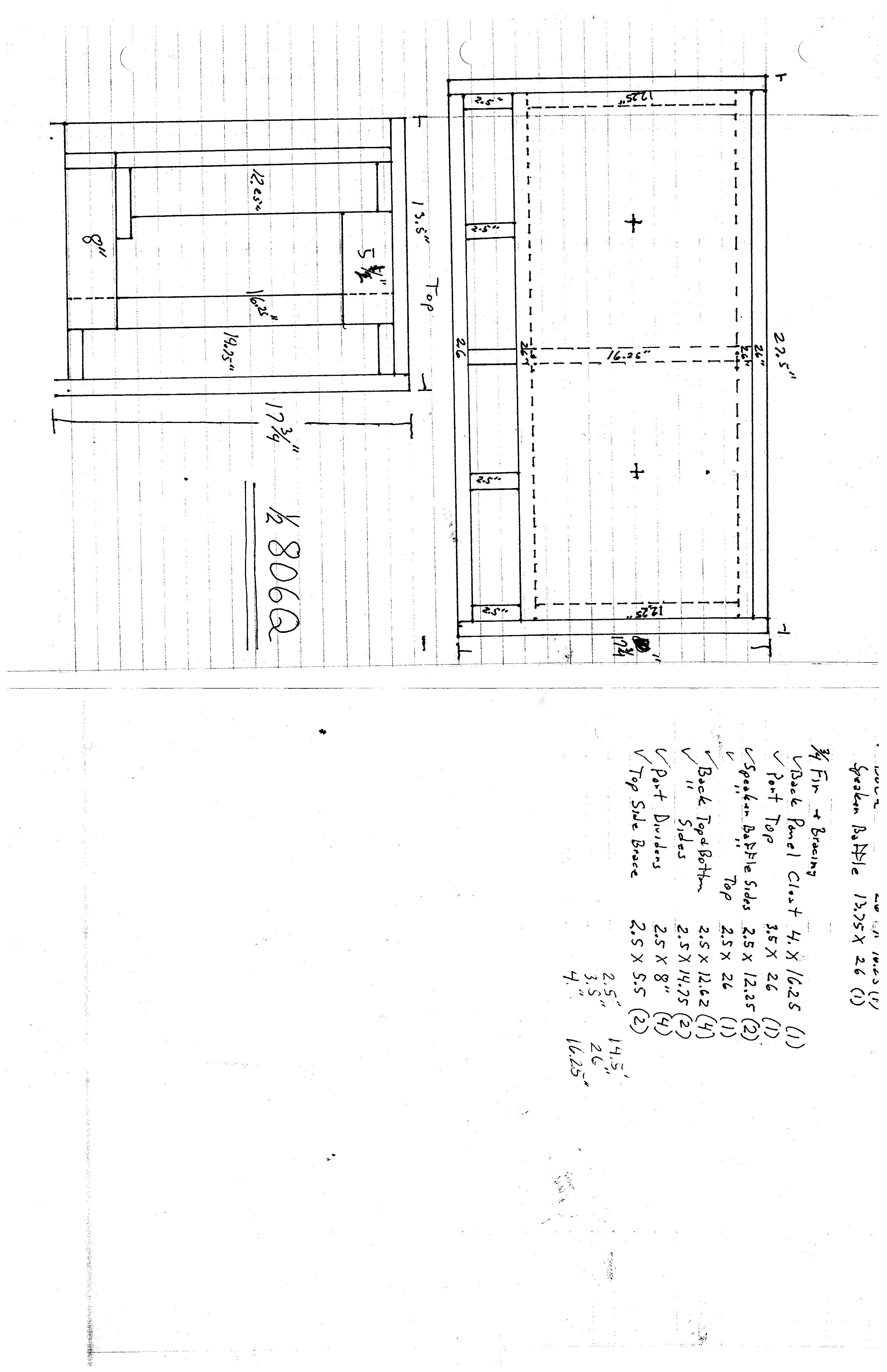

Speaking of Thiele style cabs, do you guys know where to find the plans to build one? And would simply doubling the width work for a 2 x 12?
Re: JBL D-123
http://www.google.com/url?sa=t&rct=j&q= ... 8703,d.aWcLaurent Brondel wrote:Speaking of Thiele style cabs, do you guys know where to find the plans to build one? And would simply doubling the width work for a 2 x 12?
Designed for the EVM 12L speaker. I have used them with K120s and Weber Neomag 12s, and they sound excellent.
With an EVM 12L in it, built to specs, the cab weighs 38lbs.
Hefty, and a ton of sound.
Re: JBL D-123
A couple more comments --
1. 2x12 designs borrow half of the 4x12 Thiel design so search for that.
2. Using EV dimensions etc. works well with similar speakers, which D123 really isn't; so consider in the style of vs actual clone or get T/S numbers for D123 and do the engineering to dimension correctly.
Best .. Ian

I intend to put the D-123 pair in a couple of brownface Princetons, I am hoping it will tame a bit the mid-heavy tone.
I am asking about the Thiele design for one EVM 12L Classic, and a pair of Eminence Beta 12 A I use for bass with a mid '60 Carlsbro head and currently a Bandmaster cab, which is not ideal.
I am trying the EVM 12L Classic in a Deluxe Reverb now, not crazy about it at all -the treble cap is not clipped-, the amp sounds so much better (to me anyway) with a late '60 Jensen C12N.

https://www.jblpro.com/pub/manuals/enclgde.pdf‎
This link will take to JBL cabinet dimensions, just another take.

I have built a few of the 1/2 4-12 cabs, never used anything but EVM's in them though.
