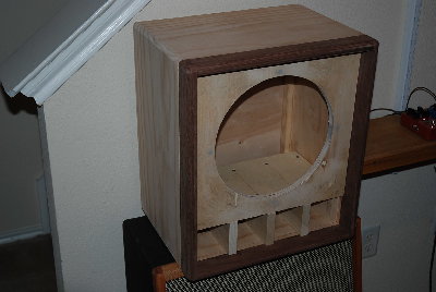

I built this for a friend as an experiment. All of the pics I found on the 'net were externals. My question is what did Mesa do on the vented portion? My understanding of low frequency development is the longer the path the more developed or pronounced the bass is - limited to the length of the wave[s]. For this reason I put a shelf on top of the baffles and left an inch slot at the rear to channel the sound waves to the back before moving forward. Did Mesa 'cap' the vent and if so how big of a slot did they use?

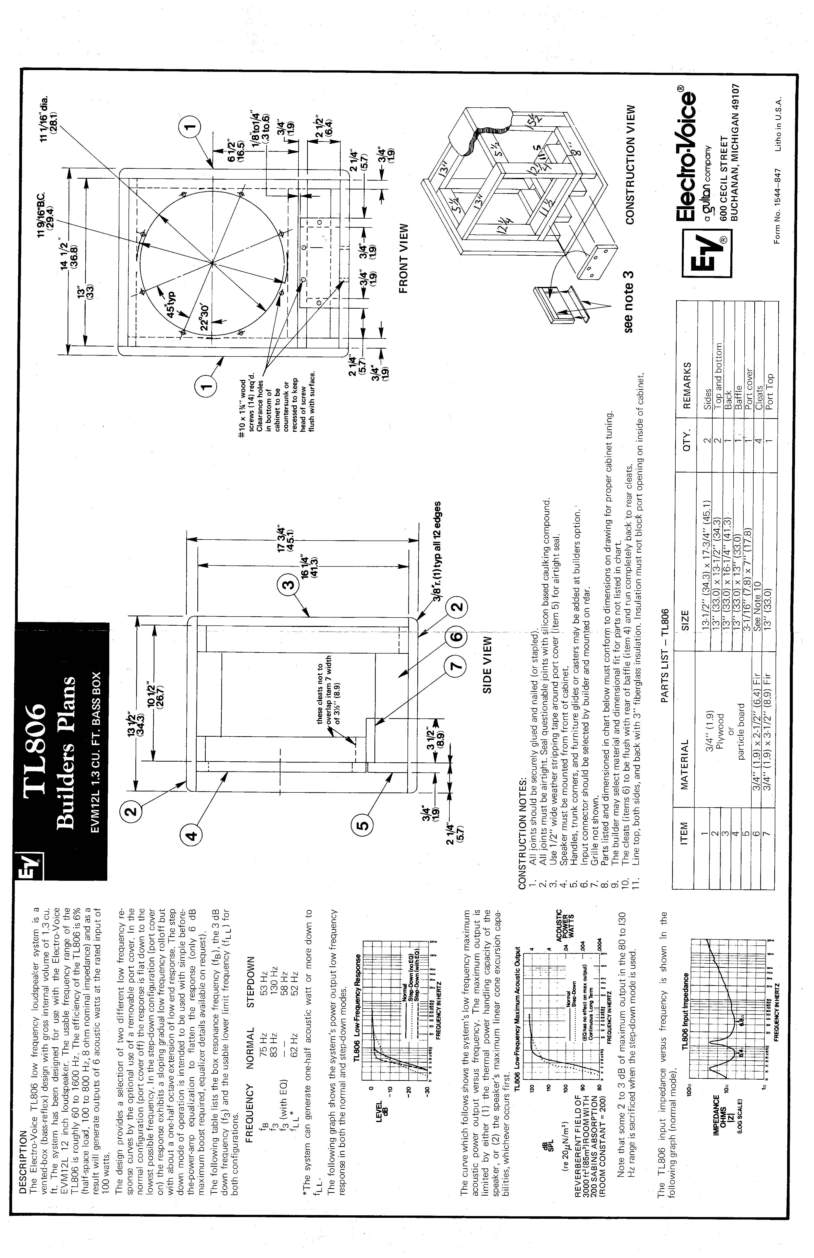

I have the EV TL806Q plans and the ports are only 3.5 inches deep and do not get anywhere near the rear wall. What made this design so notable? The cabinet designed with T/S parameters coupled with the EV's or just EV's themselves?
The plan here is to put a EV in it and let her rip.

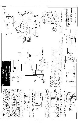

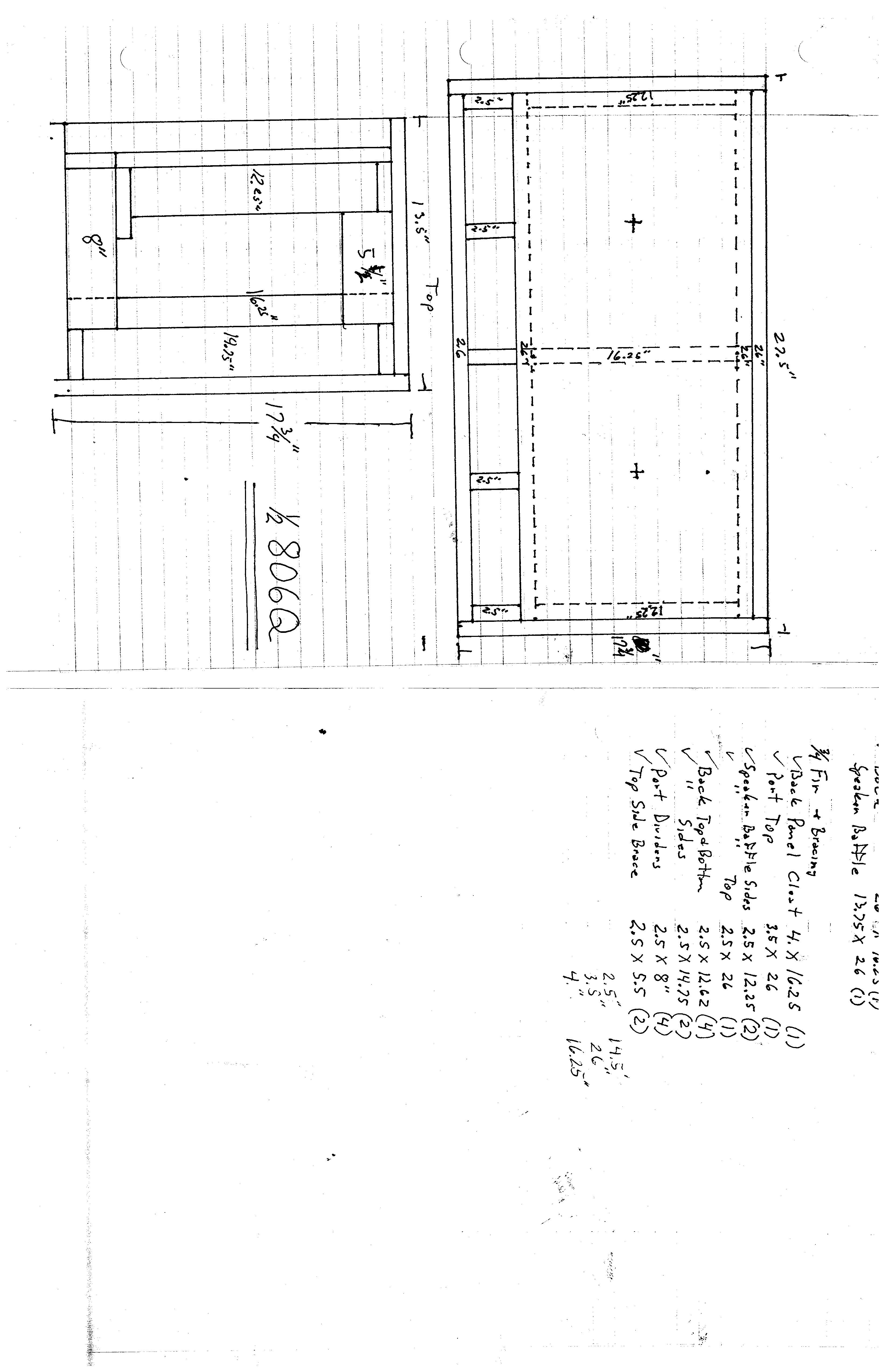

Here are the TL806 plans, (sorry, I added a few dimensions to the plans when I built one)
Re: Mesa style Thiele cab question
Plans?!?! We don' need no stinkin' plans! Oh, THOSE plans. Thank you Bill.
If the magic number is the 1.3 cubic feet = 2304 cubic inches I'm at 2309.625 cubic inches based on my version of the Mesa dimensions. They were a bit wider and shallower than the EV specs.
I plan to experiment with the shelf / one inch slot at the rear and the 3-1/2" shelf the plans call for.

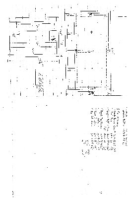

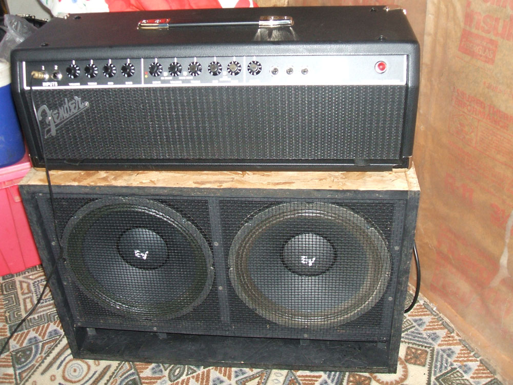

Here is my take on a 2-12 version. I built some back in the day for mids for our R&R PA. Am using one now for pedal steel guitar.
I always wanted to build a 2x 12 version of a TL806.
I believe several guys here have done it.
I just didn't want to spend the money and not have it sound good.
Do you have any insulation in yours Geeze?
This file is in German but the graphs are in English.

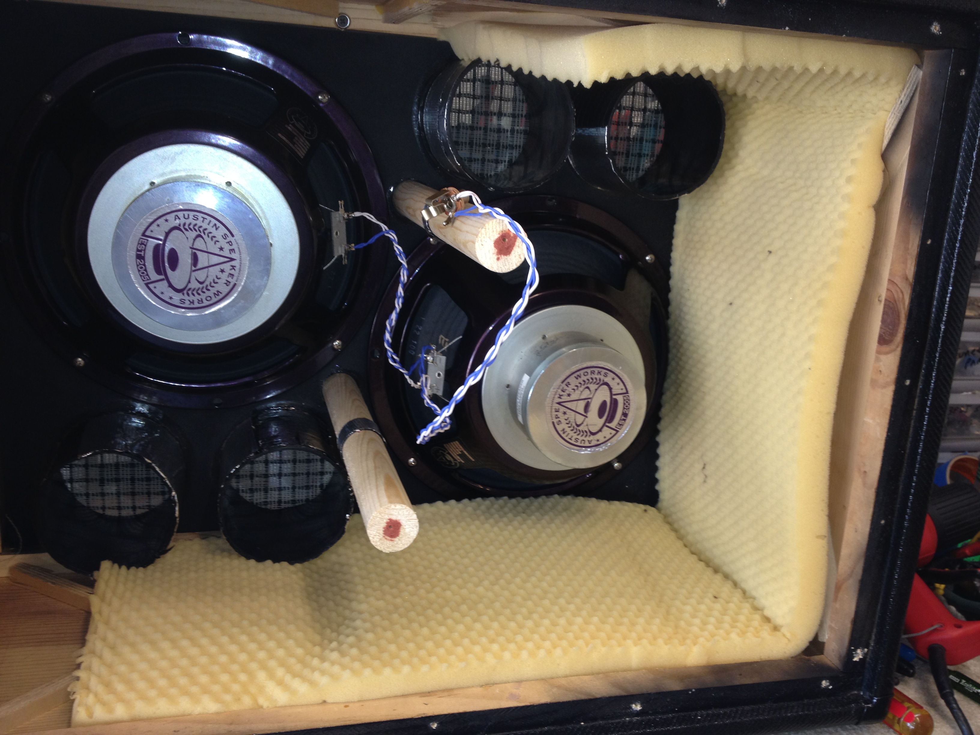

I have built several 2x12 thiel cabs. loosely based on the EV tl806 dimensions doubled. I deviated alot . I used solid pine with 1/2 ply baffle and back. 4 ea round 4" ports. secret insides, ha ha. Sounds awesome I have been told.
Interesting, Billy.
Is that a 12" and 10" speaker?
What is the clamp like thing around the posts?
Secrets. its not a clamp but vibration dampning. also around the ports . if you look very close you can see some of the cross bracing peeking from under the foam insulation. The cab is very light but very stiff, those are 12" ASW elegante. One of the most beautiful sounding speakers I have ever heard.Structo wrote:Interesting, Billy.
