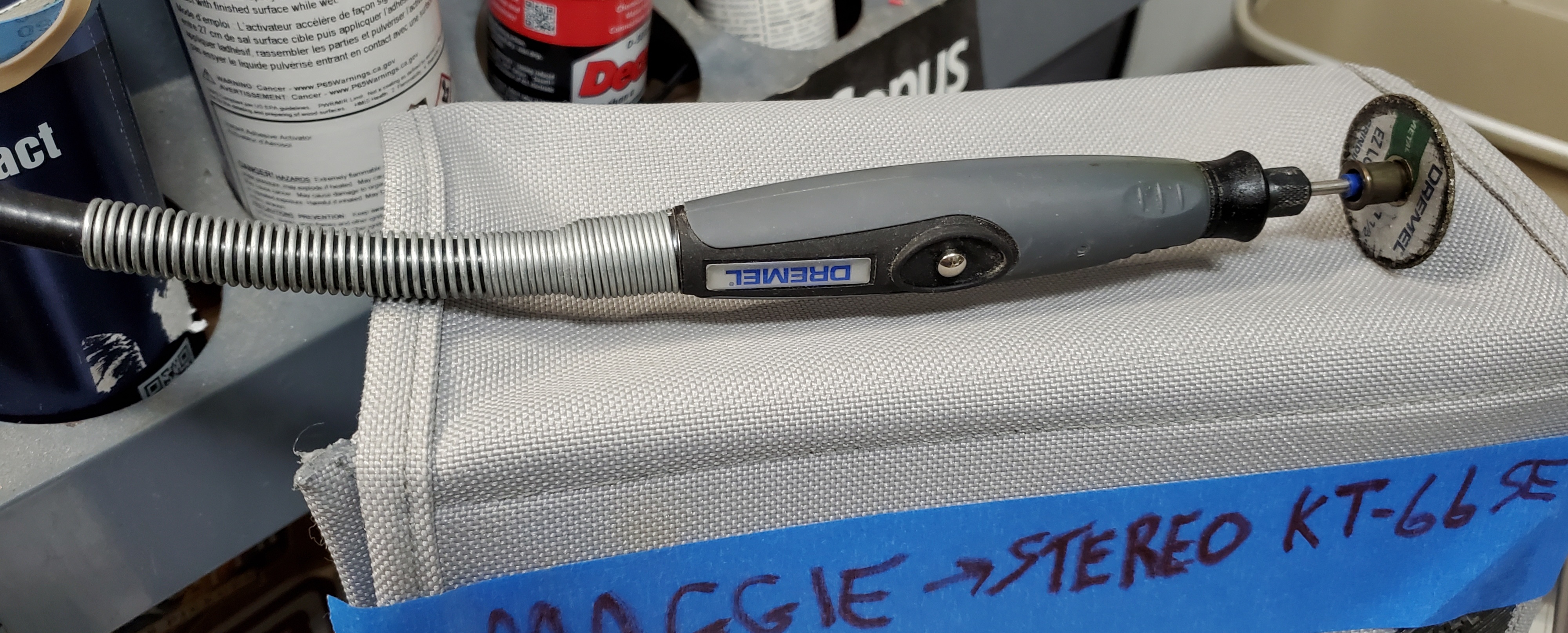

I haven't had any issues with the Dremel cut off wheels. The thin fragile flat disks yes, but not with the thicker reinforced ones made for metal.

About cutting disks: I have always been amazed watching some people doing precise cuts with that. I know that works!
For some people it does work very well, really, but it's just not for me - yet I sometimes manage to improve my skills doing that, when working on non critical parts.

This dremel accessory simplifies cuts.

I have the same. I only use it to cut my tack welds needing to be redone - generally parts to be re-positionned for the weld tend to pull them out of place, when the metal turns back to cold.

+1 for the Dremel (and a step drill at the corners). Just done a 2mm aluminium chassis like that.
