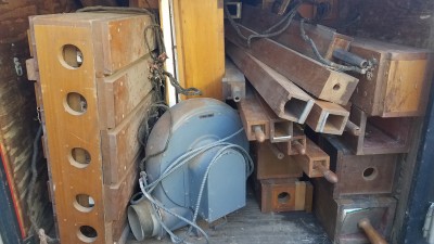

I am currently salvaging a large 1890 vintage pipe organ that was shipped to the west coast from Wisconsin in the mid 1980s and has been in storage ever since. The majority of its 786 pipes will be used for new builds or other organ restoration projects but all the largest pipes will likely be knocked down and the wood reclaimed. There may be a few oddballs in the collection but I'm given to believe most of it is poplar, milled well over a century ago and having spent over 8 decades played on a daily basis. I anticipate it will be far superior to any modern wood available for amp cabinets. If anybody is interested let me know.
