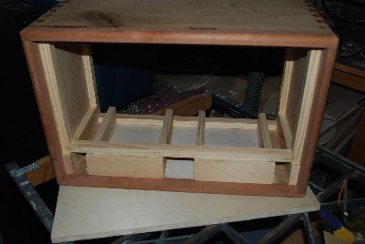

I built a 2x10 Thiele by scaling the 806 plans to 80% [internal volume] for the challenge. Also because my 4x10 weighs more than I want to drag around. I'm smiling as I write this as I remember the Ampeg V4 with 4 Altec 417s - what I wimp I have become.
I built an 806 for a EV12L a few months ago and frankly was underwhelmed. It sounds good at all volumes but not a cosmic experience as I have seen posted [with 3 different amps as well]. My current favorite is the Celestion gold series [12 & 10] and it sounded better to me. I'm not an EV speaker fan but enjoy speakers that add their own flair.
I have come to believe the enclosure is not as important as the amp/speaker interaction. I wonder about the dynamic contrast between 'Producing' the sound via LoFi equipment and 'Reproducing' the sound via HiFi.
