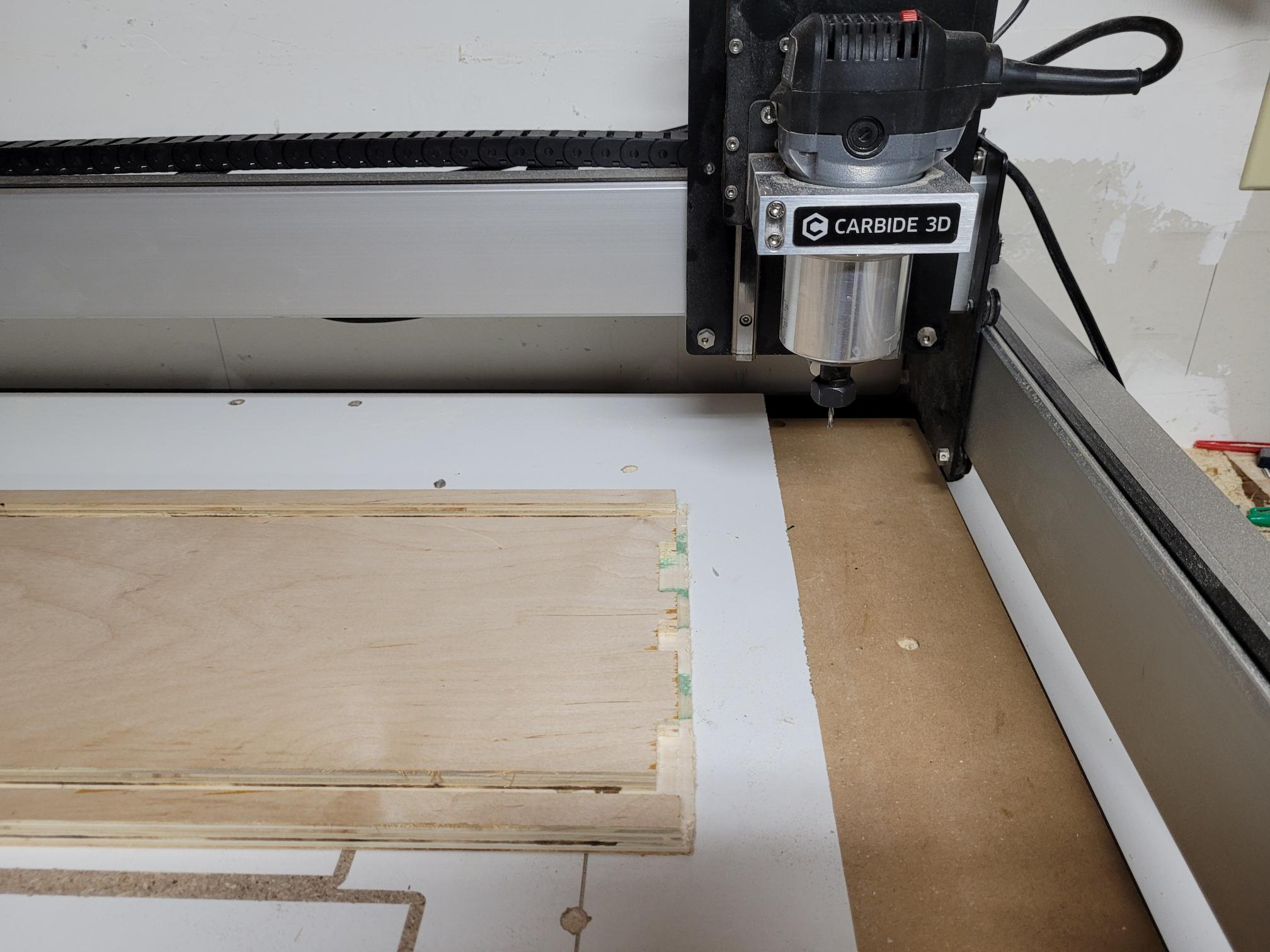

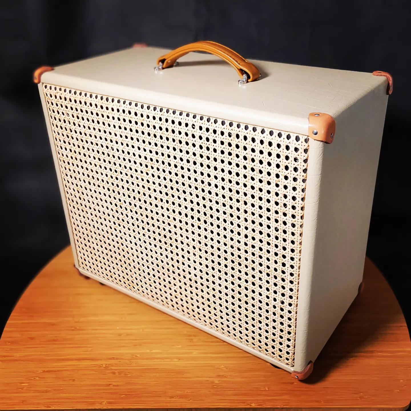

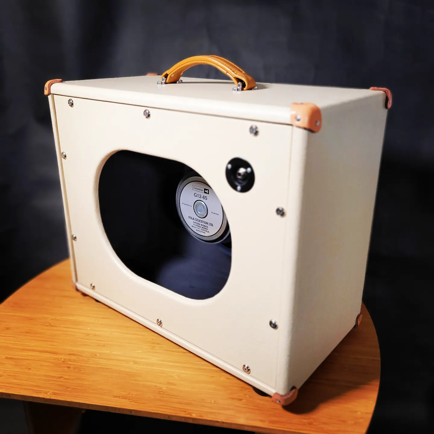

Thought I would show some pics of a 1x12 cabinet I built with my Shapeoko3 XL CNC machine.
I had someone program my cnc software to do all the Blind Finger jointed cuts and then I ran each piece of 3/4 in Birch plywood through the CNC,
I attached a pic of how the sides look when they get cut as well. That was a Mesa Boogie style Bamboo grill that was tricky to work with. It bulges out from the front when you bend it. Its like bending wood used to start a fire lol.
I already want a bigger machine now so I can cut all the sides in one pass!

Can you steam the bamboo grill "cloth"?

Hi Stephen. I used the method shown here in this video below but I may try steaming it next time. I just saw a pic of a Mesa amp with this grill and they actually used black screws with wide heads at sides and corners of the bamboo grill.
https://www.youtube.com/watch?v=aRbnFjrOYYs

Yes I agree!. I rough cut each side and back and front of the cabinet and then let the CNC do all the finger joints and other required cuts. Its a real time saver. This machine came along at the perfect time for me. My dad use to make my cabinets by hand but he is turning 85 now and those days are behind us and its time for him to enjoy his garden and wine cellar!
I will get a larger one this summer to do more sides of my cabs and heads at the same time. Having to load the CNC fewer times will be a big time saver!

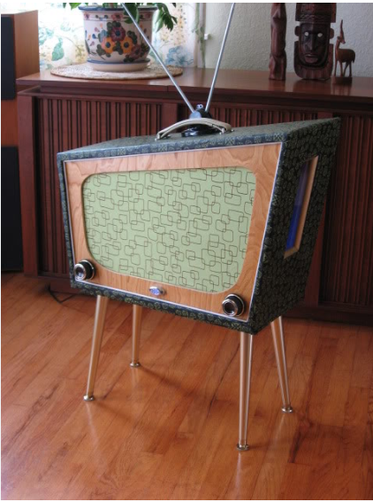

Think you can CNC cut a cabinet like this:
Shown with optional wireless antenna.
Don't these CNC machines cost something in the 6 figures depending on size ?

LOUDthud wrote: Mon Feb 20, 2023 9:47 am Think you can CNC cut a cabinet like this:
I really like that look. That is very cool!
Yes you can definitely cut that with a cnc. Just need to learn the Fusion 360 or Carbide Create software. The later one is easier to learn.

If you can create the shape in any drawing program, then you can cut it in the CNC. I find the way that it can accurately cut arcs and circles to be far easier that to lay it out by hand and hope you cut exactly on the lines. Because I have dust collection set up, I run it all the time indoors, so inclement weather doesn't make a difference... No waiting for good weather to do anything.
Btw... That looks a lot like the Electronic amps that were around a decade of so ago.
