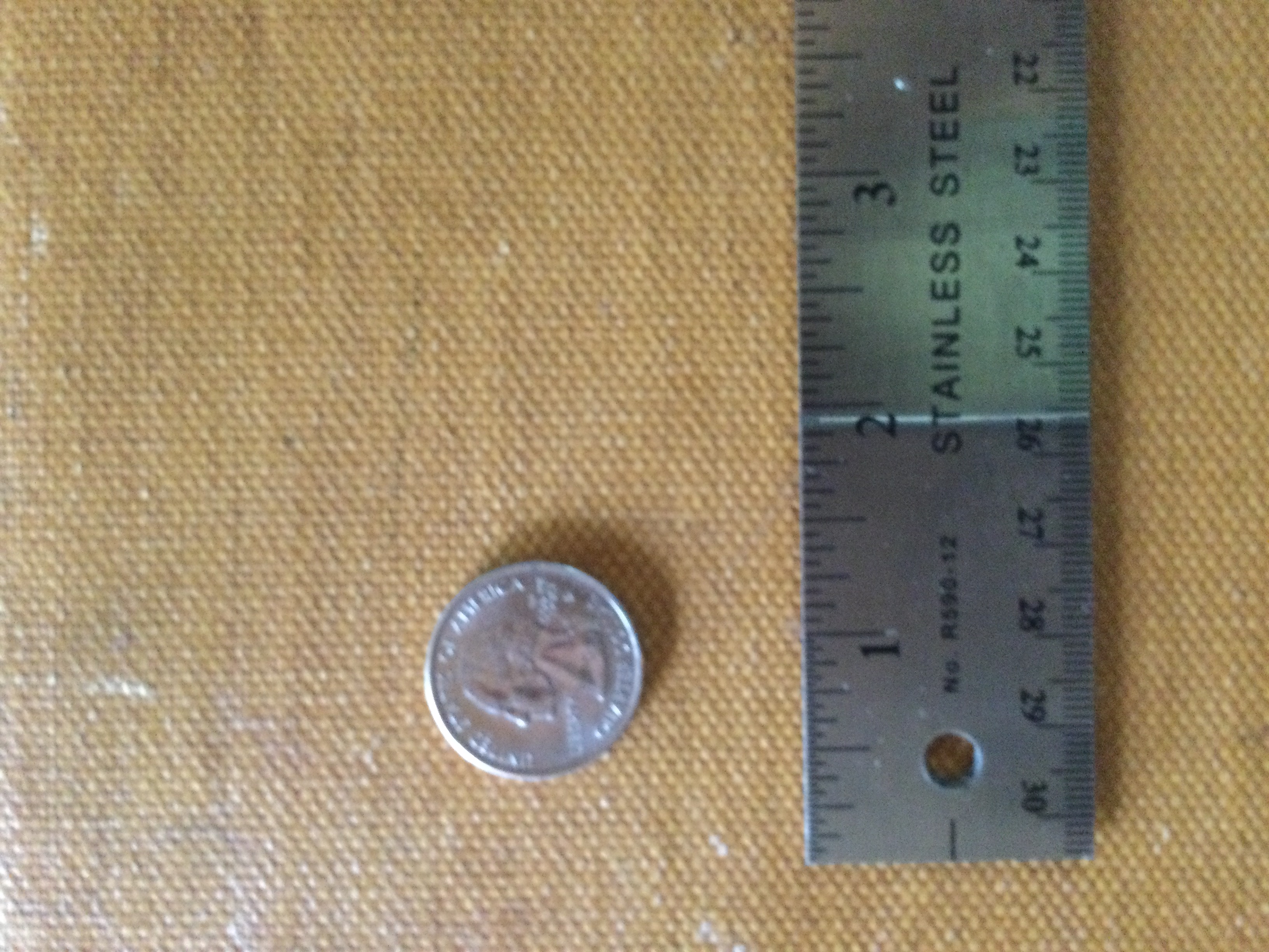

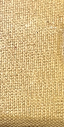

Looking for what seems to be unprimed linen or canvas material used to cover a ‘52 National 1215 amp. Back panels missing so trying to make these.
Weave is pretty coarse - about 19-20 threads/in. Shellac finish. See pics.
So far, striking out with most materials I’ve been able to find. Someone suggested finding old luggage to cannibalize. Maybe easiest route but would prefer to find the material IF I CAN.
50’s Cab Covering material
Re: 50’s Cab Covering material

I have tried the art supplies route and unprimed linen canvas of varying weights/weaves with no luck. Canvas duck in heavier weight seems closest but not quite a match. Will post more re the trial-and-error journey and hopefully any Eureka! moment.
