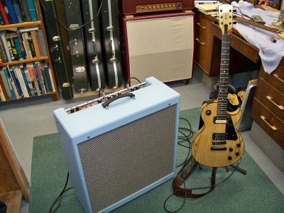

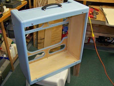

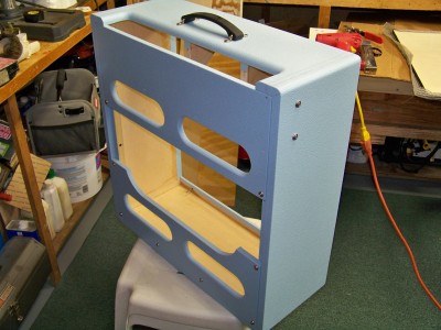

The narrow panel cabinet's baffle is secured to the top and bottom valences with a screw in each corner. I put a rubber washer between the baffle and the valence. Let me find a few photos - one I did in plywood. I used a 15" speaker on this one.
Re: Spruce 1x10 cabinet
What a nice looking cabinet.
What colour is that?
