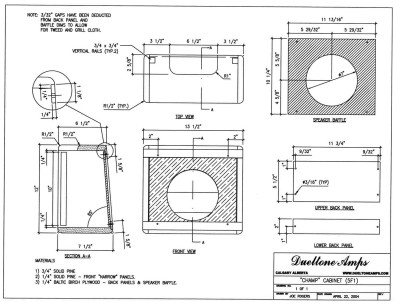

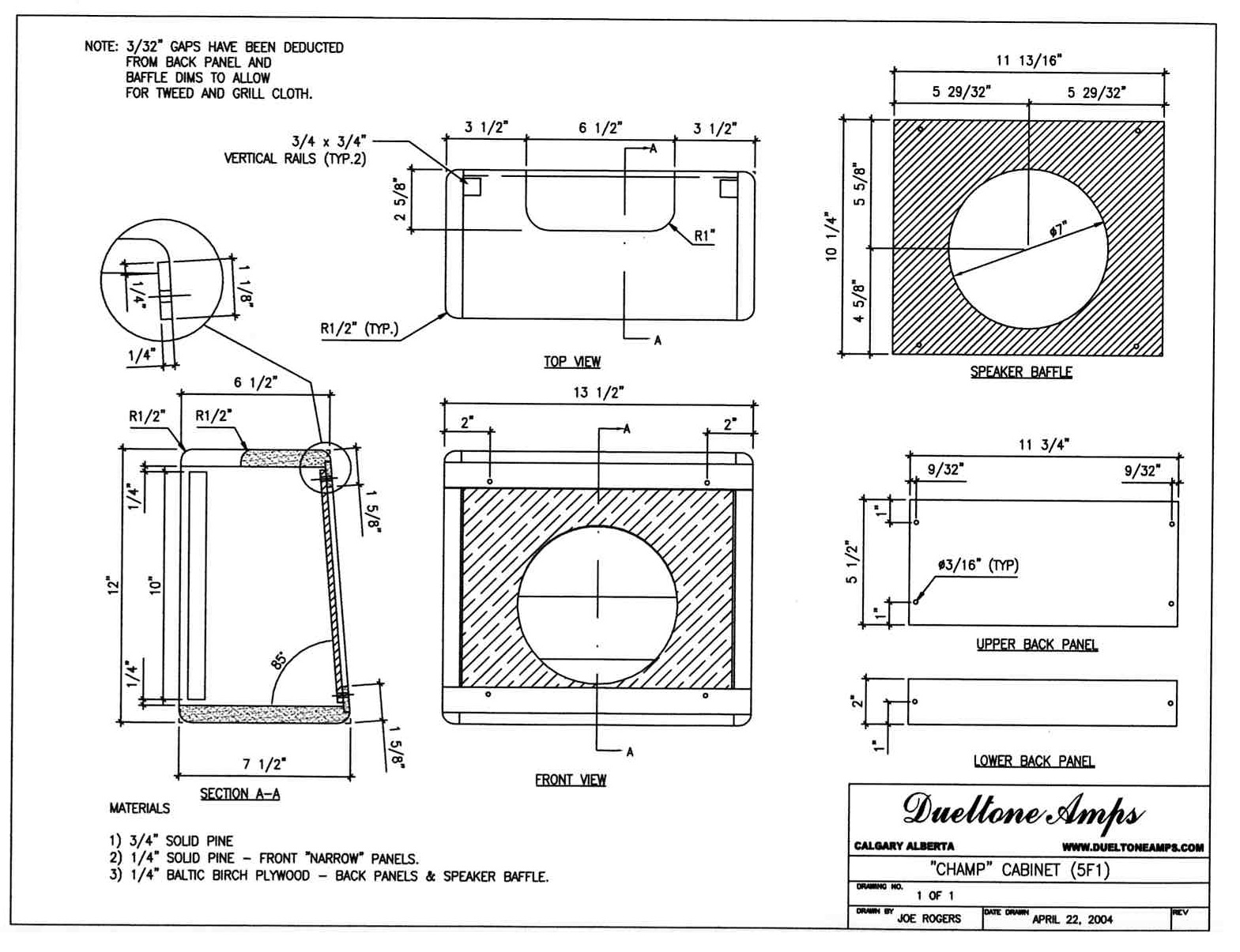

Mojojtm wrote: Tue Dec 21, 2021 8:52 pmI asked how to build a Fender Champ guitar cabinet
Fender Champ cabinet plans from the web:
Champ cab (5F1) DuelTone.pdf
(137.01 KiB) Downloaded 1305 times

Thanks a lot that helps

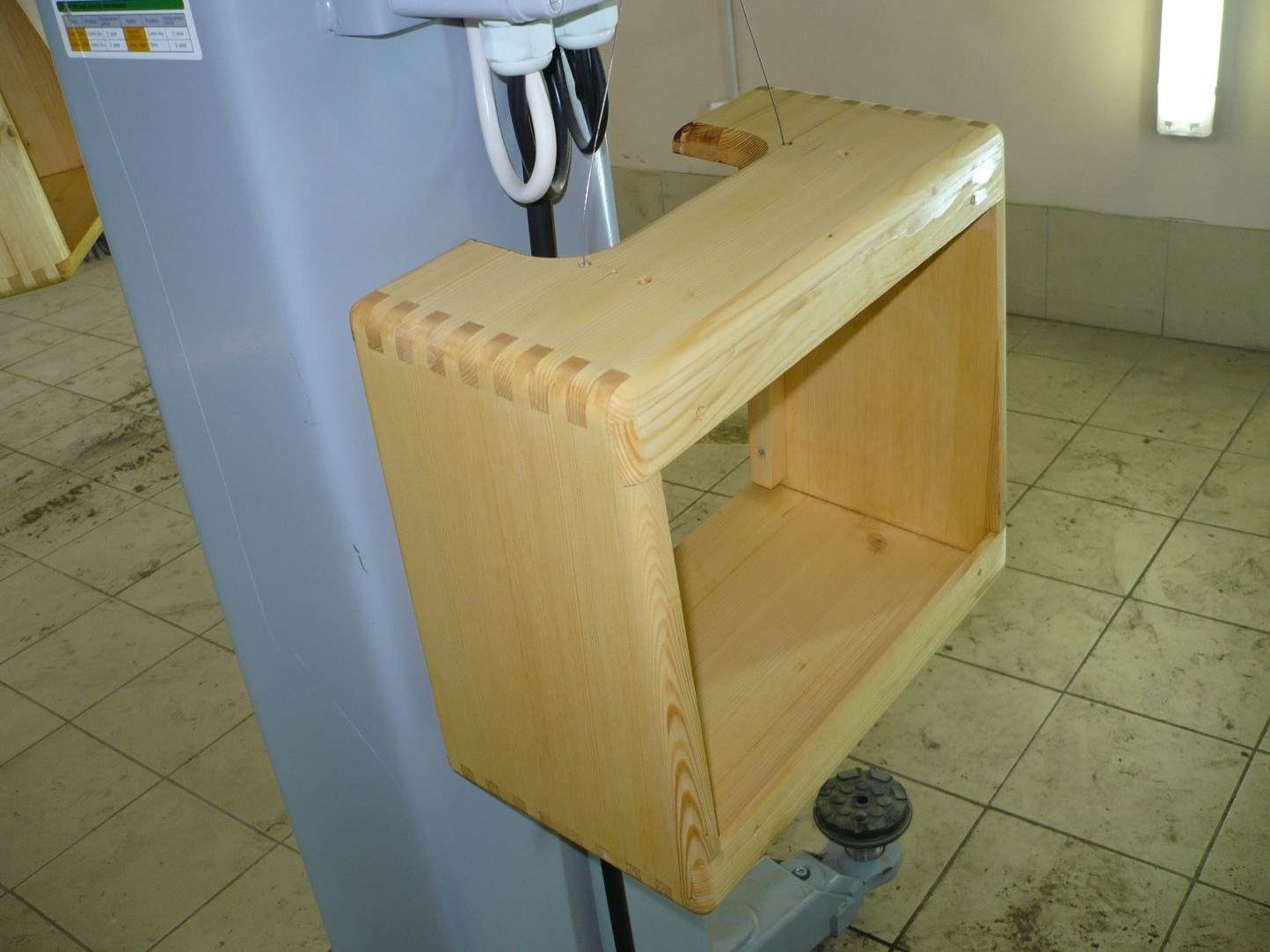

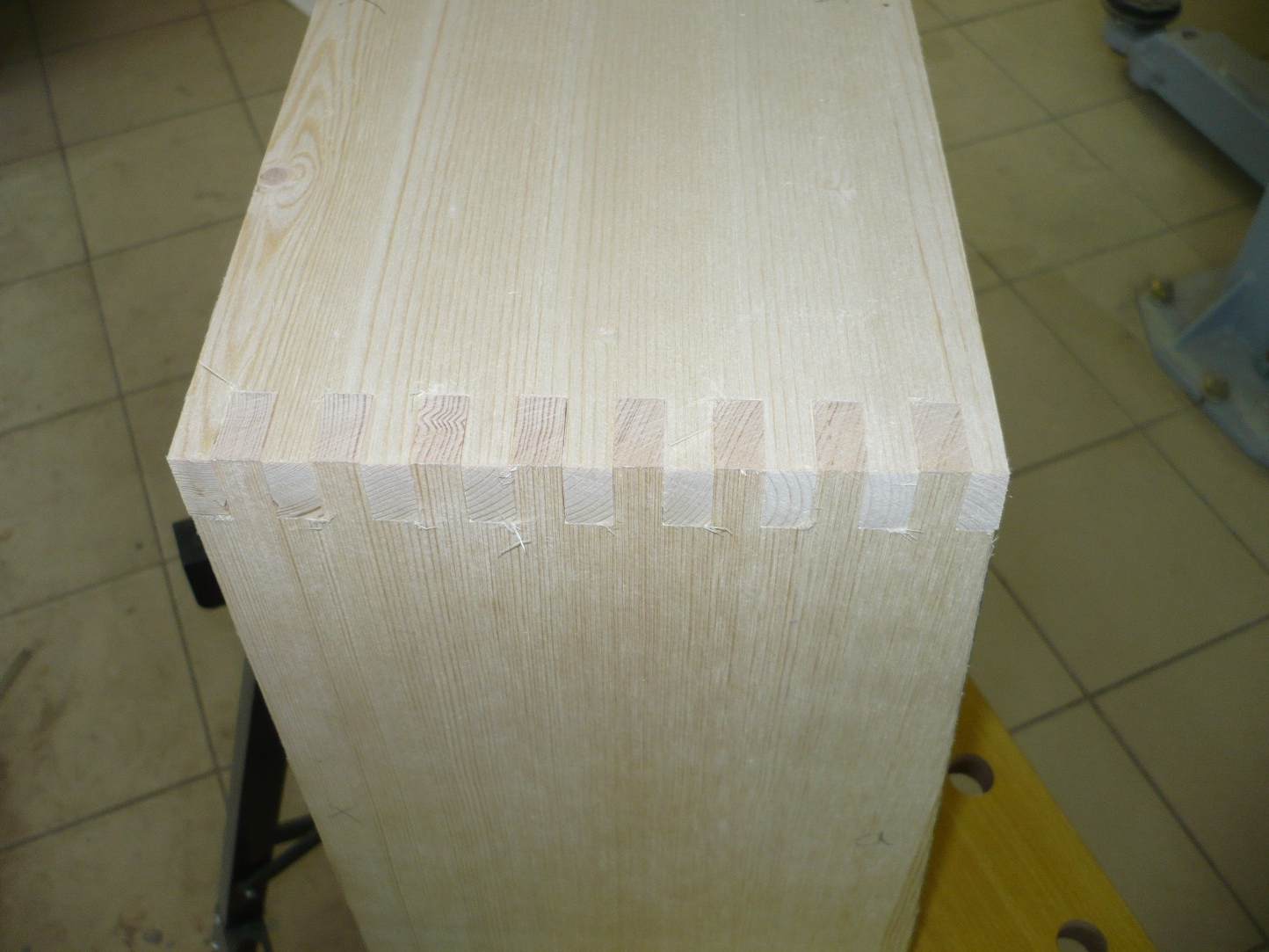

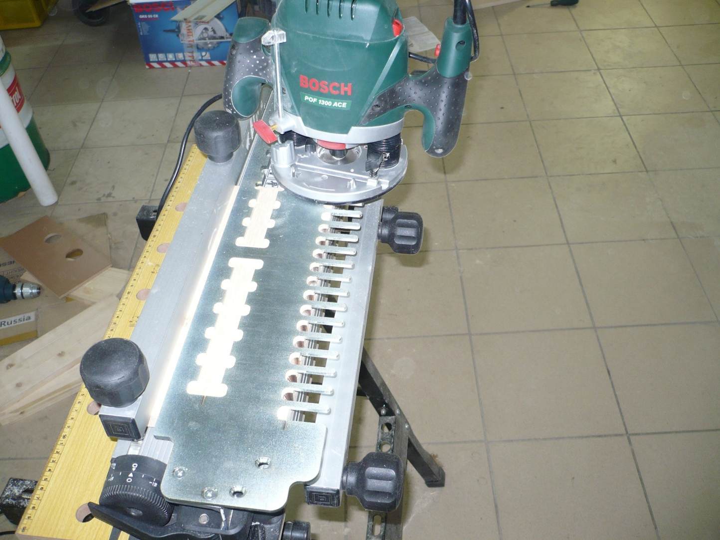

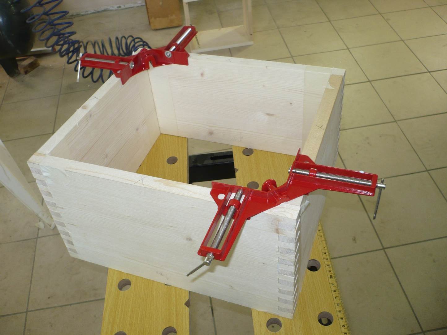

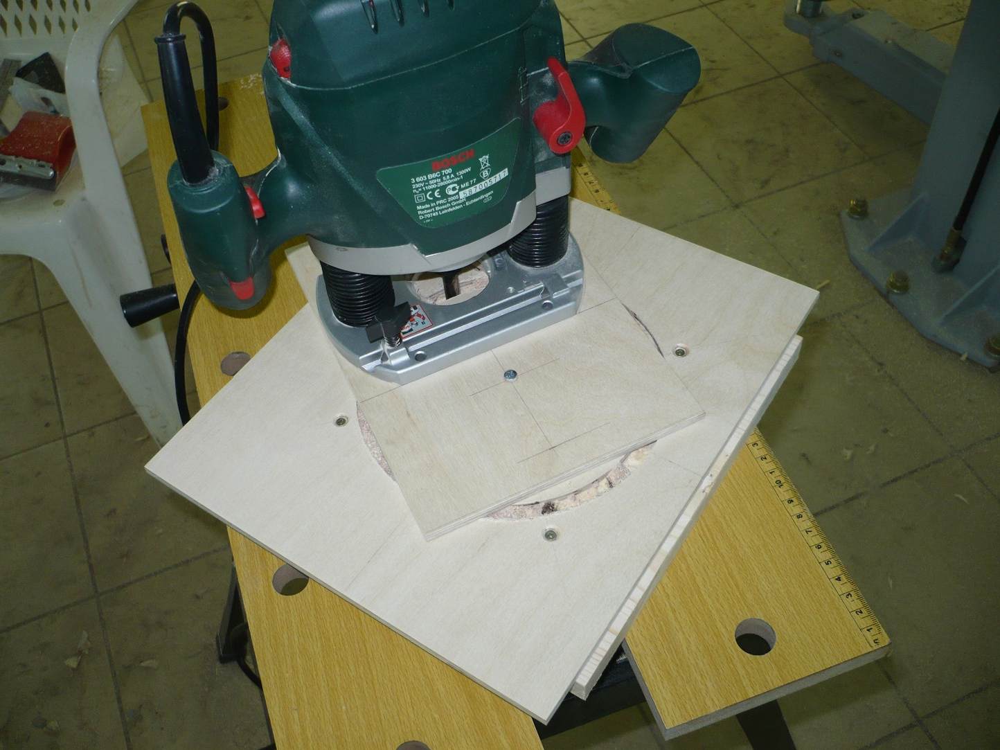

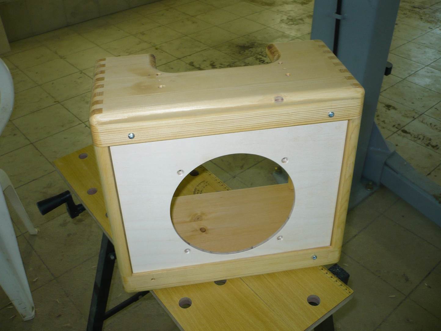

I remembered that a long time ago I also collected Champ, and I still have photos of the build, step by step. I think it might be useful to someone...
alkuz1961
Posts: 179
Re: How to build a Fender Champ 5F1 style

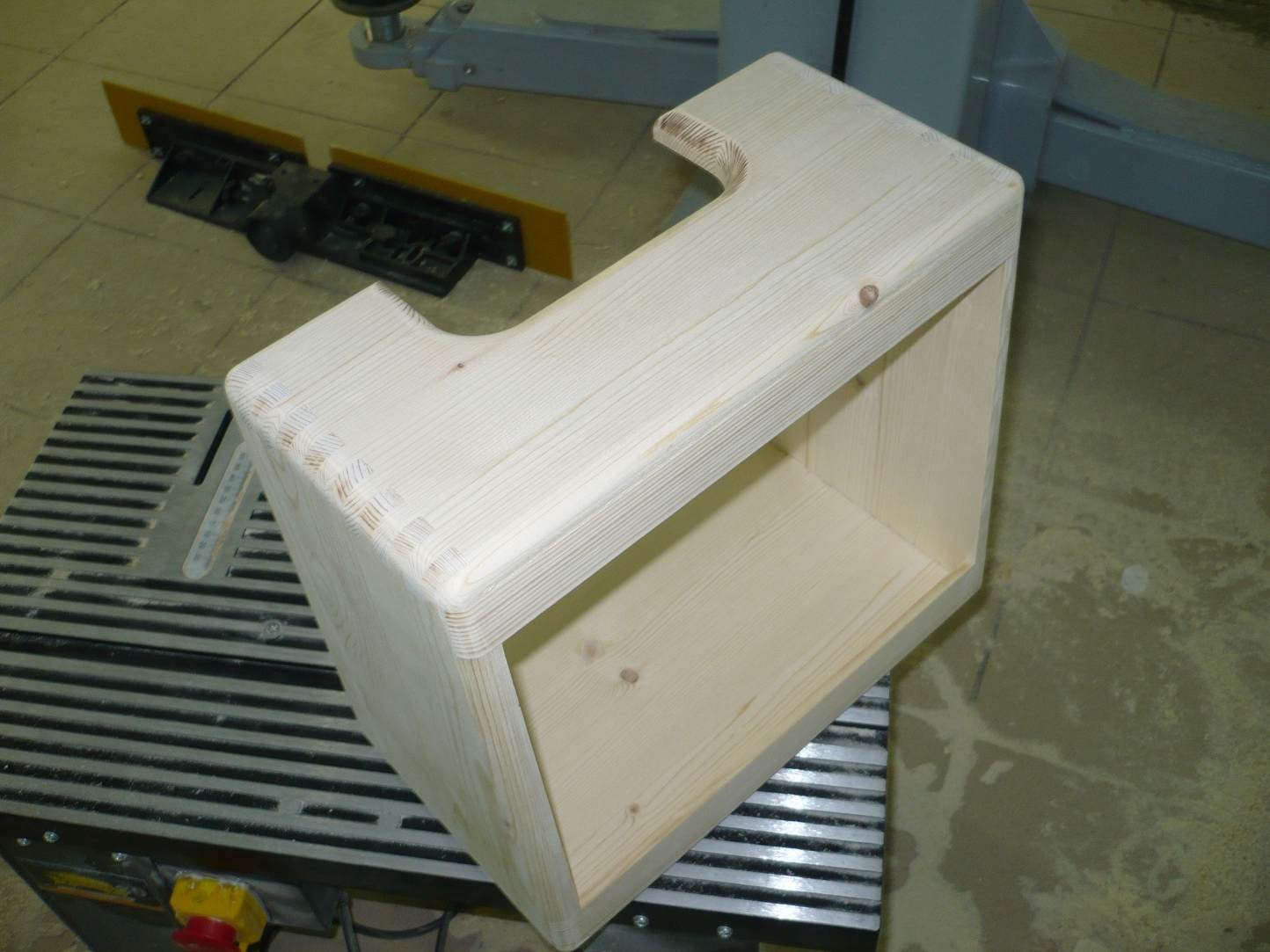

Post by alkuz1961 »
continuation
alkuz1961
Posts: 179

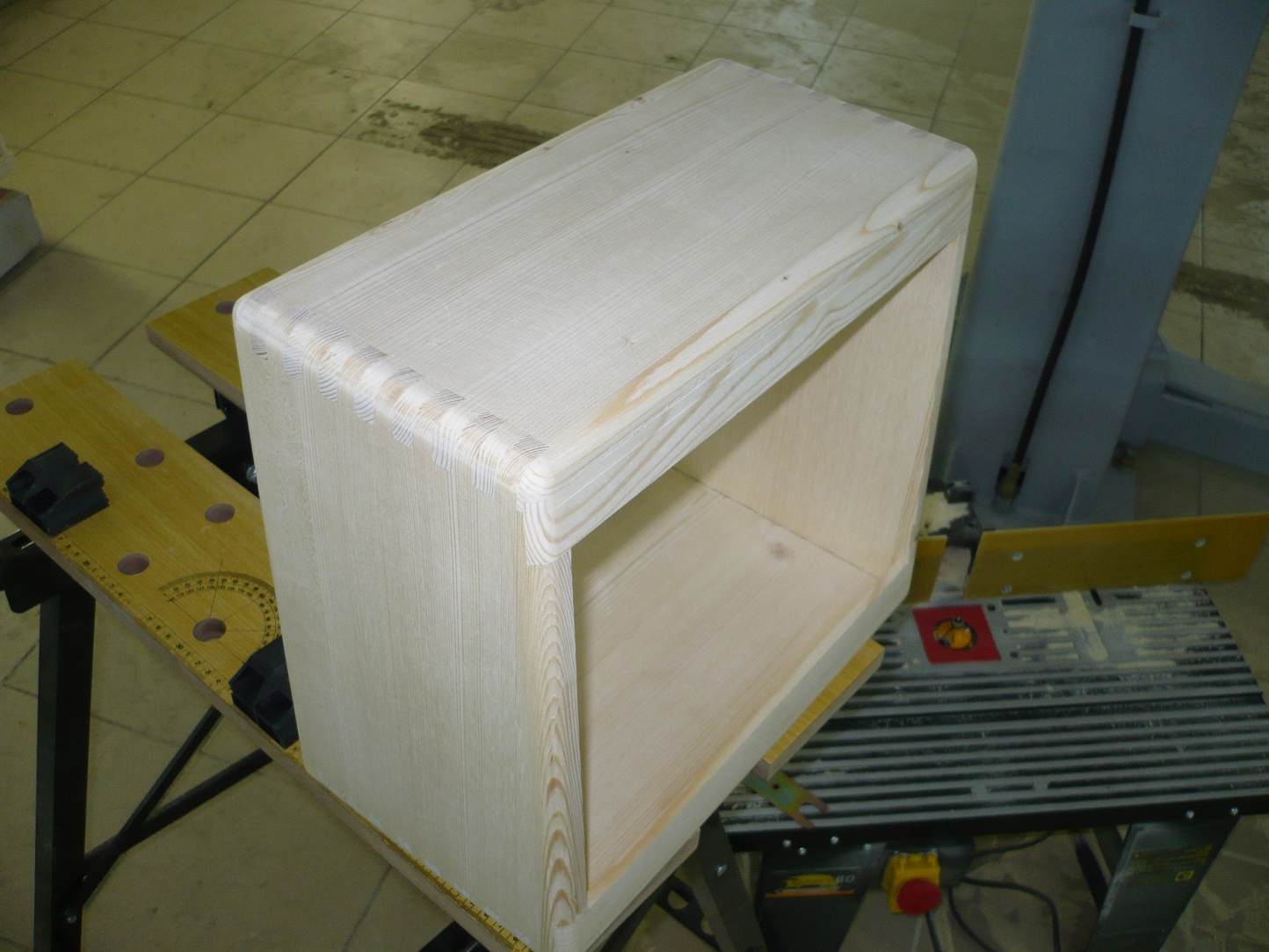

Post by alkuz1961 »
and a little more
alkuz1961
Posts: 179

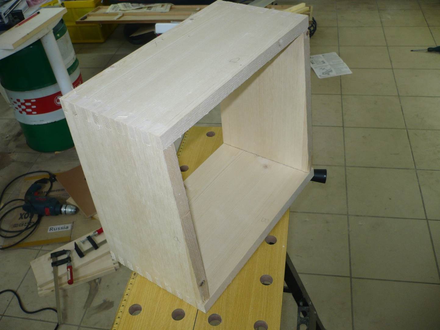

Post by alkuz1961 »
It's almost over )))
