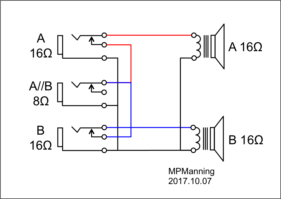

I agree using a switch is not ideal. It could get flipped accidentally. Here's an alternative using three standard 1/4" mono jacks, two with switching contacts (Switchcraft 12A). You could use a generic two-hole jack plate and drill a third hole for the A//B mode.

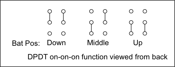

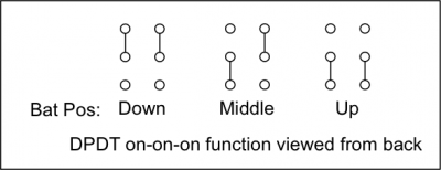

on-on-on generally functions like this. Use your DMM to verify the connections on your switch.

Thanks, that's what I was looking for, and I can work with that! I'll be sure to verify the lugs on the switch when it arrives.
