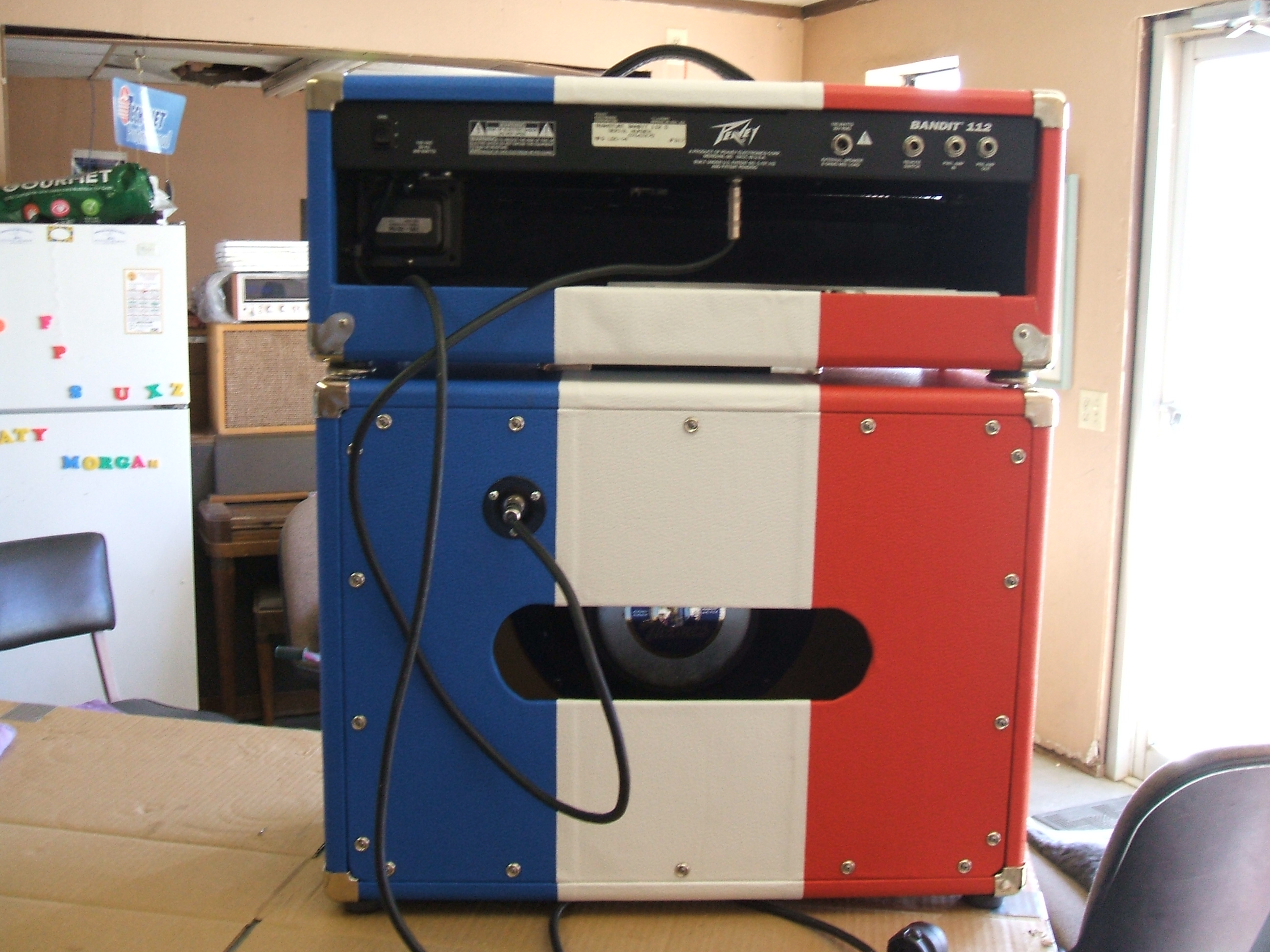

Post by Bill Moore »
I have no scientific reason, but I use the diameter of the speaker horizontally and 1/3 vertically. Seems to enhance the bottom end, more than you might expect.

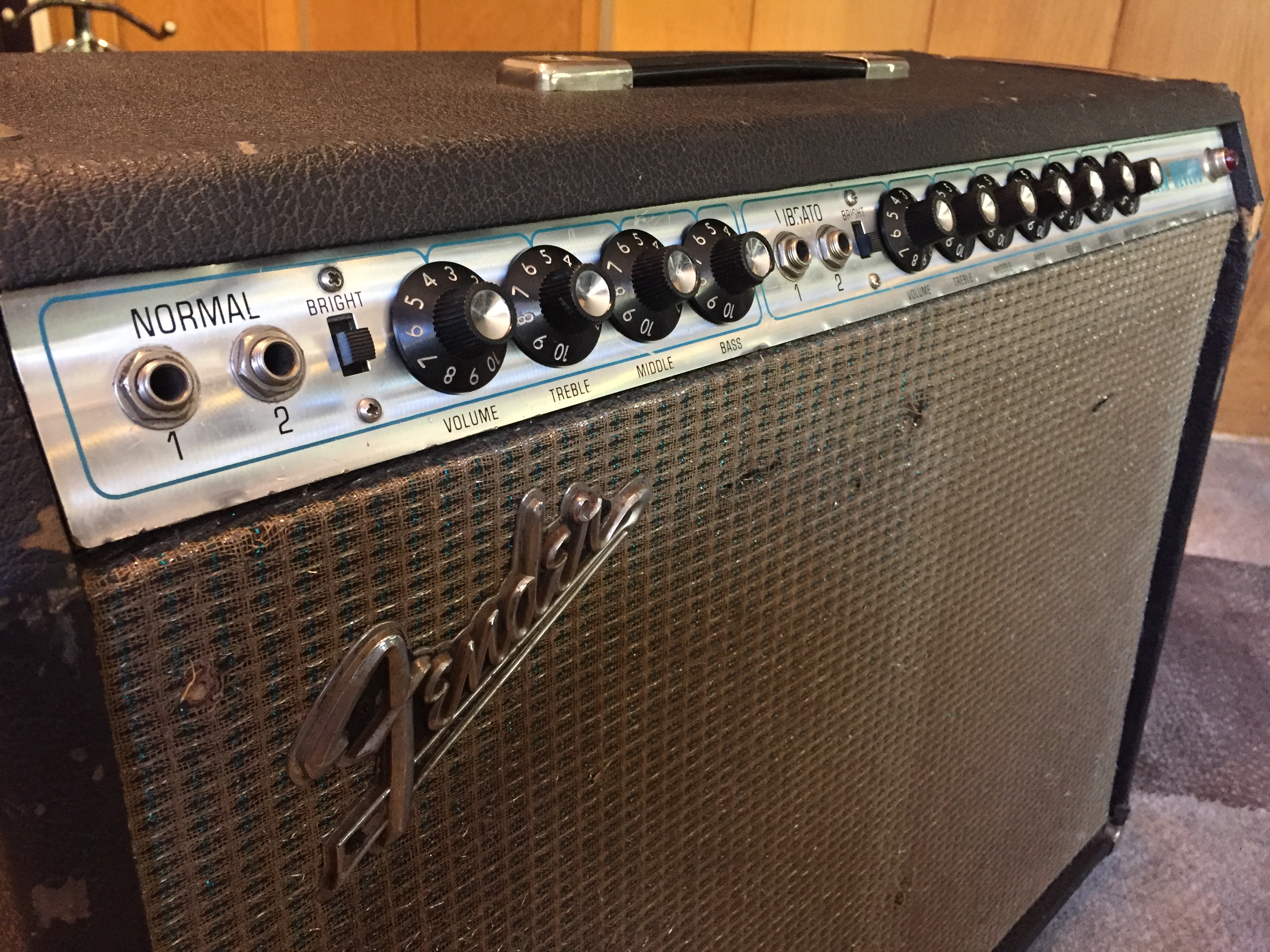

Re: Custom back panel idea for twin reverb.
I decided to keep my '71 Twin Reverb, so I made the missing back panels from 1/2" birch ply and vinyl.
Also spent some time with a toothbrush and 409 cleaner and removed the years of dirt. Shiny!
