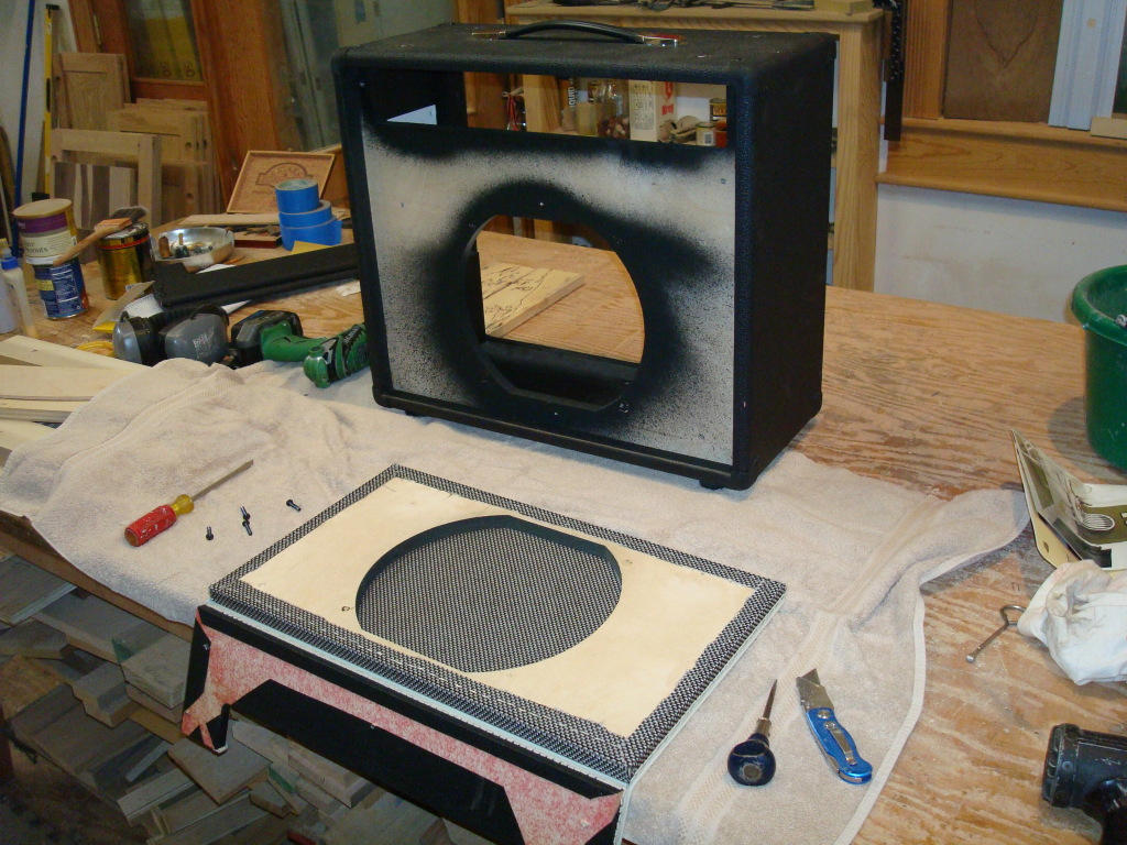

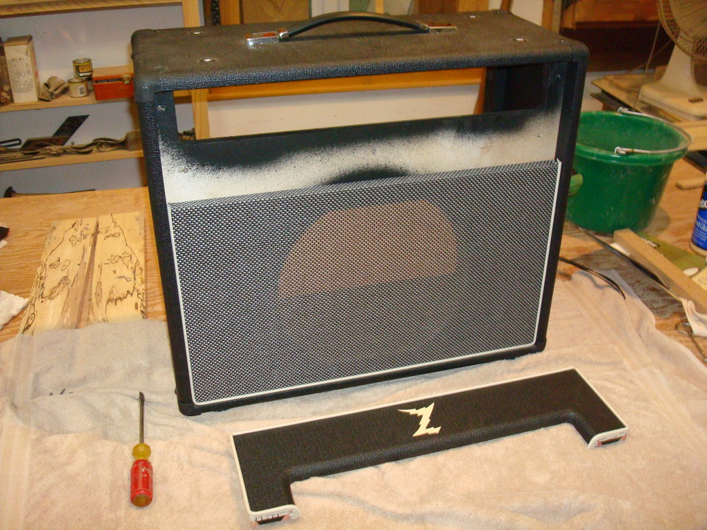

Dr Z front valance and grille are two separate pieces of wood see photos.

thanks Mark, so a Vox would be the same then and all front panels that use grill and a top piece are in fact two pieces.
In the top photo, what's holding the top and bottom together? it looks like it's hinged

Re: how to do front panel like this......
That white wide piping is holding it together and of course it all gets screwed to the speaker baffle board. I've seen some with narrow wood cleats screwed to both panels on the back.
