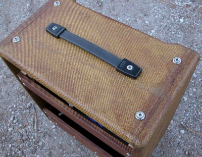

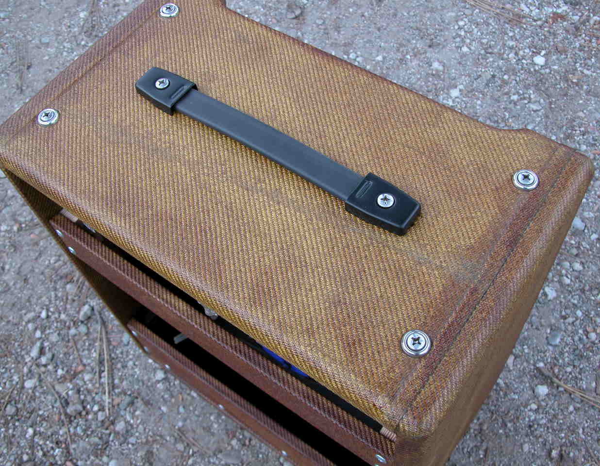

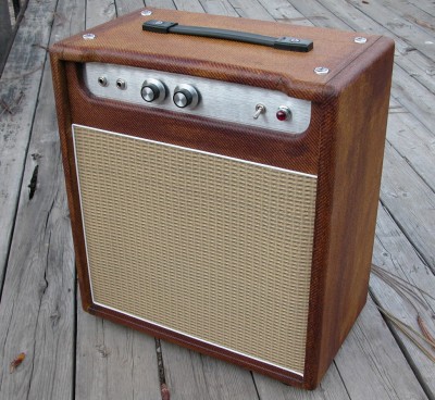

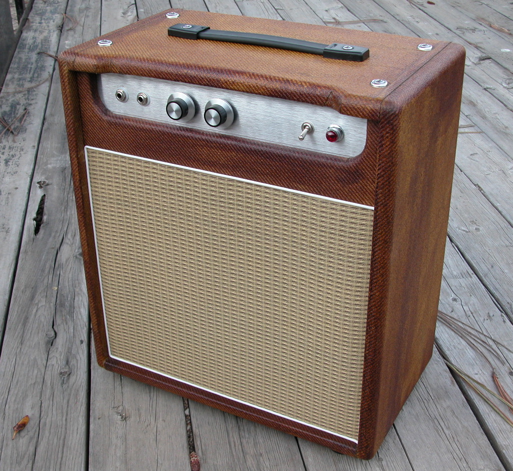

I prefer shellac as it's easier on the nose and you can brush it on.
If you want a uniform color, it's hard to get without spraying, either shellac or lacquer.
But if you are like me and don't want uniformity, you can go quick and dirty with a brush.
I've gone for a dark, road worn, smokey bar look, so I wanted inconsistency, runs, beer glass circle stains, scrapes etc.
I mixed Colortone dyes into the shellac (2# cut Bullseye. 1# cut sealer works also), and brushed it on in 2 or three thin coats.
Color can be tricky with tweed as it will pool up in the low areas, so the first coat can be clear, followed by color coats. You can make it look as new or old and worn as you want.

Tele, I'm digging that tweed in those pics! Very nice amp!
The only thing about this particular inquiry is that I don't want it to be too extensive. I was originally just going to do a regular Deluxe in that bare tweed cab, but figured I might be able to make it more appealing. I don't have a lot of finishing products, just Minwax semi gloss lacquer. I think there are a couple of stains as well. Would that lacquer be a wise choice to use for a few coats? I really do just want something that I can do in a day or so by end of the weekend.
