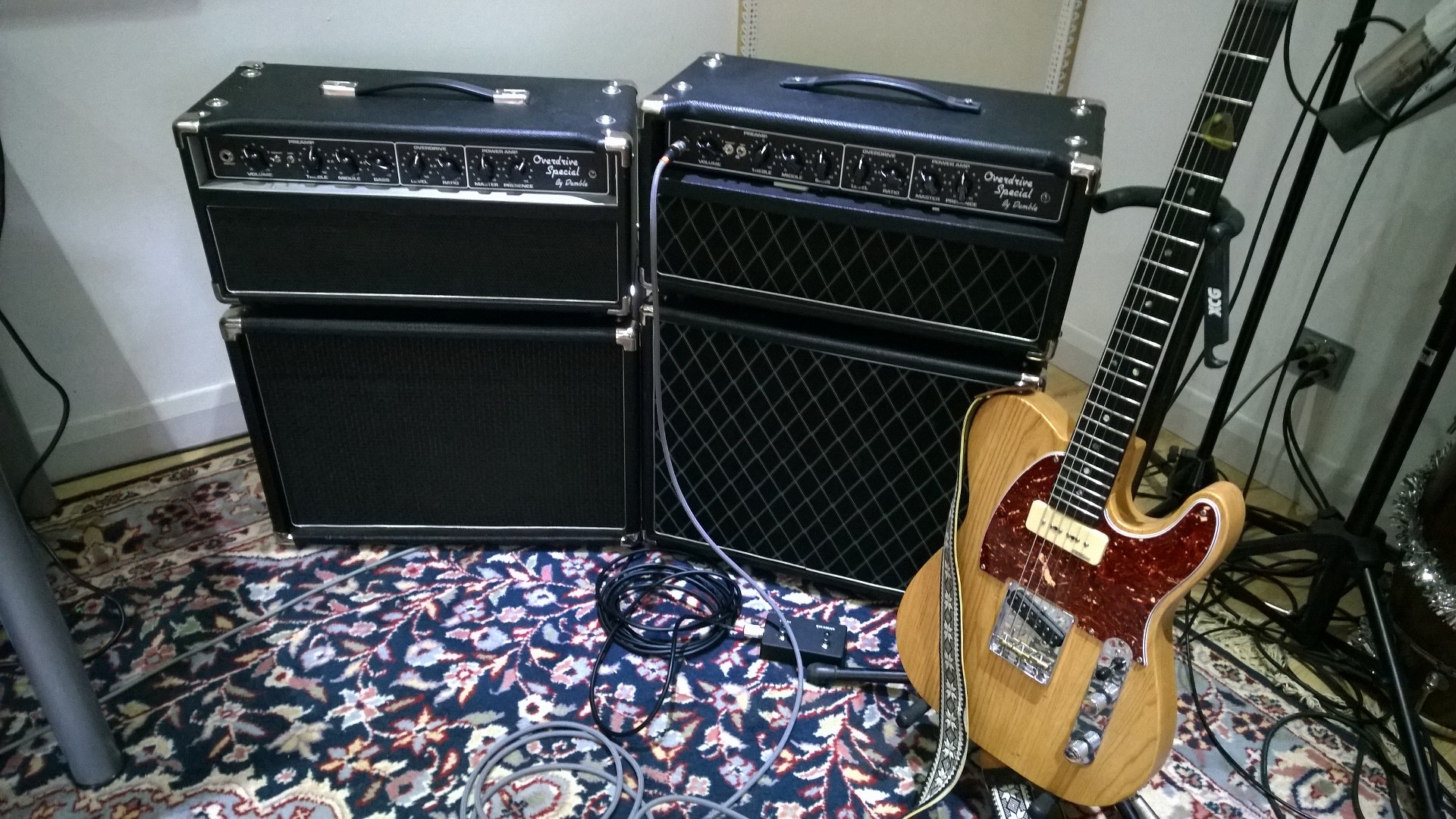

I have a sealed, ported Dumble Larry Carlton cab with a 1x 12 EVM and also the oval backed Dumble type 1x12 with a vintage UK Celestion G12 80.
Both cabs sound vey good, the EVM cab is just stunningly LOUD and clear. Its a huge sounding cab. It will easily cope with the 100w Bluesmaster (vox grill cloth)
