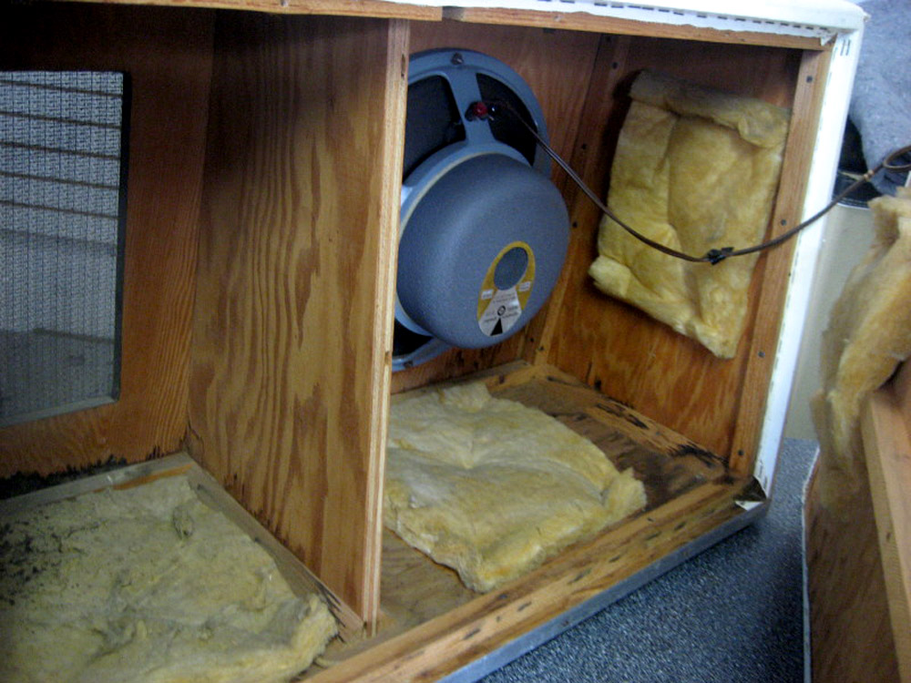

Yes, I built a detuned 2x12 with a pair of G12T-75's. It sounded very good when I put my Peavey 6505+ 112 combo through it, I was in love with the sound.
The H&K Coreblade in the picture sounds like a fizzy piece of crap through any speakers, I hate that amp (I had borrowed it from a friend).
Note that Kevin prefers a pair of detuned 1x12's to a 2x12, so he can position the speakers independently.
