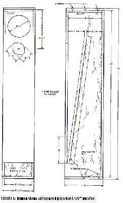

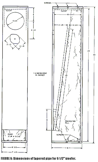

A design I found online. I'll try to find it and post.

I can't find the actual diagram I used to make the speakers, and internet searching has been futile. Here is a version with 6" speakers. The design is the same except my speakers are triaxial so I didn't mount a tweeter, the width is only 6" as i used smaller speakers, and the bottom plate is 2" longer for stability. I will get the actual dimensions for you when I get to her house later tonight.

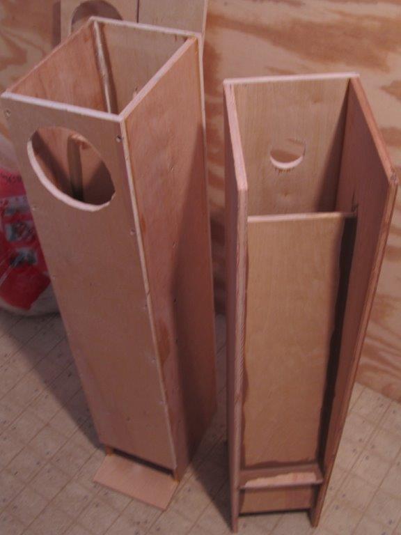

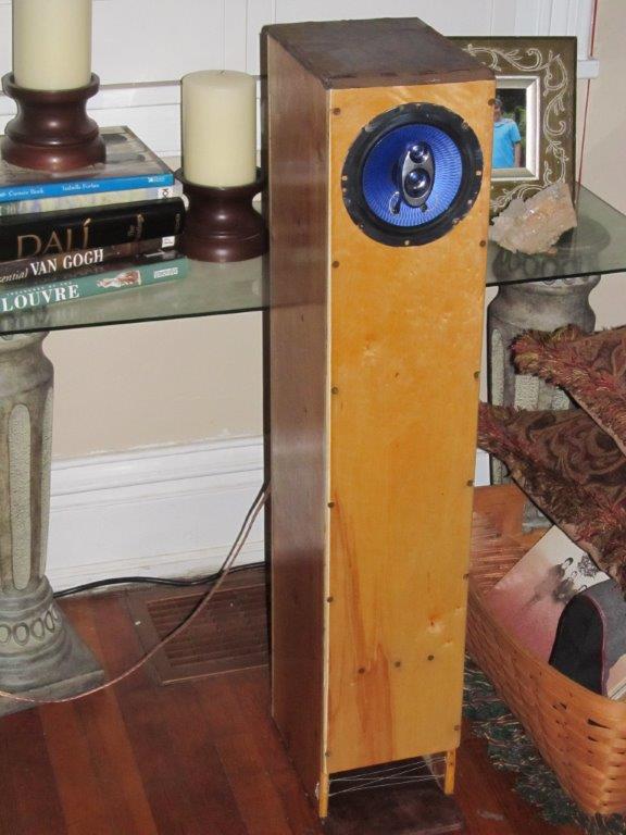

Sorry Phil, injury has kept me from the fiances house. The internal dimensions are 6x8x38. The external dimensions will vary depending on the wood you use. I used a birch ply that measures just under 1/2".
I started by gluing n screwing the sides to the center baffle, then the front n back, followed by mounting the speaker, wiring, binding posts, and stuffing. Then the top and bottom plates. The only trick part is gluing a wood piece about 6"x1"or so to the front panel and baffle, establishing the end off the line. It has to be 6" above the port opening. I sealed all joints with construction adhesive. I put a deflex pad on the baffle directly behind the speaker, and stuffed the line with about half a pound of acoustastuff. I drilled several holes and ran picture hanging wire across the port several times to keep her cat from getting stuck inside. I filled the screw holes, applied clear lacquer, followed by 2 coats of wax and buff. She hated the look and spray painted them that shit brown color. I hope it flakes off and really looks bad.

Tube dude , look for Voigt pipe. That is the name of your design

Yes, Voight pipes are another name for tapered quarter wave transmission lines. I searched under these, and other key terms to no avail. The above diagram is the closest to the plan built mind from. I wanted to build the Frugal Horns with Planet 10 drivers, but settled on the lesser design as I had all the components and materials on hand. The results were so amazing I'm glad I saved the money (more amp parts)

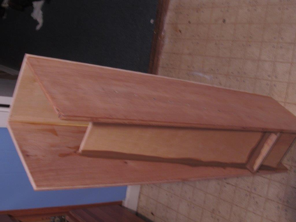

I recently found some images from the build of these.
Re: Transmission Line Speaker Cabinets for HiFi
Is that a cat fence on the bottom of the cab?
Yes, the site I got the plans from mentioned it as a good idea. The guy said the first thing that happened on power up was his cat ran up inside and got stuck. He had to disassemble it to get him out. Hah! It seemed prudent to wire them as my fiancés daughter has a cat that's dumb as a hammer. Her first clue Peeta was missing would be the smell from the speaker, since I glued and screwed them so tightly I'd never be able to fish him out. Probably raise the F3 in that channel too.
