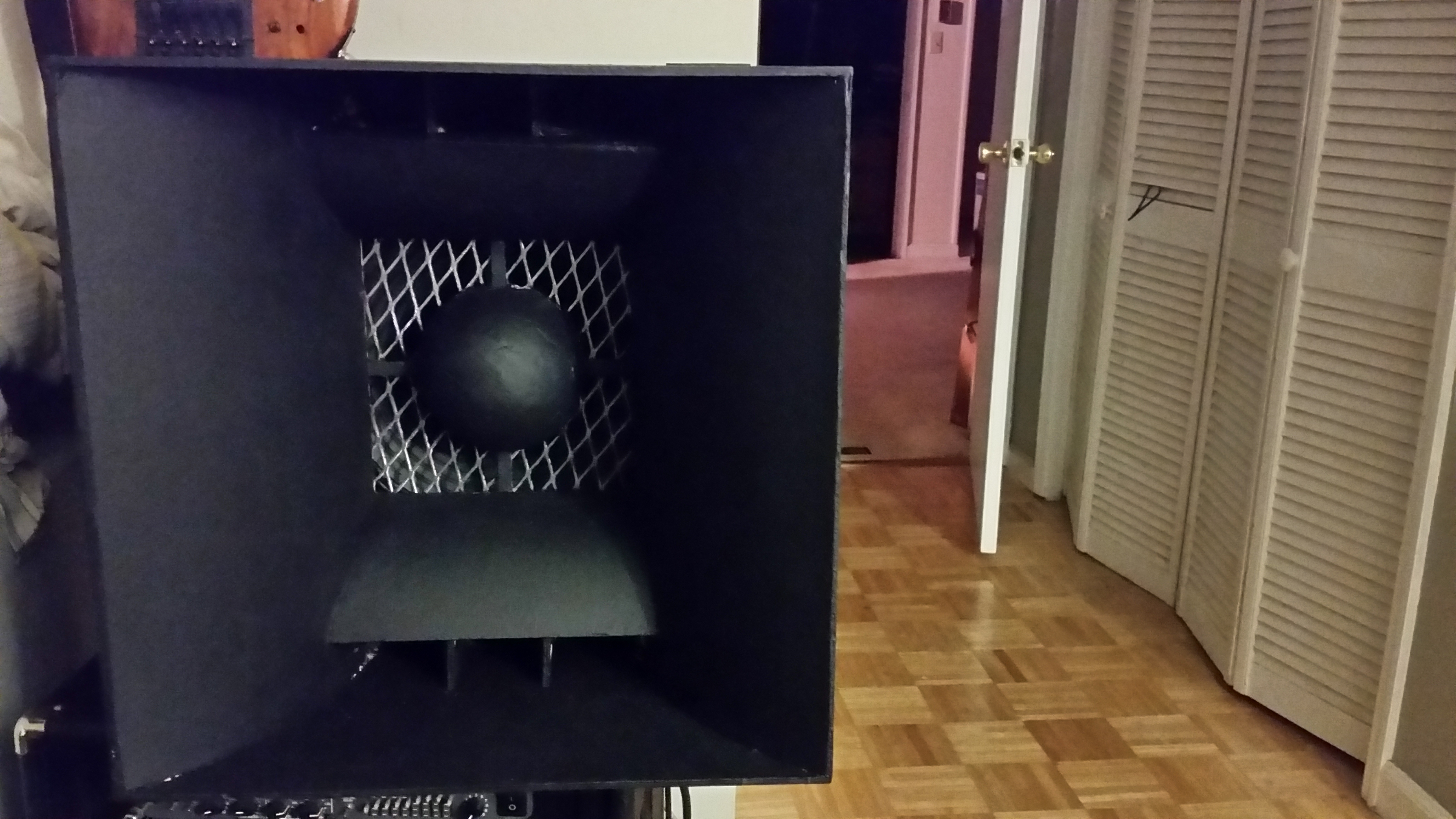

Re: cabinet construction
Post by TUBEDUDE »
Well, I couldn't resist, I built the Jack15 Lite. It is the best bass cab I've heard. I used an Eminence Kappa 3015 neomag. The cab is constructed with intensive bracing, allowing it to be made with 1/8" Birch. The completed cab with the speaker is less than 36 lbs. and still performs better than my other folded horn that weighs in at 52 lbs. I get all the highs I need so no compression driver or piezos needed.
