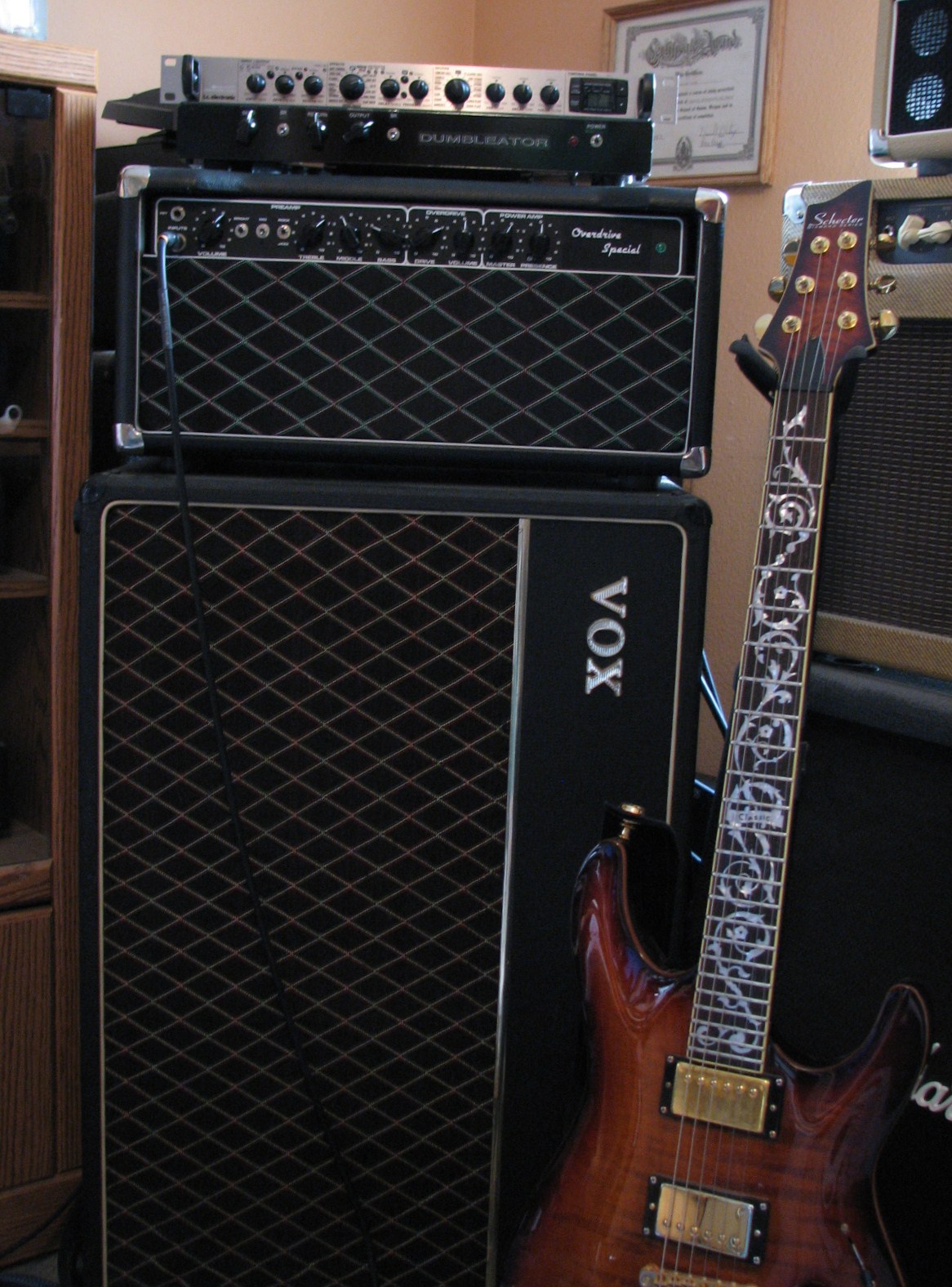

If weight is not a concern, there are many 2X 12 cab plans out there.
I like you like to put the amp head on top of the speaker cab.
I find some of the diagonal 2x 12 cabs intriguing that are wide enough for a amp head.
I use an old 60's Vox cab with two EV 12L's in it.
Semi open back.
Just by chance it was the same width as my Dumble clone head with the cab set on it's end.
I think it sounds great!
