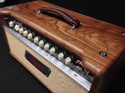

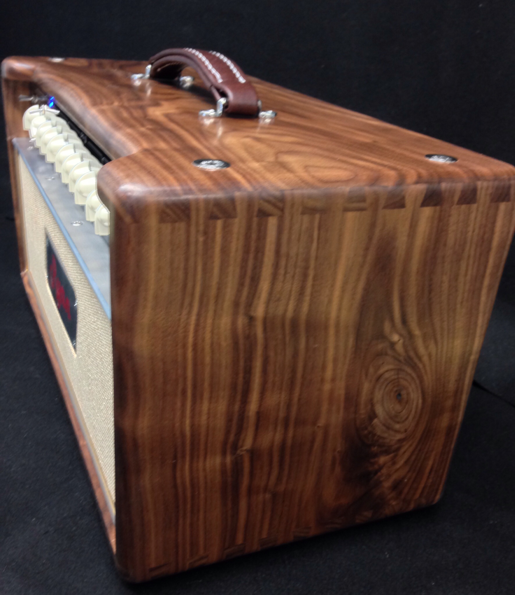

That is beautiful! But I can't see the dovetails!

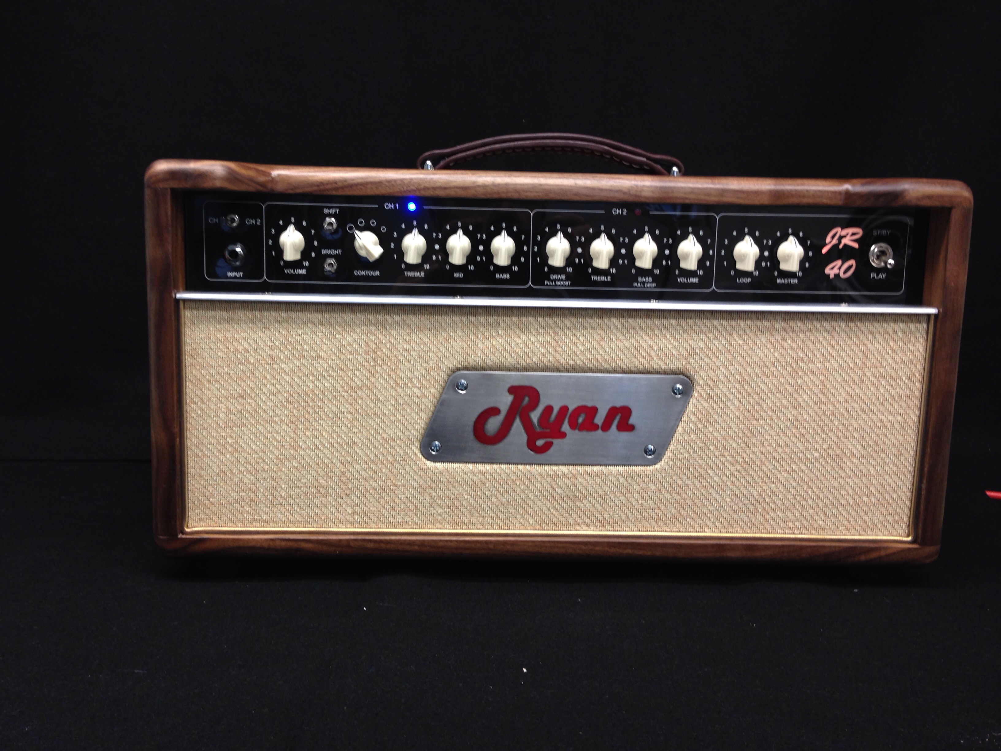

Hi Tubeinside,
That is beautifully figured walnut. Good job on the grill and piping. How does the Ryan sound? 6V6 or equivalent?
Thanks for posting - I never get tired of great work and beautiful wood.

Russ. This is a strange sort of hybrid. It's got a JMP 50 watt power stage a Fender clean channel with reduced value bypass caps and a Dumble OD section with post OD 'James' tone stack. It also has a Fet driven parallel effects loop with return level on the front panel. Sounds great

Fabulous looking amp! Really. Fabulous.
Just curious though, why'd you put the amp on the top? I find is so much easier to put the amp on the bottom.

I hang it from the top because I want the option of using them in a combo or a head.

That's amazing. Do you use capture nuts or wing nuts? I like the look better when you hang the amp but a bottom amp doesn't trap heat next to the tubes. I to like the option of using a combo.
