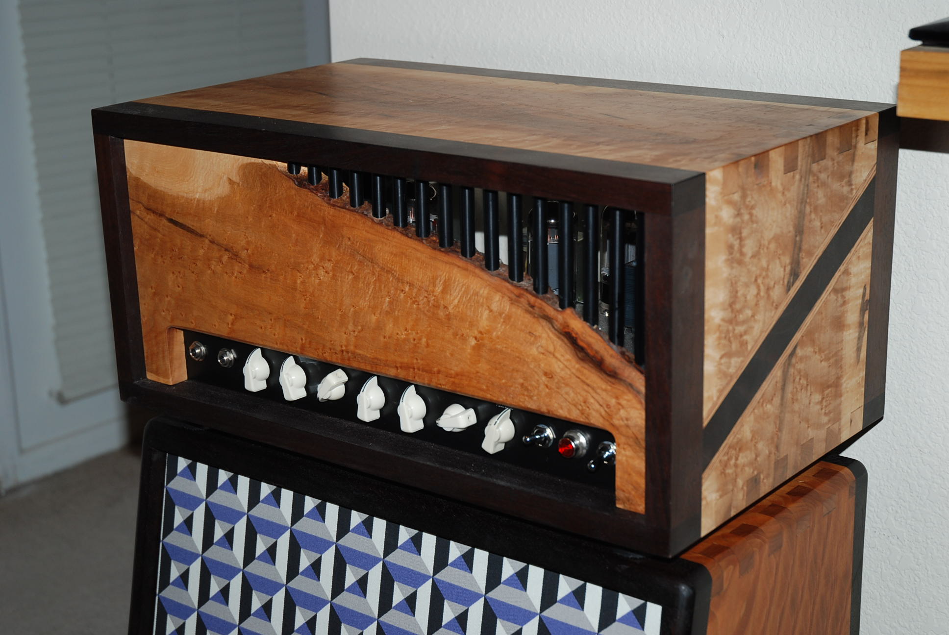

Birdseye cab grill is in

Hi Dave,
I work for a manufacturing company that uses anodize, oxide and nitride finishes on our parts. The lot charges run $150 to $250 depending on process. I stick my bits in with the company parts. I think my owner takes pity on me as I am building guitar stuff instead of chasing women.
The finish is a type III hard anodize. I chucked the rods up in a drill press and polished with 0000 steel wool, 600 & 1000 grit sand paper. For a matte finish bead blast before anodize.
Chat up aluminum finishers in your area and see if you can't sneak parts into a batch.
