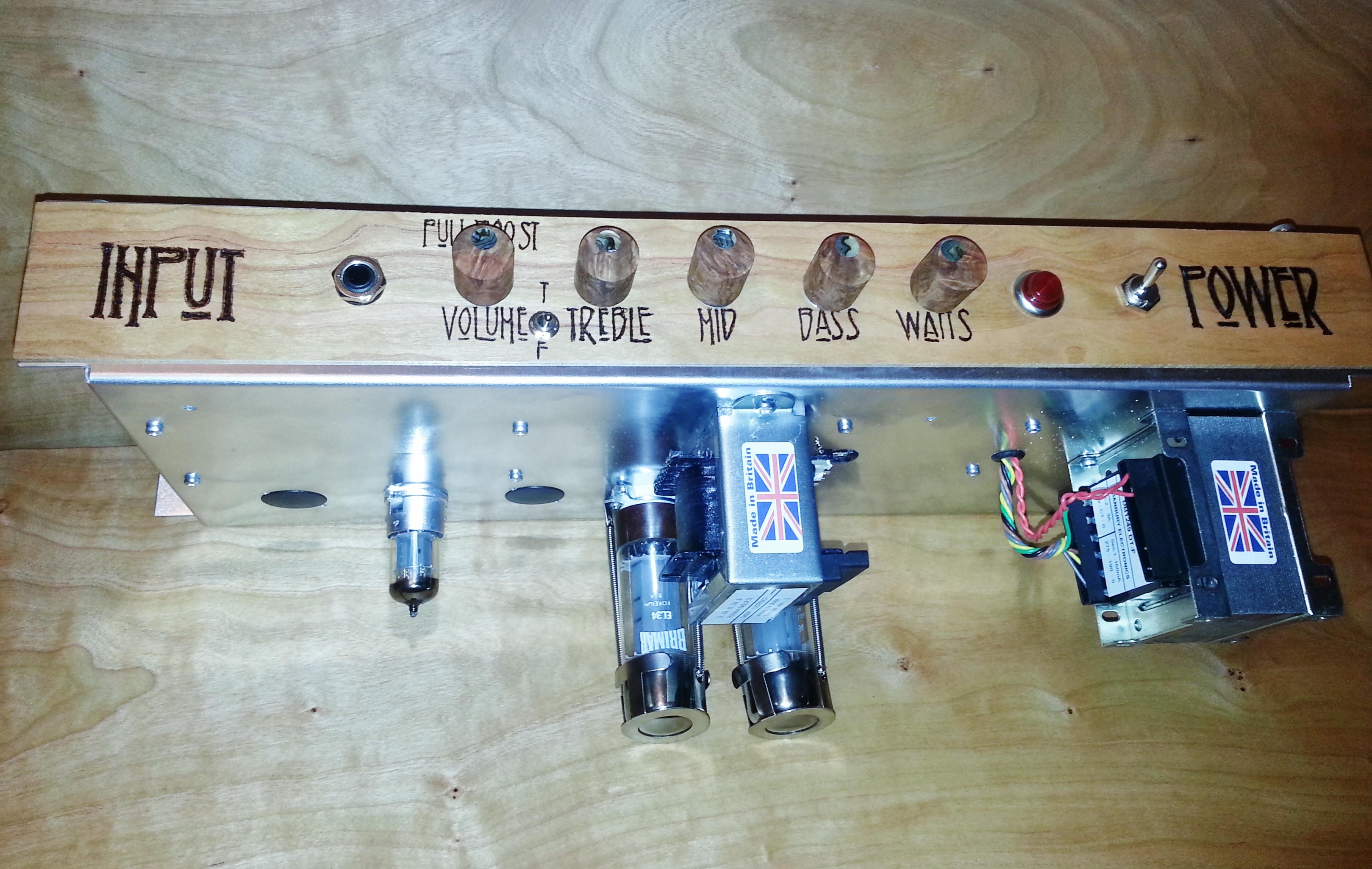

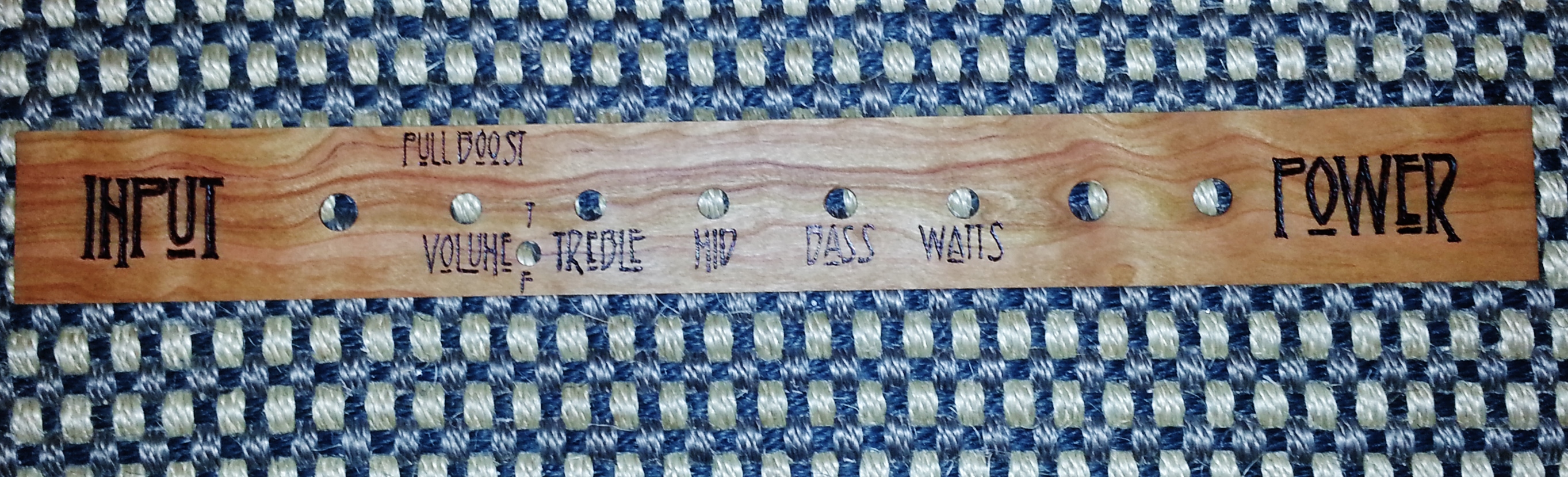

Re: Burning
Done!
The volume pot pulls out to lift the ground from the tone stack, and there is a 'thin/fat' switch as well.
the 'Watts' selector selects different B+ windings.

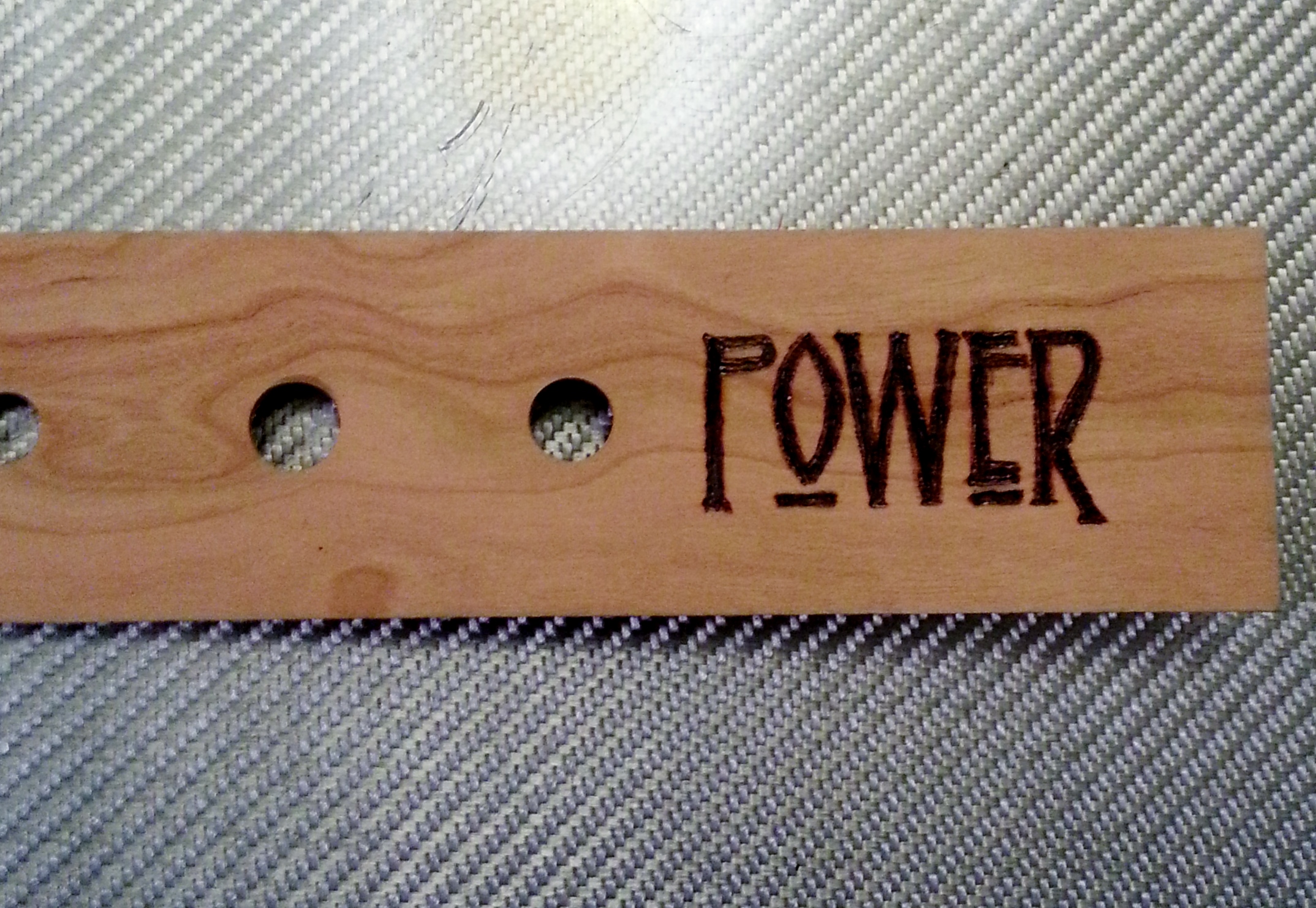

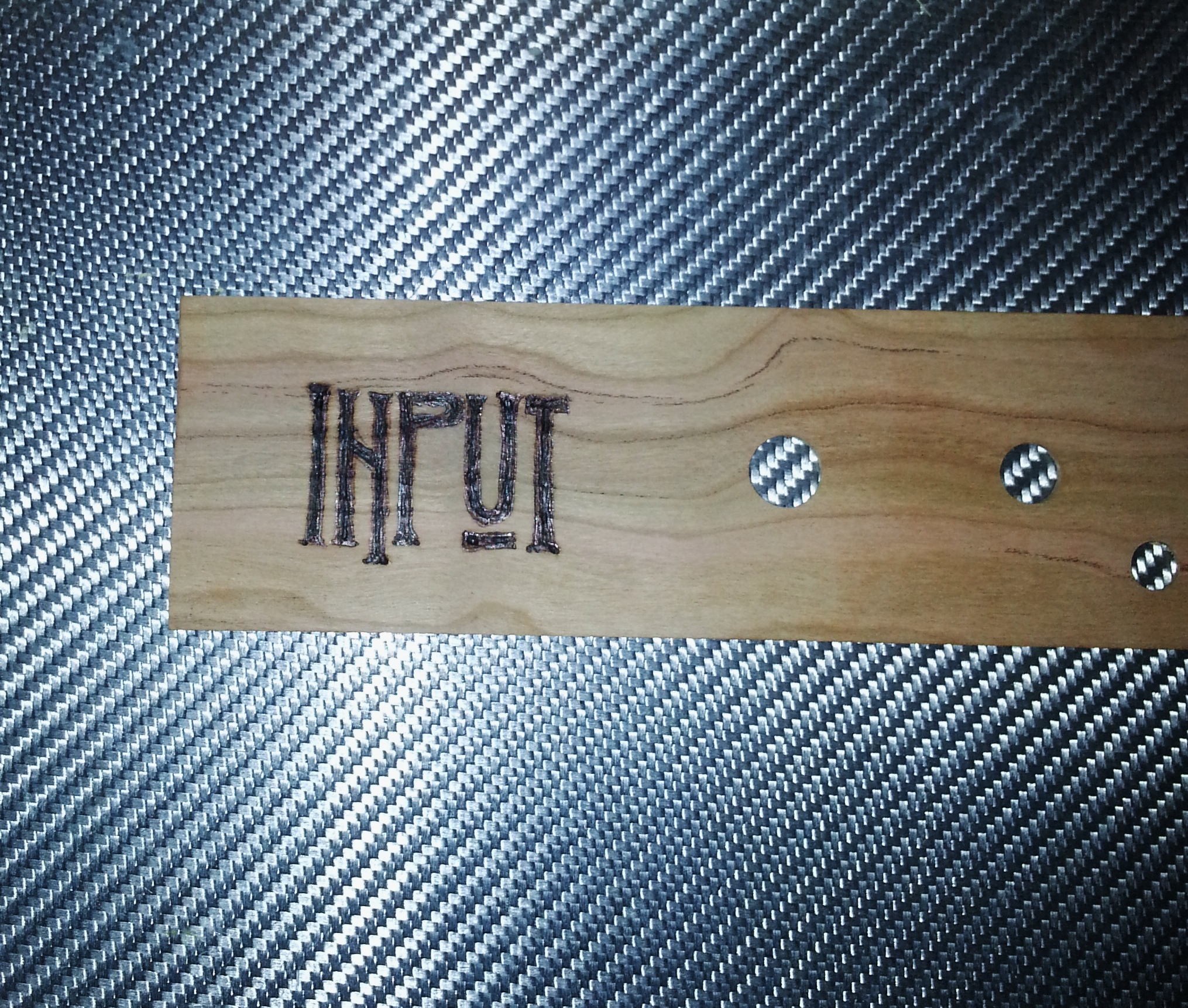

Re: Burning
Love it. Great job! Did you print on paper and trace on wood etc or is it simply freehanding? Either way great achievement.
Re: Burning
That looks awesome.
Re: Burning
That is really some excellent work. I use a woodburner but I haven't done a faceplate. However, I recommend getting one, they're cheap and far easier to use IME than an iron.
Super job. Love that font.
Re: Burning
Cooler than cool
Re: Burning
Very, very nicely done!

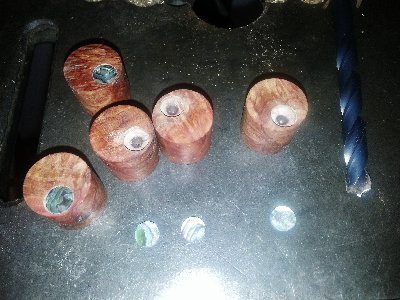

So, it needs some knobs.
This is my first attempt at inlay.
I had some scraps of camphor burl from another project that I used here.

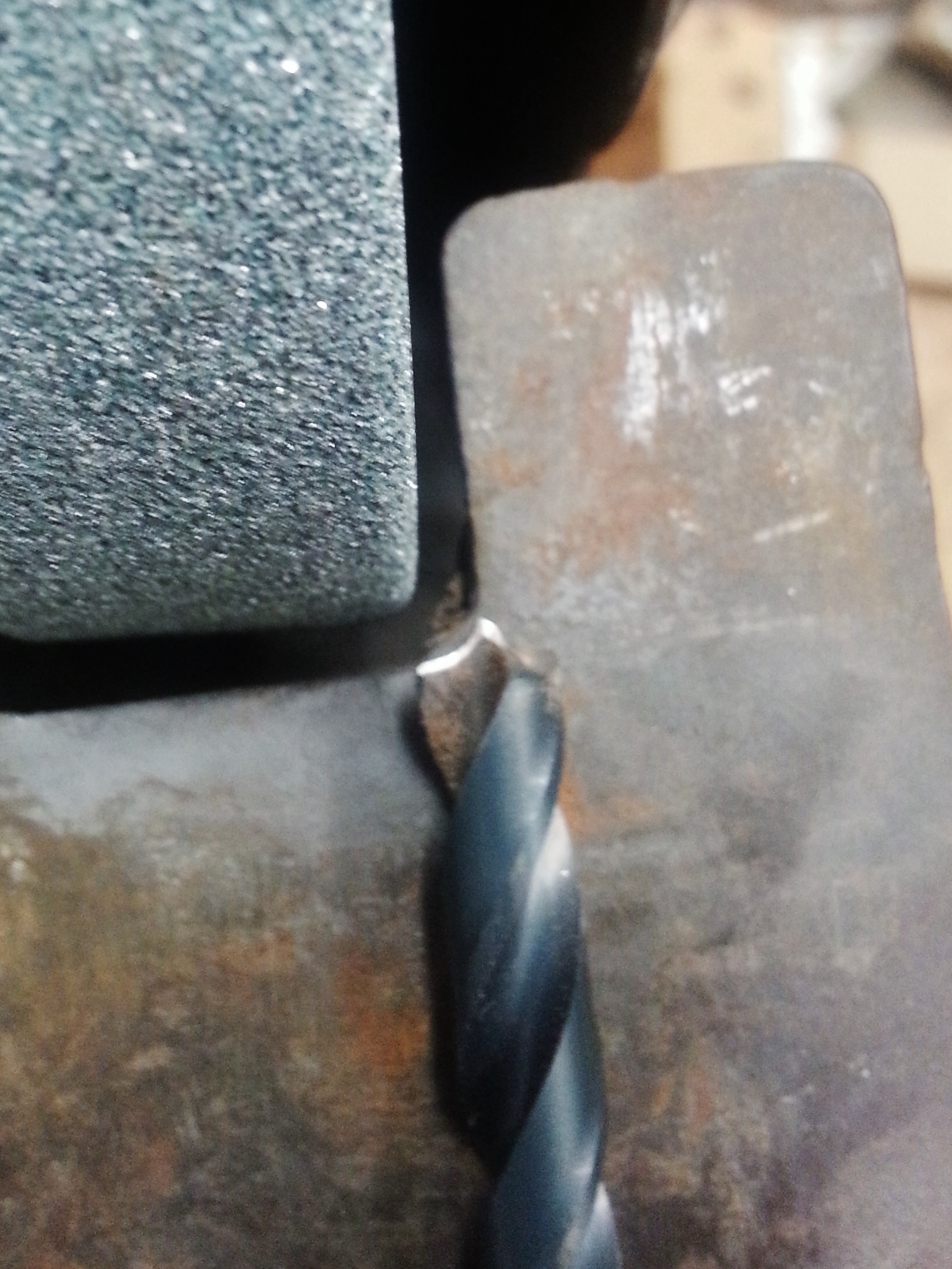

I ground the drill bit to make a hole with a flatter bottom. Notice the shine on the cutting edge? I've ground that back to a less acute angle. This prevents the drill from grabbing.
The dots are glued in with carpenters glue then sanded flush.
That's the cherry I'm going to use for the cab
