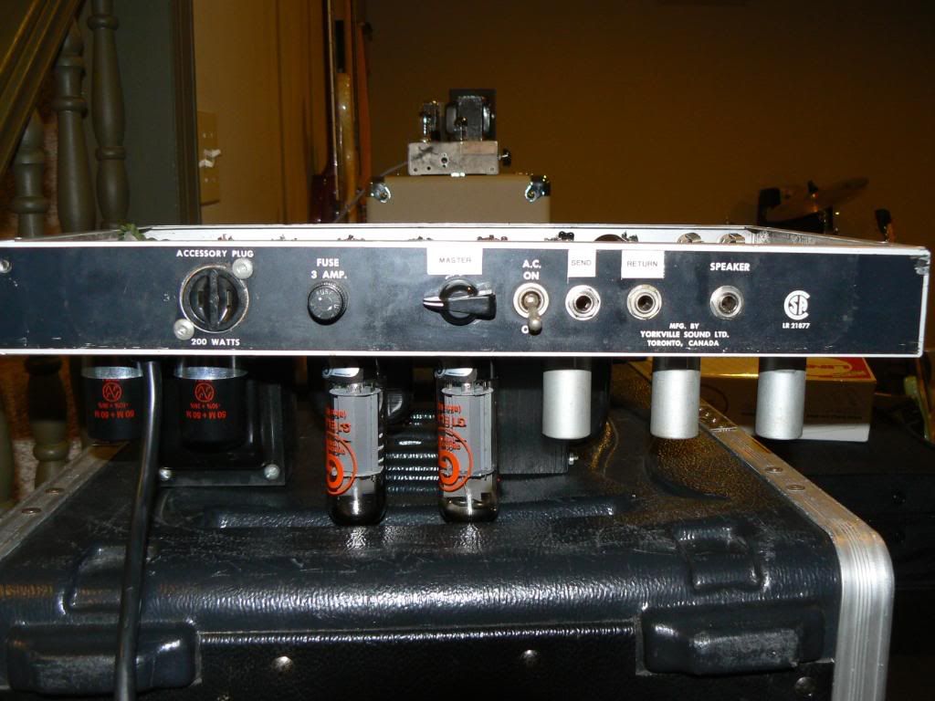

They are great amps. Here's some pics of my '68. With just a few tweaks you can go Tweed Bassman or Marshall Plexi. I've got mine to Marshall 1987 specs (give or take). I just put in a PPMV and a passive loop so I can use my D'lator with it. Really nice Hammond iron. Buy it!...but I wouldn't Wreck it

Re: Traynor-wreck
It looks like they come with some good hefty iron
