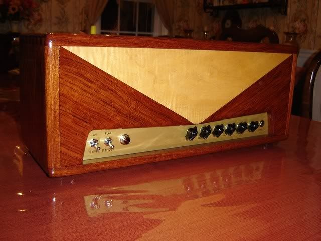

I know the darkening is inevitable...Nice guitars and nice cab. Is that one of Larry's cabs?

Yes it is..mclmk8d wrote:I know the darkening is inevitable...Nice guitars and nice cab. Is that one of Larry's cabs?
Re: Wood for cab
It is indeed! Larry is an artist!
