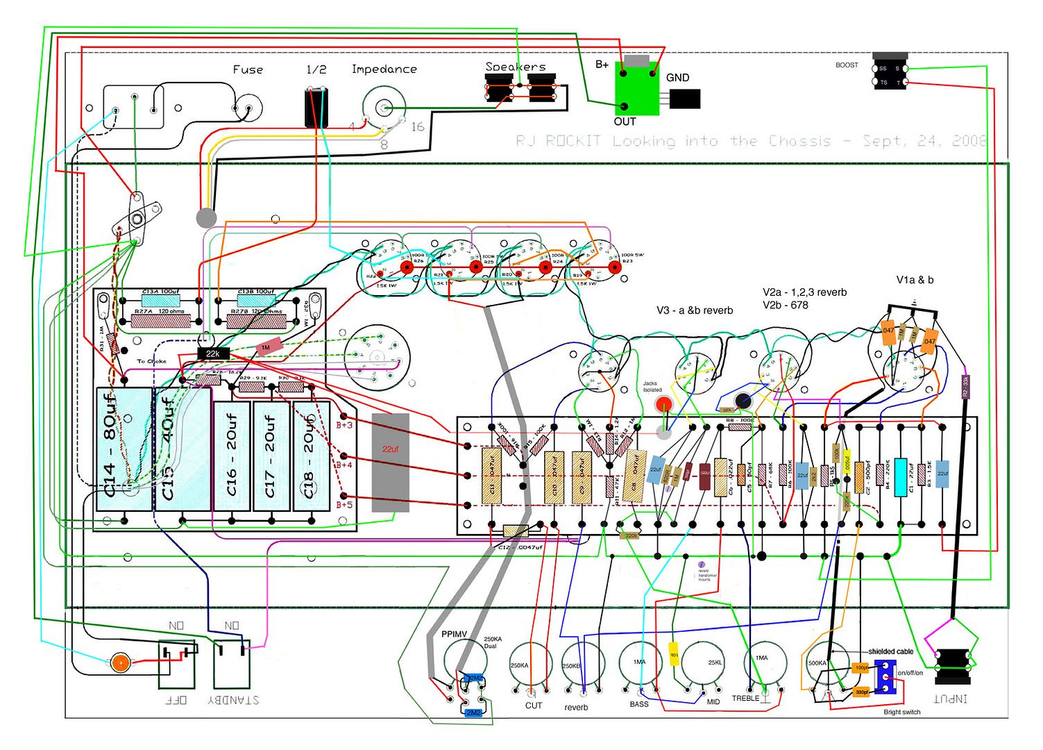

Curious if any have done a reverb circuit on the Rocket amps. Plenty of real estate.

Yup! Great platform for reverb. Norm's reverb circuit is cool too. It's a slick adaptation that works well.

Can you share a schematic for this build? Thanks

Always so nice to see your work Normster. Is this the Cadet prototype?

I copied Norm's circuit.. yes I'm a thief. It's in a Bassman chassis with the original OT.
The reverb is a simple single tube reverb, very effective and the Rocket with EL-34's sounds great.

Norm is a good friend, and I have heard/played through a number of his builds. The Space Cadet is a very cool amp, hence the interest in his reverb circuit. He did provide me his layout, however I don't build anything exactly as others would. My build style and goals with specific amps are a bit different, so I do things my way. Norm was a big help though in fine tuning the reverb circuit and coming up with the idea. He get's full credit for that.
With that said, adding reverb to the Rocket is a cool addition and sounds great. It's not the same feeling as the standard Fender reverb, so be aware of that.

Haven't tried the Gibson reverb yet, but they are interesting and sound great. Norm's circuit is pretty similar although it's not using a 6C4 driver or half 6EU7 recovery, but a standard half 12A_7 tube for both. I have been tossing around the idea of doing a power pentode/beam tetrode driver for fun. It'll get more into the outboard reverb tone.

No schematic (I never use them). Here's the layout for the 4xEL84 version. Ange, yes this was the Space Cadet proto.

Norm, what is that toggle on the reverb pot??

It just pads the reverb when playing at high volume. One of the downsides of returning the reverb to the bottom of the PI is that as amp volume increases, it has a dramatic effect on the intensity of the reverb. The switch is kind of a bedroom/gig reverb selector to help compensate.
