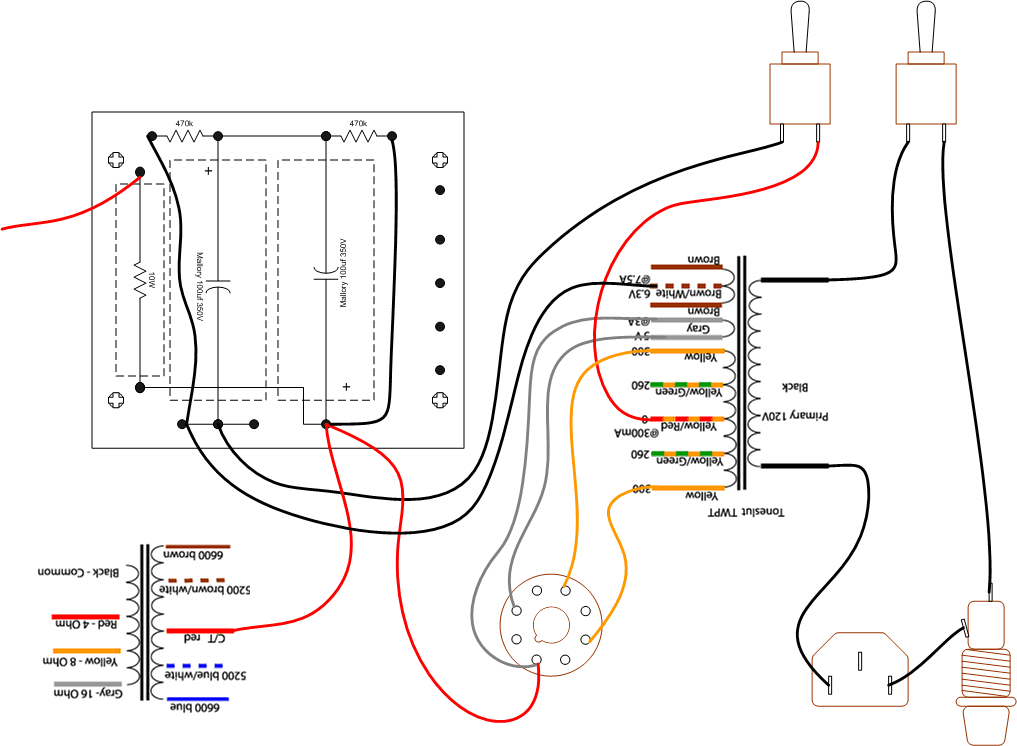

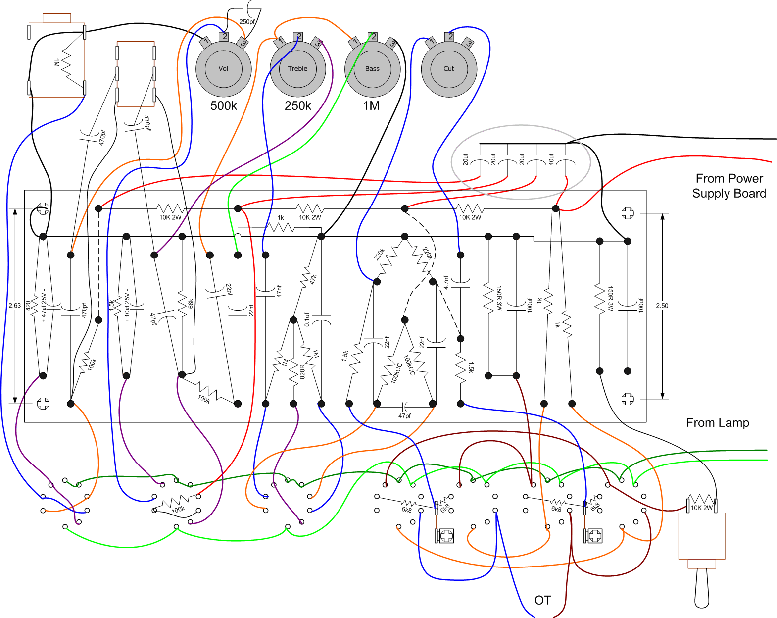

Wiring diagram:
http://www.paulamps.com/RocketWiring.gif
Note the bright switch drastically alters the treble cap in the tone stack and also modifies the first coupling cap to keep the bass properly inline with the mids and treble from the tone stack.

Wiring diagram:
