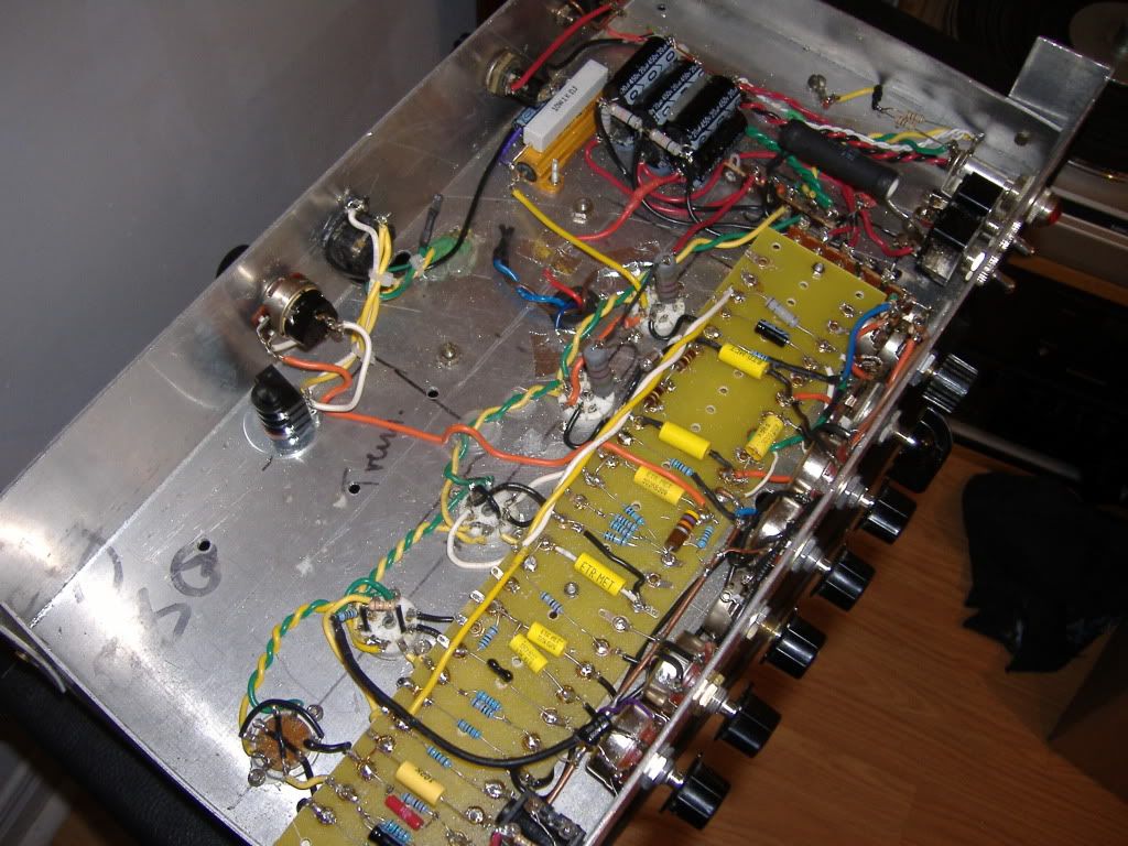

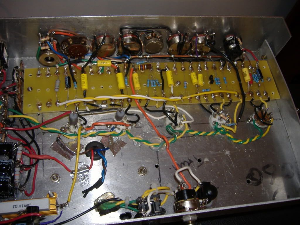

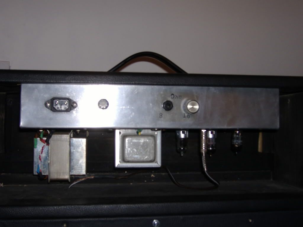

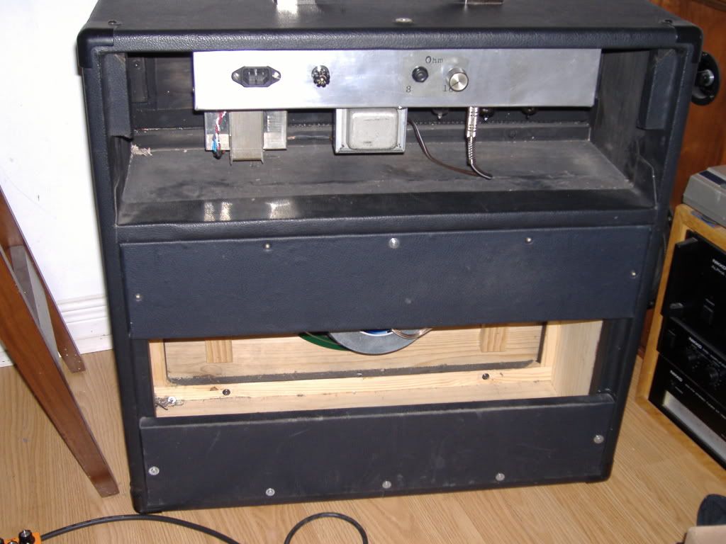

OK- You asked for pics- so no crying now! :)
http://i1004.photobucket.com/albums/af1 ... t15009.jpg
http://i1004.photobucket.com/albums/af1 ... t15008.jpg
http://i1004.photobucket.com/albums/af1 ... t15006.jpg
http://i1004.photobucket.com/albums/af1 ... t15001.jpg
http://i1004.photobucket.com/albums/af1 ... t15011.jpg
I can't believe I'm posting this- I'm so ashamed
It's incredibly messy looking.
Here is some background.
The Chassis played host to probably 5 amps now including a 15 watt Liverpool, a Traynor YGM2, an 18 Watt with Tremolo and this Rocket.
Except for about 5 resistors and as many caps, everything is salvaged from other projects
Pots, jacks, board chassis, Power supply, OT etc.
The Chassis was hand-bent before I owned a metal brake. That was maybe 4 years ago
The cab was an experiment with the idea of a combo with a partition between speaker and chassis. Its way over sized for the 12 inch speaker but honestly I have never heard anything sound as good. The dovetail jointed Pine cab is about the size of a Bassman combo. Little on the cumbersome side and not what you would associate with a 15 watter.
The amp itself is just incredible to my ears. I used a PPIMV and the Hot/clean switch. I currently also have a switchable feedback (presence) on a pot at the back.
Gonna take it out likely
The clean setting has the lifted 2nd stage cathode bypass and the grounded 150K resistor at the 220K to the PI
The Hot setting is the opposite.
This amp is way more aggressive that I thought it would be and I like it!!
Thanks folks
Questions, comments and loud laughter welcome
Markus V

Oh will you quit being ashamed right now!
You've built an amp. An amp that works. It could be tidier, yes, but who cares when the music's playing? Only you. And guess who the guy who builds the next amp will be? You!
Great job. This is a fantastic journey.

If you built something that sounds great and you love it, you've succeeded. I have built really neat amps I hated, and some really ugly Frankenstein amps that were transformed a hundred times before I loved them.
I don't think Dumble or Fischer ever had the neatness of say a Komet. I'm pretty sure the owners of Dr. D's or Ken's amps don't really care, as long as they are reliable.
At the end of the day, it's still about how it sounds.
						Re: Choke on Rocket
I just looked at photo #5, a gut shot, and it doesn't look all that bad really. Clean it up someday if you're inclined. For now though, take a break and pat yourself on the back, it sounds like it's working great. I get that thing where you have some parts and the urge, that's maybe the best place to hang out.
