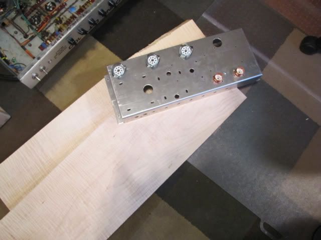

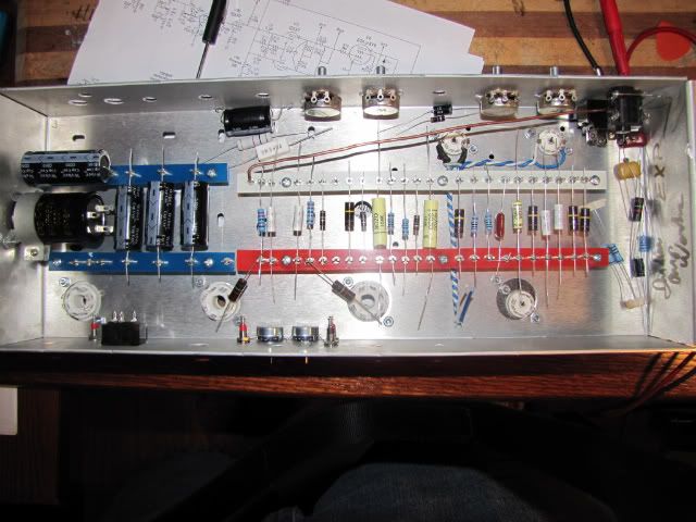

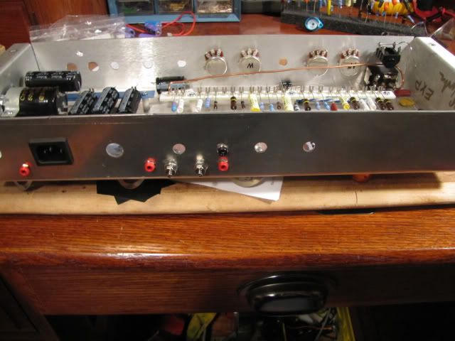

Got some nice Flame Maple here. Going with the Kelly schematic and the cleanest layout I can come up with in this chassis I have here. I'm gonna carve out a flamed maple faceplate on this one to. FUN STUFF!!! Will keep you all posted. Everyones two cents welcome.

IME, flamed maple (and almost any kind of flamed or curly wood) chips out with a planner. Better off with a table saw and a thickness sander.selloutrr wrote:planer - reduces wood.

Thanks folks. Yes the planner just rips chunks out so it will be a thickness sander to get down to 3/4. The faceplates ill just rip and sand down. Got a buddy with a lumber company that hooks me up with the wood. He says only about 1 in 500 trees have flames. I'm stocked up enough on wood to build about 8 or 10 cabs right now, unless my wife needs a table or something
