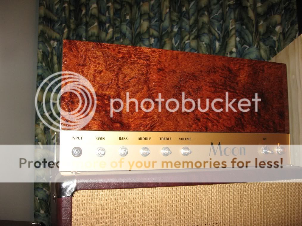

Here is a piece of bubinga I finished this way - and it looks so much better in person!
768]http://i514.photobucket.com/albums/t346 ... all184.jpg[/img]
761]http://i514.photobucket.com/albums/t346 ... binga2.jpg[/img]
761]http://i514.photobucket.com/albums/t346 ... binga1.jpg[/img]
