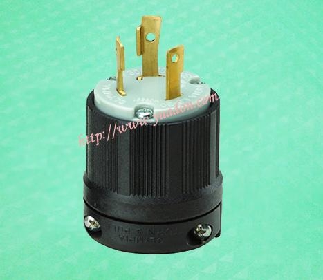

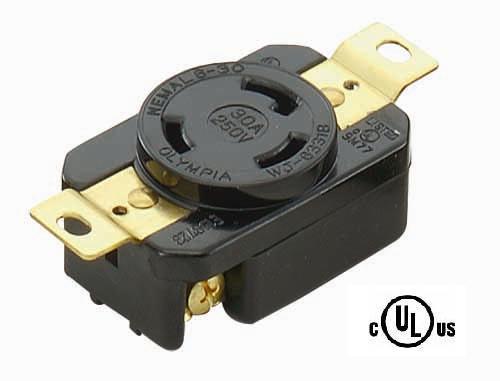

Back in the 70's when I was doing sound in NYC we used Twist-Lock plugs and jacks like those used on generators to try and be fail safe. They worked really well, too.
[img:500:381]http://img.diytrade.com/cdimg/496972/59 ... socket.jpg[/img]
[img:350:530]http://img.diytrade.com/cdimg/496972/59 ... g_Plug.jpg[/img]
