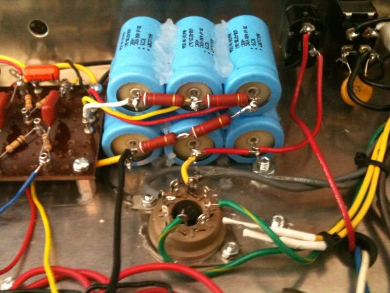

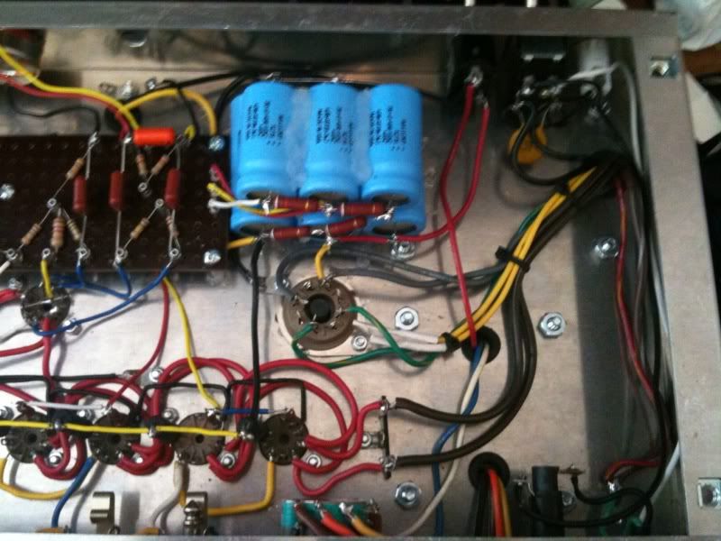

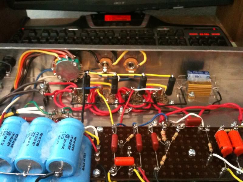

Re: Rocket Voltage Problem Fixed - Distortion Problem

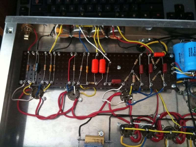

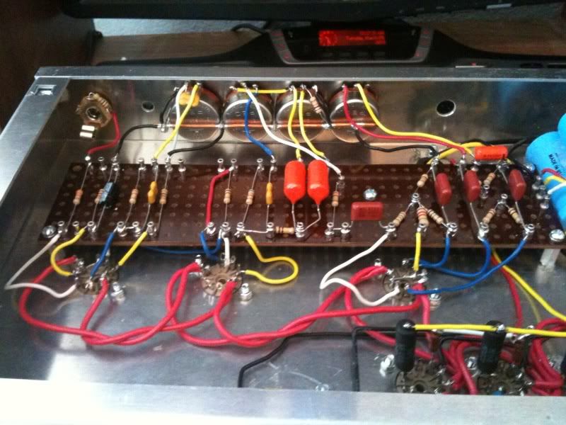

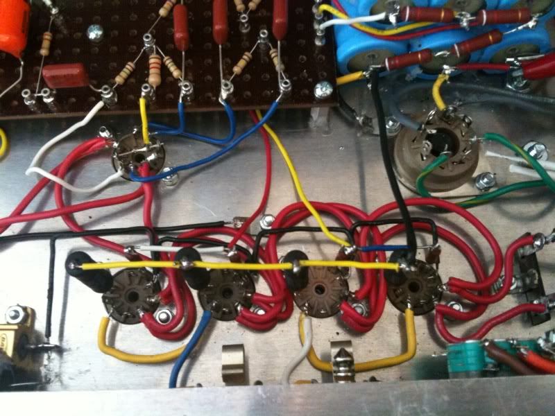

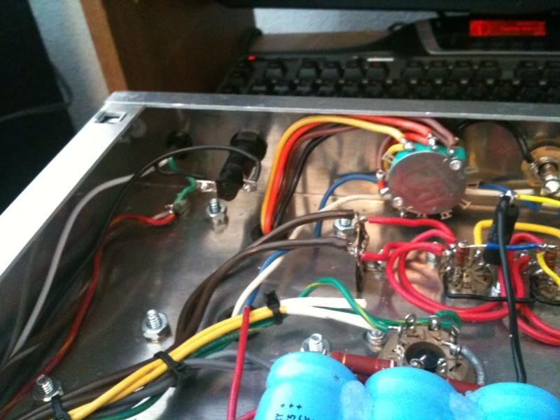

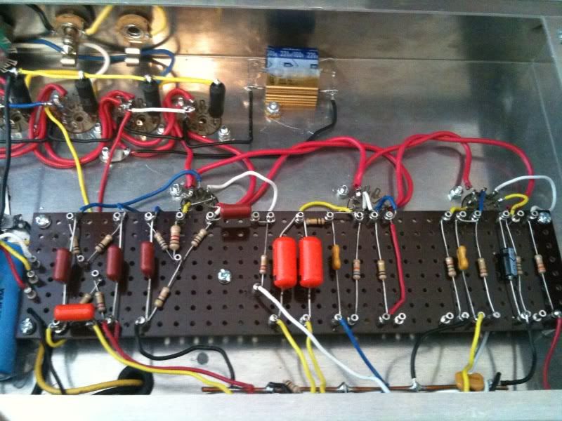

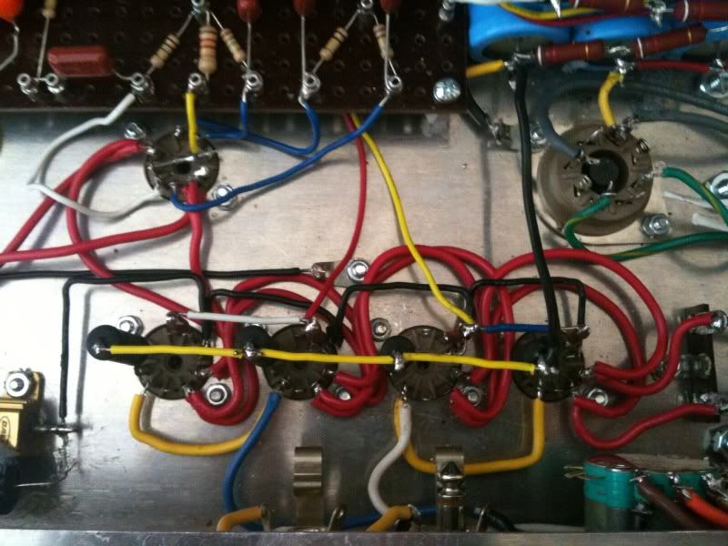

It's not the cleanest build, but here are some pics and a voltage chart....
[IMG:800:600]http://img.photobucket.com/albums/v238/ ... hoto32.jpg[/img]
[IMG:800:600]http://img.photobucket.com/albums/v238/ ... hoto34.jpg[/img]
[IMG:800:600]http://img.photobucket.com/albums/v238/ ... hoto35.jpg[/img]
[IMG:800:600]http://img.photobucket.com/albums/v238/ ... hoto31.jpg[/img]
[IMG:800:600]http://img.photobucket.com/albums/v238/ ... hoto30.jpg[/img]
[IMG:800:600]http://img.photobucket.com/albums/v238/ ... hoto29.jpg[/img]
[IMG:800:600]http://img.photobucket.com/albums/v238/ ... hoto28.jpg[/img]
[IMG:800:600]http://img.photobucket.com/albums/v238/ ... hoto27.jpg[/img]
[IMG:800:600]http://img.photobucket.com/albums/v238/ ... hoto26.jpg[/img]
Is it fair to assume the tubes are known good at this point and the component values have been verified?
Some of the connections look like they might benefit from reflowing. If they are not the issue it will likely improve the reliability long term.
Easy and relatively quick.
strato - Um, the input jack? You seem to have the load resister hooked up incorrectly. It needs to go to permanent ground on the jack, right? Prolly a simple mistake.
Oh, it also looks like something other than a 1meg?
Good eye!
That does look suspect.
Also, I would ground that jack to the buss wire, but I do understand you guys like to copy Ken's design so it's probably alright there.
I think its a solder issue, when the strings are hit causing large in rush and caps aren't delivering voltage.
Make sure each tube is seating well also. Look at the PI tube socket well.
Did you change the 1m resistor as shown goes from tip of jack to ground tip then back to middle switch. Doesn't reguire extra ground wire.
Well, I failed to connect R7 to ground(as seen above). Needless to say, that fixed the voltage problems. However, I am now experiencing ALOT of overdrive in the amp. I wouldn't say it's horrible sounding overdrive, but it's not desirable either. I have to run the volume at 8o'clock or less to get a remotely clean tone.
